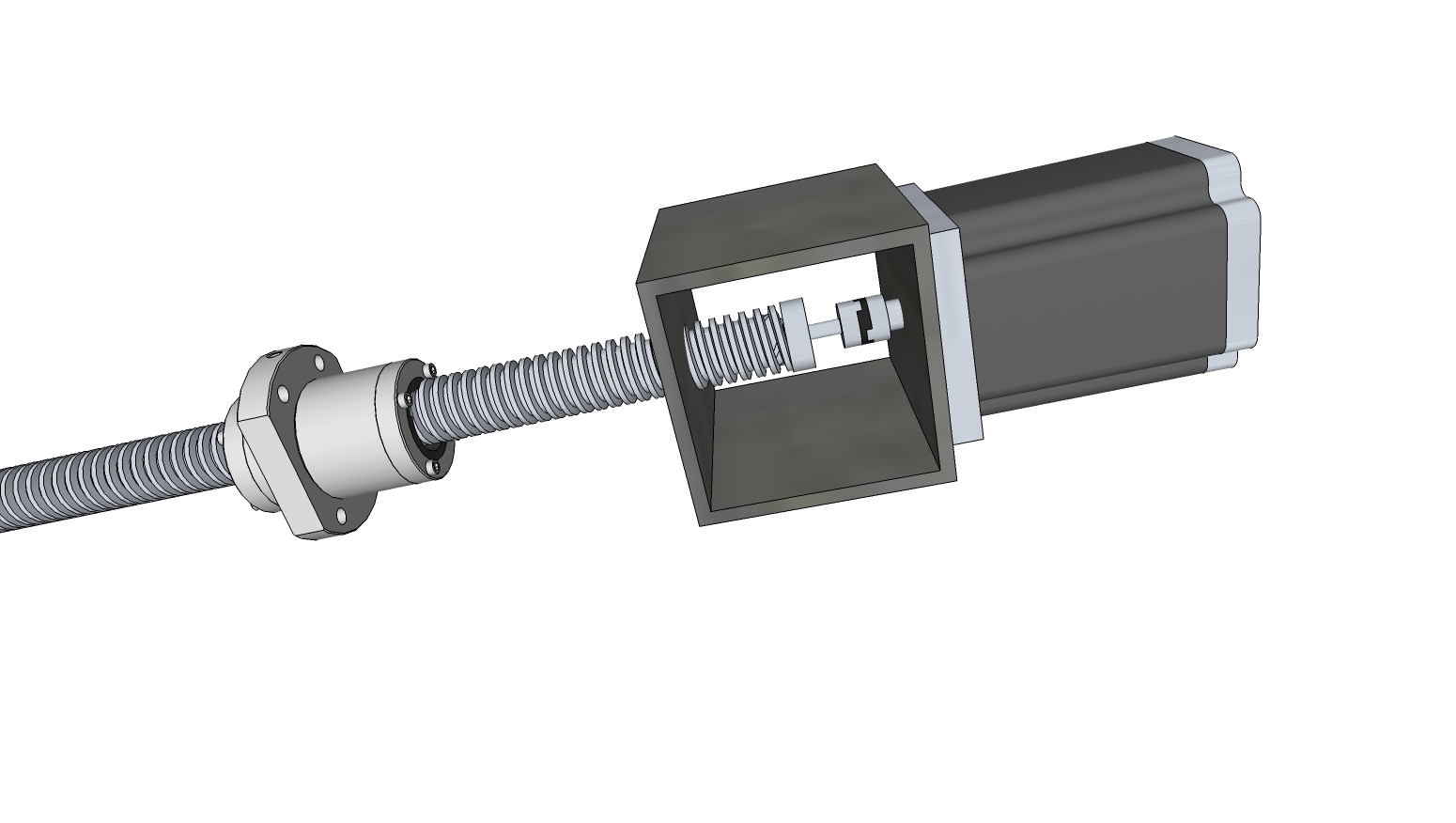

Has anyone used box section metal (suitably machined) for mounting motors etc? Something like 70 x 70 x 4 for example?
Any problems likely? :question:

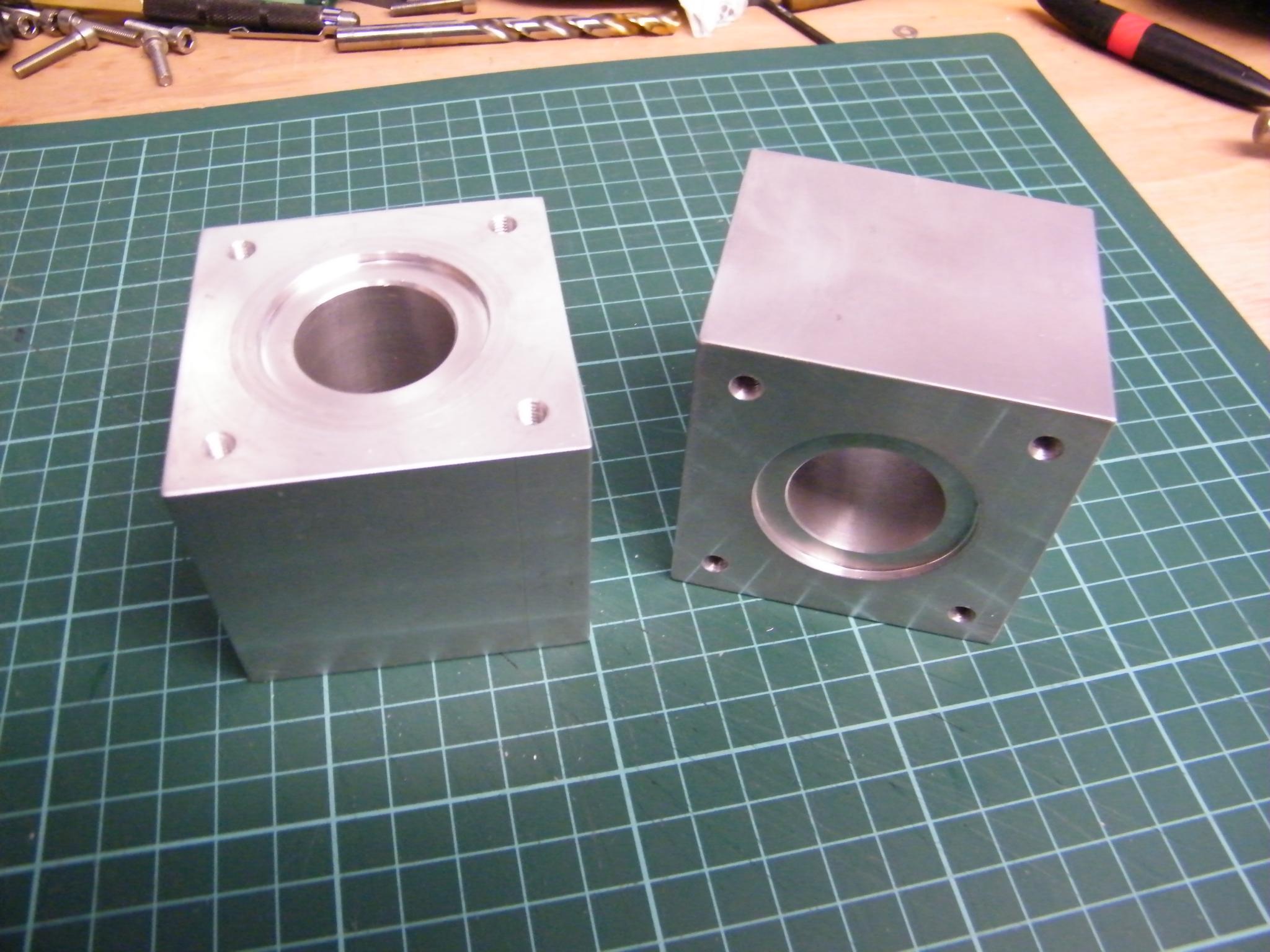

The best method i've seen/used is a solid bar of ali, on the other side of the block is a pocket to recive the leadscrew fixed end bearings, like the floating end round mounts in the other pic, but you use two bearings back to back for the fixed ends.
.Me
Thanks Lee, They do look pretty!
had a ferret around and found these, but forgot to note where I pulled it from! Apologies to the owner for the borrowing his pic :redface:
I'm toying with the thought of using something similar, but longer.. to help protect the more delicate parts.:naughty:
Attachment 4646
edit; picture is from pavlo's excellent build log elsewhere on this site.

I'm looking at slicing something like an 80mm length of 70 x 70 x 4 and mounting the motor on one of the "x4" side walls, with the bearing on the opposite side. So, the ID (62mm) of the box section is the space available to fit the coupling and anything else etc.
I'm trying to find out if 70mm square is going to give me enough room inside, or if I need to go to 80mm, or more.. But I want to use the smallest size that is practical.

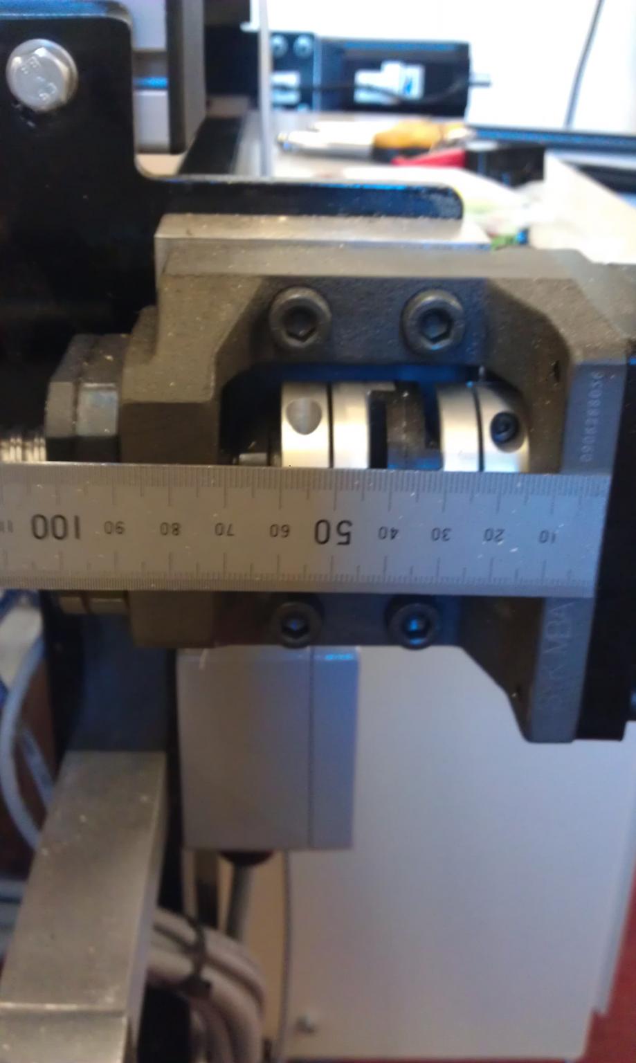

Can you fit the coupling to the motor shaft then fit the ballscrew shaft into the coupling. If you fit them loosely you will have a bit of play to guage what length you need on the ballscrew shaft.
The photo below will give you a rough idea of the distance of the motor mount.
Attachment 4647
Are you using a bought bearing mount for the ballscrew or are you going to make one?
Ian

That's the plan, (theroretical plan!) :)Quote:
Mount the motor first, align that with the bearing at the far end, then the coupling loose, bearing, ballscrew. Then make another plan when that doesn't work! lol

From what I've seen from Ian's picture and the schematics on line for motor mounts, it looks like it will be ok. Of course until I get the parts and the steel in my hand I can't know for sure.
Don't think you'll need as much room inside the box section as you think because you only really need say approx 10-12mm more than the length of the coupling because the shafts of both motor and screw go inside the coupling. So the only extra distance required is the thickness of the coupling dampner (If using split type coupling) plus a bit of wiggle room.
Obviously will depend on how you mount the fixed end of the screw IE:bought BK/BF blocks or DIY etc and how much of the screw you let stick thru the steel.
Edit: Drawing or rough sketch of intended frame and screw mounting would help. ;)
Thanks Jazz, I think it should all fit in.. I'll just do a complete redesign if it doesn't! (so far I'm only wasting paper, not metal!)

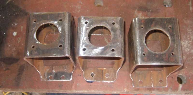

As Lee has suggested I got the end portion (F) of my screws machined 25mm long to leave plenty of room for pulleys. You could do the same here if necessary.
If you do something a similar size to what I made here it should be fine...if not luke is in trouble! I don't remember spending more than a few seconds deciding the length.
http://www.mycncuk.com/forums/showth...3-motor-mounts
I can make you some if you like but it would cost more than a piece of box section and you'd almost certainly be much better off investing that money in buying pulleys as I keep saying! So much more versatile...
