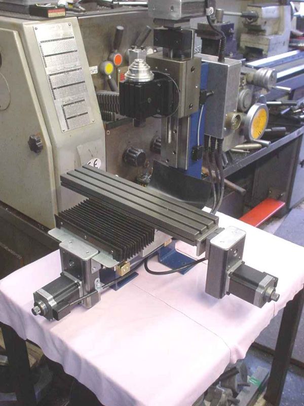

Just for interest and to fit into the recent motor mounting posts here is my Taig.
Attachment 4652
Inside the steel box section are HTD timing pulleys at 1:1 ratio, with a 20 tpi screw the Taig doesn't need any reduction.
I did it this way as I don't like the typical 4 column mounts that look like a clock on steroids plus the standard Taig mounts make the machine look like Prince Charles.
