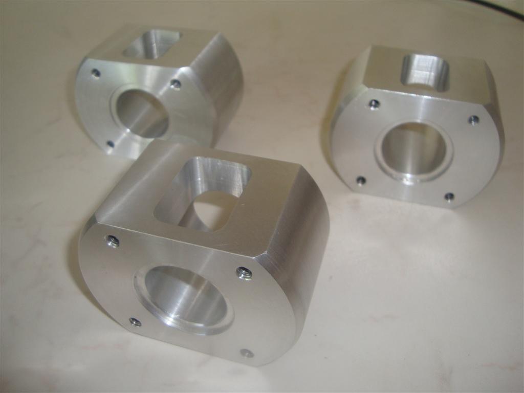

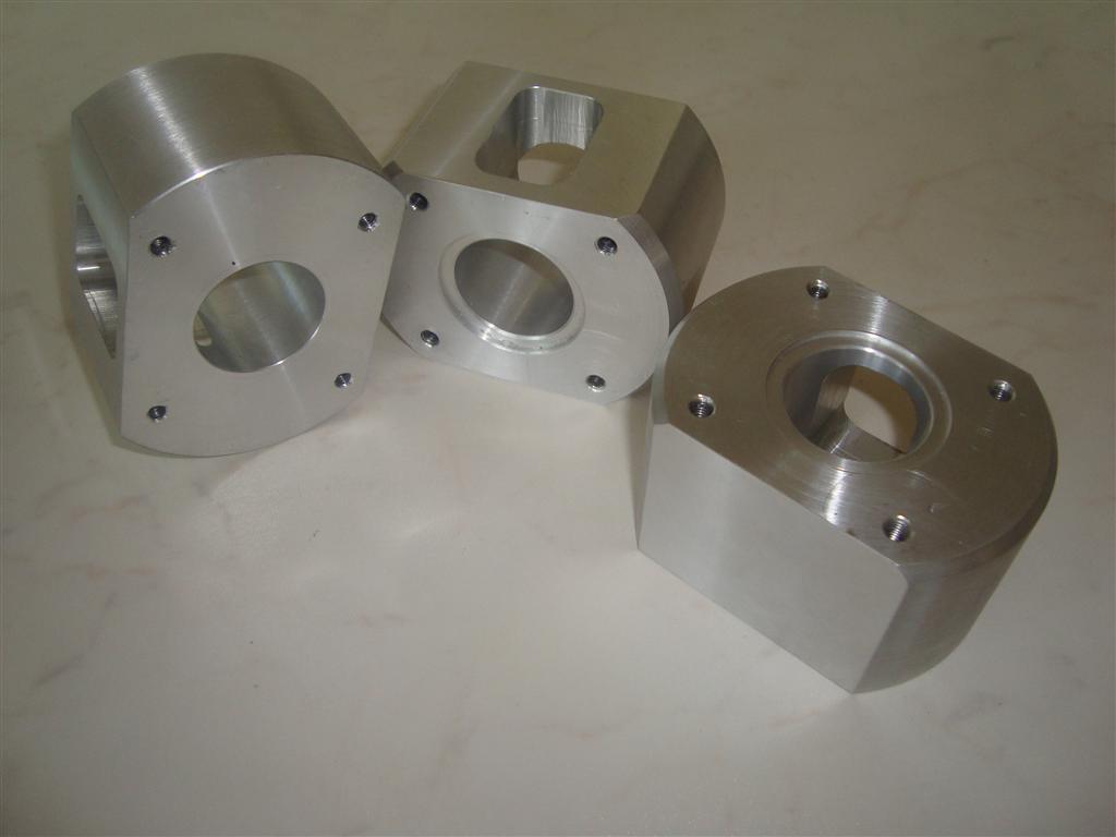

I can do Nema 23 motor mount, here's some I made earlier:
Attachment 4708Attachment 4709
http://www.mycncuk.com/forums/showth...3-motor-mounts
Altering the design to suit your requirements is no problem...
I can also make the bearing mounts if you send me a drawing / requirements.
