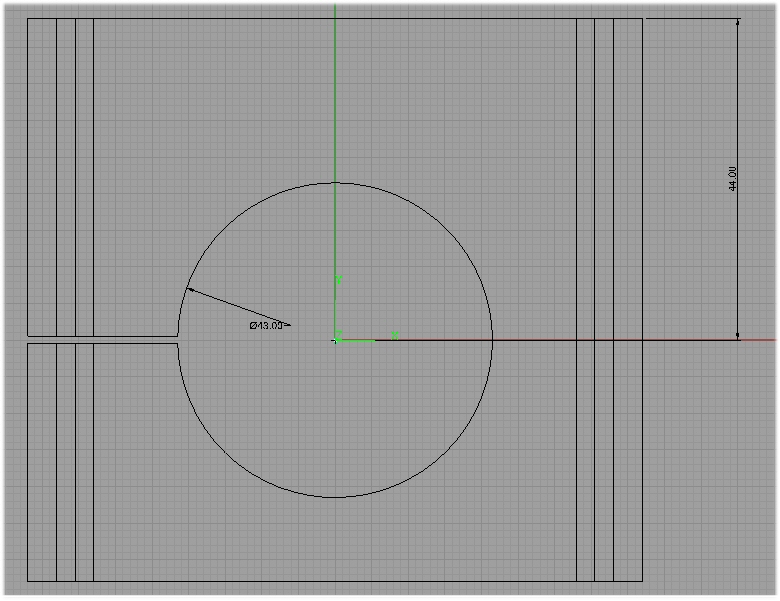

(I've omitted the clamping aspect...as I'm figuring who ever is confident enough to quote me will also be confident enough to put their own clamping arrangment in place! The key thing is those m5 holes - they've got to be bang on (71mm between centres - here's the manafacturer's Z plane mounting plate drawing - http://www.motor-star.com/Z%20AXIS%2...LE%20-%201.jpg ).
Re spindle mount thickness...hmm, difficult, my spindle is quite chunky at 2kg (far too big for such a little machine really), so I don't want a *huge* amount of weight attributed to the mounts alone (although I'm conscious of the heatsinking 'win' a larger mount brings) ...but it'll probably need to be something 25mm thick?
Anyway, my 'first stab'  DXF file is attached which has all the dimensions.

I have had a play with your dxf and I think you may have a problem with getting 5mm bolts into the holes. I take it you would be using a 25 to 30mm long bolt depending on the thickness of the tool post you are bolting on to. You might need to reduce your outer diameter a bit to be able to get the bolts in without them hitting the side of the mount. But then again you could always mount studs in the tool post then just fit nuts to clamp the mount to the post. Might also be better to make the holes 1mm larger diameter, this will give you a bit of adjustment. The 71mm pitch isnt a problem, you can just mill a drilling jig to get it spot on if you really want to.

		Hi Ian,
Good spot with the mounting bolts., I'm liking what you've done...
http://img846.imageshack.us/img846/9...indlemount.jpg
In this fine forums' opinion, would 25mm be about right for such a mount? (just checked the spec 4.2kg of my spindle ....yikes, no wonder my CNC Z plane stepper was struggling on my homemade machine!). Also, I need that amount of 'throw' from the back of the mount to the spindle centre (because the upper portion of Proxxon spindle measures about 82mm diameter) ...just wondering about the mount's weight here ....would it be worth removing some material out of that long back edge (a recess?!) to remove some weight from the mount?

		19mm or 3/4" would be fine, there,s nothing there in the extra 6mm or 1/4" that will add anything to the design.

 The other way to get round that is make the hole a slot, then you can insert the bolt at an angle to get round it. To ensure that the screw fails before the thread strips you need about 8mm thread engagement with M5 into aluminium, so since the mount is 18mm thick you'll be fine with a 25mm bolt. Not that it really makes a lot of difference here...

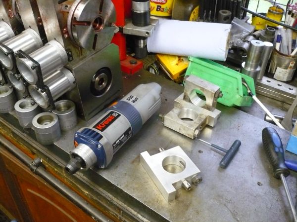

		Looking for a drawing I did a while ago and came up with this picture.
Attachment 4761
Not suitable for your use because you can't get the centres in you need but it was an exercise on keyhole milling to get water passages nearly all the way round the mount to keep the Kress bearings cool.
Not sure if any are left but i don't use my Kress now I have the high speed spindle so I'll do a search and see what I have

		Sure that's enough rotary tables!
I notice you've done the other clamping method. I wonder which way is strongest.
 I was thinking of doing something like that with the DIY brushless spindle as the bearing temperature on those seems to be an issue...if I can find cheap 8mm bore angular contact bearings.

		Don't know about strongest, with the clamp method once the slit is compressed that's it.
With the cotter method there is no limit how far you could pull it thru or better to say how much damage a ham fisted ijit could do.
