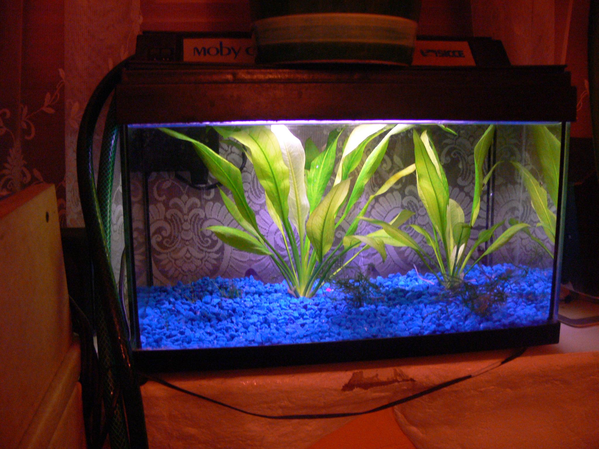

...and replace with fish tank
Attachment 4804
That's how my cooling unit looks like in my PC cooling system after I replaced 3l bucket with fish tank 11l I think:heehee:. 100% pure tap water + antialgae some time ago:smile:
