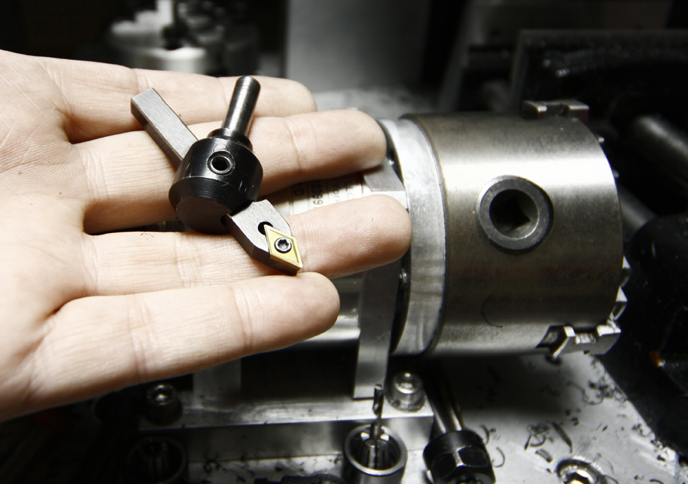

i bought a cheap fly cutter (ebay) and turned the shank down
http://www.ebay.co.uk/itm/Fly-Cutter...item3f0cb22c9d
this one is a bit pricey but its the same as the one i bought... youll have to have a hunt around, RDG might be better (i ended up putting a dcmt insert holder in mine)
Attachment 4817
i can skim alli with mine at 60mm (ish) diameter if im carful (my machine is quite rigid though and my spindle will cut at low rpm)
cuts acatal quite well up to 0.5mm without to much trouble
might be worth a ponder :smile:

EDIT: Having just watched a couple of youtube videos, woaah fly cutters rock - I want one! Mark what diameter is the business end not the shaft but the end that holds the cutter)...I've a mini lathe collet that holds up to 20mm diameter - & do I need the dcmt insert holder you mention?
19.8mm (ish)
not at all... thats just me being lazy...just try to put a "small" radius on your tip when your sharpening your tool

Old thread I know, but I've just got my fly cutter!
(I went for the one blackburn_mark suggested .... http://www.ebay.co.uk/itm/Fly-Cutter...item3f0cb22c9d )
I now need some guidance ....
So the thing is the fly cutter has an 8mm shank, but my modest spindle (200W) only goes up to 6mm collet size. So I used my mini lathe to turn the shaft down, but while doing so the lathe control board blows, to get the remaining 0.5mm off the shank, would you believe I attached a benchtop test psu directly to the lathe's dc motor (needs must!)) ...the PSU only goes up to 60V (vs 180V the motor expects) so the motor turned slower than normal but I got there in the end.
So I slaps the the fly cutter in my CNC spindle & turn it on ...."woah there fella!" ..... Vibration City, Arizona!! (btw: this particular tool scares the life out of me -a sharp bit of metal hurtling around that I can't even see..... god forbid if that cutting tool ever flies out of its holder).
So I backs the revs right off (fortunately my spindle speed goes down to about 800rpm) & sets the thing off cutting. I've got my CNC aluminium bed topped with 5mm acrylic. Sure enough it's well out of true...the right side of the bed is higher than the left & the front of the bed is lower than the rear! (that'll be why I'm getting such crap result wrt pcb milling)
ok, to my question, the fly cutter is only cutting on one side of it travel as the blade spins around from about 1 o' clock to 5 'o' clock (in other words looking at the spindle from the front, the actual fly cutter is only cutting the surface on the right hand side) ....presumably this means my Z axis is not bang perpendicular (the cutting radius is about 48mm) ....is such an assumption correct or could it be something else causing this (fly cutter shaft, spindle shaft etc). Does it even matter - wrt fly cutters - if the cutter doesn't cut equally around it's full travel? Yeah, I know to you guys it'll be obvious...it's only when I hit issues like this - no matter what I mighnt sometimes con myself - that I realise what a totally un-engineering mind I really have.

For HSS 800rpm sounds about right for that diameter. As you found the fly cutter being inherently imbalanced causes a lot of vibration which will very quickly wear out the spindle bearings at high speed. Even if you did balance the fly cutter it still needs to be operated at low speed as for the speed of the tip of the tool to be correct you have to lower the rpm as the diameter is increased.
What you're describing is the spindle being out of 'tram', so like you say the axis of rotation of the spindle is not orthogonal to the plane defined by the X and Y axis motion. Does it matter? If you're using a large diameter cutter and trying to get a very good finish then yes it does since the cut will be ever so slightly concave. Depends how far out it is...to measure it on a mill you would put a dial indicator in the spindle, facing down to touch the bed, mounted on the end of a reasonably long bar attached radially. Swing the indicator round and use it to measure the height of the bed at 4 points of the circle (12,3,6 and 9 o'clock). By comparing the readings you can find the gradient and thus how far out the spindle is and adjust accordingly (shims etc). That gets the spindle orthogonal to the machine bed. That's great on a mill but it's not a lot of use on the router unless the bed is already surfaced to get it parallel to X and Y. So you need to surface the bed first then indicate off it... but it will never be perfect due to the initial surfacing being slightly uneven due to the problem you're trying to correct! I'm sure it will be plenty near enough though as I bet most people don't bother with this at all. Unless it's out by a lot you only notice it on very large diameter cutters.
Edit: Also if you haven't already then grinding a reasonable radius on the fly cutter tip should improve the finish. Not too great though as it will increase the cutting force.
