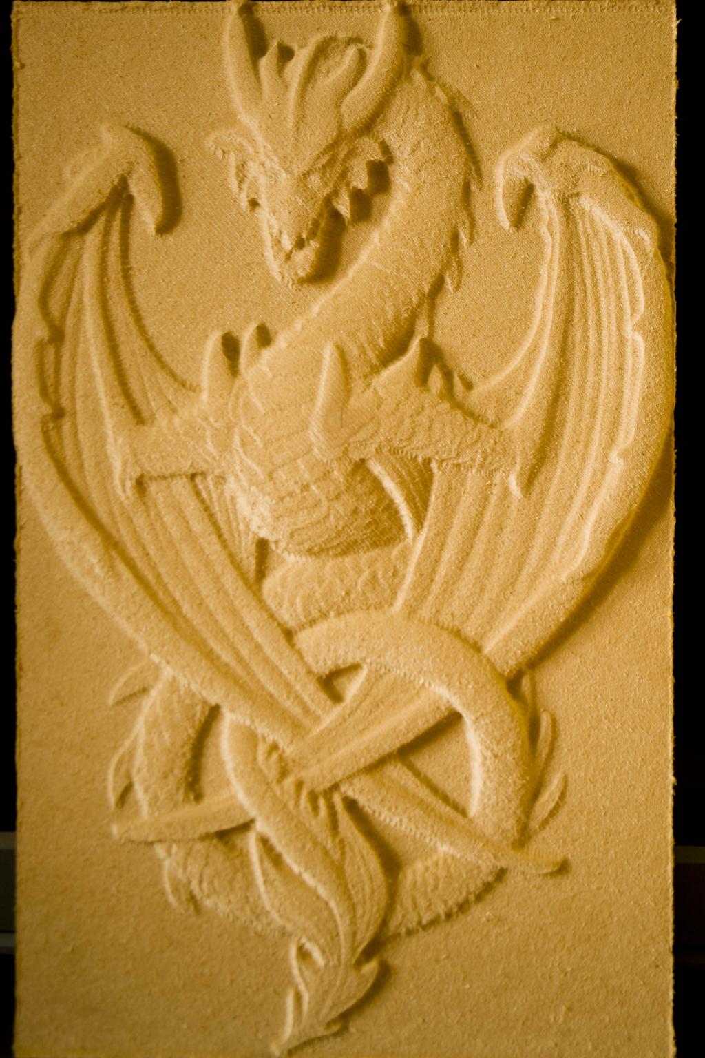

So as not to waste money I did a trial cut in MDF now this material may be cheap as chips but it's not very good for carving as it will fluff up
I would be interested in a better material for proofing a carving.
So I downloaded my chosen model to cut3d which to my surprise is very basic, in fact I found it to basic so artcam is the program I'm going to try next time
Any way I set up my CNC Machine to carve at 414x300 and at a depth if 15mm
As I only had a 6mm ball nose I wasn't going to run a smoothing pass but at the last minuet I did , but I'm glad I did as I found that the ball nose cutter cut's the out edge of the model which would snap a fine 1.5mm ball nose cutter so I will run a out line cut out before the final finishing pass
so for this time I ran the following cutters 6mm end mill (next time I will use a 6mm ball nose) for the rouging pass and a 6mm ball nose for the finishing pass (next time I will use a 1.5mm or a 2mm ball nose)

Attachment 5273

Looking forward to seeing you progress with this. Would hdf be any better to proto?
bruce
Re: Dragon project (Oak coffee table)
I don't know I will take a look on ebay for some is it call hdf or some think else ??
James
There are various types of foam and wax that are designed for, or good for prototyping.
HDF is High density fibreboard and is very stable. Usually has a veneer finish. Try your local quality kitchen manufacture or a joiner that has a workshop.

Just had another idea. Goto any kitchen fitters and ask for the off cuts from solid wood worktops like the bits from cutting out for sinks. These can vary from oak, beech, walnut and others. The picture shows a plate I made from a piece of oak top. Its quite stable and may well machine well. And it will be free!!!

I make a point of keeping an eye out for old furniture in skips, I currently have an oak dining table that is being used to supply blanks for prototyping.
