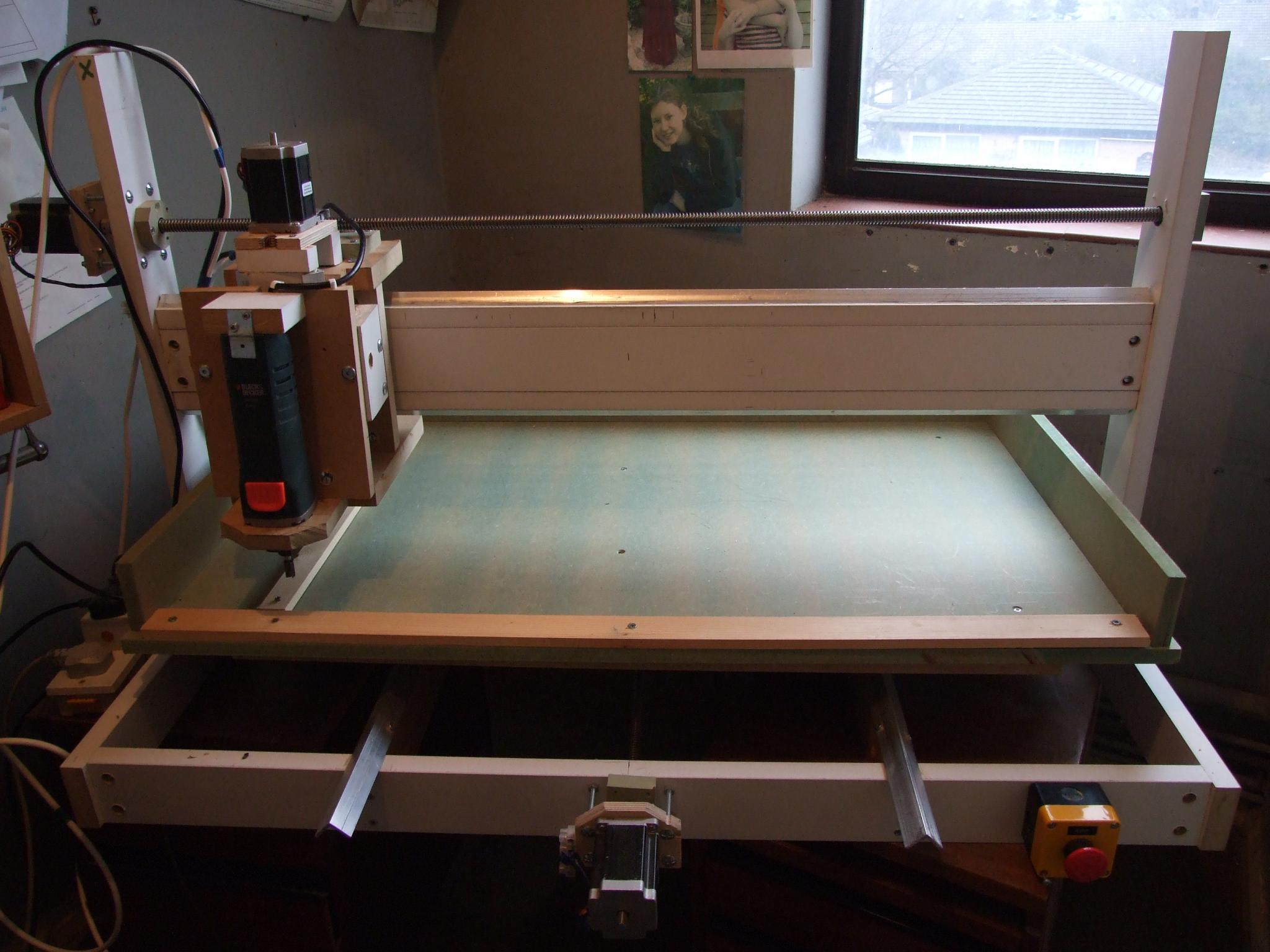

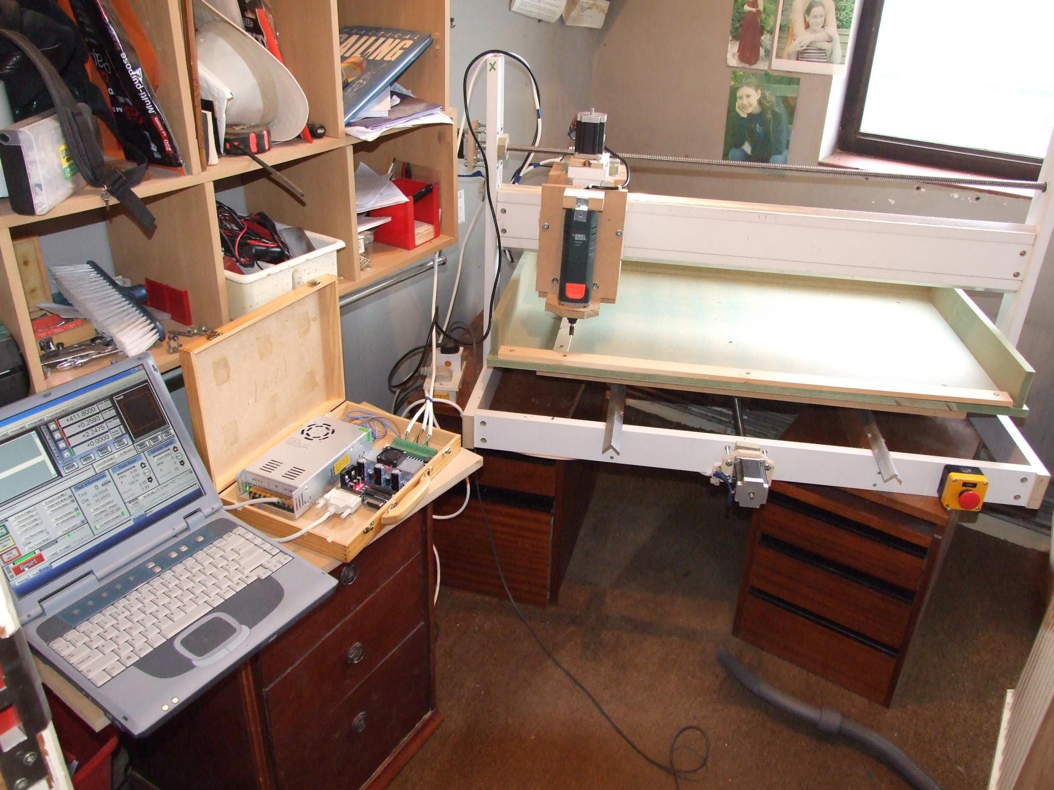

Hi All, been reading and learning a lot on this site for quite a while, I built an mdf cnc last year and like most people got hooked and needed to build a better one. I decided to go with a fixed gantry this time and it looks like it will be a lot more stable than my previous moving gantry model. slightly larger footprint is small price to pay.
I used 1"x3" coated mdf for this one ,I have used the 3.1Nm Nema23 439oz stepper motors and TB6560 Driver board from 1st machine.

Thanks a lot, it did feel good the first time ran it and it actually did what it was told, steep learning curve but well worth the effort. now down to thinking what to make with it !!

I know the feeling... made it because it was interesting to make, not for a specific purpose.
What screws are you using for each axis? Looks like ACME not ballscrews from here.

Hi Jonathan, I used TR16x4Dx1500mm and 1000mmTrapezoidal Acme Leadscrew for the X and Y axis and 10 allthread for Z axis. had a couple of teething problems this last 2 days but will be all sorted out tomorrow.
