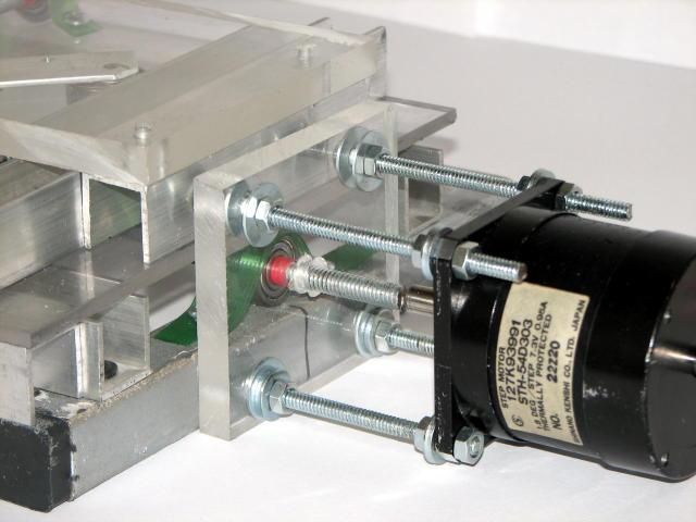

 I would be interested to know how you get on as I like the price of this machine but not the various opinions I have been hearing. Here is a pic of a mounted motor that I saw. Please bear in mind I know nothing about CNC machines and there construction, its only something ive seen.
Attachment 5428
Out of interest what will you be making with it?

 Tube pillars would be better than just threaded rod.

		That's what we had in mind. But if we put a bit of pvc pipe inbetween the motor and the frame we can just use bolts from the motor into the tapped holes in the frame, which will give it a better structual strength too. Aswel as keeping the motor paralelle with the frame. Which i'm guessing is important to match the shaft from the NEMA to the leadscrews.
