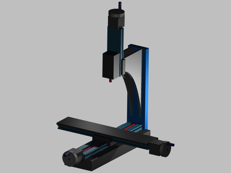

Building a CNC, x=20" y=20" z=10"
Expensive cnc are too high for most people. I have a Sheline 5400cnc. at $3,200.00us this machine breaks down alot, this time the A axis driver failed.
I am building the USB controller, driver and milling machine with the skills I have.
CNC controllers have a major problem with BEMF, I design motor controller with 500 amps output and over 144v.
This is not that hard to understand, when you have some back ground in electronics, computer programming and mechanical engineering.
Alot of people want to use a Arduino to build a CNC controller, but there have software problems from G-Code to C++.
They are great toys, but working with Atmega 168/328 would be a better way of getting a software designed.
I plan to do experiment on PIC/Arduino/Atmega chips.
Looking to spend less then $1000,00 us.
I did a design that should fit my needs:
Attachment 5427

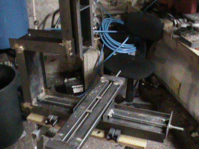

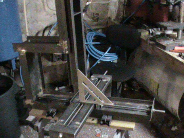

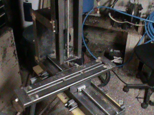

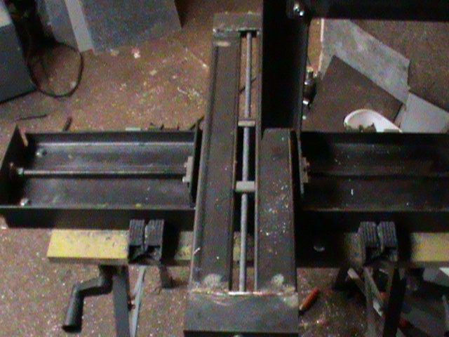

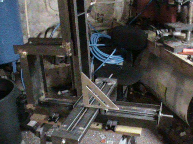

Update on my cnc mill design.
This is what I am using to build this mill.
6" x 2" I beam /1/8
3/8 threaded rod with nuts
1" x 2" 1/8 with 1/8 L brackets for x axis
6" x 2" I beam for y axis
Frame is welded.
Attachment 5453Attachment 5454Attachment 5455Attachment 5456Attachment 5457
re: Building a CNC, x=20" y=20" z=10"
Tommy do your self a favor and dump the threaded. . . . Nothing but trouble, the little extra for lead screw will payoff big time on head banging.!!
Also depending on what you intend to cut with this machie I'd strengthen the I beam joint where it goes from vertical to horizontal.!! . . looks like a nice place for flexy springing.? .. . A few triangle plates would help big time.!

You think! do your self a favor on my threaded, and kiss my A hole.....I'm not done, but you could not see that could you!
I will add a angle bar, and other metal brackets in the future.

Yeah, maybe I jump the gun....all I can say is I'm sorry.
I agree, the extra brackets, and more metal will do...
Its my first CNC mill I'm building, also building the controller and driver pc board....

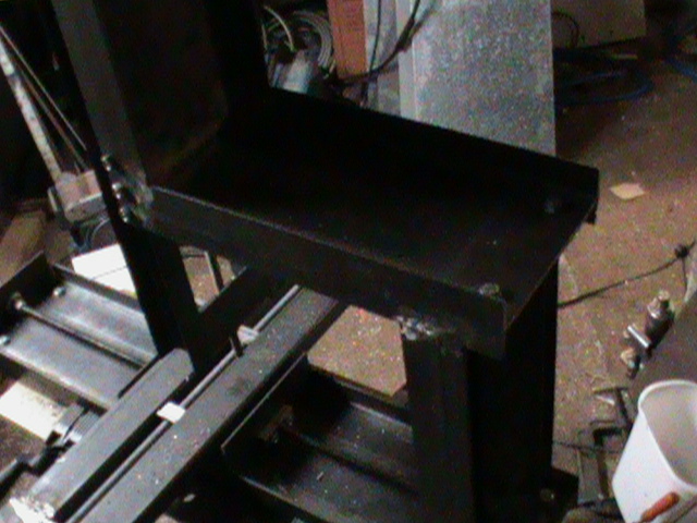

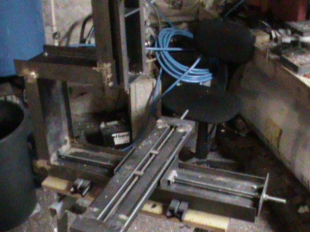

Ok, I added the base.
This is a I beam 3" x 4" 1/2 and 1/8 l brackets
I attached it to the upper level of the mill.Attachment 5461Attachment 5462Attachment 5463Attachment 5464Attachment 5465Attachment 5466
I have about $125.00 us in this mill so far.
