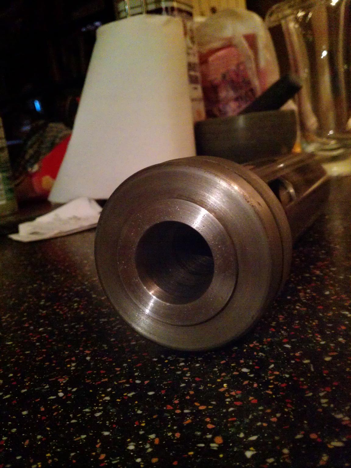

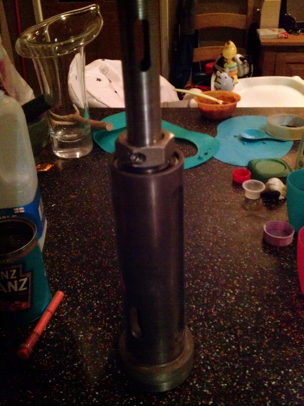

About time for an update and a drip feed of pics. Tonight I finished rebuilding the spindle for this machine in readiness for the Poly v pulleys i need to make. I dumped the original inner and used an old spindle from a lever lock collet closer. I re machined it to take new bearings and machined it to use R8 tooling (before you ask why?....i have loads of it already). I ended up with a 28mm id bearing on the top and needed a lock nut, apparently they don't do them? So i ordered a 28mm x 1.5 pitch hub nut for a citron/ Peugeot that fitted the bill and sunk a capcrew in the side and slit it. It locks lovely
Attachment 8642
The next job is to make the pulleys and machine the rest of the spindle so it all looks good.

Another pic of the R8 endAttachment 8643

:friendly_wink::friendly_wink:What size and type bearings did you use if you dont mind me asking? Still collecting info for my spindle project and its good to build up a data base of existing arrangements.
You are probably aware but the pinch bolt in the top lock nut could cause vibration and imbalance at high speed, since you mentioned vfd I'm guessing you are looking to increase top speed? If not ignore my comment :friendly_wink::calm:
Re: CNC Arboga U2508 Mill Conversion
Hi Ross
The lower bearing is 35 x 62 x 18 and the top bearing is 28 x 52 x 12. I've left enough room to double the top bearing should i need too. It's all about making things fit, it does not work out then i shall build a complete new spindle and housing. The locknut should be fine as used that arrangement before on another project. It's all heavy duty so will have to see how it works out. Just made a new adjustable burner for the furnace, so will get some Ali blanks cast at some point this week to make the pulleys. I can then start getting the motor mounted etc.
Attachment 8688
Fair point, just seems a shame to do all that work and then risk an imbalance problem :smug:
Cheers for the bearing info, are they AC or deep groove?
lastly why would you want to put 2 bearings at the top? most of the cutting force is in the lower bearing, hence the lower one being bigger.
The top are just deep groove, having two just helps with stability. As for the nut i could always replace that without too much effort. Thamesdown bearings said they could get me proper locknut but only on as a special order for a ton of money. I will learn a lot more from what does not work, i'm happy to just plod along :lemo:

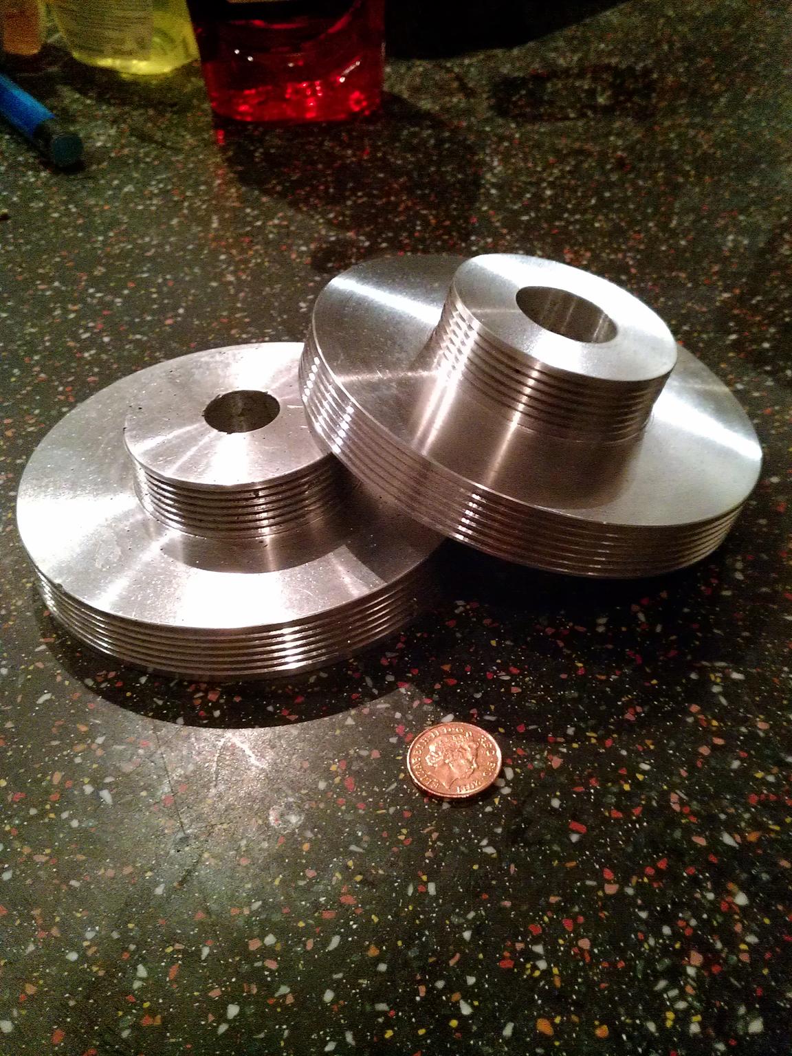

Monday i had a chance to cast some Ali blanks for the pulleys. Got one machined up yesterday evening and the other tonight. The one on the left i will have to make again. Stupid me let go of the cross slide whilst plunging the pipe threading tool in for the ribs and it pulled itself in (tool slightly too low). This in turn locked and flung the pulley out of the chuck damaging it. I will use it for now so i can mock things up.
Attachment 8738
Made these to fit 'J' section 5 rib belts, size 559mm long or 22" in old money. Belt will be here next week.

looks good, shame about the slip, why is it always the last operation that goes wrong?
when will it be working then?
Good question? Time is very finite that i can use so it really is a question of slowly but surely at the moment. Need to do some casting which i will do over the weekend hopefully. I can then build the motor supports and remake the left pulley. Now i have these bits i can start laying the motor out and fix the top plate, work out how i'm going to fix the spindle in place as well as make a bush to lower it in the head slightly.
Will grab some more pics of all the other bits as soon as.

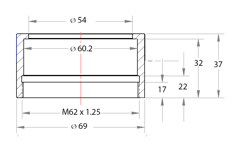

Just got the Arboga u2508 mill and I am missing the spindle nut.
Got an m62x1.5 nut from a supplier in order to fabricate the collar but the m62x1.5 isn’t correct.
Can anyone confirm the thread pitch ?
Or better still has anyone got a spindle nut for sale or know where I can source one or have one made.
Thanks in advance.
Jon

Hello
it is correct the m62x1.5 isn’t correct, the name is M62 but the thread is SAE 20, wierd i know
i bought a nut from suplier here in sweden for about 1 week ago and they told me this, and i have also checked this for about 5 minuts ago..=), i will come back with e-mail and what company you can buy the nut, one moment..=)
but it is bastards out there so to be sure, buy i thread checker tool and try the SAE 20 on the spindel threads.
the SAE 20 is very similar to 1.25 metric threads, so i think that will work to, but it is SAE 20
Attachment 23162Attachment 23163

I payed 95 Euro, but if you go to a macine shop with the drawins i added the can easy make a nut for you

Hello

I actually turned a spindle nut and cut the threads myself on my lathe. Knurled the upper portion to make it easy to fix/remove.
Turned the washer/collar too.
Actually an easy job and it works a treat.
Many thanks for the drawings and if anyone is stuck I’ll turn and thread a nut for you.
