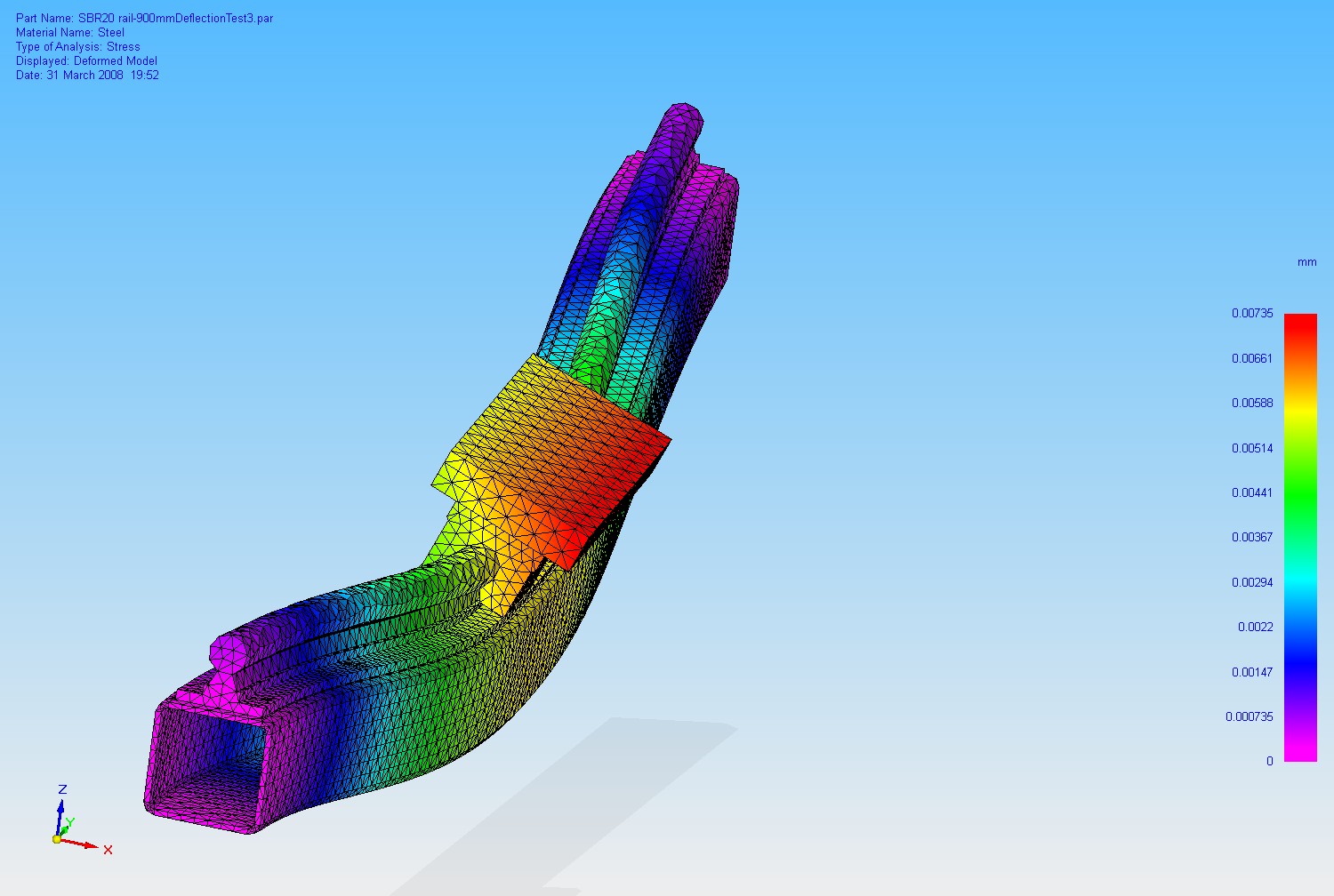

Why not use unsupported rails?
This question arises in almost every build log on the forum and every time someone explains why they are unsuitable for most CNC Routers. Here are some simulations I have run to prove the point...
All rails are 20mm diameter with 150mm between bearing block outer faces. The bearings are attached to a 75x160x20mm plate to which the forces are applied.
Assumptions:
Rail / box section ends are perfectly rigidly supported - in reality wont be so deflection will be greater than calculated.
All joints are perfect, modelled as single entity - in reality will get some deflection between joints.
The following diagrams each have different scales to make the deflection visible throughout.

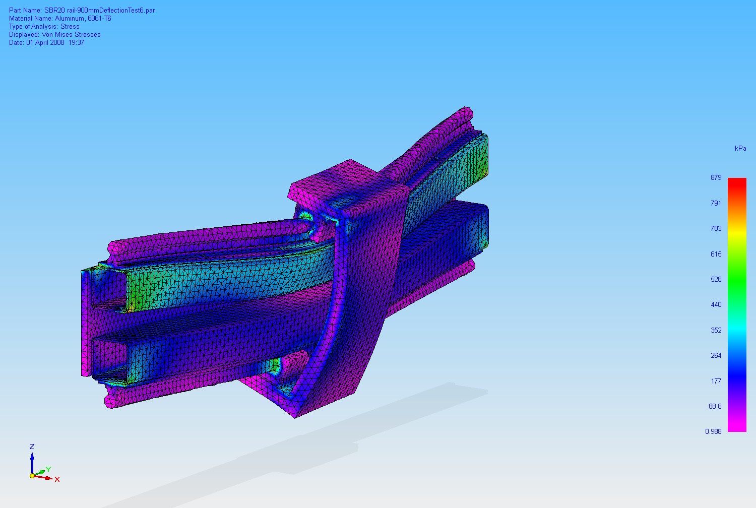

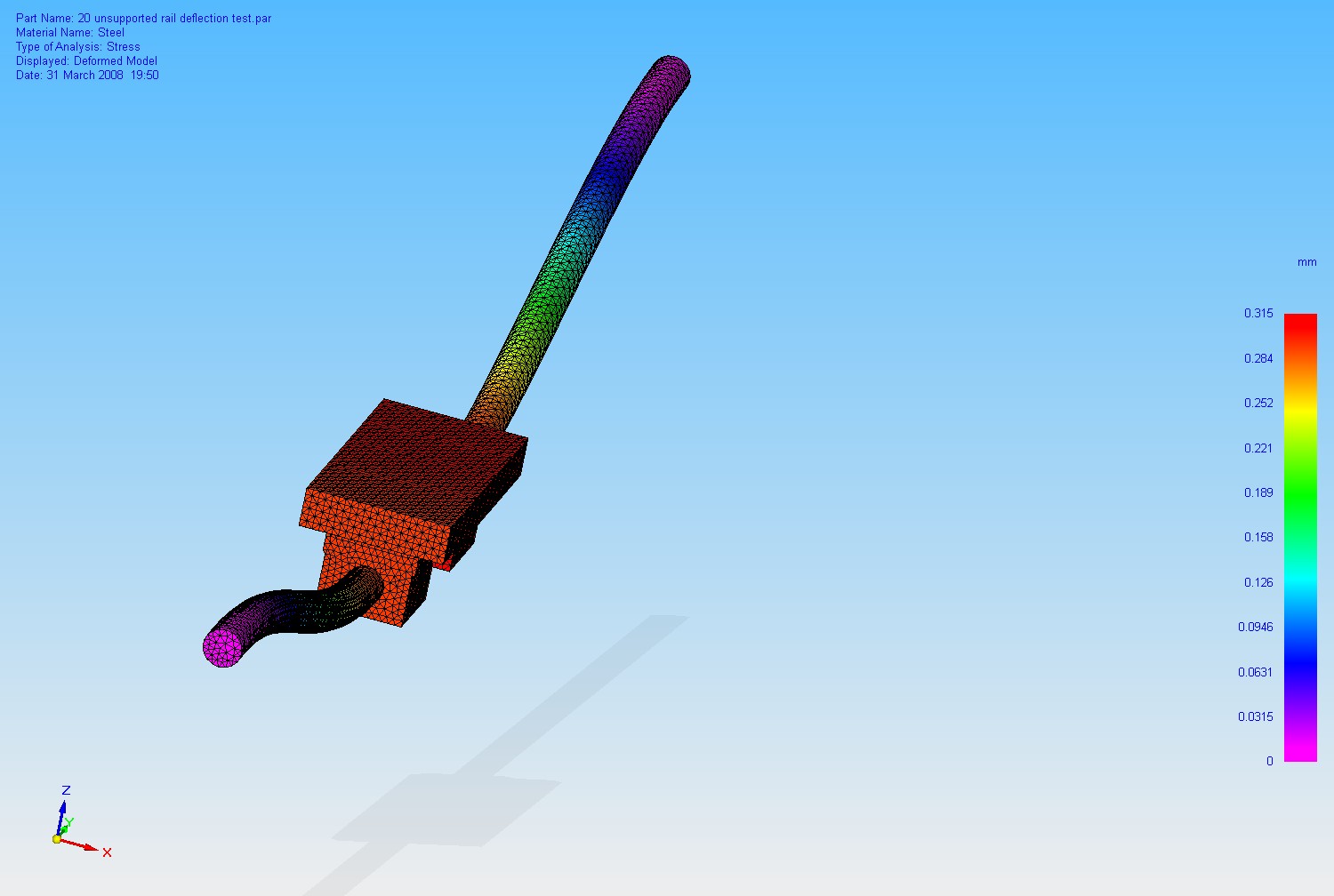

Unsupported rail 200N in Z direction to simulate weight of Z-axis:
Attachment 5615

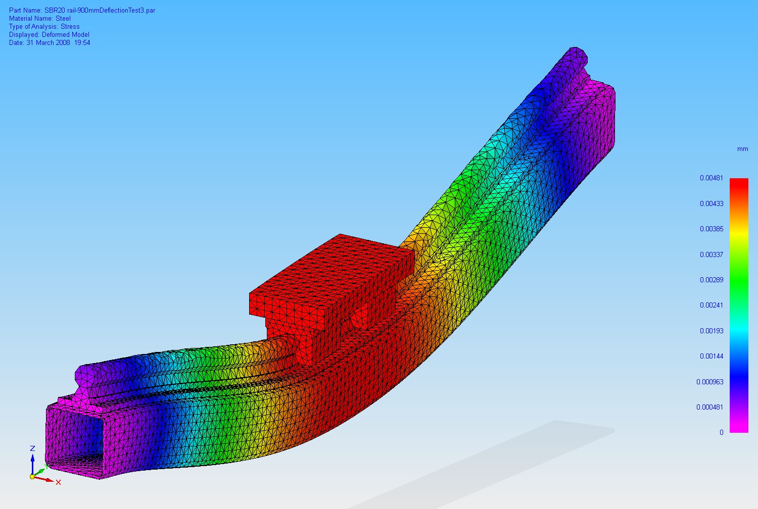

Supported rail 200N in Z direction to simulate weight of Z-axis:
Attachment 5612

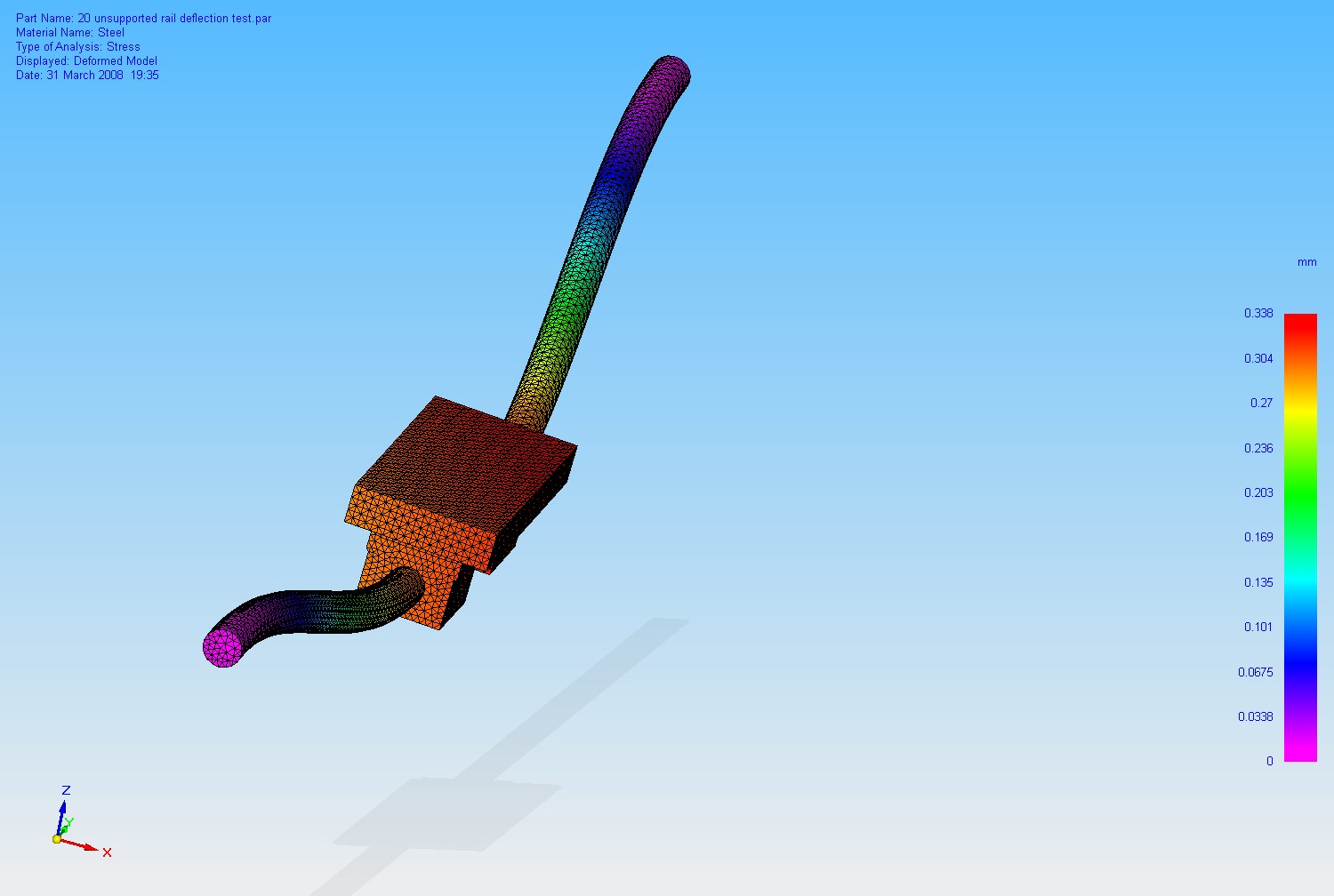

Unsupported rail 200N in Z direction to simulate weight of Z-axisand 50N in parallel to X for cutting force:
Attachment 5614
Supported rail 200N in Z direction to simulate weight of Z-axis and 50N in parallel to X for cutting force:
Attachment 5613
Max deflection for supported 0.0074mm vs 0.34mm for unsupported... draw your own conclusion.

So by the time you have factored in unsupported rails, rolled ball screws, or Acme screws, off the shelf commercial extrusion, lovejaw couplings, roller skate bearings as thrusts for ballscrews you have the equivalent of a high tensile wet rice krispies box.
Good job the builders of these machines don't have access to a FEMA program so they can see where they have gone wrong. :rofl:
Re: Why not use unsupported rails?
So, for those of us who are colour blind:
Case 1) Unsupported deflection is about 100 times greater than supported
Case 2) Unsupported deflection is about 50 times greater than supported
Nice work J. Ever thought of designing roller-coasters?

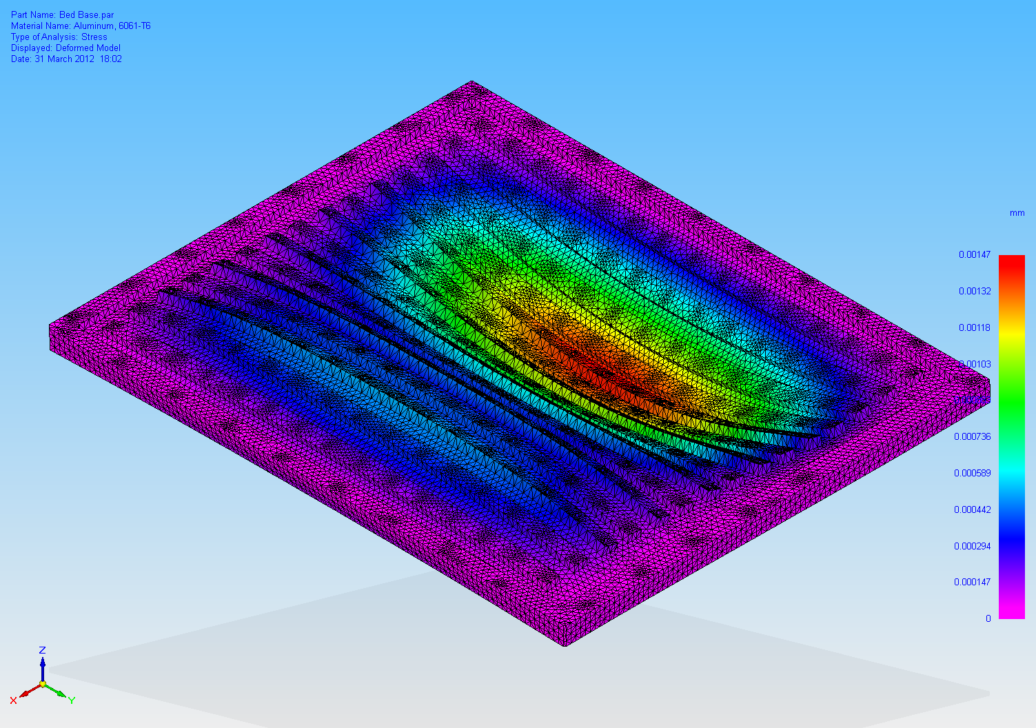

Yes, there is deflection in the bed, I'm not implying this accounts for all the deflection. My only point here is that the same diameter of rail is tens of times weaker when unsupported, so all other factors being equal, if given a choice between unsupported and supported, you should go for supported.
An FEA simulation is never 100% accurate, but it's certainly a big improvement on estimation and common sense. I've simulated bed designs too, here's park of one I'm working on:
Attachment 5618

2 Attachment(s)
The purpose of this simulation is purely to compare rails, not to say one type of rail is better than another in all circumstances, clearly each of the 3 main types of rail has its place.
What the supported rails are mounted to has to be included, as nobody would mount them without any support, however including other factors such a bed strength is unnecessary complication and so should be considered separately. Clearly when designing a real machine you must consider how all the parts interact, so ideally one would simulate the machine as a whole. However since the rails are a major source of error it is reasonable to look at them independently to help with selection.
The main advantage with profile rails is they can tolerate high preload, so the stiffness is much higher and there is no play (so long as the preload is not exceeded), which is why I will soon replace my round rails. Round rails have much less, if any, preload so the deflection of the bearing block relative to the rail is non linear and greater. In the case of just supported rails the load rating/stiffness varies depending on the direction of the force which is a significant disadvantage if not mounted 'opposing'. The accuracy of a profile rail is not much different to a round rail - it depends how you mount them as how many of us correct the bend in a profile rail by comparing to an accurate straight edge reference? Not many as for the vast majority of machines it's excessive.
2e0poz
Your right john, it would be interesting to see what the equivalent would be of unsupported against...for example would 50mm unsupported be the same as 25mm supported?

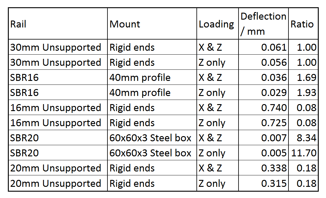

Depends what you mount them to...I've run simulations to find the equivalent in supported rail of 30mm unsupported. Since you suggested comparing 40mm extrusion I have used 40mm *light* aluminium extrusion. Same forces as before.
Table, Ratio colum shows deflection relative to the equivalent loading on 30mm unsupported.
Attachment 5619
Pretty pictures attached:
Attachment 5620
So the 30mm unsupported rail is similar in bending to the SBR16 rail on weak 40mm extrusion, yet currently using the cheapest prices for each I can find the 30mm system costs 70% more. That's for the rails, bearings and end supports, or supported rails, bearings and extrusion. That implies that now the prices of SBR (and TBR) rails have decreased significantly since 2eopoz bought his it is no longer makes economic sense to use unsupported. The exception of course is a small machine (Jazz's 300mm estimate sounds reasonable) with lower forces, or laser and plasma cutters.
The thing to do now would be to run the simulation with two rails as that is more realistic, however I don't think it will tell us anything new.

Hi Jonathan,
Enjoying your stress analysis so far - good work there. I think people are finding the pretty colours more interesting than my old spreadsheet of numbers.
You mention the bed analysis - any plans for stress analysis on other areas of a cnc machine such as gantry sides?
routercnc
Thanks - I used that spreadsheet a lot to start with.
routercnc
Don't see why not. Although I'm not sure what to compare there? I could model different thicknesses of aluminium plate, but that wont tell us much more than your spreadsheet did. What would you suggest?

Hi Jonathan,
I was only thinking of various thickness plates vs RHS. Both cantilevered with one end grounded over an area representing a typical gantry end section (e.g 80x80 extrusion). For RHS the inside gap at the grounded end would also be filled in over the same area as the end of a typical gantry (e.g a spacer) since this represents the best bolted joint.
You are quite right that this is available in the original spreadsheet its just that your pictures are easier for most people to follow, and it is another question that gets asked on this forum. Just a thought since as this is now a sticky it might help newcomers to see the relative performance of common CNC machine designs if the analysis results are all grouped here.
