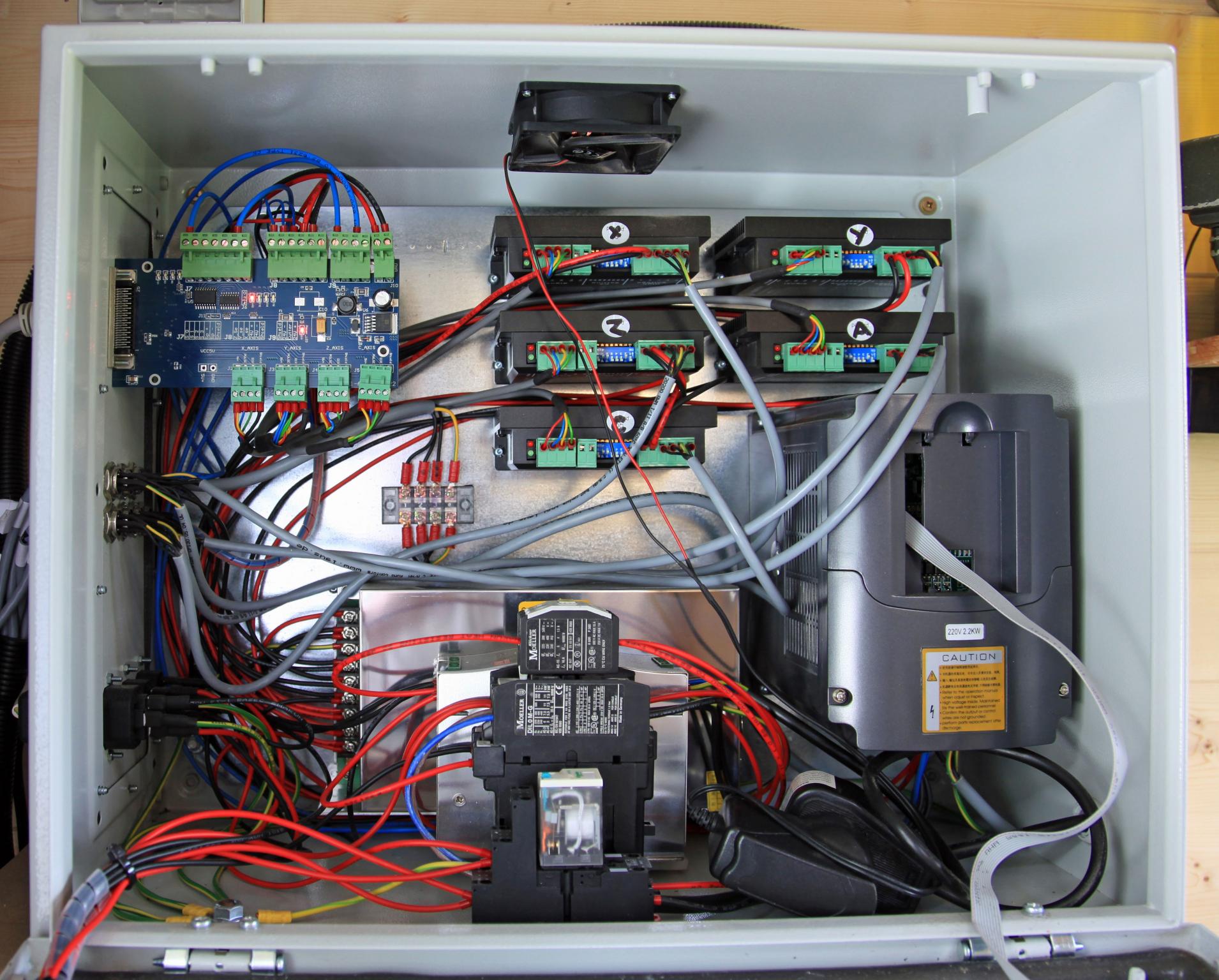

I was using my router over the weekend, and noticed at the last moment I didn't set the position right so hit the emergency stop button and it all stopped but then when I restarted it the motors now don't work.
I didn't build it, I bought it because the wiring was beyond me, and have been in contact with the firm but thought while I was waiting for him to get back to me I would try here, as the guy I spoke to just doesn't inspire confidence in me.

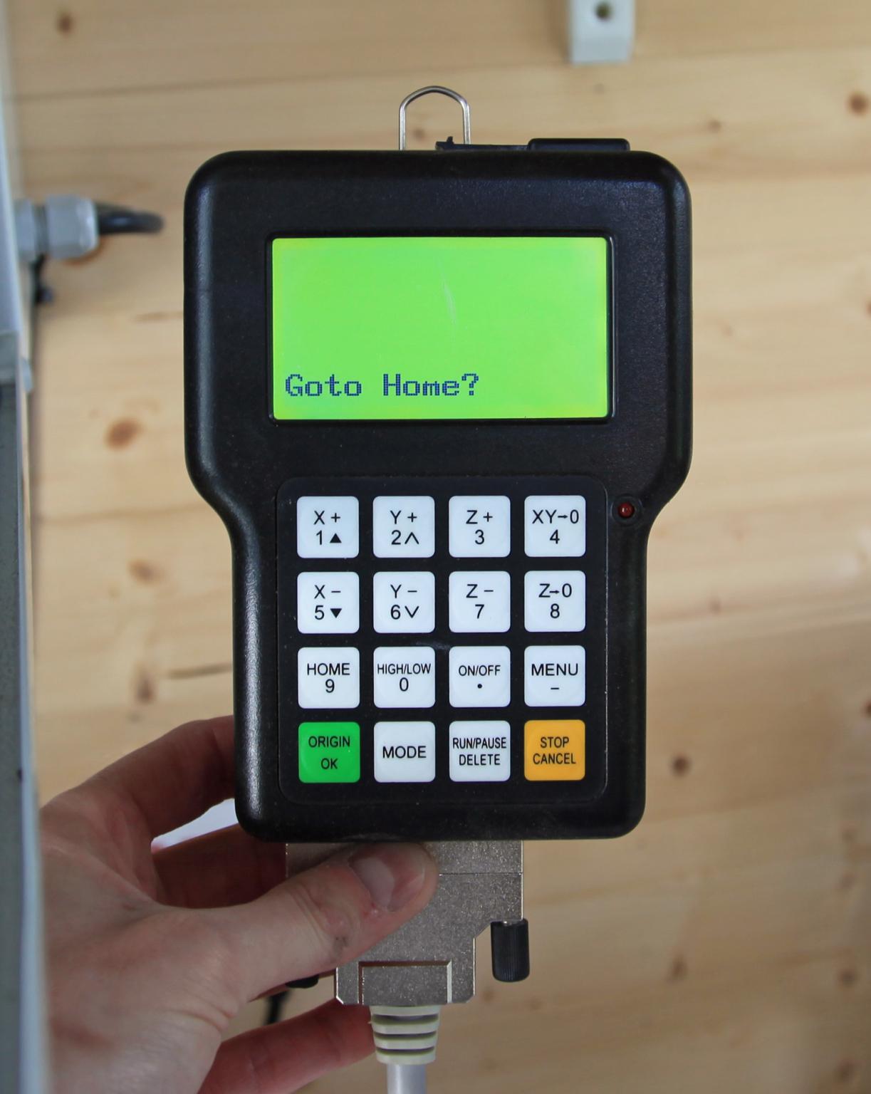

So to help explain I have attached two pictures one of the main wiring box, and the other is the dsp pendant that works it.
Now when you switch it on there is a clunk from inside which is the main relay switching on, (that's the tall black thing just in front of the little clear square thing) but there used to be a second clunk type noise as the motors engaged, which no longer happens. Apart from the motors everything else works. Once on the pendant displays 'go to home' and when you press a button it starts counting as it normally does, which to me indicates that it works fine and thinks the motors are now moving the carriageways to the home positions but there not. Power wise the large silver box at the back that supplies power to the axis controllers has power going in and coming out, so not knowing a huge amount about these things I came to the conclusion it could be a problem with the controller card, because the pendant seems to be sending the info to it, but it's not getting to the axis controllers, and while it could be the axis controllers, I thought the chances of them all going wrong at the same time is minimal.
But as I said wiring this sort of thing is not my strong point, so any suggestions would be much appreciated.

From the control box picture the top right are the main stepper motor drives, they look something like the 542 or 752.
If so then it looks like only the step and direction are connected, and the enable pins are not being used, meaning that the drivers are enabled as soon as power is applied
You say that the silver power supply has power going in and out.
What voltages are you seeing at the silver power supply, You should see your MAINS 230VAC in, and anything upto 75VDC out, depending on the power supply and drivers being used.
Are any of the LED lit on the drivers?

EStop is a good one to check as are the LEDs and actual voltages. Also check all limit and home switches.
It would be unlucky to have blown all four drivers but the lack of a second clunk does sound like a fundamental problem. I assume you have a multi meter? Set it to DC volts, 10v or 20v range if applicable and measure the voltage across the STEP inputs on the X axis driver, right up at the green connectors. It may read 0V or xxV (near 5V most likely), now with your other pair of hands use the pendant to jog along the X axis and see if the meter reading changes. Any change in voltage associated with the movement tells you that the step control signals are getting as far as the driver, no change in voltage tells you that the problem exists before the driver.

It sounds like the contactor and relay aren't getting activated.
Can you trace the wiring, to see what the relay and contactor coils are connected to?
I'd guess they're somehow connected to the E-stop circuit, but it's just a case of following wires until you find where they should be getting power from to confirm.

Don, can you post a photo looking down into the control box showing the top down view of the relay, contactor and the power supply. Also what is on the front panel of the control box? It looks like you have some of the wiring from the relay and contactor going there.
Another tip is to throw away your neon screwdriver and get a decent test meter. Neon screwdrivers are at best un-reliable, dont trust your life with it.

Anyway the problem turned out as the guy said to be an internal fuse in the power supply, which was the larger silver box at the back, so they fixed that, but I thought kind of silly of a manufacture to put a fuse internally where it can't easily be reached if it should blow. They also turned the fan around so now it sucks in air via the filter and blows it out the top, but once back working I found my tool height sensor no longer works. Its not the sensor itself on the pendant you push menu then the on/off button and it start a sequence that moves the x axis down to set the tool height but when I hit those buttons nothing happens. The guy so far hasn't got back, but says they are on two separate power systems so wouldn't be connected, but seems very coincidental to me that something blows and something then doesn't work, so will wait and see what he says.

Sorry for the long delay, but the company said to reinstall the pendant software to cure the tool height setter not working so not being too good at stuff like that, I left it until I had done all the jobs needed, (just in case I buggered it up) and reinstalled it as per the manual and it still did the same, as in your press the two buttons to start the automatic tool height setting and as before it jumps straight to the end without moving. However someone local who works with a cnc router said he didn't think it was a software problem as the pendant works fine with everything else, and the pendant thinks it's set the tool height when activated, so he thought it could be either a duff cable which for some unknown reason has shorted out (bearing in mind we still don't know what caused it to blow the power supply in the first place) and is sending a false signal to the tool height setter so it thinks it's set the height or a controller card problem.
So I contact the company to find out what the cable was as I can get one locally then take it back if it's not that before getting onto the controller card, but it seems the company is happy to sell you stuff, but when it comes to problems well it took them days to get back to me each time when I rung or e-mailed about the loss of power problem more times than not they never got back, and I had to re-contact them for an answer and now I don't even get a reply, to e-mails or when I ring get told he is not available.
So if anyone reads this that has the same controller pendant thingy as shown on the first page, if you know what the cable is that connects it up I would be grateful if you could let me know. It's going to be scsi or parallel, and did take it into the local pc world but the guy in there was clearly not on the same planet as the rest of us and just shrugged.
I have googled it but can't seem to find any mention of the cable used, and a chum said he thought it was a scsi cable, but wasn't sure. I cna post pics of the ends if that will help.
