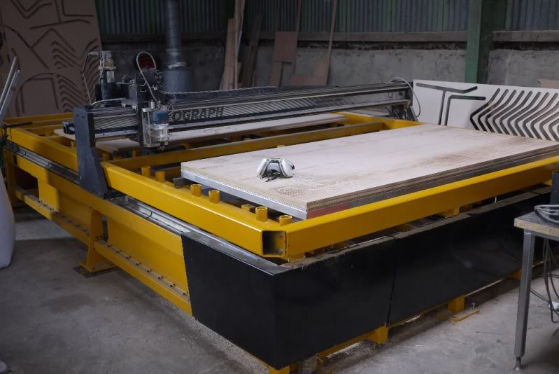

http://i59.photobucket.com/albums/g2...h/P1020811.jpg
Picture of machine taken today. Let me know what you would like to see and I will take some more.

Attachment 8183
This was as good as sold to a chap in Ireland but due to a change in his bussiness it is back up for sale. Would make a great machine for someone looking for a large bed machine as it breaks down easily into pieces to aid transport. Some of the heavy parts would still need a forklift to shift.
