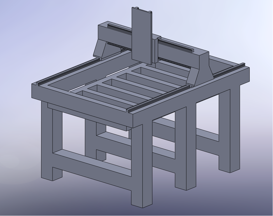

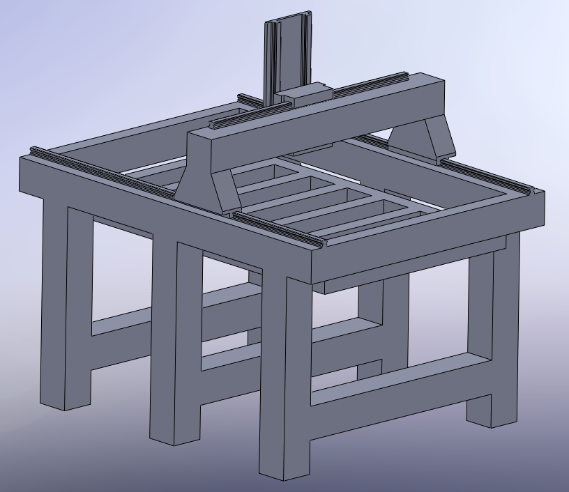

2 Attachment(s)
Re: New CNC Mill on the horizon
Right I have had an hour to play in solidworks so this is not very detailed its just an outline of the idea I am thinking of once I have ironed out any potential problems I will go in a bit more detail.
So once again 1200mm x 800mm bed current z axis 200mm ? good bad ugly?
z axis is based on 4 blocks sitting on a 200mm square footprint eg one on each corner of a 200mm square.
Adjustable bed for altering depths of material / things to machine.
twin ballscrew on the x axis, single on the y and z
concrete/ sand etc in the box section taken on board I will give that a go.
Attachment 6016Attachment 6017
fvfdrums
Ah so you've seen me mention sand before.!! Yes dry kiln sand works good and is easily removed.
Like the chunky frame look forward to the detailed version.!

I'd go for epoxy granite over concrete. Concrete moves/warps after it's set and since you're using profile rails any movement in the piece they're mounted to could cause serious problems. If the rail is bent ever so slightly the slide coefficient of friction increases dramatically, so if this happens over a long period of time you probably wont notice until the machine stalls due to the greater power needed to move each slide. By that point some serious wear could have occurred to various parts in the system.
Frame looks appropriately sturdy, but I'd be inclined to add some smaller box section to link the legs. It wont cost much compared to the rest of the frame and could help with resonance, since at the moment you have a large mass supported by legs (rather like a cow which wobbles a lot if you push it!)

Ye but seemed logical has I mentioned concrete and he added sand which I've mentioned and recommended many times in the past.!! . . . . But does it matter.!!
Personally I wouldn't go with Epoxy or concrete.!! Sand is cheap the concrete example was to make a point that heavy or dense is good.!
Epoxy is not a good solution either has the heat from the large qty of epoxy could and will warp the steel.!! . . .Plus the cost of epoxy it would be just has cheap to buy plate steel.??
Sands good with me likely hood is I'll need to move the machine at some point so the potential to "drain" some weight would be useful

Updated spec after current discussions:
1200x900 footprint area with approx 1000 x 800 cutting area
80x40x4mm steel box section frame with adjustable bed
Aluminium gantry made from a combination of 20mm/15mm plate either standard 6082 or ecocast for the bearing and guide plates
20mm Profile rail on x,y,z
**16/10 on x axis (running 2:1)**
16/10 on y axis
16/05 on z axis
250mm cutting depth on z
2.2kw chinese spindle
electronics (just ideas at the moment)
1 x nema 34 7.7nm running 2 x axis ball screws via a timing belt running dual 16/10 screws
1 x nema 23 3.1nm running y axis on 16/10 screw
1 x nema 23 3.1nm running y axis on 16/05 screw for better resolution
80v Leadshine Drives
75v PSU
Mach 3
How is this all sounding? are we on the right track :)
Design wise the gantry design is very similar to the one Jazz has posted on here before with interlocking aluminium plates (copying someones idea is the best form of flattery right? or is that plagiarism :P) anyway it looks an extremely solid design and I tend to make things over engineered so figured this was a good place to start.
With the y axis I was considering a direct drive using a coupler, all the other drives will use a belt to transmit motion, would it better to engineer it so the motors are all belt driven or would this make no odds?
fvfdrums
This contradicts the other.? If using 10mm pitch you won't need any ratio with 7.7Nm 34 and belt drive 1:1 will be fine.
fvfdrums
No don't direct drive keep the belts for resonance reasons even thou your planning using very good drives which handle resonance fantastic. If your copying the gantry I think then I've actually changed the design slightly and the Motor is now on the inside connected to screw with belt. It's very neat and compact. (code for F@#% tight fit.!!)
copy and paste mistake yes I mean 1:1!!
I was looking into that possibility and I think I must have guess the dims pretty close as I had exactly the same design issues but I think I can get it in!

after a bit of redrawing last night I had a thought that the fk/ff bearings (which I have just stumbled across) may be a better option for the x axis that the bk/bf ones. I am trying to determine the exact length of the ballscrew I need and cannot tell if the bearings in these units are flush to the back of the mounting plates or they are set in? does anyone have or know a link to some accurate tech specs for these bearings? Because the design of the axis uses a plate either end of the frame to sandwich the x axis ballscrew between two bearing units and I need to know the length of ballscrew I need to order otherwise there will be play or it will be over sized!
Alternatively if I were to machine up my own bearing blocks for the x axis, the floating end is straight forward, what does the fixed end comprise of? angluar contact bearings? sizes?
