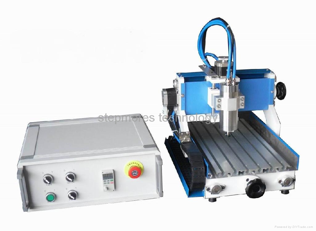

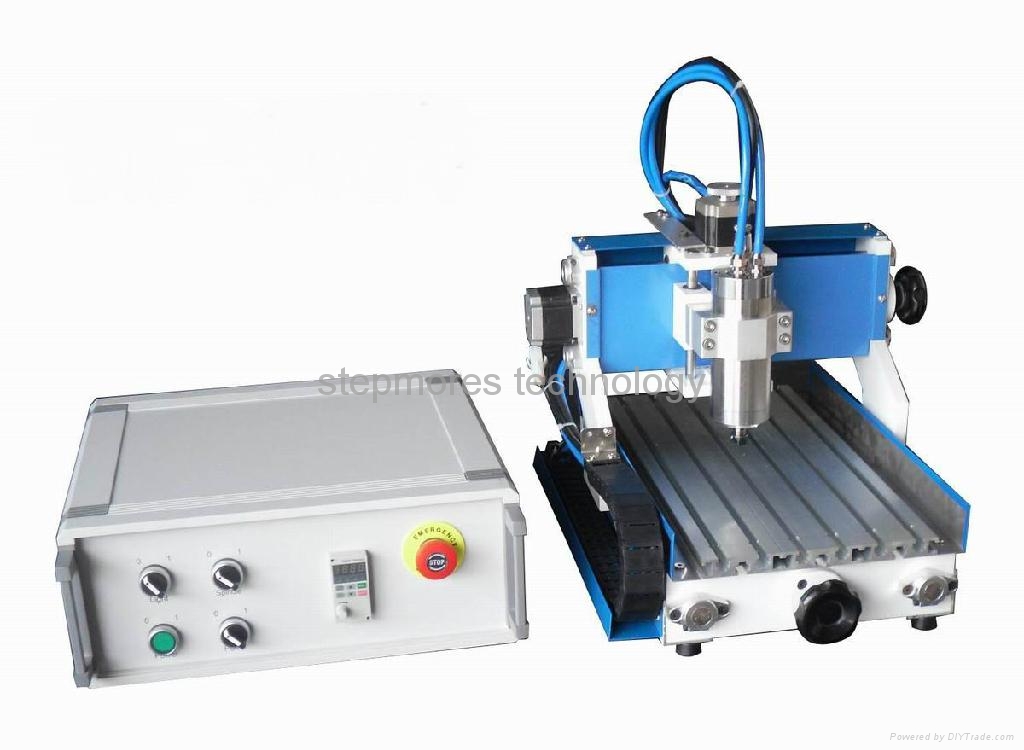

I have ordered my machine it is the SM variant of the CNC 3040, which has marginally better specs than most.
It is running 20mm rails and 16mm ball screws, 2.5amp steppers and a 1.5KW spindle(watercooled)
It has an offset gantry to make full use of the bed and extra supports, it also comes with a 4axis driver board.
The machine comes powdercoated to stop oxidization from the factory.
The machine cost was a total of £880 delivered, (plus import tax)
So far customer service has been quite good via MSN & E-Mail and whats nice is the sales lady speaks very good english too! (which isn't very common for most cheap exporting chinese companies).
I will leave it at this for now and update as i need required.

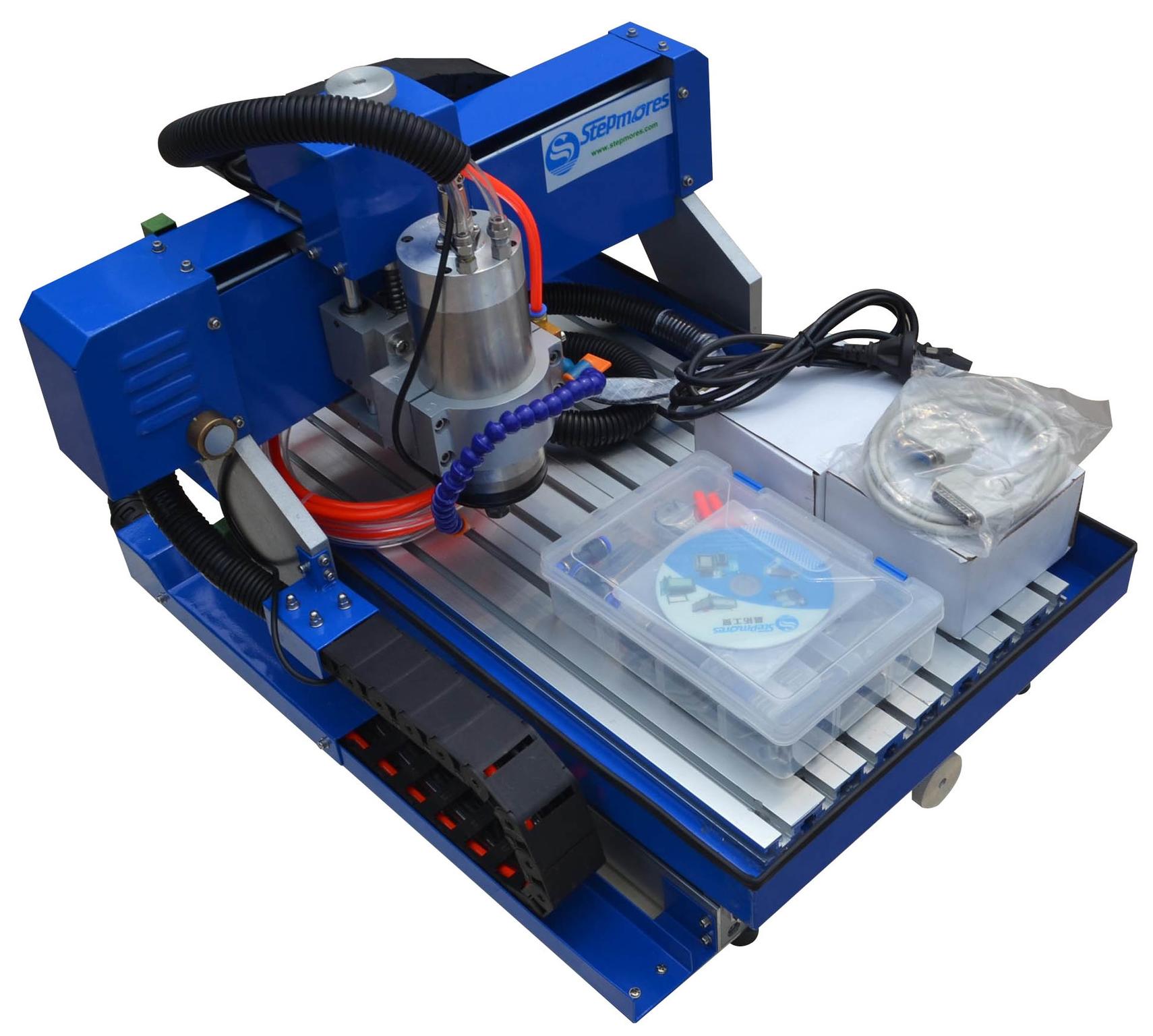

Stock photo
Attachment 6014

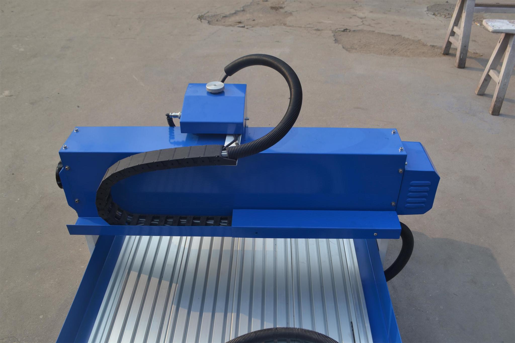

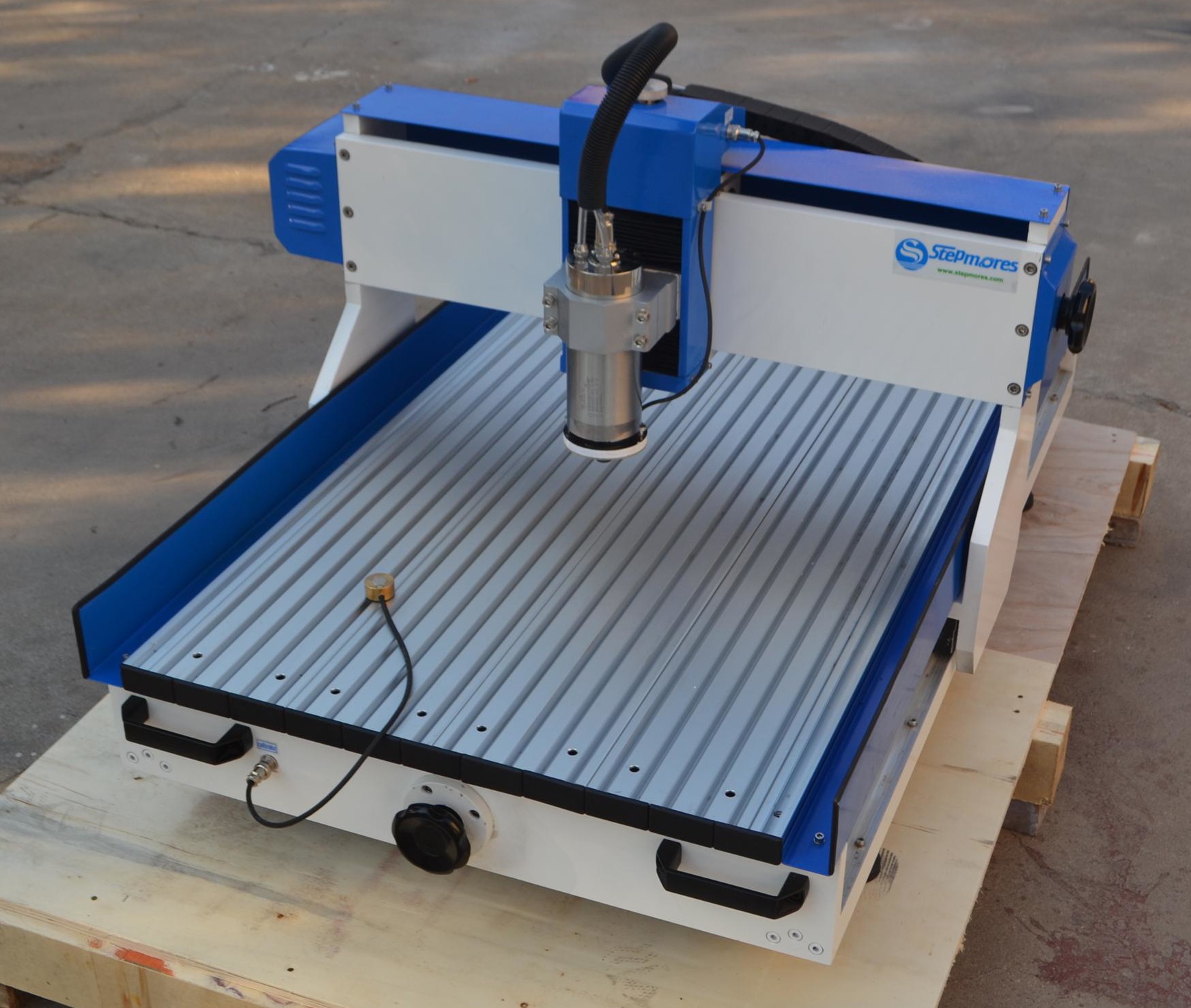

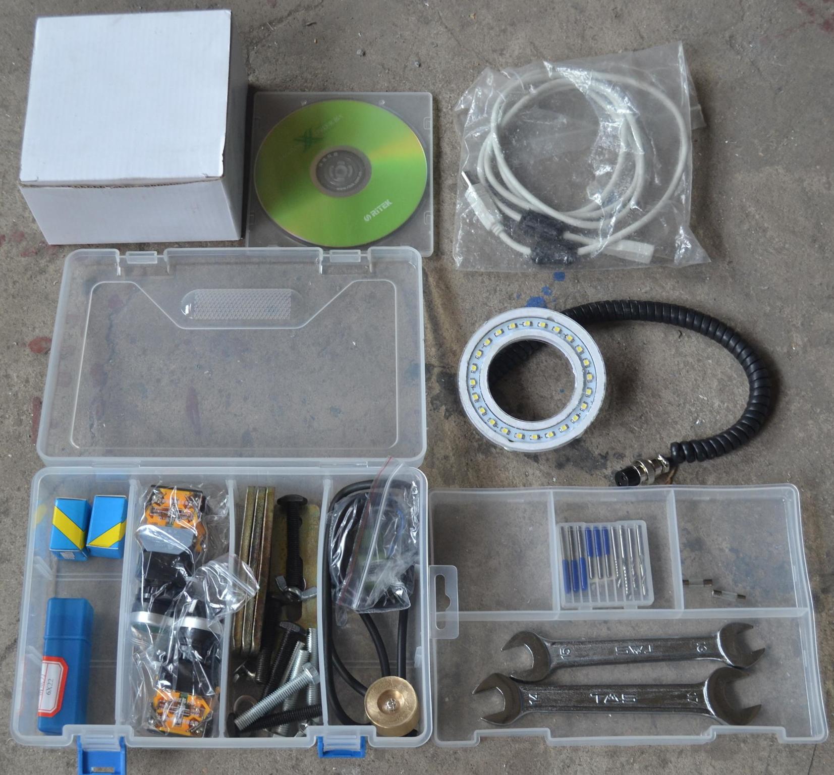

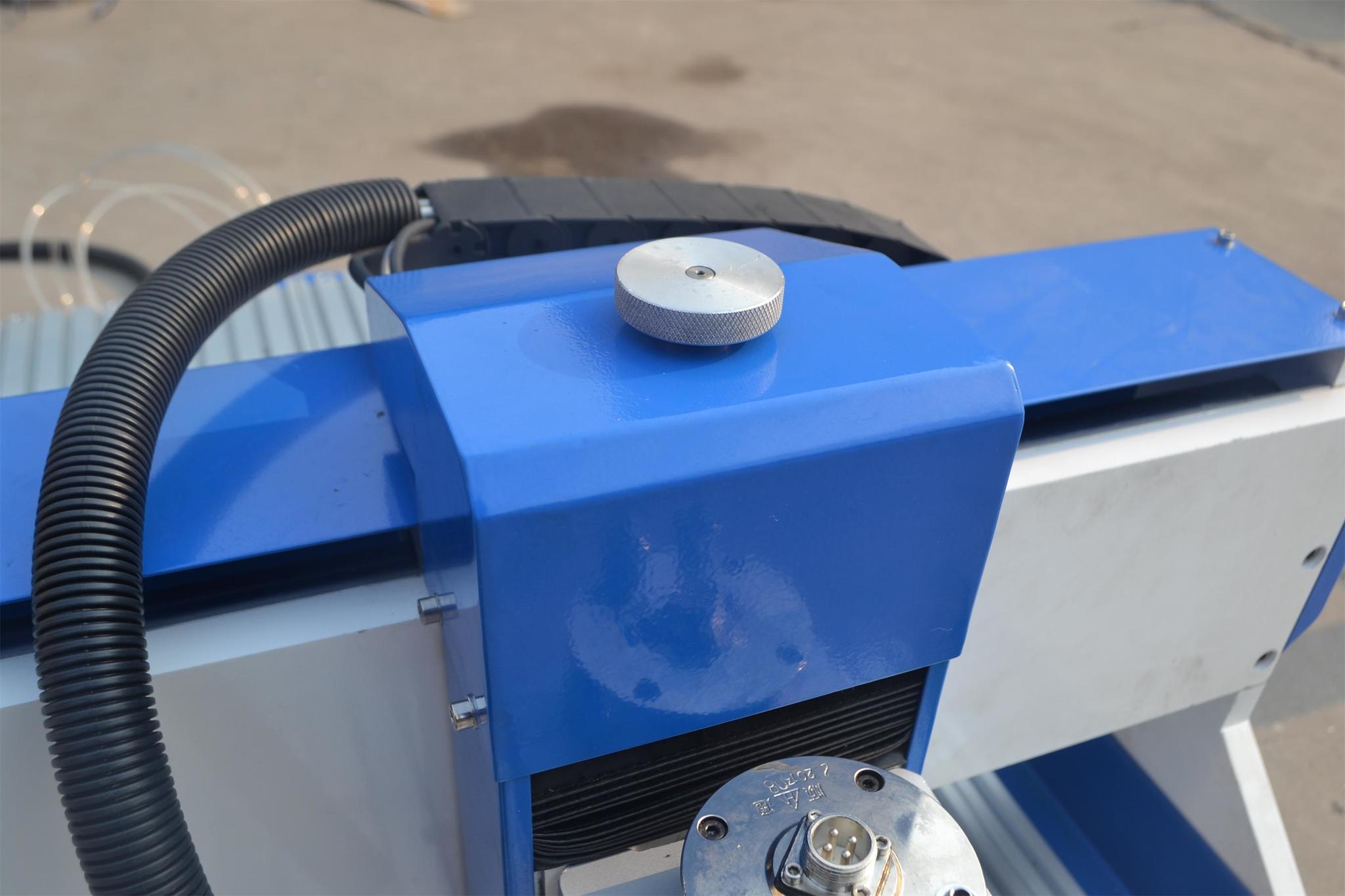

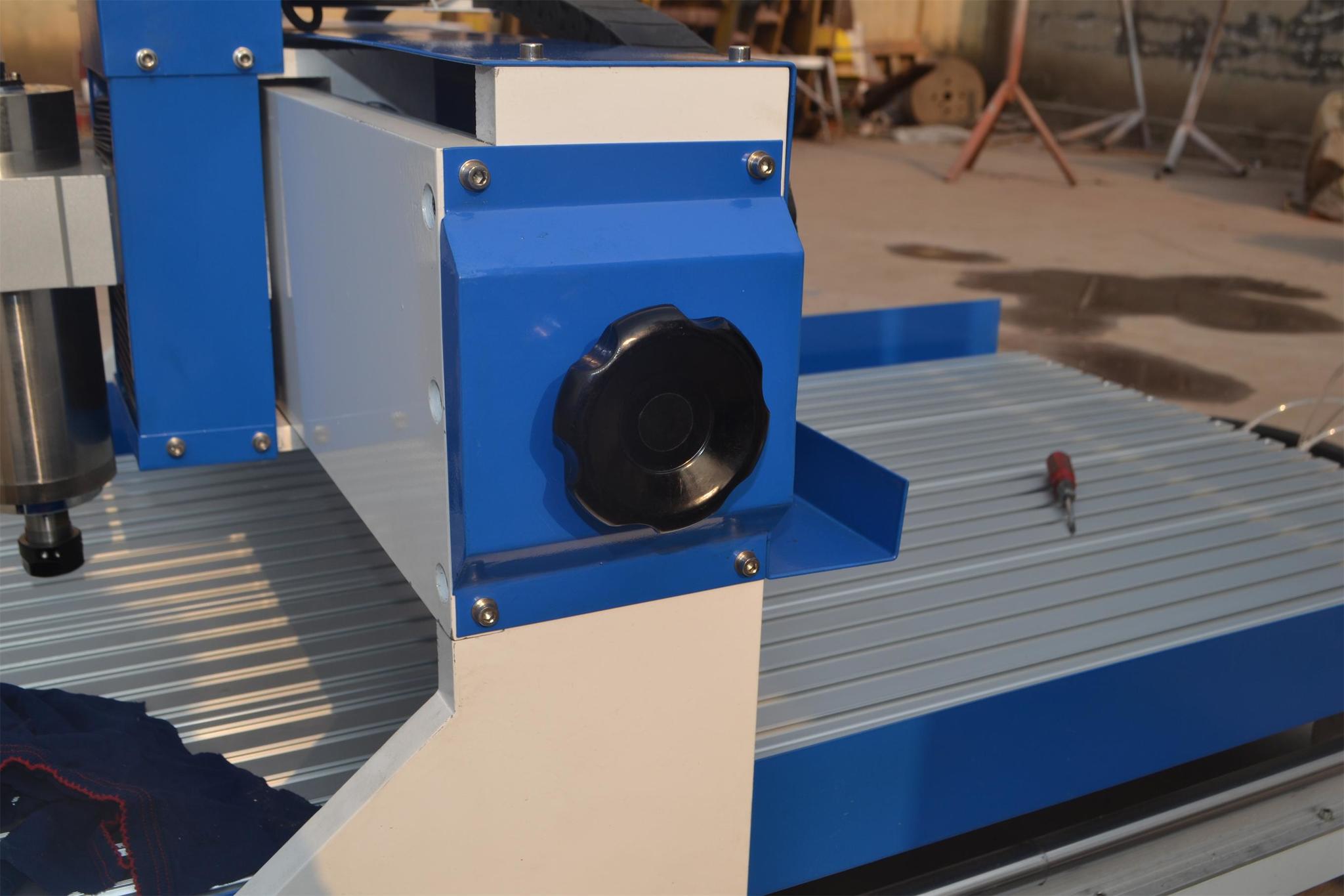

UPDATE:
http://i200.photobucket.com/albums/a...0529090600.jpg
http://i200.photobucket.com/albums/a...0529090601.jpg
http://i200.photobucket.com/albums/a...0529090602.jpg
http://i200.photobucket.com/albums/a...0529090700.jpg
http://i200.photobucket.com/albums/a...0529090800.jpg

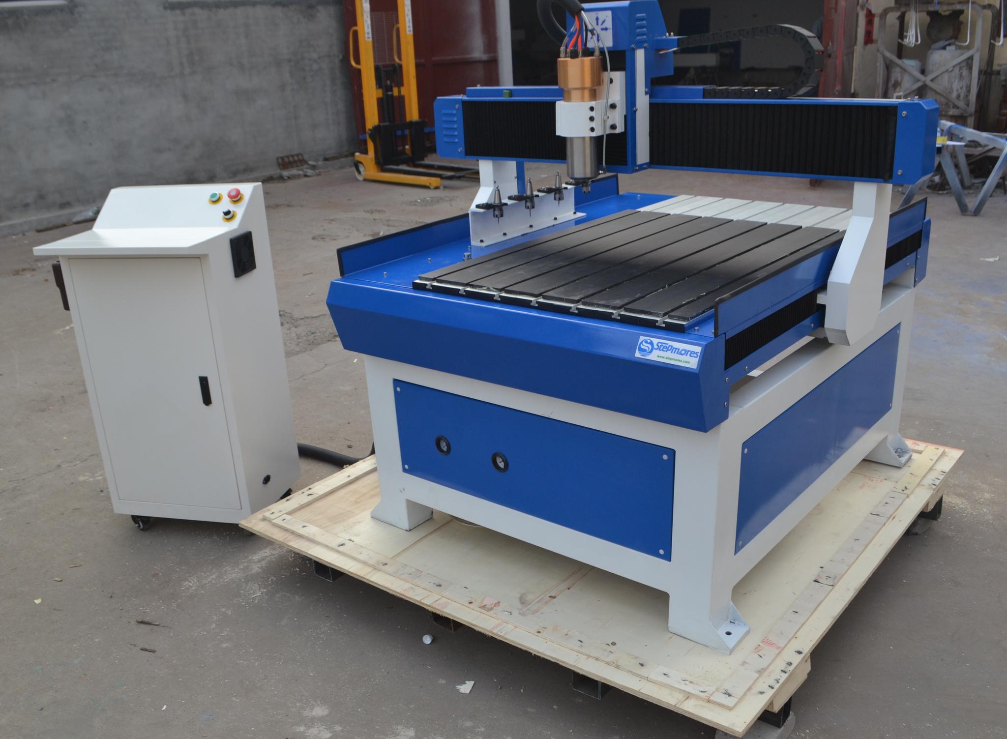

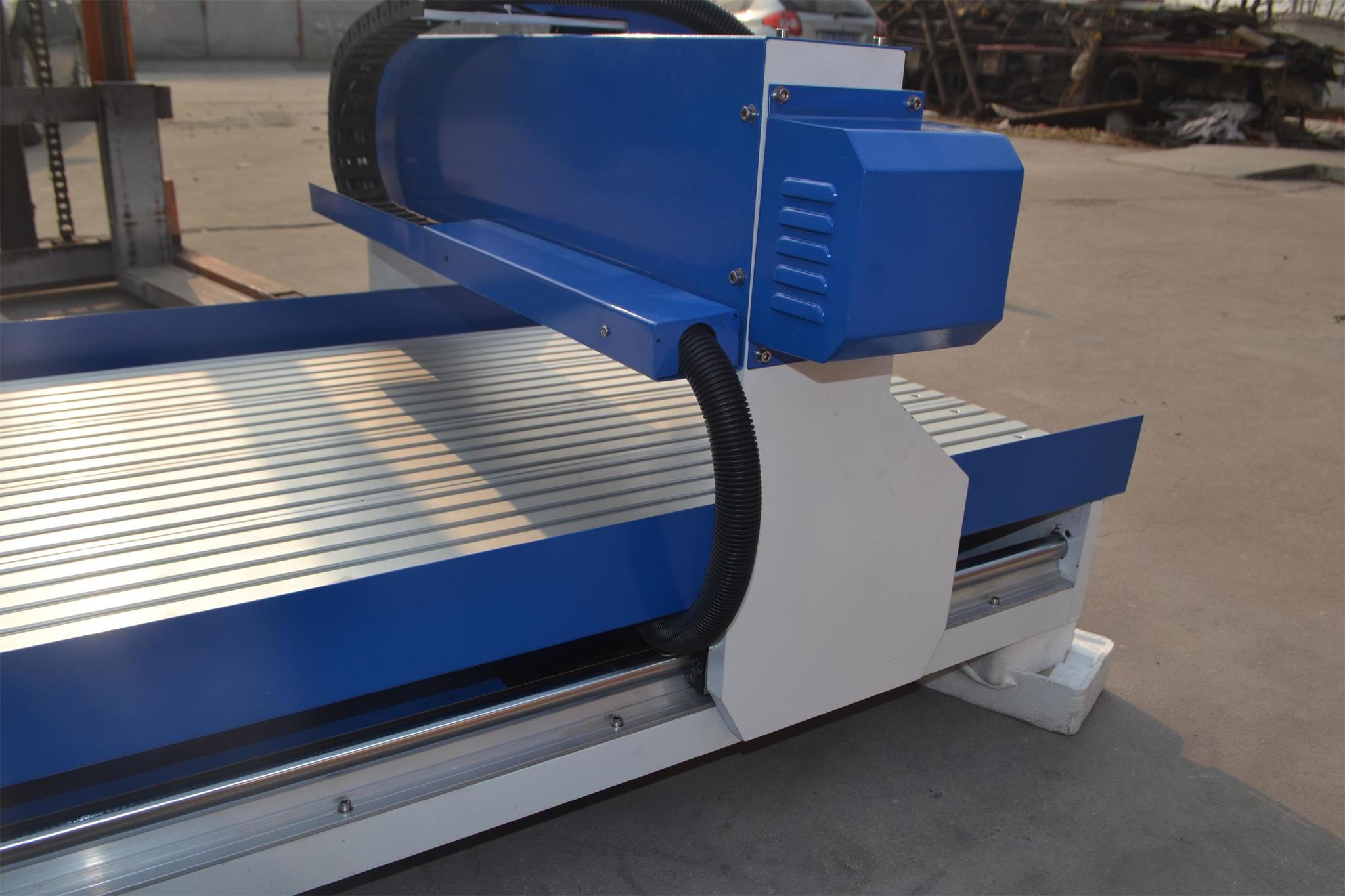

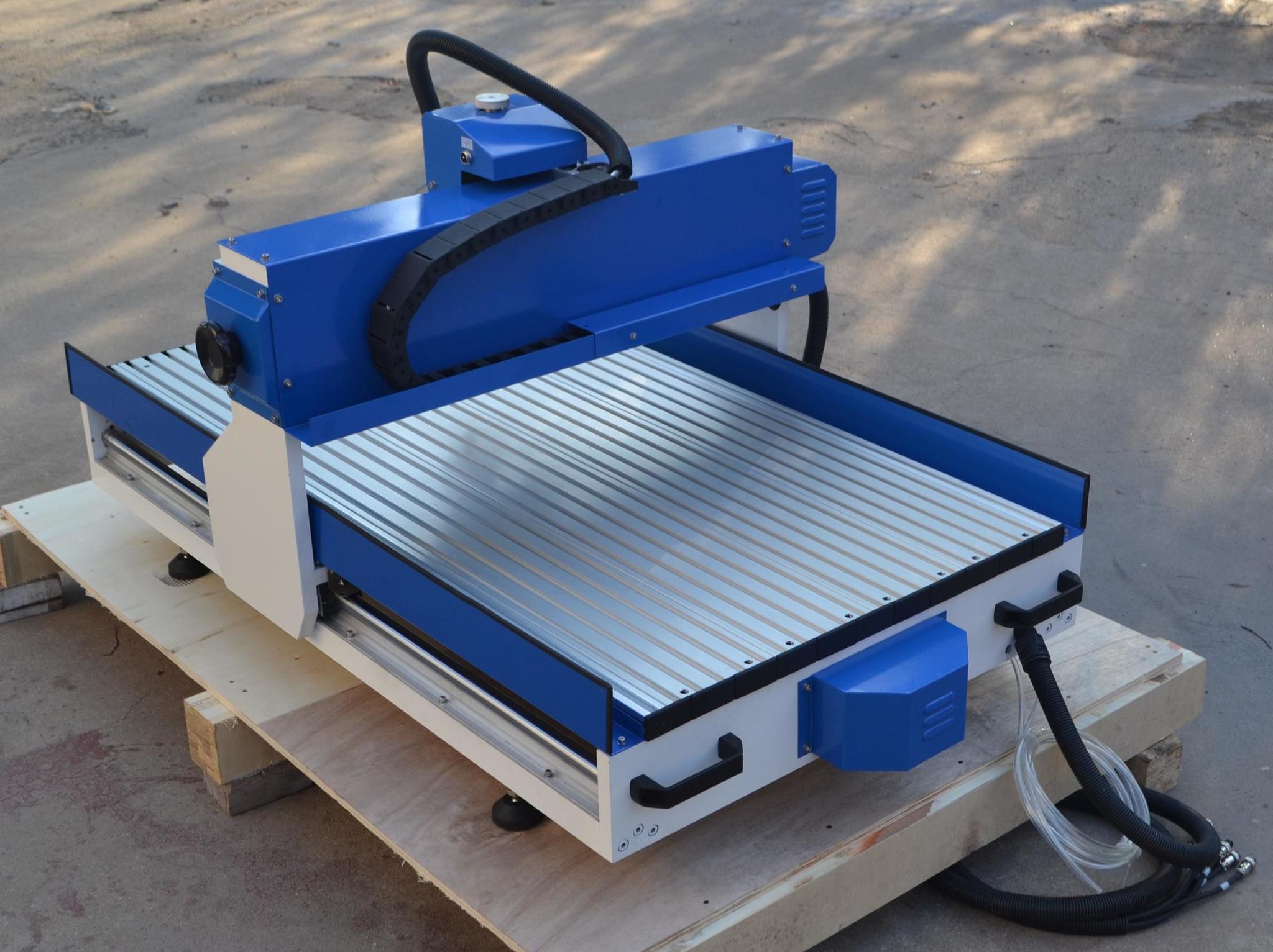

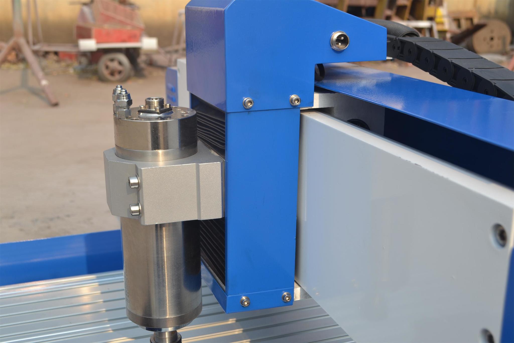

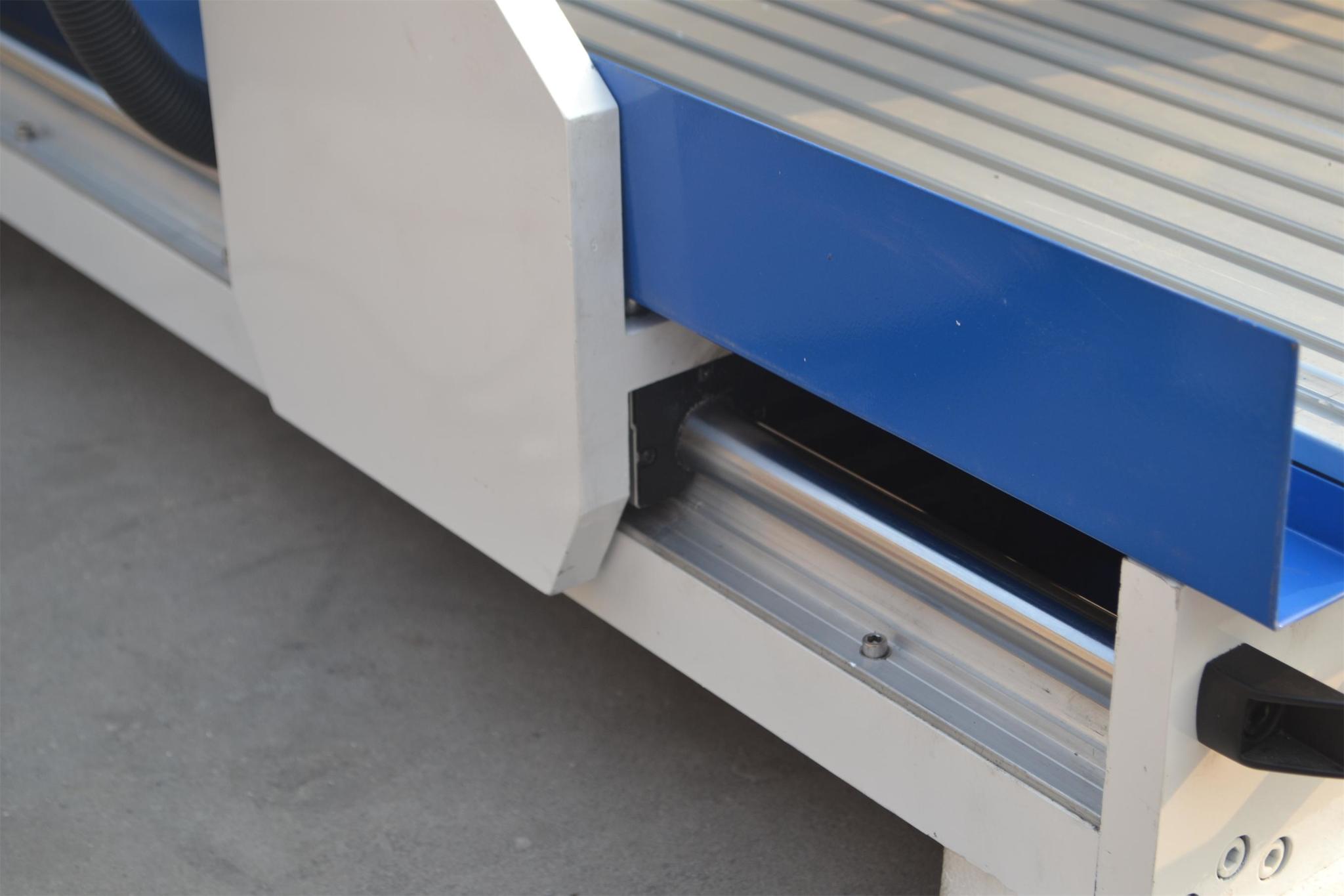

I have added an update to this machine, please check the bottom of first post.
The factory sent me 'build' pictures of my machine.
You can already see how much better, sturdier and feature packed it is over the ebay models.

It is, However Its not quite as high spec, You only get a 0.8kw with 6040 I got a 1.5kw Also i have 20mm Rails all around the 6040 is only on the Y axis.
Another bonus is that because of the laid back gantry and the subtle modifications the actual cutting size is 450x320 So its better than most which are UNDER their stated dimension.
Remember, mine has flood cooling and tub too, even came with the pumps and everything required for the full system.
The gantry rails are mounted much more securely with large 20mm clamps which are fully adjustable vs the 6040 rails which are just drilled & tapped with an 8mm screw
Another plus is the control box is of much higher quality than the typical 'eBay' models.

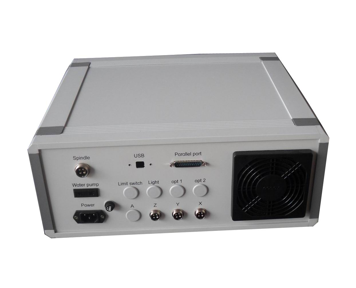

The controller board looks like a TB6560 (without a cooling fan!) and from what I read they're not very capable for Nema 23 steppers. Is this what you have as well? are they 23s?

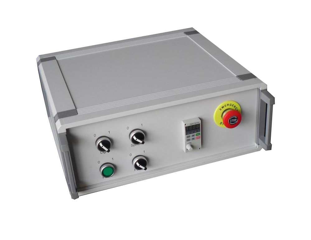

Do you have some pictures of the control box and did you had a look into it?
Maybe you can tell me if there is a label on the stepper motors?
Thank you for your help!
Greetings from Austria
Philipp
Re: Reveiw: Stepmores SM-3040 CNC Router/Mill
Hi there Phillipp/
The control box I can get pictures for you later on they are of a high quality compared to others.
I'v looked inside but only brief!
The steppers are blank with no labels sorry.
