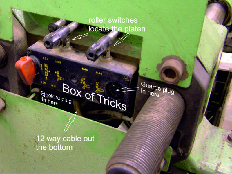

There's another idea out the window, I don't have the aux socket, it's blanked off. Everything seems to work fine, except it doesn't.
To understand it I took the guards right off and found 2 more gadgets to stop me cycling it with the guards open. A switch and an interlock that physically blocks the platen if all else fails. This machine is seriously paranoid.
It all comes down to one box of tricks with a 12 wire connection that covers most everything and I will need help to buzz it out, I haven't got enough hands.
With the guards off I went around all the bits and pieces figuring out what they do. It's much easier to fix something if you know how it works and the manual is not friendly. Now I understand it everything looks bleedin' obvious.
I was surprised to find the fixed platten isn't fixed at all, which explained why it has pipes connecting to it, it's got grease lines. If it moves before it should, the machine assumes something didn't eject properly and it would be a bad idea to insist.
Next. disassemble the box of tricks, buzz it out to the controller, make sure the guard switches are connected. It has 8 switches going to 12 wires, how hard can it be?

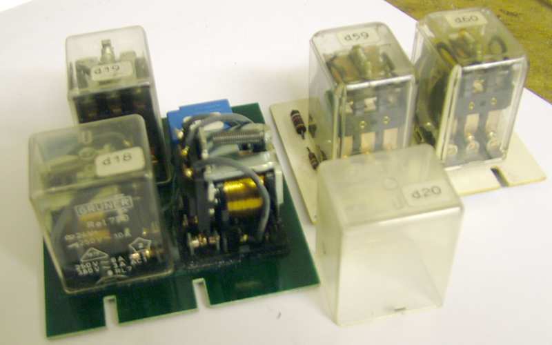

Still no reason why LED b20, guards closed, doesn't light. I took the control box apart and found a mess of TTL, this thing doesn't have a microprocessor. The control box has an input labelled b20 which lights the LED and does nothing else.
There must be another circuit board to nobble b20 somewhere in the cabinet which is an absolute rats nest of wiring. However, I now know which pin on the monster plug control box plug goes to b20. Armed with that I should be able to find this mystery board and see which of it's inputs is failing to light b20 and enable the hydraulics.
When I plug/inplug the shorting link on the optional core retract guard socket I can hear a relay click, so I am probably looking for a board with relays on it.

Hmmm!

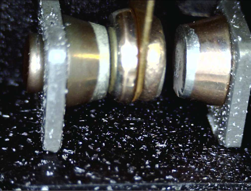

Found the safety guard circuit relays and they are truly unwell. I'm looking at 6A 3 pole c/o relays and only 2 out of 9 normally closed contacts actually buzz through.
Close up piccy shows they are full of gunge, probably plastic residue.
This isn't arcing causing the problem, most of the nc contacts aren't even used. These 6A relays drive nothing more than other relays or LED's.
Next problem, they are archaic, not listed by RS, Farnell or Rapid. Do I try and clean them or bodge in equivalents???

Found the relays on ebay but then I drew out the rest of the circuit.
I've never dissected a commercial guard controller before, curious stuff.
There are 4 switches tripped when you close the guard, they pair up and close 2 relays. When both relays are shut the guard is accepted as shut.
A third relay closes when you open the guard, this relay has to stay closed for normal operation.
As the other two relays close they cut the third relay back to a holding current. If any guard switch opens momentarily relay number 3 lets go. If the switch should close again the holding current isn't enough to reset it.
Basically, lose any guard switch and you have to open and close the guard before you can restart the machine.
The circuit is dependant on the holding current so changing relays seemed like a bad idea. I had to clean the contacts.
If it plays up again I will rework it and drag it in to the 21st century.
