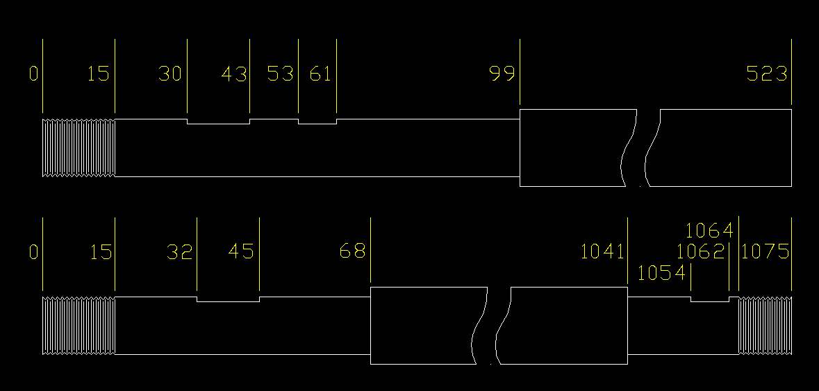

Took a while but here it is, can you make 'em?
16mmx5 screws with your anti backlash double nuts.
Threads are your usual M12x1, flats are 1mm deep.
I'd like 12mm ball races to slide on by hand, not tight. Other tolearances are fairly slack, shall we say .25mm :beer:
best regards
Robin

Yes we can make them, but to get zero backlash they will need to be made at the factory, and will be a long delivery.
Also how come you dont have a floating end? you have the lower screw fixed at both ends?

Out of interest what are the flats for? Are you fixing the ball screw and turning the nut?
Also 0.25mm is going to be very sloppy on the bearing and may cause you problems?

The shorter screw is the mill Y axis, can't end support it without cutting lots of iron out the way.
Re: Ok, I'm stumped. Question for Gary (ZAPP)
On monday i will draw it up and send the drawing to the engineering company to get a price.
It looks quite easy so i guess the price will be quite similar.
Email me your details and i will respond over email with the rest.
Delivery time will be about 2 weeks i think.

The flats are for the grub screws that lock the pulleys and handles in place. The nuts hold tension against belleville washers I wouldn't want to rely on them to grip anything.
The tolerance does not apply to the shaft diameter, that wants to be a nice sliding fit. I'm sure you can do better than .25mm anyway.
