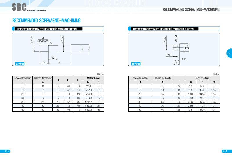

Re: DIY Build of Aluminium CNC Wood Router without Workshop & Tools
Does anyone perhaps have a legible dimension data sheet for Chai's 1610 ballscrews?
I have a copy off eBay but these old eyes canna read the dimensions even after sharpening and increasing the image size.
Particularly interested in the BK12 and BF12 bits.
Thanks,
Here's the end-machining drawing I got from Chai a couple of years ago:
Attachment 6490
Which dimensions do you need from the rest?

Thanks Jonathan. I had already saved those up off a previous post of yours I think.
Jonathan
I'm after the size of the BK and BF support blocks, and particularly the dimensions from the centre of bearing to each of the edges. My current design looks like too tight a fit for these blocks, so would like to know what I need to cater for.

Found the dimensions I needed for the BK12 and BF12 mounting blocks.... they are 60x43 and the bearing centre is 32.5 from the base. So just the one remaining query:

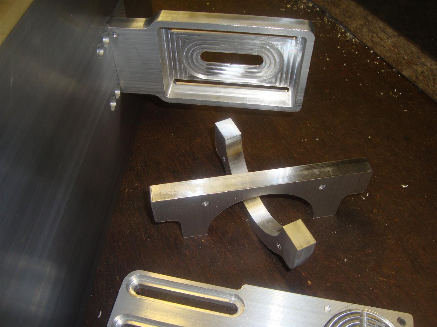

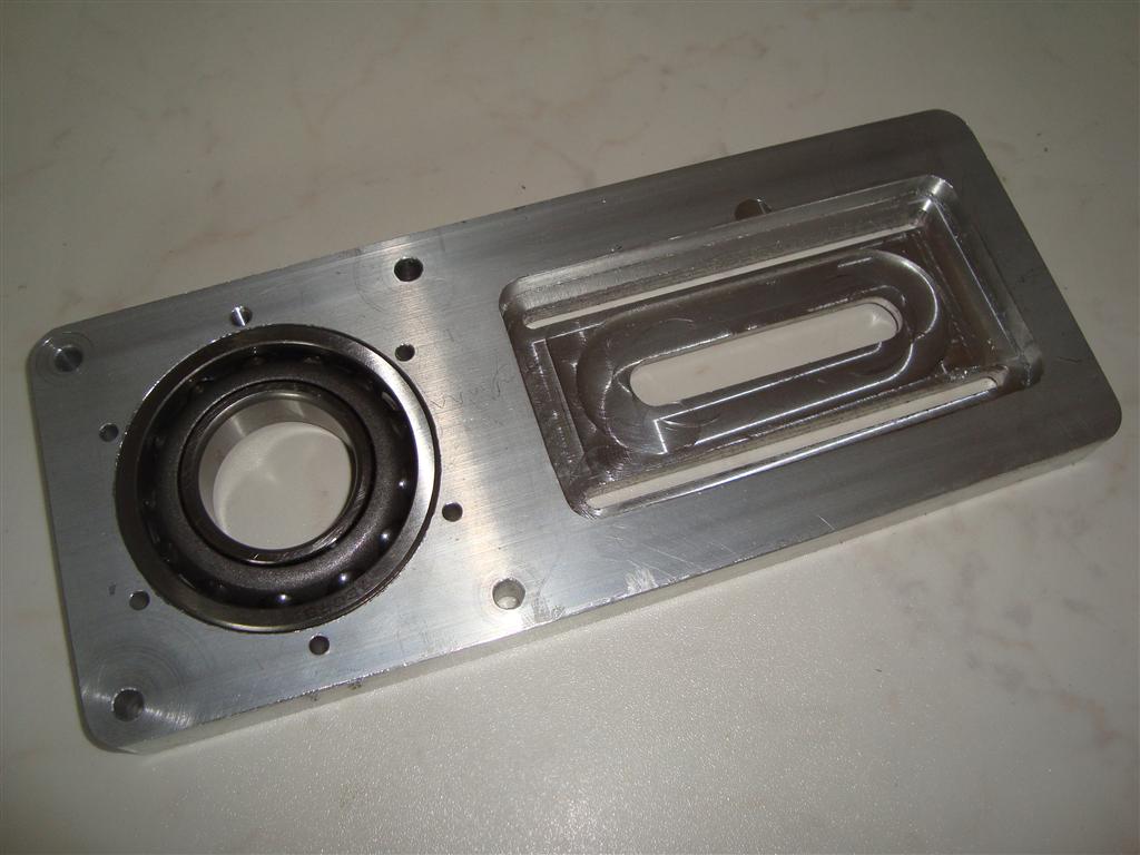

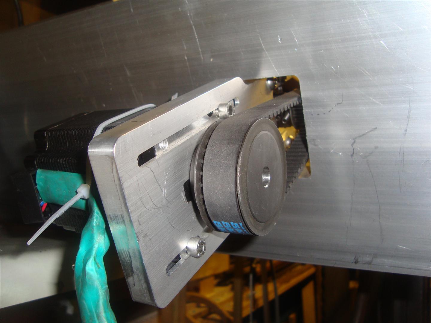

3 Attachment(s)
The BF side bearing is only there to stop the screw whipping which does not require particularly great rigidity in the mount. This bearing should only be subject to radial forces, so as long as the mount is strong enough in the Y-Z plane it will be fine. I would make it a bit stronger than you have currently drawn, but wouldn't go so far as replicating the other end mount exactly - you can save a bit of material.
If you're buying the Hiwin rails new then there's no need to get 20mm for this size machine - 15mm is perfectly good for the vast majority of CNC routers. This could help with making the Z-axis more compact. If however you find the rails cheap on eBay then by all means use the larger sizes. You shouldn't have much difficulty finding a good deal there at least for the shorter rails.
As irving's said, recessing the motor mounts is an easy strong way to get round the short shaft problem, here's a few examples:

Thanks Jonathan... Pics really help visualise things... Looks to me like those mounts are milled down to about 3mm? Have you noticed you're missing a bolt in pic-1... or is that one an optional extra... Lol
Yes something like that... you don't need much thickness if there's plenty of material around the motor mount surface to stop it bending. I missed two screws in that picture as it was just a test fit.

Two quick questions please -
- Apart from asking Chai to machine F increased to say 30mm for coupling, does Chai grind the small flat on the shaft for the grub screw to grip and stop the pulley spinning or is that something I would have to do?
- Are M4 grubscrews about the right size for 8-10mm diameter shafts?
No it's DIY but turned portion is soft so a decent file and it's done in 2mins
