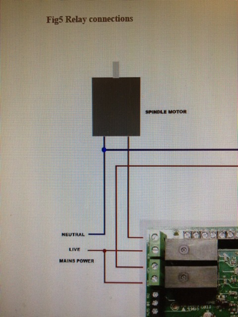

What spindle is it.?
The uniport can only turn the spindle power on/off by using the on board relay it can't control the speed. You need a spindle speed board to do this and even then it can only be used if the spindle has variable speed controller that can accept analog 0-10V to control speed. Vfd's have this option thats why I asked what spindle.
Thanks for the reply Jazz. It's the chinese spindle with the VFD, sorry I can't remember the brand but begins with an H lol (truth is I dunno how to spell it haha)

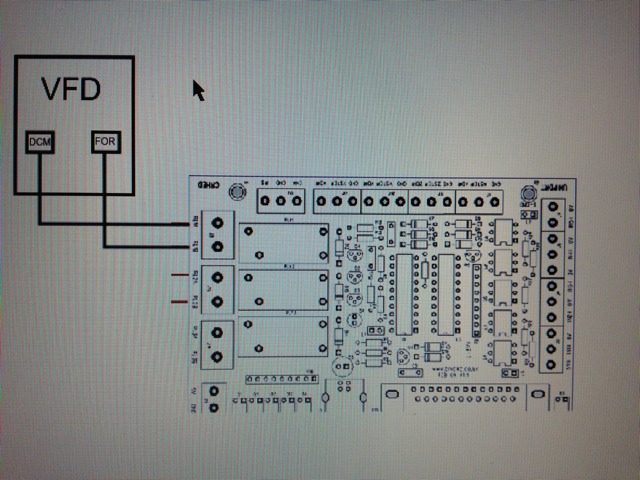

Haha yeah that's the one ;-) so I defiantly need a spindle board? I thought I may of been able to switch on via the uni as the instructions on the manual of the uniport don't mention the spindle board just the pic Attachment 6408
Might work... but the inrush current of the VFD might be too much for the relay on the board... its could be marginal I reckon with a 2.2kW spindle. Also it is very bad practice to start the motor by switching on the VFD! You could probably, and more safely, use the relay to control the 'soft start' input on the VFD (might be labelled 'RUN' input). Then you will have to turn the VFD on and set the speed before pressing Start on the PC...
Could you give me an idea how to do this? Is it just the case of finding the wire which enables the run command on the VFD? And wire that to the board as in the pic?
Had a word with a mate and between us think we have sussed it but give me 30mins to explain or write how to do it. It's easy thou I think.? but without vfd you'll have to do the testing.!!
Top guy(s) appreciate it!
Please make it read like a child's book as I'm new to all the electrics malarkey haha
Ok here goes.!!
Wiring first.!
Take a wire from the DCM terminal on VFD and run thru the normally open (NO) contact of relay one(No1) on uniport and return to the FOR terminal on the VFD.
VFD Setup:
Set PD01 = 1
PD02 = 0
PD44 = 01
The speed or frequency will need to be set manuely using the key pad.
Mach setup.:
Port & pins - output signals-output#1 = port 1 pin 16
Spindle setup - relay control- untick check box
Spindle setup - relay control- clockwise (M3) output# = 1
Spindle setup - relay control- CCW (M4) output# = 2 (but wont be used)
That should be it.? You may need to toggle the active high/low in output #1 if the relay turns on when it should be off.
Then when mach see's M3 in the code it will turn the relay on which in turn lets the signal from DCM thru it's contacts to the FOR input starting the VFD untill the signal drops then it will turn off.? This will be done when Mach see M5 and turns the output off which in-turn shuts the relay off and signal drops to the VFD.
Hope it works.? ( If it does then you need to thank AudioAndy not just me.!! . . . If it doesn't work then it's all Andy's fault. . Lmao)

Is tho correct I'm not sure what you mean by the normally open (NO) Attachment 6409
ok Jazz i will try that tomorrow afternoon when i get back from Scotland and let you know how much smoke my VFD makes :p
Thanks a lot guys!!
Hey Jazz, your "tutorial" worked perfectly!! Thanks a lot!!
