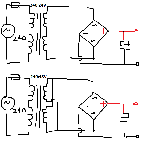

Couldn't find it either, so just drew this:
Attachment 6345
(next time I'll find the mouse..)
Top one if you get 24V or 25V transformer (preferable), lower one if it's 48V or 50V. The capacitor needs to be 10000uF minimum, ideally a bit more so three of these in parallel is good (assuming you get transformer from Rapid, otherwise might be cheaper elsewhere, eBay, Farnell etc). This bridge rectifier is good as it wont need a heatsink. So about £60 in total...

I am also thinking of making my own power supply and have no problem building the circuit, but a few questions about design. How accurate are the secondaries in a transformer? I'm asking to see if there will be any premature failure if they are not equal, from one coil working harder than the other. Which is better to connect the secondaries in?, series or parallel as both 25v and 50v are available from many suppliers.
I will be using pm752 drivers which I've had lying around for 2 years. Their datasheet says typical voltage is 48v and max voltage is 75v. In another post I read Gary saying to Jonathan that 72v from a toroidal supply is bit on the high side for the pm-752 driver. When I do the calculation 50 X √2 I get 70.7v. Is this the output I will be getting or are there other factors which bring it down by a few volts.

Iwant1
That's precisely the reason I said '24V or 25V transformer (preferable)' in the previous post. Wondered if someone would pick up on that :)
If they're not equal then more current will flow in the secondary windings, but I don't think it's likely to be a big enough difference to cause failure.
Iwant1
I remember that one, to which I replied saying I'd checked the actual voltage at the MOSFETs and the spikes on switching were well below their rated 100V so I was happy to do it. That was with a 25+25V transformer from rapid, with the same PM752 drives from Zapp.
70.7V is correct, but the diode will drop about 1.1V, so more like 69.6V. However the mains voltage does have a fairly wide tolerance. It looks like those transformers output 50V with 230V on the primary, however the mains voltage could be 240V (depends on numerous factors). That would make the output voltage 240/230*50*√2=72.7V... still less than mine which has been fine for a long time now. You could always add a couple of turns of thick wire out of phase to reduce the output voltage, but crude but it works...

Think I should say that if you choose the top pic Jonathan drew you will be getting double the voltage of the 2 secondery ouput ratings IE: 2x24=48V but only half the rated Amps of both seconderys but if you wire have 48V seconderys and wire parallel you get the same 48V but double the amps.
No difference really has lower voltage seconderys have higher amps, roughly double, if the higher seconderys are double the voltage.!! . . . So 2 x 24Vac 12A seconderys can either give 48V @ 12A wired series or 24V @ 24A wired parallel. . . . So obviously 2 x 48Vac 6A seconderys wired parallel will give 48Vac @ 12A.
The 48Vac when rectified to DC will give roughly 68V IE: 48Vac x 1.4 = 67.2Vdc

JAZZCNC
[yada yada]
48Vac @ 12A.
Didn't see the point of that...In short, the power has to stays the same, hence why I specified what power transformer to get as then so long as you wire it for the right voltage, the current will be correct by default.

Jonathan
Yep but I find folks under stand better when it's spelled out and the difference known.? He could have been wondering why or how 24V could give him 65+V.?
