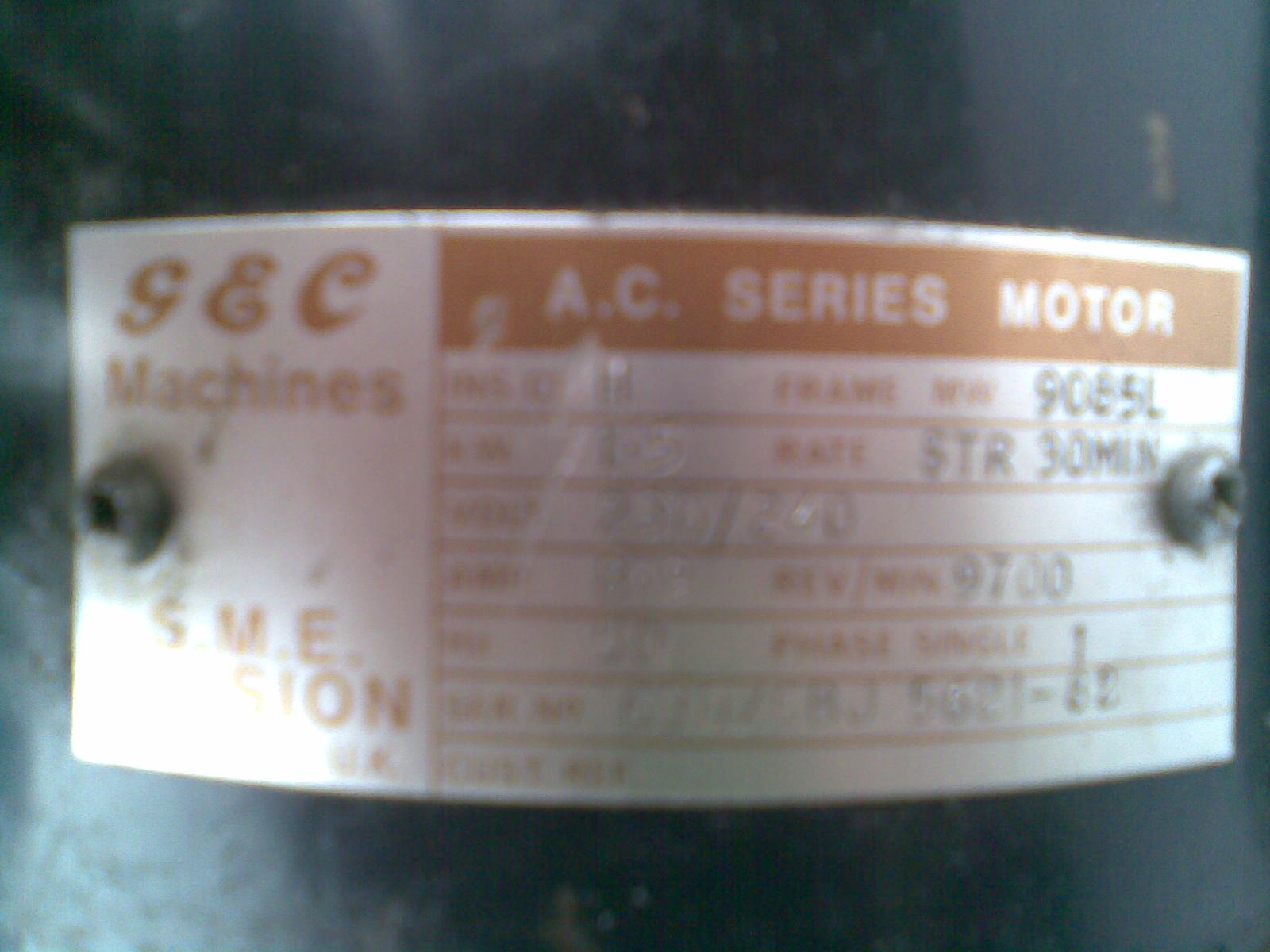

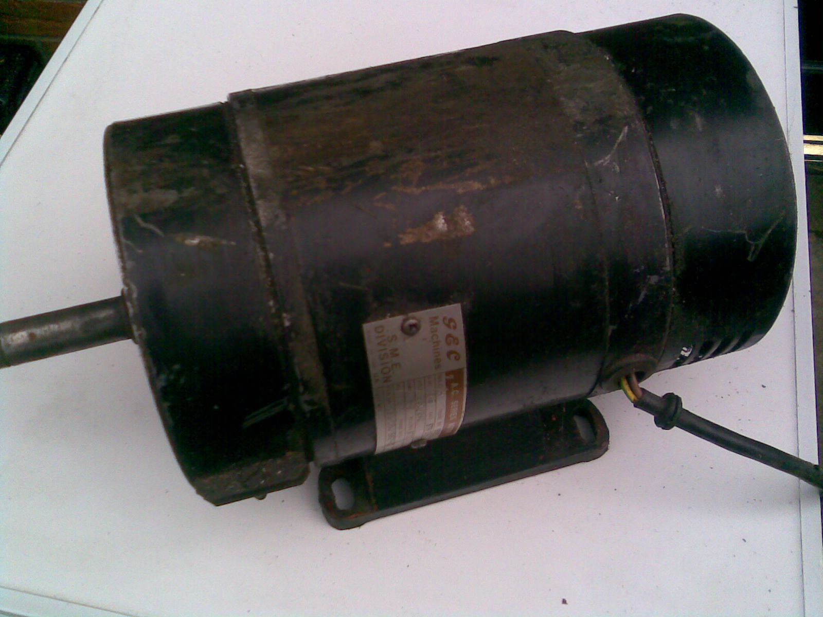

2 Attachment(s)
Re: mystery motor??? what is it for???
well... here are some pictures of the motor in question
picture quality isn't great as the only camera i have is my trusty but outdated nokia 6300
Attachment 6393Attachment 6394

just noticed that the pic of the spec plate is indecipherable so i wrote down what it says
G&C machines
S.M.E. division
made in the uk
AC series motor
INS. CL h
KW 1.5
VOLT 230/240
AMPS 8.9
HZ 50
PHASE single 1
REV/MIN 9700
RATE sfr 30 min
FRAME 9085l
SERIAL NO. 630 cbj 5621 82
It'll be some kind of commutator/brushed motor, not a standard AC induction motor.

It sounds like a series wound ac motor / universal motor?
open it up, so see it the armature and the field are wound in series?
Not seen one for years.

Since its limited to 30min operation, I'd hazard a guess at some sort of cooling/pumping/extraction process.
I have been looking around at some motor specs on this but cant find that exact one. It looks like a universal motor going by the speed rating. Probably for some sort of power tool.
