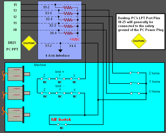

Wiring home and limit switches
Wiring limits and home switches can be handled in a multitude of ways.
But first you need to know what software you plan to use before deciding on a method. Typically limit switches have both normally open contacts (NO) and normally closed (NC) contacts. Depending on how you want to wire you can wire them in series or parallel with other switches.
http://www.mycncuk.com/images/dump/l...imitswitch.png
http://www.mycncuk.com/images/dump/limits/Nop.png
http://www.mycncuk.com/images/dump/limits/NCS.png
For example, CNCpro utilizes one input pin for each axis. Commonly that one input pin is wired to two fixed switches, one for home and the other for limit. It could also be used with one switch that moves with the axis and either via ramps or mechanical triggers actuates at the travel ends. Home is defined by the software setup as to which direction the axis is traveling when the switch activates. When using stepper motors, there typically isn't a need for more than two switches per axis. Servo's on the other hand, may need two dedicated limit switches to protect from a open loop failure causing a run away servo.
MACH3 software is very versatile and can be configured in many different ways. A common way is to have a seperate home switch for each axis, and one pin to all of the limit switches wired in series utilizing the normally closed contacts.
Below is two methods of wiring limit, home and kill switches. By utilizing a series wiring of normally closed limit switches, when one switch opens it sends a signal to the computer to stop issuing step pulses to the axis drive motors. In parallel, you have to use normally open switches to sense a switch activation. The top drawing utilizes independent normally closed switches for a home for each of 3 axis and is more compatible with MACH3. The bottom is another method to do home switches.
Utilizing normally closed switches is more noise immune, and thus reduces the risk of false switch actuation. The other noise benefit from utilizing NC contacts is coupling noise back into circuits and wiring for step/direction motor controllers.
http://www.mycncuk.com/images/dump/l...h_wiring_3.png
http://www.mycncuk.com/images/dump/l...h_wiring_2.png

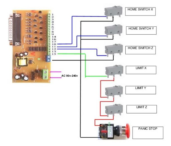

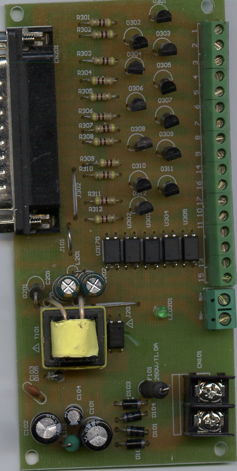

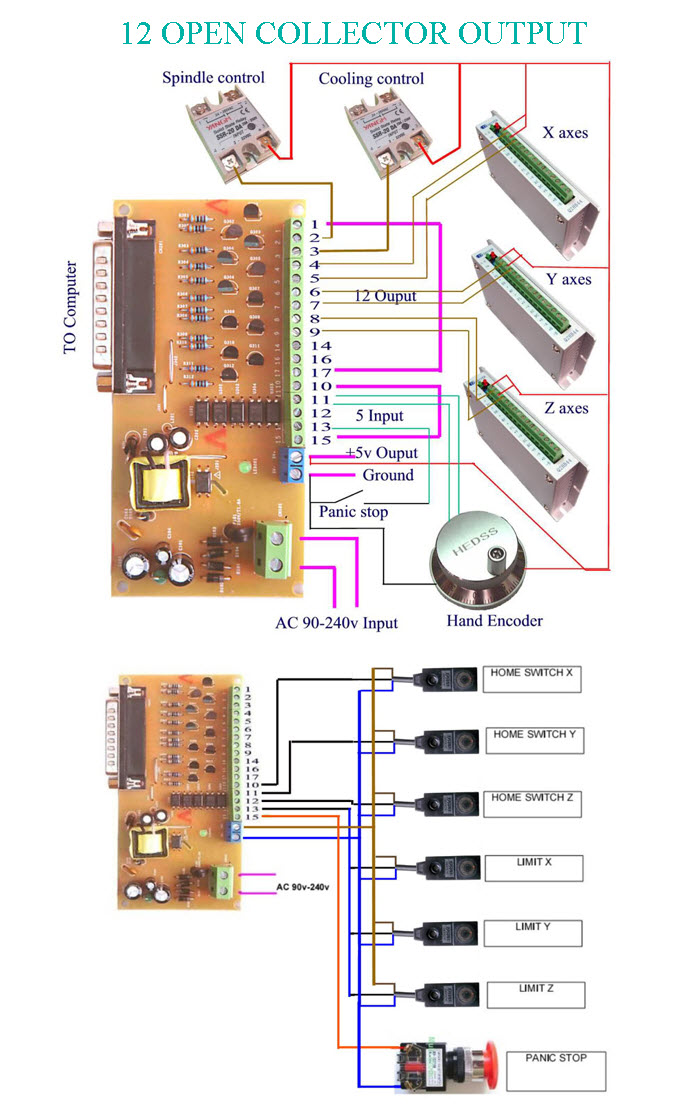

Hello Lee - I have just seen your wiring diagram and thought you might have a view on the following
I have just started getting the equipment together to add limit/home switches to my machine, and have found the following diagrams
Attachment 3143Attachment 3144
The first has three wires running to all switches while the second has a serial connection to the switches which includes the emergency cutout. I can see how the second works , but am unable to see why the first has the three wires. - The connection board is the same as shown :
Attachment 3145
Are you able to comment on this set up and how it compares with your diagram
Would apprcieate anything you have to say
Ken
Re: Wiring home and limit switches
The reason is that the inputs to the board have to be switched between 0v and +5v. generally the inputs are pulled up to +5v by a resistor on the board and the switches then short the input to ground. An alternative approach is to use both poles of the switch to switch the input line between a 0v wire and a +5v wire. This is how the home switches in the first diagram are wired, as individual inputs. But the same approach is used for the limit switches in the lower part of the diagram and this is just wrong... in fact the way that is wired when one limit switch is activated it puts a short from 0v to +5v, which will probably have the effect of stopping everything but for the wrong reasons.... I would ignore that and go for the single chain of switches. However I would seperate the PANIC switch from the limit switches. A panic switch should always control a relay which supplies power to the motors. That relay MAY have a contact that does the panic input to the breakout board and thence to MACH3 as per these diagrams... one should NEVER rely on MACH3 to stop the motors in an emergency, the panic switch should always act directly...
Thanks Irving - I di think that the kill switch in series with the limits looked funny - effectivley actinas another limit switch and relying on the catches in the switch to keep the power off (dangerous if it failed.) so the second diagram (without the kill switch at present is the next step) - going by the other suggestions in this thread I should use NC contacts. The Home switches look like they are using separate connections with the board numbers mimicing the port outputs.
For the kill switch - would I be OK fitting that to the mains side as a breaker to cut all power to the controller and motors and leave the PC on.
Yes the normal arrangement is to use a contactor with a low voltage (under 50v, typically 12 or 24) relay coil. The contactor is normally open, and you close it manually which energises a small transformer which provides power to the contactor coil via the kill switch, thus holding the contactor closed. Hitting the kill switch interrupts the power to the coil causing the contactor to drop out. This arrangement prevents it being re-energised accidentally in the event of a power failure. You have to manually close the contactor and it wont stay closed unless the power is on.

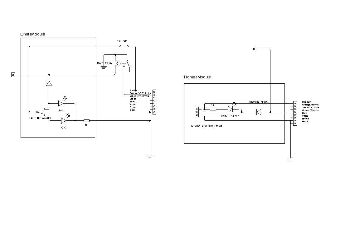

I got a bit annoyed with my machine stripping the delrin on the Z axis, so I decided to put limit switches on it. At the same time I put a couple of extra home switches to give home and limits on X++, X--, Y++, Y-- and Z++. While I was about it I put in status LED's (C'mon it's my toy :thumsup:)
The Limits had to go on a second BoB that I had that worked on 5v, so I basically OR'd each module to operate a reed relay, to give a Ground signal to indicate a limit switch had been triggered.
My main control board worked on 12v for the inductive prox switches and again each axis was OR dioded on the extra inputs for the X and Y axis's.
The only stupidity was the Override to kill the limit signal was a push to break switch. This means I have to hold it pressed while I reset Mach3 and keep it pressed while I jog off the limit. I am changing this to a SPDT switch which puts power onto a buzzer when the override is on. I know it is overkill but hey - I have retired and I need all the excuses I can find to stop other people finding me jobs.
OK - If anybody wants more detail I am happy to provide it, but right now I have to go and clean up in the Kitchen :worked_till_5am:
