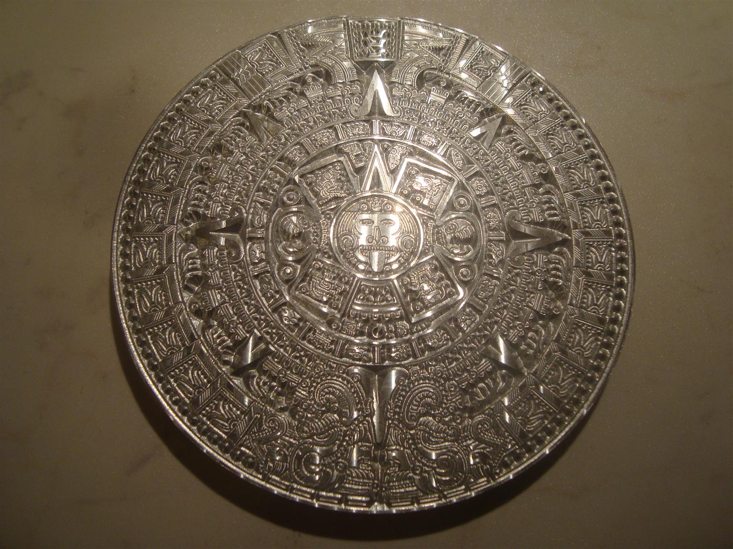

Nice, now try it in aluminium...
Now that is even more impressive! Was that done on your big adjustable bed machine?
Re: Woo, my first 'proper' part!
WandrinAndy

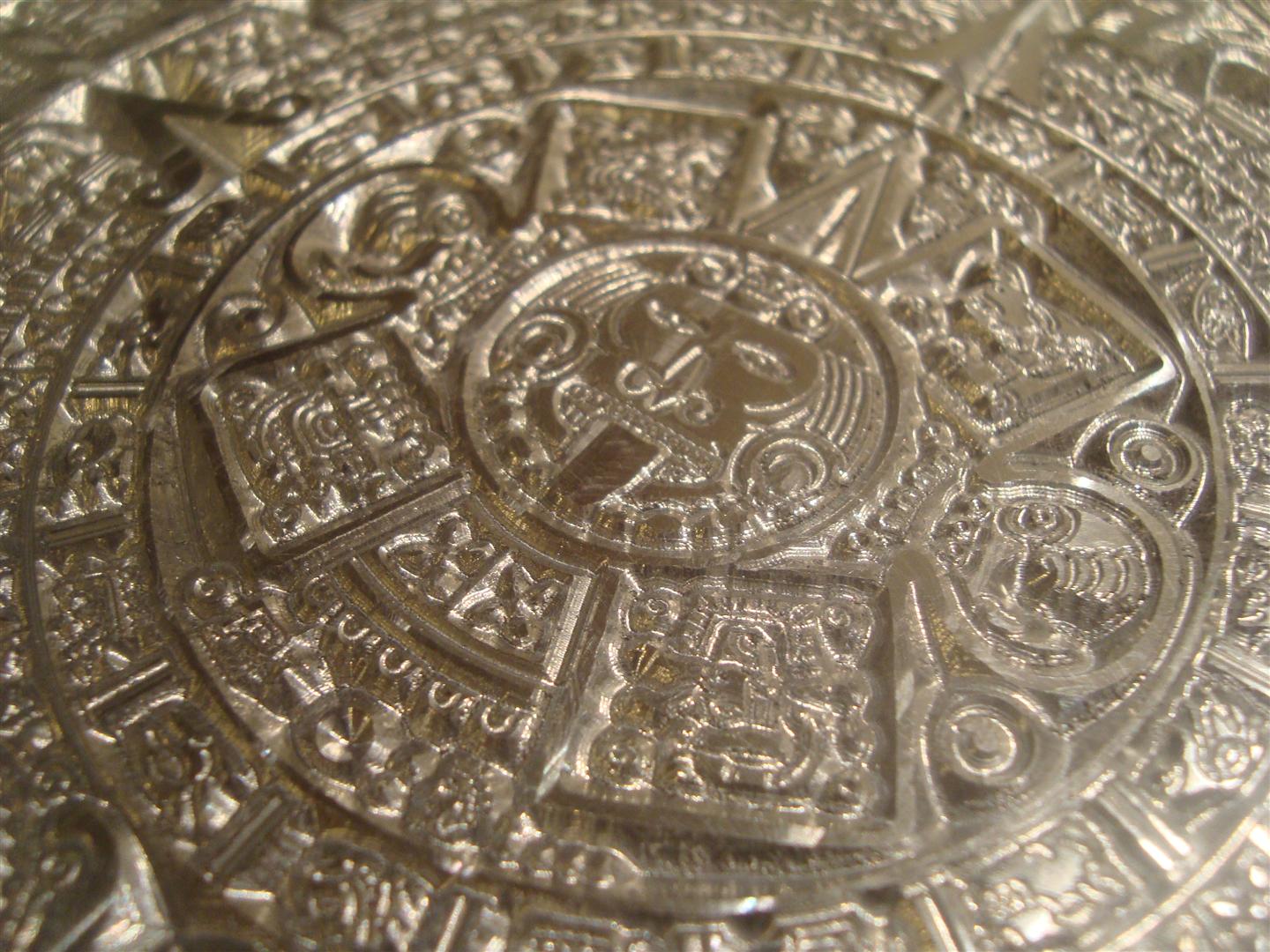

Thanks but it's not impressive really - one of the easiest parts I've ever cut since Jazz sent me the code so all I had to do was press run and do something else for 4 hours! It is a nice feeling though to see your machine make something so detailed...
WandrinAndy
Yep, that's the only machine I've got that could do it since the mill has too much backlash.

What bit would you recommend for cutting it in aluminium?
Craig
craigrobbo
Craig
Jazz and I just used 6mm diameter 90° spot drills with a sharp point, but it would probably cut faster if you bought a 90° engraving bit. Having said that spot drills are exceptionally useful so this is a great excuse to get one!
