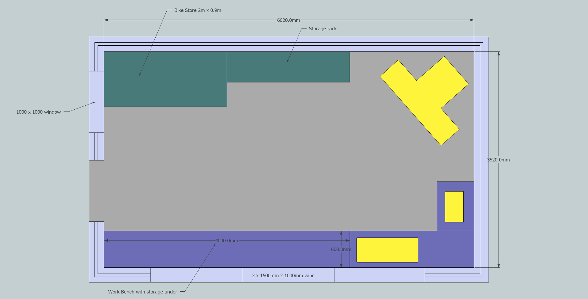

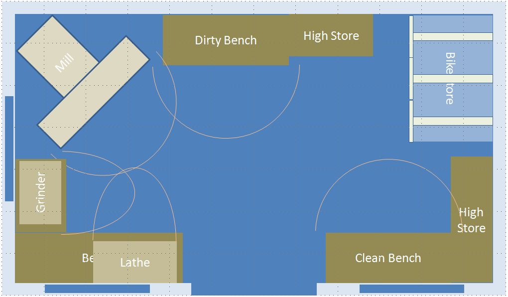

OK main changes to be incorporated... bike store on ceiling to give more wall/floor space, Dutch dryer style but cleverer... maybe with powered lift :) That frees up space to make room for a small CNC router maybe, or a 3D printer, and/or more workbench...
Bigger windows to increase light and make it easier to get stuff in if need be.
But can't decide what to do about the mill... fix/re-engineer current one or buy a new one (the Amadeal AM30LV @ £1300 is a similar size but more suitable for CNCing... or the slightly smaller XJ25 @ £850)? Reckon I could get £250+ for the current mill...

Done some rethinking and some replanning and put some tent pegs and string in the garden where this is likely to go (not so much a garden as a unkempt undergrowth behind the trees). Reckon I can get 6.5 x 4m external which is 6 x 3.5 internal and I can keep it to 2.5m high by putting the door in the end and better utilising the space. So here is plan B in Sketchup this time...
Give me a continuous run of 6m of workbench with the lathe and grinder at the end, lots more windows and therefore light and room to put the bike trainer up when I can't get out and ride... and i could make it 0.5m narrower if need be (but I dont want to). Will make it a single pitch, 2.5m at the front sloping to 2.25m at the back (top of pic)

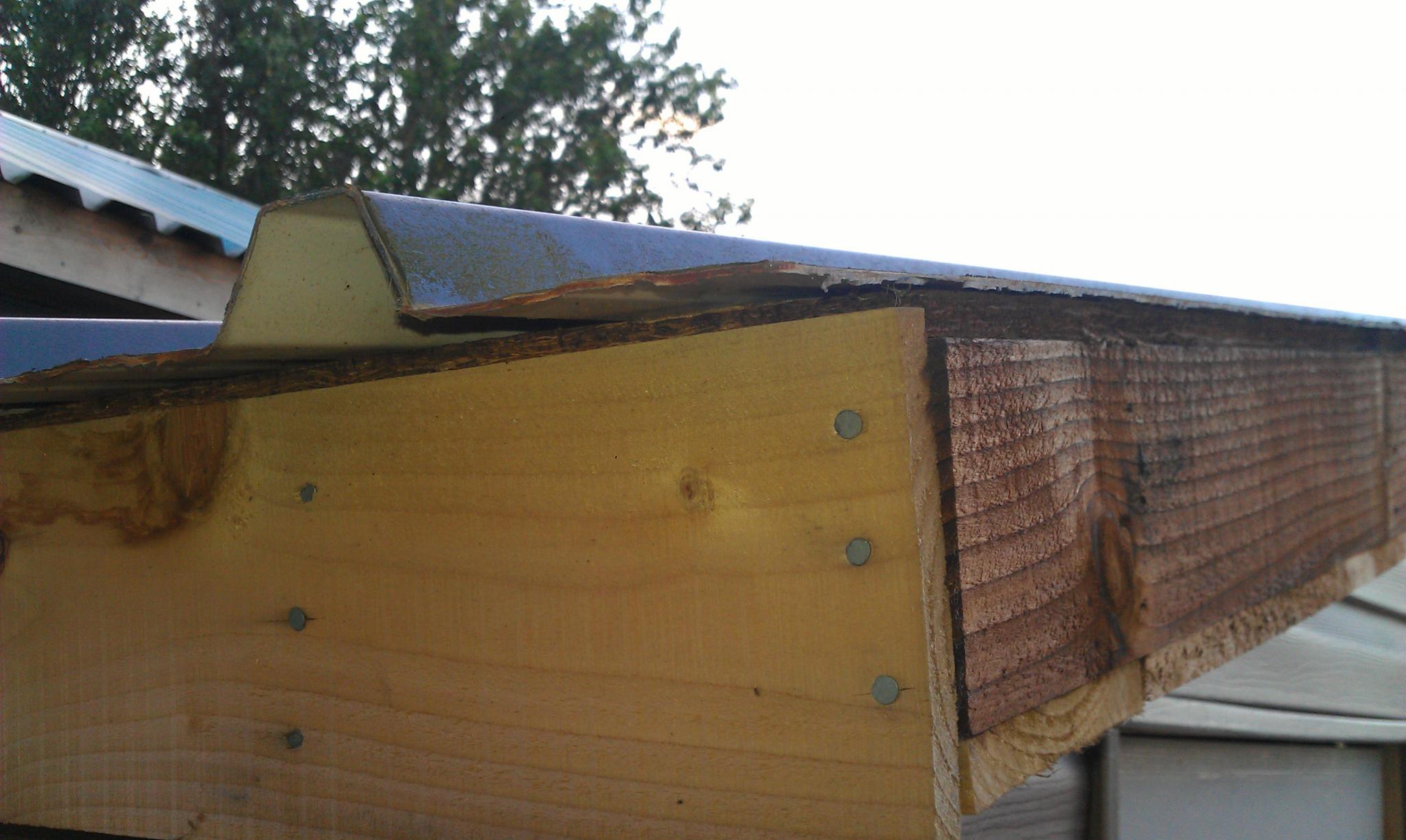

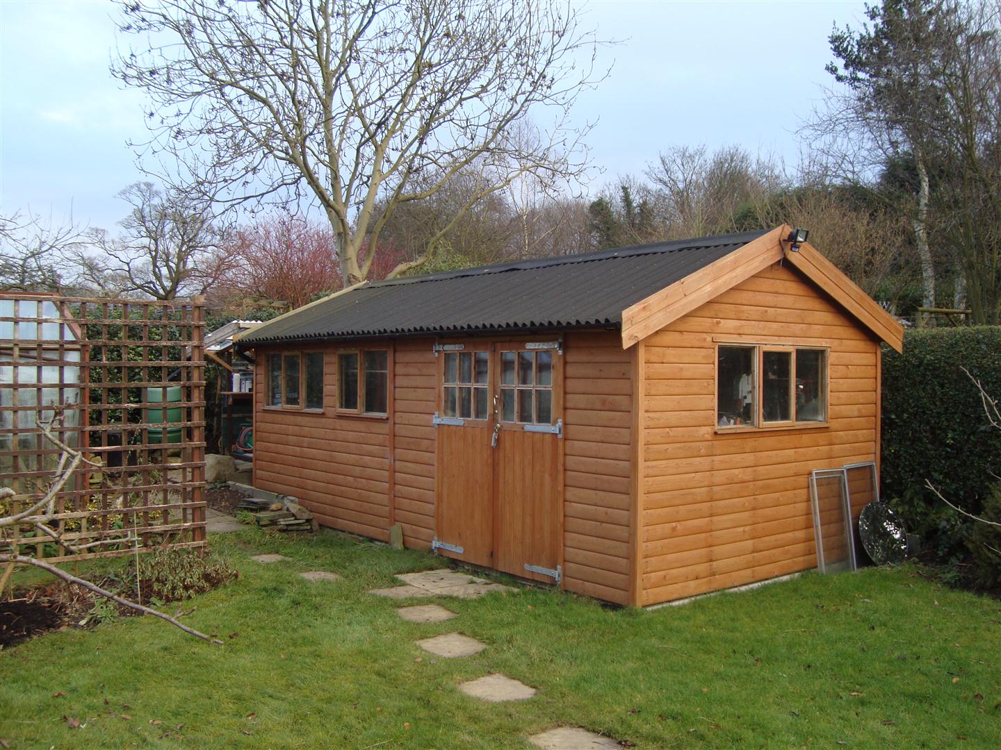

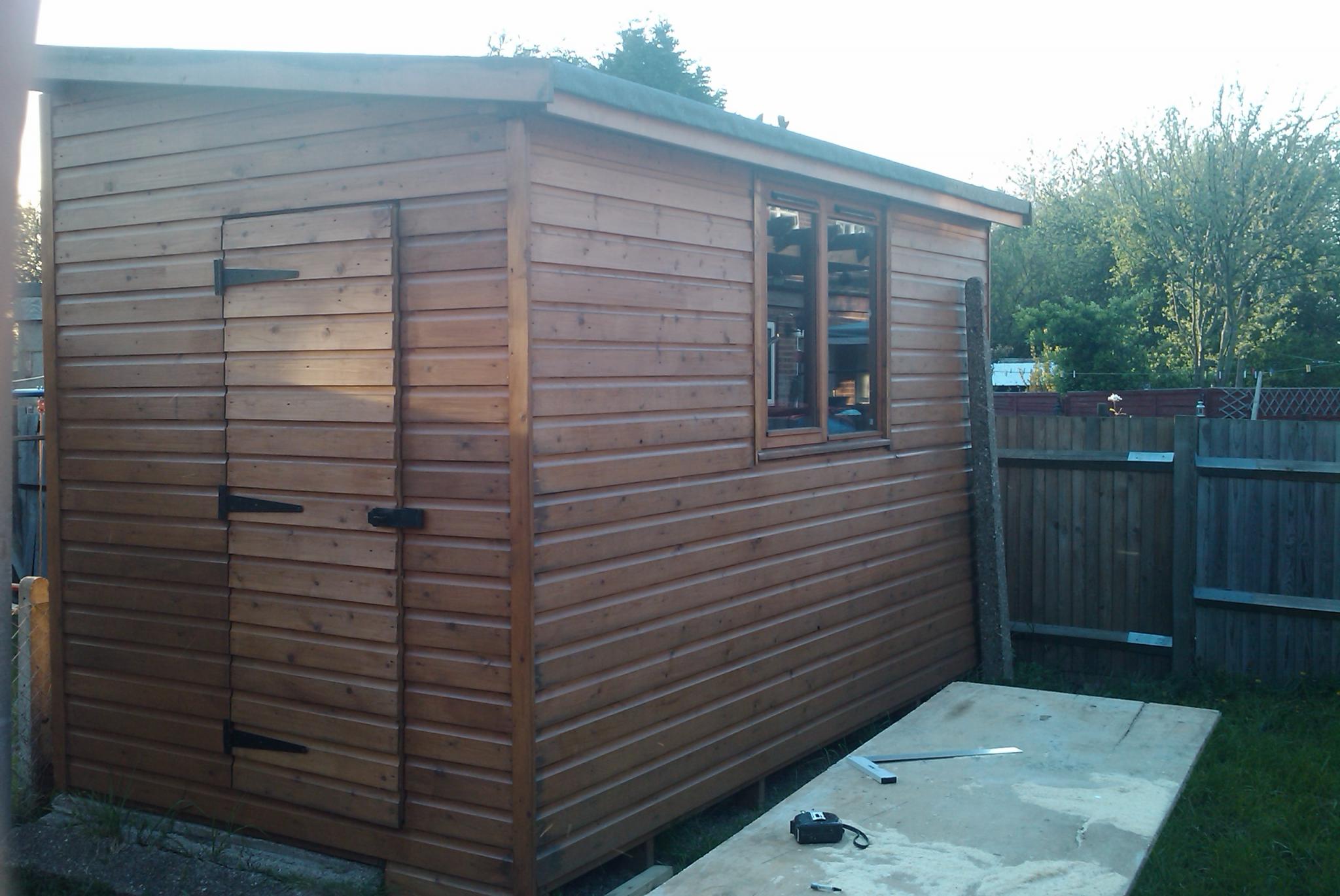

I wouldnt recommend a single pitch roof. I had this on my last workshop and I am glad I didnt do the same on the new one. Having the extra storage space is a major bonus on its own. But if you do go down that route go for some decent roof covering like plastic coated metal sheeting. Got that on mine and its great.
Photo of the enlarged access I left myself to get stuff into the roof storage area.

If you are going to build to 2.5mts at one side anyway would you not be as well having a pitch roof? It might not be as much of a slope as you wanted but it would Still be there. The metal roof is not really that noisy and the roof sheets are screwed down on top of the outside sheet of timber anyway.

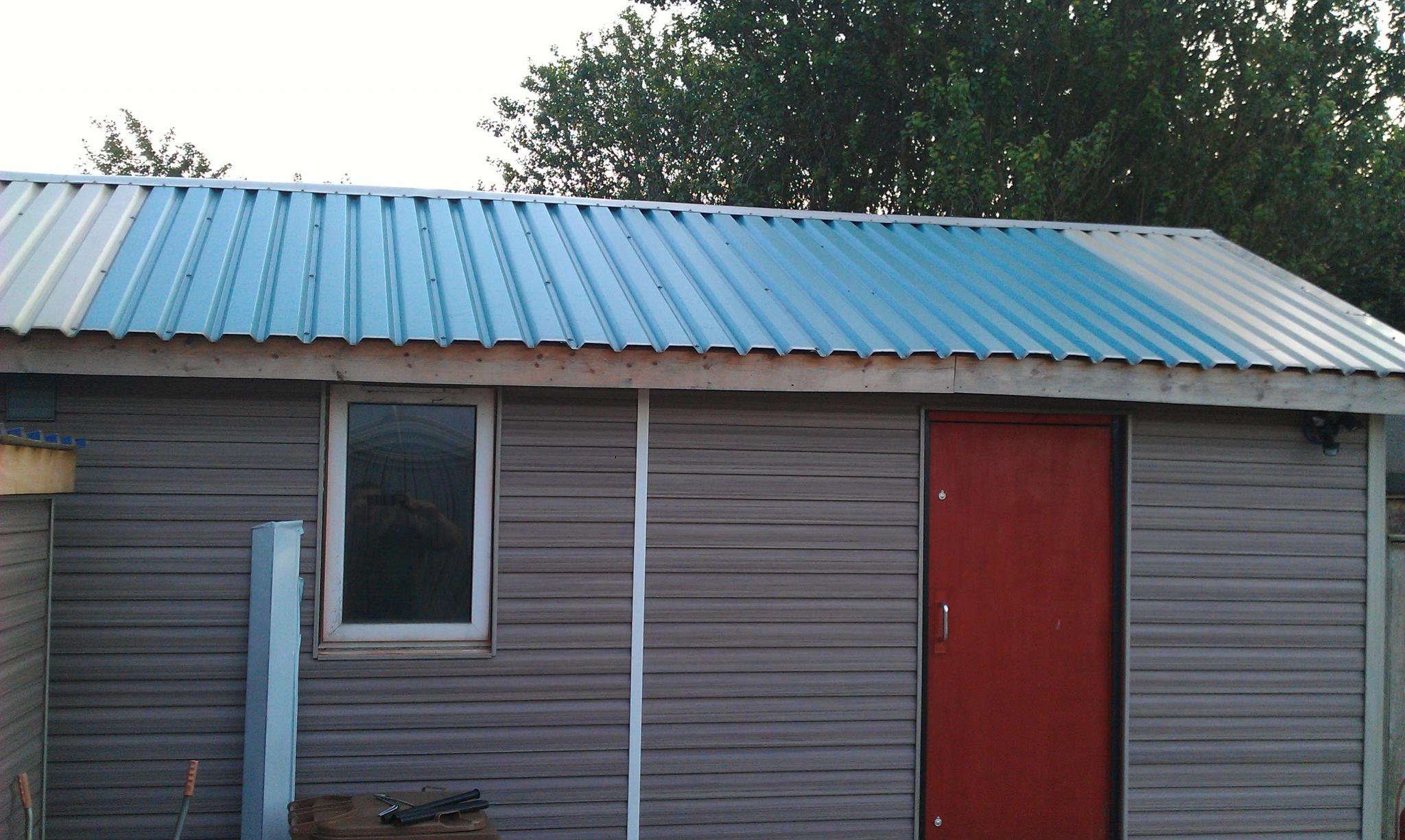

Photo below (left)shows my workshop roof. The photo on the right shows my nearly complete bike shed with the same type of roof. The roof has the outer sheet of osb, 100mm of poly insulation, then another sheet of osb inside so its well insulated for heat and sound.
Attachment 6569Attachment 6570
Re: Musings on building a workshop and a new machine...
Forgot to add that the air gap between the roof timber sheet and the metal sheet gives it a good way to breath to keep the damp away.

Yes 100mm insulation between the joists with osb top and bottom. I used plain osb screwed down. The grade of the osb is structural I think. It was the one with the better preservative treatment but even so I did give it a couple of coats of creosote or what passes for creosote these days. Seeing as the roof is covered by another waterproof layer you should only need protection from dampness.
My last workshop roof had bitumen coated fiber sheets on it and I really didnt like them. If it is the fiber ones they go soft in really hot weather and hard in really cold weather and after a few years they get very brittle and if you walk on them they break. You need to be really careful when screwing or nailing them down to get the right tension on the fixing so that its not too loose or too tight that it starts to crush the profle and makes it prone to leaks. Also used to have a large tree behind the workshop and in high winds some of the broken off branches punctured the bitumen sheets. You dont get these problems with the metal sheets. Metal stuff can also be repainted after a while to tidy it up again.

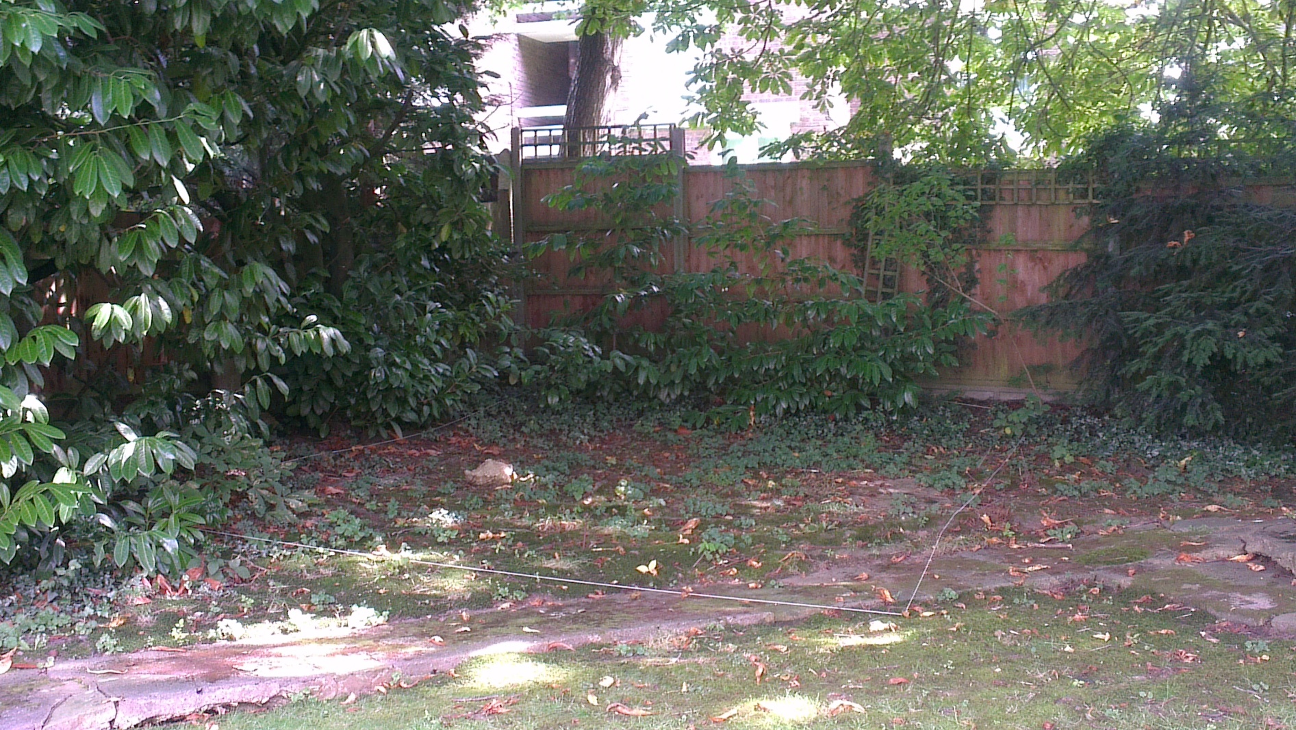

Tree's are my problem too... I have a mature chesnut tree approx 3m away on one side and a large laural tree/bush at the back and I'm going to have to cut through a few major roots that lie on the surface. Not sure what impact that will have a) on the tree(s) and b) on the ground swell...

Hmm, we had a youngish (5-10 years) plum tree in the way of where we put the workshop 20x10' shed. The plan was to leave it there, hence why we got 20x10' not 20x12', however surpisingly after cutting lots of bits off my Dad managed to move it so we could have had the extra 2' on the width after all! There's also a mature ash tree pretty close to the end of the workshop, but it turned out there weren't too many roots in the way.

Not sure what exactly the roof sheet is, but it's black and corrugated:
Attachment 6571Attachment 6572

This is the proposed location, marked out with string. As you can see there's a big tree not too far away and if you look carefully you can see the roots (the string bends over the top of one!)
Attachment 6573Attachment 6574
The roots might cause you a problem but you wont find out till you start digging out the foundation and see how they are growing. Another problem is that the tree roots will continue to grow so could be ok just now but could damage the concrete in the future thats why I removed the tree next to mine, I just knew that it would cause problems so it had to go. I think you might need some expert advice on this one.

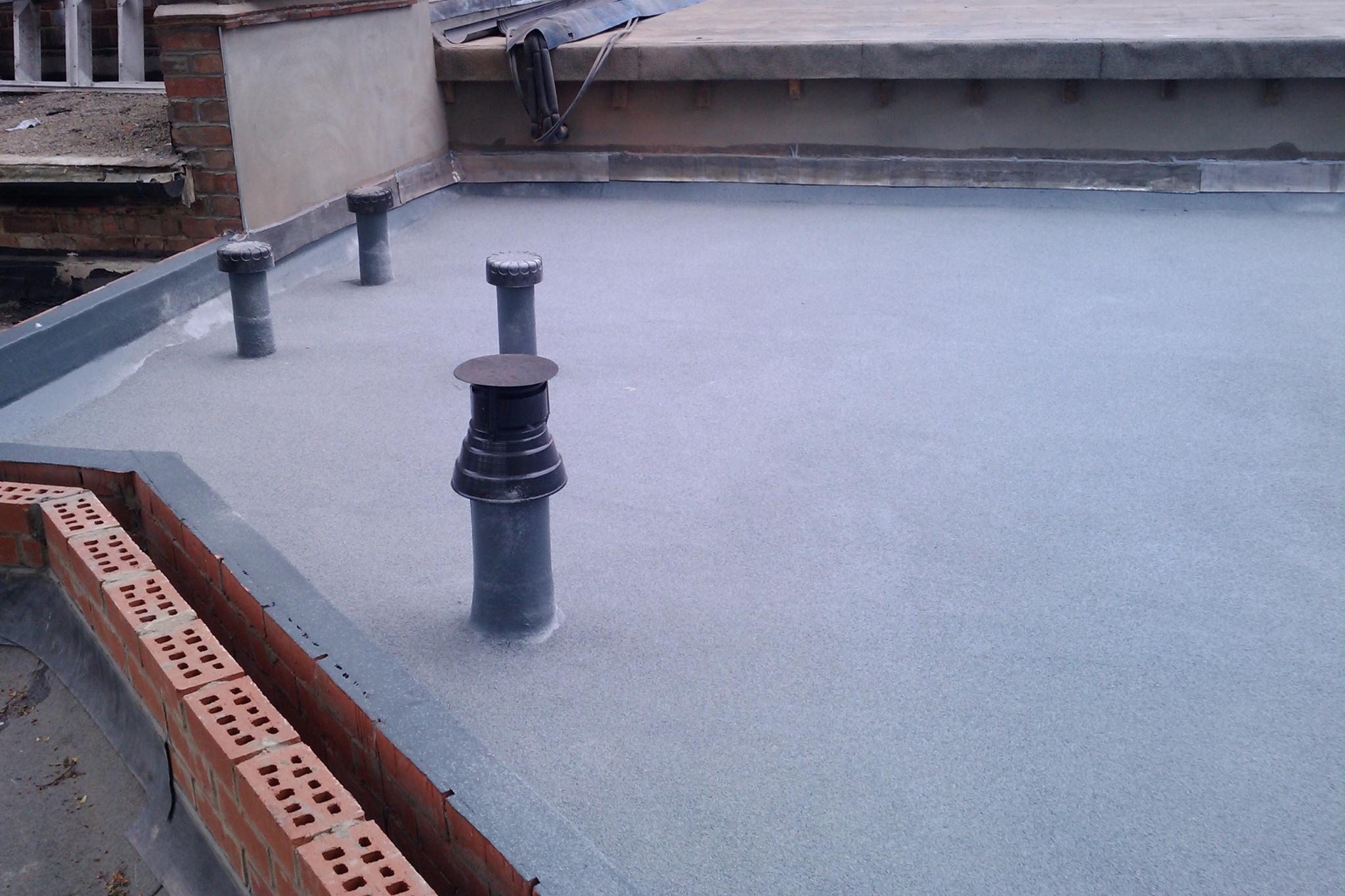

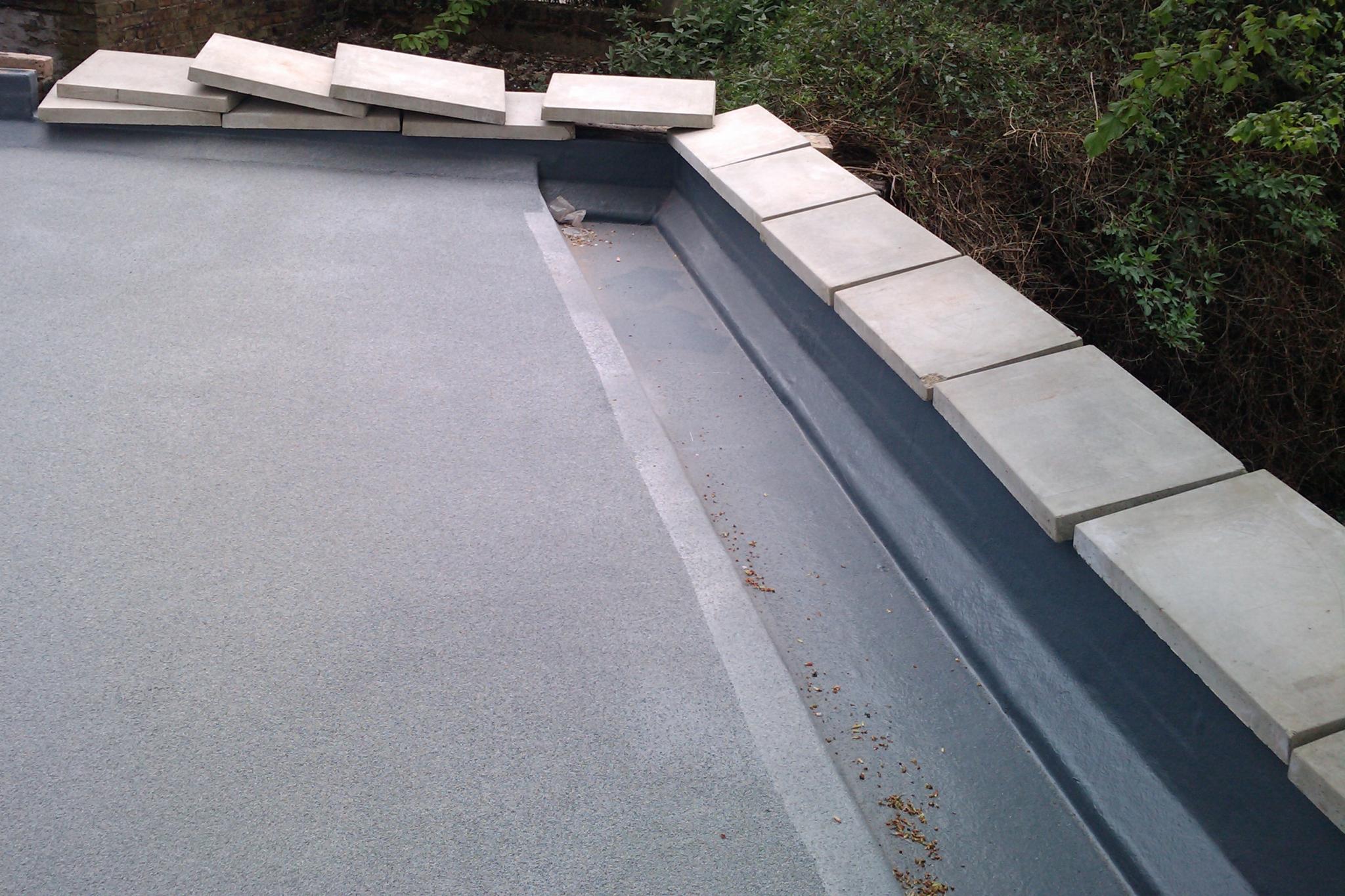

I've had all sorts of issues with a flat roof on a garage in the past so don't want a repeat of that. The only issue with plastic coated metal roofing is the noise it makes when it rains hard :
Have you had a look at GRP roofing. I did a roof with a friend of mine as an extension behind his shop. Its uses fibre glass and resin, its easy to put down and has a 30 year life. We didn't put insulation in between the joists, rather OSB3 board over the joists, then 120mm insulation, topped with another layer of OSB3 board, all screwed down with 170mm screws. Planning actually specified which type and size of insulation we needed to use. We had a flat roof with just a rain slope, but it could be installed on a pitch.
Attachment 6577Attachment 6578
