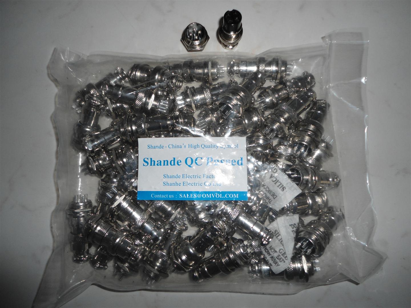

Yes managed to cancel the order but spotted another problem.
The multi pins I already have [ forget the high speed motor ] are opposite, the chassis sockets are female. If you use these GX16-4 or the 19-4' [ or 5's ] for stepper drives the pins, when connected, are live.
Can't seem to see the opposite version, must have a different designation but can't see what it is.
Doesn't stop this lot:
CNC Controller 4 stepper motors Router Mill Plasma | eBay
You can just see in the photo that the stepper connector is female...
If its under 48v DC its not an issue, though it isn't best practice. Over 48v its a no-no...

So because I have to keep to regs, these are not for me. I have some of the 4 pin military type ones similar to these.
CONNECTOR Picture - More Detailed Picture about 4pin circular connector, diameter 1.5mm*4 ,free shipping Picture in Connectors from Shanhe Electric Co Ltd
But opposite, female in the socket so legal, Again all the ones on the aliexpress site seem to be opposite
Just been in the workshop and stripped two of the military plugs down as in the pic above, one from RS ? with correct female insulated chassis plug and one of the above from Ebay.
Idea was to see how easy if possible, they could have the guts swapped over, yes they can do but it takes 3/4 of an hour and you make a right mess getting wire circlips out that were never designed to be removed. So unless you can get these female chassis type that's a non runner on time alone. Certainly don't fancy taking a week off work to do 100
So the question is what other than XLR's are available in 4 and 6 pins Female Chassis mount and good for 8 amps ?

I asked the supplier if they could do the 19mm the other way round and they've now listed these:
Aliexpress.com : Buy 4 pins push pull circular quick connector 16mm from Reliable connector suppliers on Shande Electric Factory
I'll ask if they can do the same but 19mm...
Yes I got the same email from Andrew this morning for 4 pin and 6 pin.
That'll do me nicely as I'm not into wiring a stepper motor with welding cable :calm:
Anything larger than a M542 and I hard wire back to the driver anyway.
They arrived today:
Attachment 6689
I prefer to do that, but for some reason people seem to enjoy sticking connectors in between.
