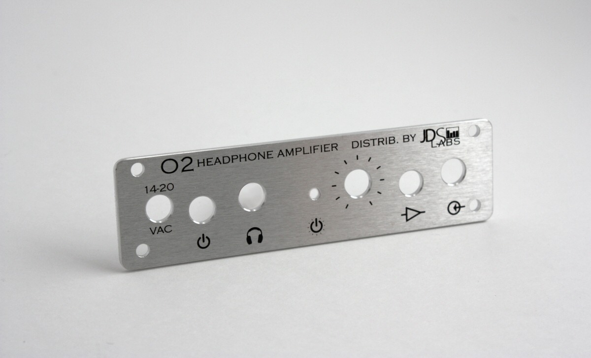

		Just as a query .. I take it that being liquid cooled means the spindle and not gushing water over the tool ? Also if anyone can answer this, and yes it may be a silly question but how do they put the letting on the face plates .. i was thinking of etching them then filling with paint but is there a tool for the miller ? BTW theres money to be made making these custom plates for people, one of the reasons I invested in a miller, to do the one below as a "one off" would have cost me close to £100.. now they sell for less than £6 plus postage .. but back before mass production to get one made so I could mould it would have been very expensive.
example :
Attachment 6640

		Re: Well I bought one off ebay..
		yes, the spindle is water cooled.
 im guessing that plate has been etched, mayber with a lazor?
it would take quite a bit of effort to machine it with the diffrent size/thickness of fonts
if you tacticaly designed a line drawing decal you could easily drag engrave your plates add a touch of paint then burnish it clean?
a simple spring loaded drag engraver it pretty easy to make if you can get to a lathe?

 Yes, its the spindle thats water cooled.  there's no option for coolant on that machine, but when cutting ali a garden spray bottle filling with cutting fluid and the occassional squirt is all thats needed... or a compressed air blast works too.  Depends on cutting speed/material/etc.
When I used to do faceplates like that in the past we had these approaches...
prototypes: letraset and lacquer
short/medium run: Screen printed or photostencil, etch and paint-fill.  For ali panels, photoresist, etch and anodize was also an option.
medium/large run: screen printed or die punched. Tho milled/paint-filled was used on occassion for equipment that would take a battering or where the panel was too thick for die punching - usually military stuff where cost was less an issue and the paint-fill could be redone in the field.

Seems Like a lot of work Mark .. I think Irving’s idea of printable decals could be more my skill level lol I have seen dry decal kits advertised, I’m looking into that..
irving2008
Thanks for that , I have a compressor I’ll find a 2nd hand air gun and buy some cutting fluid, and I think decals will be the safest and probably easiest method.
