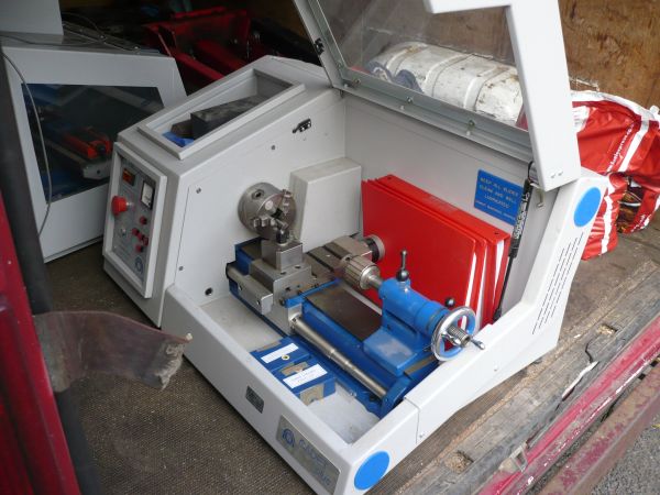

Bob,
Problem was once Conect had finished with it, it was no longer a ML10, just donor machine parts.
Attachment 6644
As you can see they used none of the countershaft parts or even spindle pulleys, just one speed under VFD control so most of the Myford documentation is null and void.
