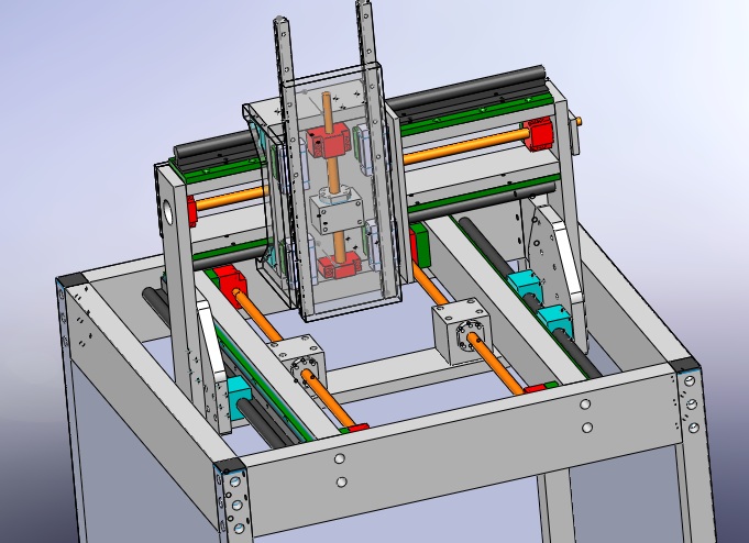

Re: 3-Axis CNC Mill Project
Ok I'll shoot first.!!
Please take what I'm about to say has help rather than pulling a design down.!!
That gantry is miles too narrow and it 99.9% will twist and rack even if you use 4 bearings in the arrangement you show. It will 100% rack if you use a single down the centre ballscrew using this arrangement.?
It does need 4 bearings but not like you have them drawn. They need to be in-line side by side creating a wide foot print.
The gantry cross bracing (Y axis) is no where near enough and it will flex with Y axis sides ways movement, 2 of those pieces would work much better.
If you are going to use this narrow profile then I would recommend you fasten wide plates at the bottom for the bearings to mount side by side.
Also some corner bracing wouldn't hurt.
Don't know where your inspiration for this machine comes from but it has a very Merchant dice feel to it and if so then let me tell you they are rubbish design which flex and move around like quivers jelly.!!
JAZZCNC
I fully take on board your comments jazz.
I can see now with slightly less blinkered eyes that the opinions so far have a good grounding behind them.
My only option is to start from the original sketch, assess and improve where ever i can.
Even if it serves no greater purpose than an expensive learning curve and thats the only benefit ive gained from doing this project at least i can put that expirience under my belt.
As for the merchant dice thing yes i did look at those, and designs from youtubers, neo7cnc and hamrx8 for some of the inspiration for my design, that and i was able to come by the aluminium i have used for free has left me with what i have.
Im not too disheartened, but will glady accept any furth help your willing to offer.
as for the greater foot print for the base in x, how about if i mount two pieces of 40 80, long side vertical, inside the frame, top edge of the 40 on the same plane as the under edge of the table top, and on these pieces mount each side a linear rail to meet 4 linear bearings on the carraige that way?
thanks again.
The base is not so much an issue and easily sorted with bracing or like Robin suggested stiffening with panels.
The tall narrow gantry is the biggest weak area I see and is where all the action takes place. It's also where all the other machines of similar design fall down.!
If your having a single central screw then you need a wide bearing footprint to help counter racking when cutting at the outer edges. The wider the better but obviously this loses travel so it's always a compromise.!
The other area that is often over looked and is THE most important part of the machine IMO the Z axis. It does all the work so if this is flimsy then it don't matter if the rest of machine is carved from one lump of granite the finished result will be shite.! . . . Obviously this is fastened to the Y axis and again if the gantry is flexing around because it's too tall or narrow and under braced then so will every thing attached to it.!. . . . It's also what Robin was pointing out.!
It's really just a case of make the X axis bearing foot print has wide as you feel you can spare and make the gantry only has high as you really need. If you need high then build very rigid with loads of bracing.
Don't under estimate the inertial forces of the gantry and Y/Z axis they can be quite high and will easily rock and flex a high narrow gantry at half decent cutting and rapid speeds.
This is what plagues the Merchant dice type offerings because the motors and Ball-screws are capable of so much more than the frame will allow and the finished cut is drasticly reduced if run too high.!! . . . So therefore the machines run feed rates well below there components potential to give anything like a decent finish and stop the frame from falling apart.!! . . . . This soon becomes very limiting and restrictive and why most sell them shortly after buying.!
My suggestion is you Stand back a little have a think and look about at other machines and throw a drawing or two our way for checking over. Has you've probably seen already where all more than willing to help and advise with honest opinions.

http://videobam.com/FeuSv <-- link to video
Ive knocked this up in solid works, there is now 200 gantry plates, and the gantry profile is now 425 long not 600.
Any advice, input welcome and required lol thanks

This far now, this was supposed to be a re draw. But I think ill be going for a re re draw just to be sure all my parts right.
The eagle eyed among us will of spotted my ball nuts missing for x, thats because im shit at cad and still learning and they have disapeared, so i put them back in.
Yes, for the vast majority of things 1:1 is the best choice to get good speed and acceleration with 10mm pitch screws. There may be occasions when you need to use 1:2 (e.g. motor 15:screw 10), but it would need to be something very detailed to warrant that. Also there's no need to use such a large pulley, it will only increase the inertia of the system and reduce your acceleration as a result. 30T is a good choice since then you can use 1:2, in addition to 1:1, without having to use very small pulley.
See now i just feel really thick. I had in mind 5mm pitch, 15mm belt. Ive already been having a lift with this from jazz and it has helped me to be in the right direction but i still dont fully understand this aspect of the machine im building. Not that im ignoring his advice i just thought id throw the Q on here and see what comes of it. Your last sentence went straight over my head jonathan, sorry :cower:.
If you use a 30T pulley on the ballscrew then you can put a 30T pulley on the motor to get 1:1, or use a 15T pulley on the motor (which is unlikely to be needed much if at all, but it's good to have the option) to get 1:2 ratio. It's best not to use smaller than a 15T pulley since the belt will wear quicker and you may not have enough teetth engaged with the pulley if it is too small.
The moment of inertia of a cylinder (which is essentially what the pulley is) is proportional to its squared, so a small increase in the pulley diameter will cause a relatively big increase of the inertia. The torque required from the motor is proportional to the inertia, so you want to minimise it if possible - hence use the smaller pulley, 30T instead of 40T.
This has helped some what. Aim for 1:1 but leaving the option for 1:2, got it :encouragement:.
