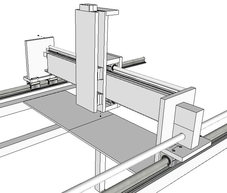

Ok, this has turned in to one of those projects that occupies every waking moment....every sleeping moment! Its doing my nut in but it's a dream that needs to come to reality! Ok ok may be a tad OTT:joker:
I've read many of the build logs and have a decent understanding of what the machine needs to do and what needs to be done in order for the machine/me to acheive it. And if i can get even close to what you guys have acheived i'll be a happy man!
The main functionality is to machine my carbon fibre plates.
Machining ali will be a major bonus.
If i can add an A axis at a later date to machine the likes of a motorcycle fender then even bettererererer!:joyous:
So heres a couple of pics of my current design. This must be the umpteenth version and unless you can see any flaws this is what im going with....
Attachment 6938
Attachment 6939

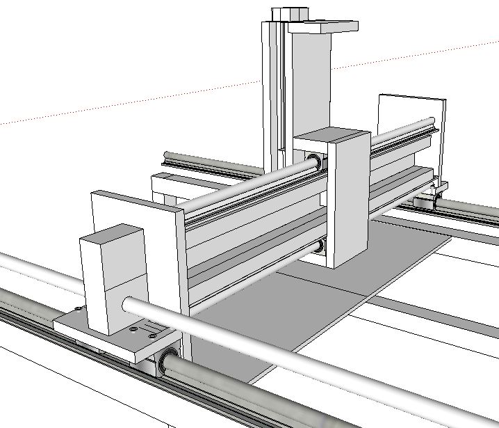

X axis consists of 25mm supported rails on a box section frame made from 60x60x5mm. Box section will be drilled and tapped for the rails. Bearing blocks will be on a plate 200x100x20mm. This plate will support the Y axis upright supports that are 200mm tall. The plan to date is to have the 2510 screws fixed and use a couple of Jonathan's spinning ballscrews.
Y axis consists of a 1000x130x20mm (may go to 25mm)plate. 80x40 ali extrusion will be attached to the length at the top and bottom of the plate. 20mm supported rails will be bolted to the extrusion to form a C shape with a 2005 ballscrew driving it. The ballnut will run within the C and again i'm thinking of using another spinning ballnut.
Bearings for Y will be wrapped by 20mm ali plate 150mm wide.
X axis support is 150mm wide, 500mm tall and 20mm thick. I plan to have at least 300mm travel on Z. I got some profile rails off ebay that ive since discovered are from someone on here. They weren't suitable for them so im wondering about the suitability for my application. So Z needs a little thinking about.
I've got these steppers from Zapp and plan to use MA860 drivers with a 70v+ PSU.
A 2kw watercooled spindle with flooding at the cutting head will be used to minimse CF dust floating about. Ill also need a vaccum attachement for MDF and the like.
Oh and the bed. Nearly forgot about that. Height is going to be adjustable whether it be a manual job of unbolting and adjusting or using and electric scissor jacks on each corner.
Appreciate your comments/advice.

I've got
WHY.?? . . . . far far to big and will restrict performance not gain. To get any decent performance then you'll need far more than 70V and really need to be run using 240V drives.
Personally I'd ask about returning and get something more suited. From what you're proposing using rotating nuts then 3-4 Nm would be enough on 70V. Even 6Nm 34's would be OTT using rotating nuts esp if twin driven X axis, and then still restrict performance compared to 3Nm 23's.!
Bigger is NOT better and on this machine would be restrictive.!!

Originaly i wasnt planning on a 2m X axis and they came up cheap on ebay. Ah well looks like they'll be going back on ebay.
I'll stop messing about trying to design the rotating ballnut mount to accommodate both size motors and just make it for the 3Nm nema 24's then? :)
Your gantry as drawn will weigh about the same as mine, so you'll be fine with 3Nm on 70V since that's what I use and the system is virtually identical...
Nema23 Stepper Motor 3.1Nm

It'll cost more than the standard setup and wont really gain anything if you use a 10mm pitch screw. I hope you've not bought the RM2005 already since RM1610 would have been much more suitable for that length, again due to critical speed.

Not understanding here.? You wouldn't want a fixed Y axis with a moving gantry machine.!! . .It just don't make sense?????
Did you mean fixed gantry so therefore fixed y Axis.? If so then you'll have a moving Table design and the X Axis will need to be roughly twice the length required to have same cutting area.! Not good design for large format machine.

I've now got the 60mm box section. Its 5mm thick and bleedin' heavy. Should be idea for the table frame.
Appreciate any thought of reinforcing a 2000mm unsupported span. The difference in cost of the 2 designs would be minimal due to the cost saving with only one ballnut mount will go in to tooling plate. I've been quoted £160+vat for 2000x150x25.

Ok so here's my latest incarnation. Gantry is 2000mm wide. Rails are 25mm.
I've stacked 3 60x60x5 box sections on top of each other and will be welded together. The edges have a 10mm radius on them so will need several passes to secure them.....at least thats how they did in on Discovery's Extreme Engineering on a bridge build:hypnotysed:. Do you think i'll need a backing plate?
Each 60mm section will have 2 supports to prevent the beam falling forward or back. I've used 20mm ali plate for now but may weld box section cut-offs direct to the beam to form a 'T' on the ends instead.
A spinning ballnut mount is bolted to the back of the Y axis bearings.

From the drawing it looks like the plan is to mount the rails on the top and bottom of the welded box section? If so you'll have problems with how much the steel will distort due to the welding. The rail spacing needs to be very accurate (guessing probably <0.05mm) for them to run smoothly, which is hard to get even before welding. Perhaps consider bolting them to a backing plate instead, since this allows adjustment to get the rails parallel. Also you will get much less deflection on this Y-axis if the ballscrew is placed between the rails. Currently when a force is applied parallel to Y, the Y-axis bearings can deflect in the same direction since there is a long horizontal distance (parallel to X) between the cutter and ballnut/rails.
If you decide to mount the rails on aluminium plate (as in post #15), then yes it is best to use tooling plate, but realistically the tolerances of the bearings are not that good so you would be fine with normal aluminium plate, but definitely not flat bar. If you were using profile rails then tooling plate would be the best option.
Re: The Mrs aint gonna be happy about this little project!
The rails are bolted to the box section, even in post #15. Earlier designs for a 1000mm gantry had them mounted on 90x45 ali extrusion which was bolted to a back plate.
I was hoping that tacking the sections together first and then do gradual passes would eliminate any heat distortion but if it's out of spec for the bearing before i even start, well that puts the mockers on that idea. Any idea how 90x45 ali extrusion would cope over 2m?
I would have liked to have the ballscrew mount on the Z axis upright so I would have to remove the middle box section and bolt to a 20mm back plate but then then is no room for the ballscrew mount unless the width of Y is 200mm+ to accomodate the mount as i feel it best to surround the Y bearings. Y ballscrew is currently 100mm off centre from the Y bearings.

Here's a quick mock up the ballscrew mount running between the Y rails. All uprights are approx 500mm
Attachment 7105
Back plate is 2190x330x20mm.......quoted.......wait for it........£300 +vat for ecocast!!!:hysterical:
5038 is £205
Back to the drawing board i guess
