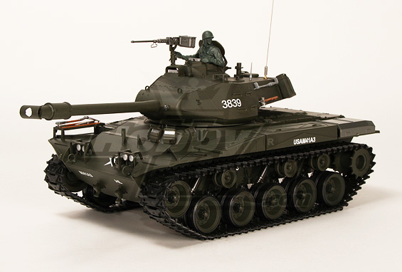

Anyway I bought a Heng Long Walker Bulldog
Attachment 7005
*Not my tank but for reference.
There’s nothing fancy about it , no smoke or sound, and after a few hours playing around shooting various things (badly) it got a tad boring lol

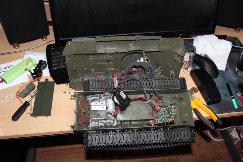

So now it looks like this:
Attachment 7006
The idea is of what to create... is evolving as I go along. I first thought of using a wireless camera via my Wi-Fi network. This is fine but is very very limited. First of all the range would be poor unless I added repeaters or boosted the signal somehow. Anyway I decided to go for first person view equipment. Lots of range , lightweight for RC planes and lots of things on the forums to help me decide the correct equipment for my project.
The ultimate idea will be to use my CNC / Casting equipment to build a really robust rover , so this is my R&D phase plus I can have some fun.
