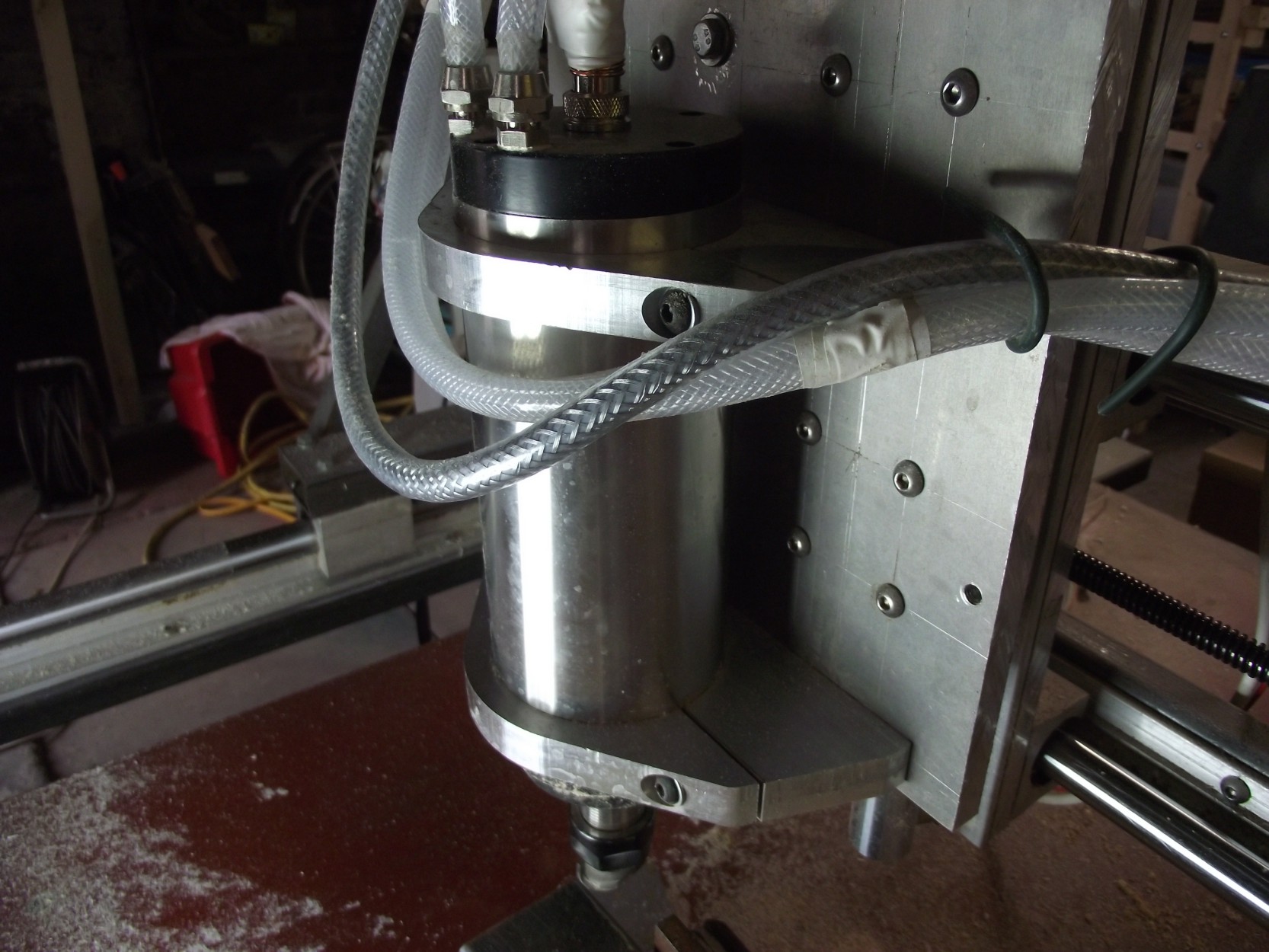

yes, inverters too. no mounts though :(

no mounts though :(

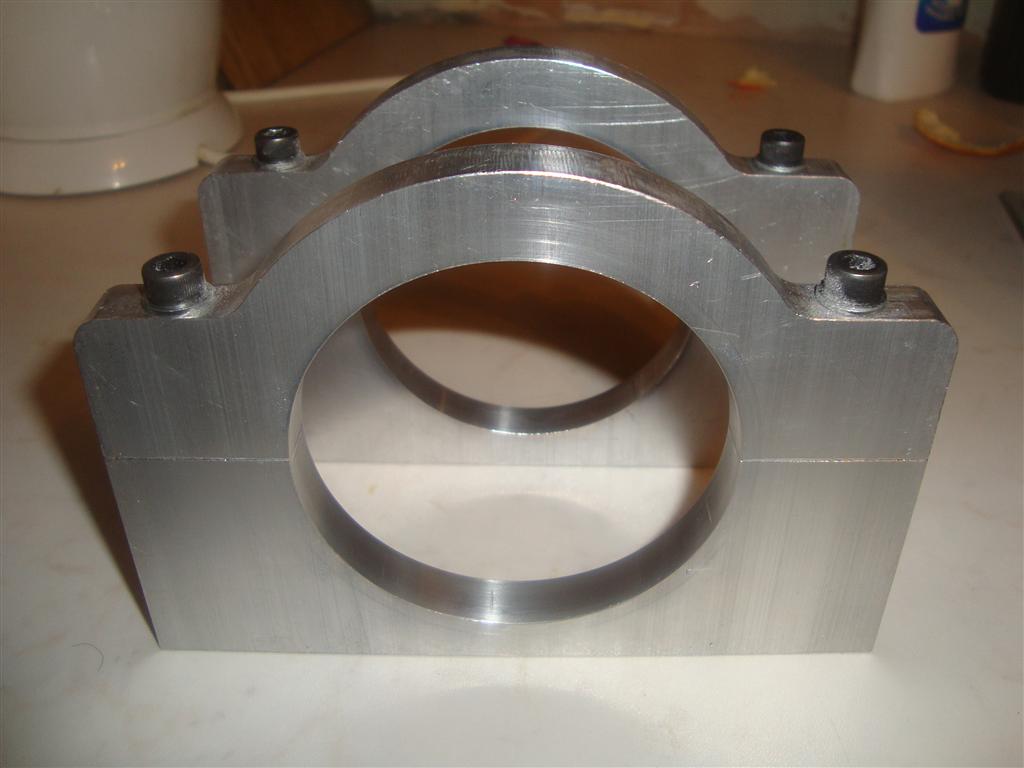

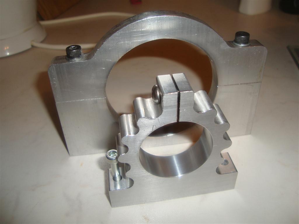

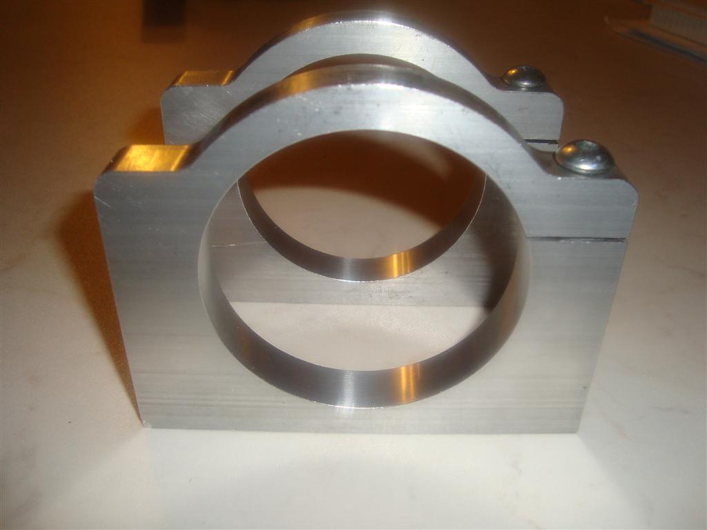

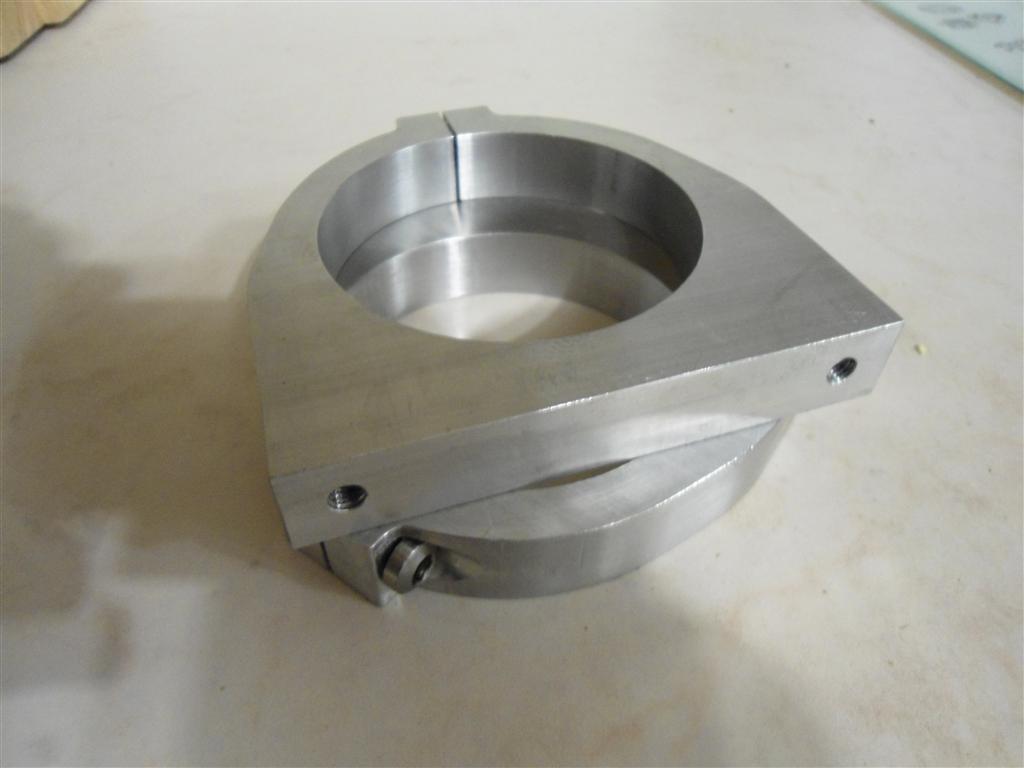

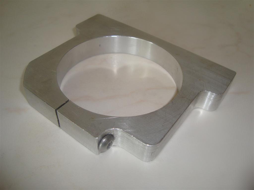

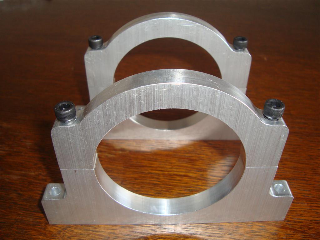

Attachment 7119Attachment 7116Attachment 7117Attachment 7118Attachment 7115Attachment 7112Attachment 7114
:whistle:

Are they from chai jonathan? As when I asked him last week if he could supply he said no :(
Re: I promise I will stop asking daft question soon. Ish.
Sees spindle/motor mounts and wants ;-)
If you're selling those Jonathan and can take paypal, don't be shy and send me a PM (2.2Kw water cooled spindle 80mm dia attaching to a 160mm wide Z plate BTW) :-)
I'm guessing thise mounts are from Jonathan DC
Yes they're all ones I've made. I need to make one for someone else on the forum asap, but I'm very short for time currently since I'm at university and have another project that needs finishing. However if I can make a few to the same design that would be pretty efficient...the one in the second photo from the left is easiest if made from 1/2" thick aluminium, to this drawing (can change the hole spacing if required):

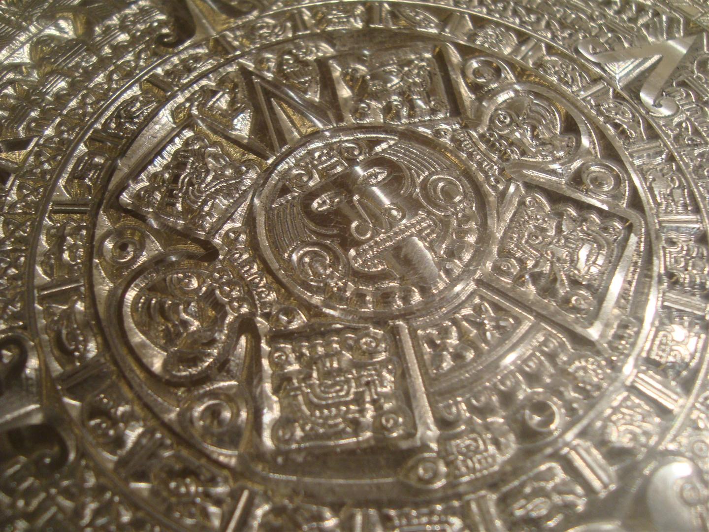

Also the resolution you get from 5mm pitch is hardly ever required. I cut this with (roughly) 10mm effective pitch:
Attachment 7120
The area shown in that image is roughly 50mm wide...
