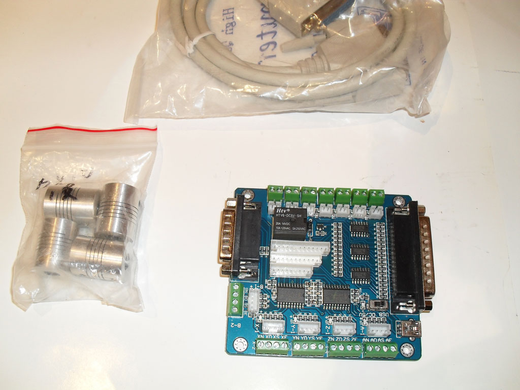

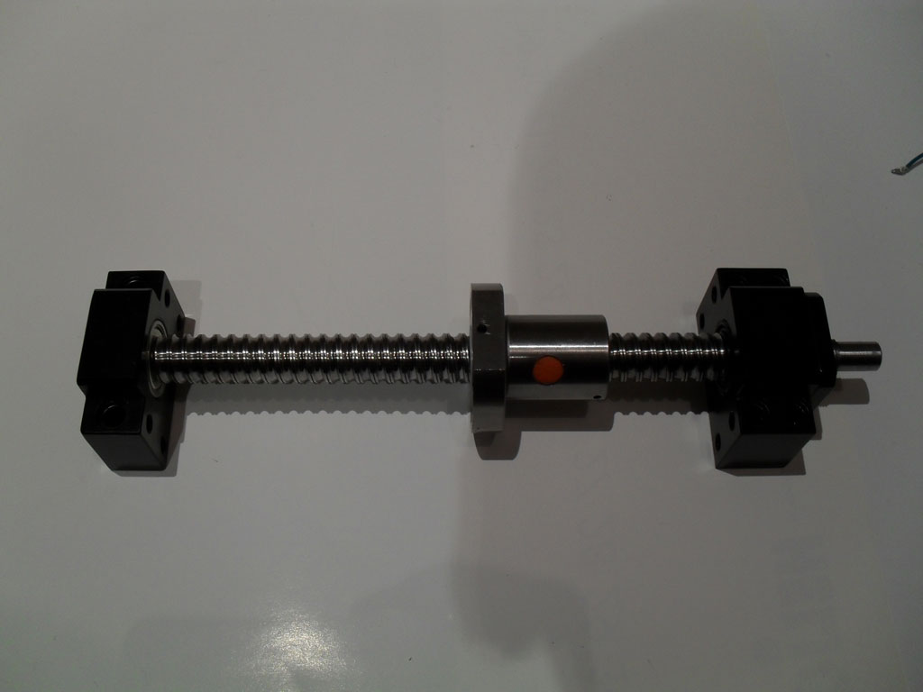

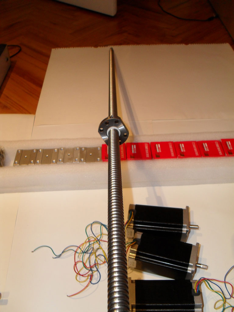

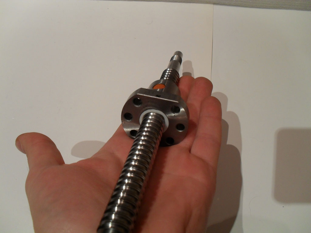

Hi. I am researching this field for months and I decided to make one. I ordered almost all parts except the linear rails. I am going to make them.
I have all the parts but I'll post pictures tomorrow because it is late now to take pictures :fat:. Anyway this is the parts info:

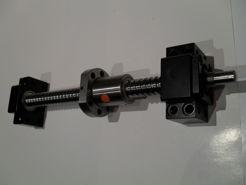

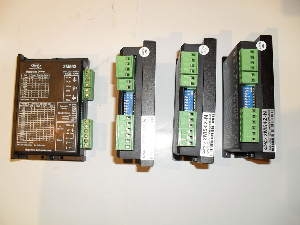

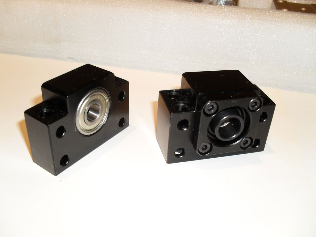

- 4 x Axis Driver 2M542 4.2A & Breakout interface board for Router system for CNC
- 2 x ballscrew RM1605-1300mm (for dual X axis)
- 1 x ballscrew RM1605-900mm (for Y axis)
- 1 x ballscrew RM1605-250mm (for Z axis)
- 4 x flexible couplers

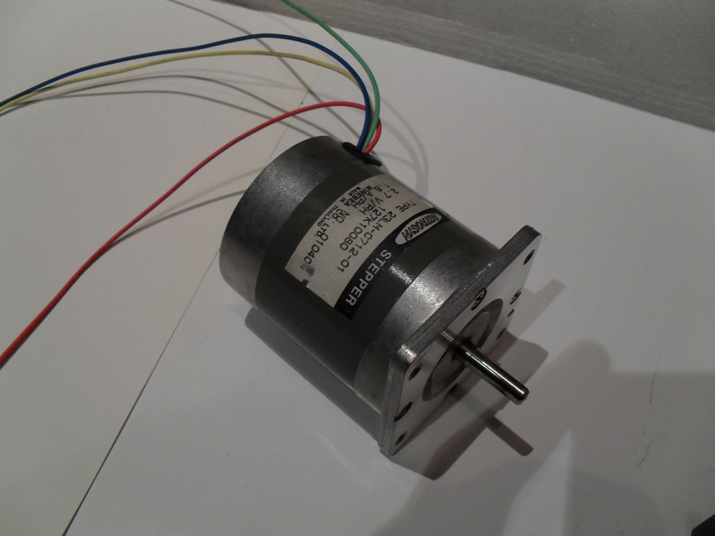

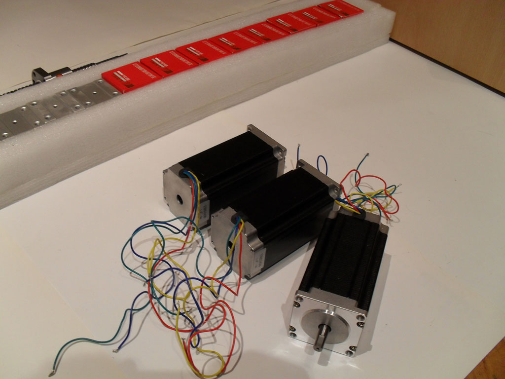

- 3 x NEMA23 425 oz-in CNC stepper motor /3.0A (two for X, one for Y)
- 1 x NEMA23 287 oz-in CNC stepper motor (for Z)

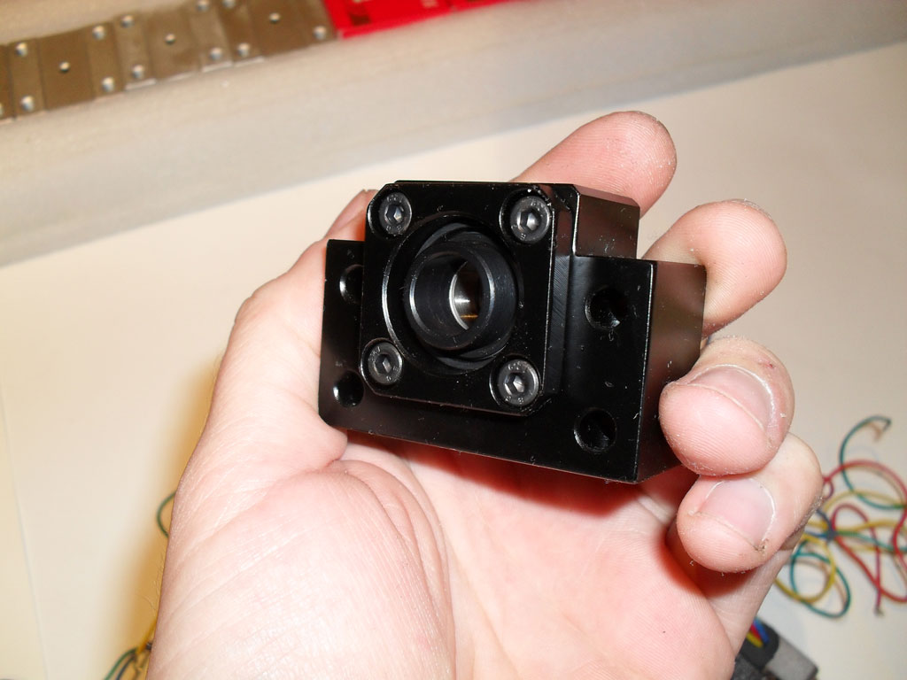

- 4 set BK12/BF12 ballscrew end support
- 12 x SBR20UU BLOCKS
- 3 x Cable drag chain wire carrier 10*20mm 1000mm (40")
I have all of this parts and I hope I am on the right track, I'll be so frustrated if I made some mistake because my budget IS VERY VERYYYYYY TIGHT.

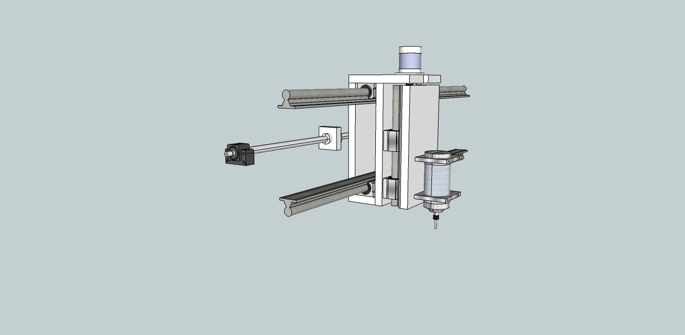

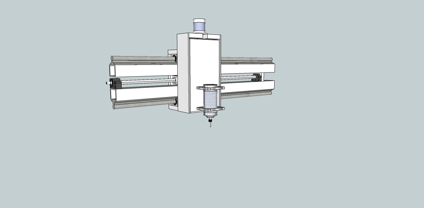

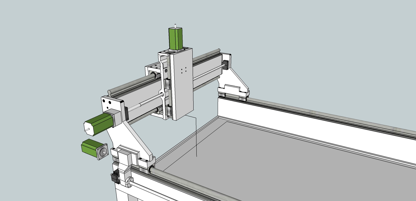

Here is some unfinished design.
Please tell me what do you think.
Thanks.

Re: This is my first BUILD please help.
Going off advice given to my design, and the veiws i know others share I'd say it seems to have the right things in the right places pretty much.
Critisism: flip the stepper motor and mount it on the back then use a belt and pulley system. This will reduce resonance, as well as other things? (correct me)
Perhaps also mount the ball nut inline with the rails, might help give greater travel in x?
Finally, ignorance is getting the better of me, are you really from chernobyl?

Hahahahahahhaa no my friend, I am not from there. I just put it like that :D
Thank you for the help.
Can you tell me if the Y distance of the rails (vertical distance between the Y rails) is better to be 150mm or 200mm. Y will be 1140mm long
PS: I am still working on the Y boll-nut. I just put it like that, it is not in place.
PSS: I was also thinking about belt and pulley for the Z but I don't have those parts and it will complicate my design. What do you think? Is there that much difference?
All aluminum parts are 20mm tick.
I changed the design little so the Y distance between the two axis is 150mm
Attachment 7202
Do you think this is better?
Its always better to have the y-rails as far apart as you can and as low down to the bed as you can to improve torsional stiffness...
I think you could reduce the thickness to 12 or 15mm without undue effect...
What is the box section between the rails? material and dimensions?

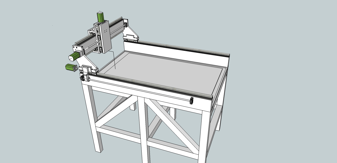

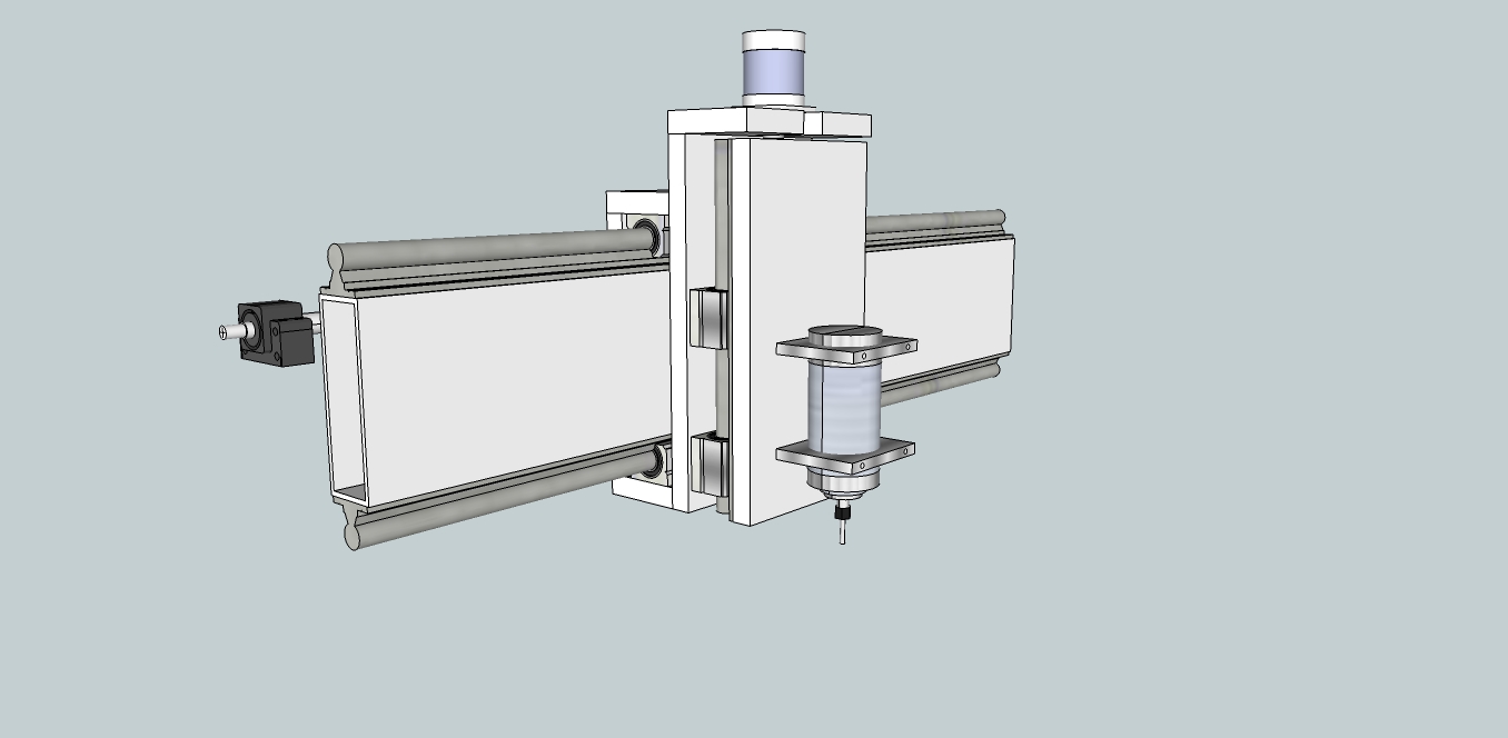

This is my newest version. I found that I must put the ballscrew in the sandwich so I can use the maximum length.
The box section of the two pieces that hold the rails is 50mm x 60mm at 4mm thickness?. I am thinking of using stainless still. What do you think. Will they bend?
I don't think the backplate on the rear of your z-axis adds a great deal to the performance of the machine, if you get rid of it you can bolt a plate to the back of you gantry to improve stiffness. If that still doesn't provide enough stiffness for what you are using the machine for you can always pour concrete into the box section.
Concrete is obviously heavy but weight can be reduced by adding things like vermiculite/perlite/polystyrene beads etc into the mix to displace the sand and and some fibre glass or fine steel fibres to add reinforcement.

hmm so you say the backplate won't do much think?hmmmm
I am thinking to use 5mm for backplate.
Assuming a typical spindle/z-assembly the 50 x 60 x 4 isnt strong enough for that 1140mm length if its aluminium, the deflection in the middle will be around 0.1 - 0.2mm and torsionally the deflection under cutting loads at the tool tip will be similar, so needs to be steel. You'll still need to join the two box sections with a plate, or a series of plates at the ends and in the middle to transmit torsional forces from one to the other and to maintain the rail seperation accurately else you'll get binding. The other issue is that box section isnt flat enough to mount those rails on unless its ground flat after assembly, you'll not be able to maintain the rail spacing accurately enough to prevent binding. Aluminium extrusion is better but again needs to be bigger, e.g. 100 x 50 for tortional stiffness. 5mm plate is probably too thin, the deflection at full Z extension under cutting load could be ~0.2mm. 15mm plate seems to be the norm, and will limit the deflection to <0.1mm. These calcs are very rough.

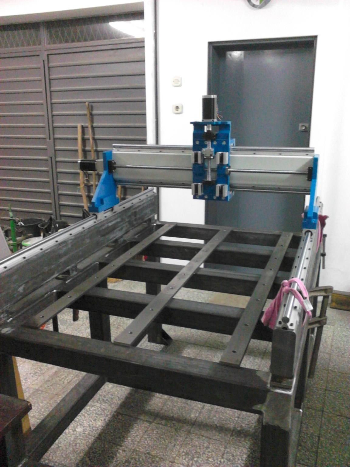

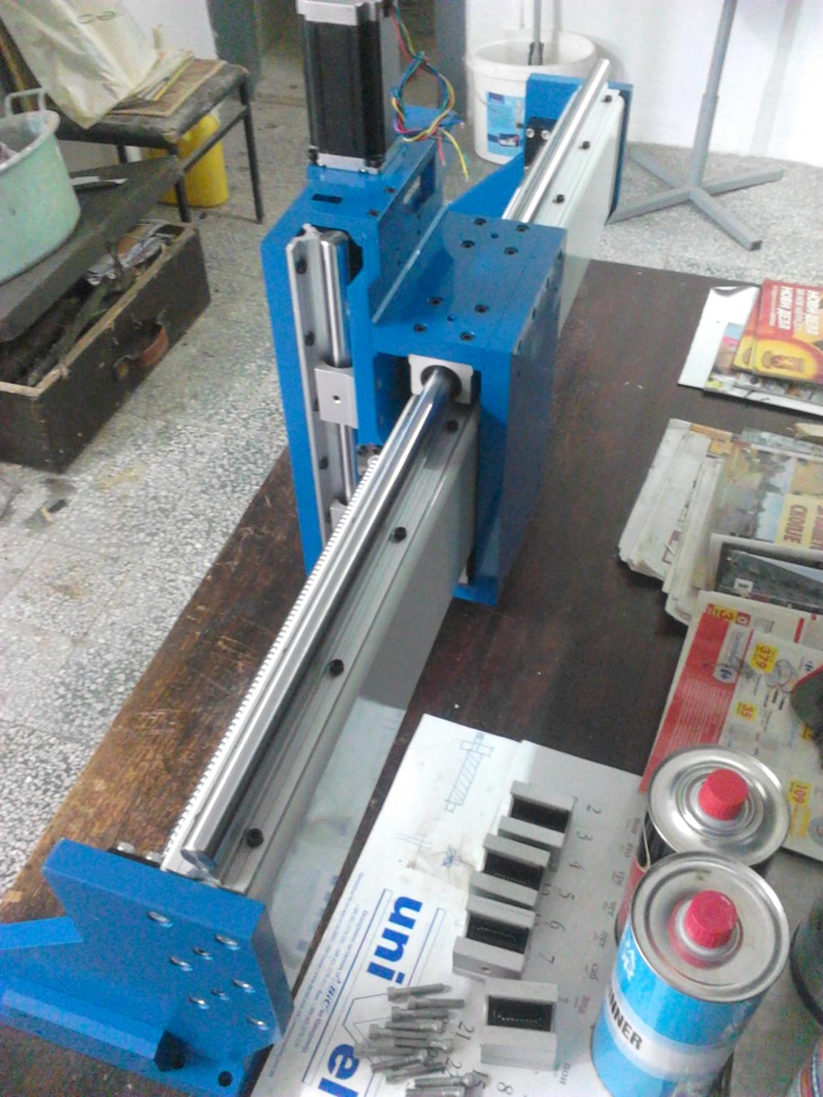

Tomorrow I will be cutting the aluminum pieces for the Z gantry.
For now I have two questions.

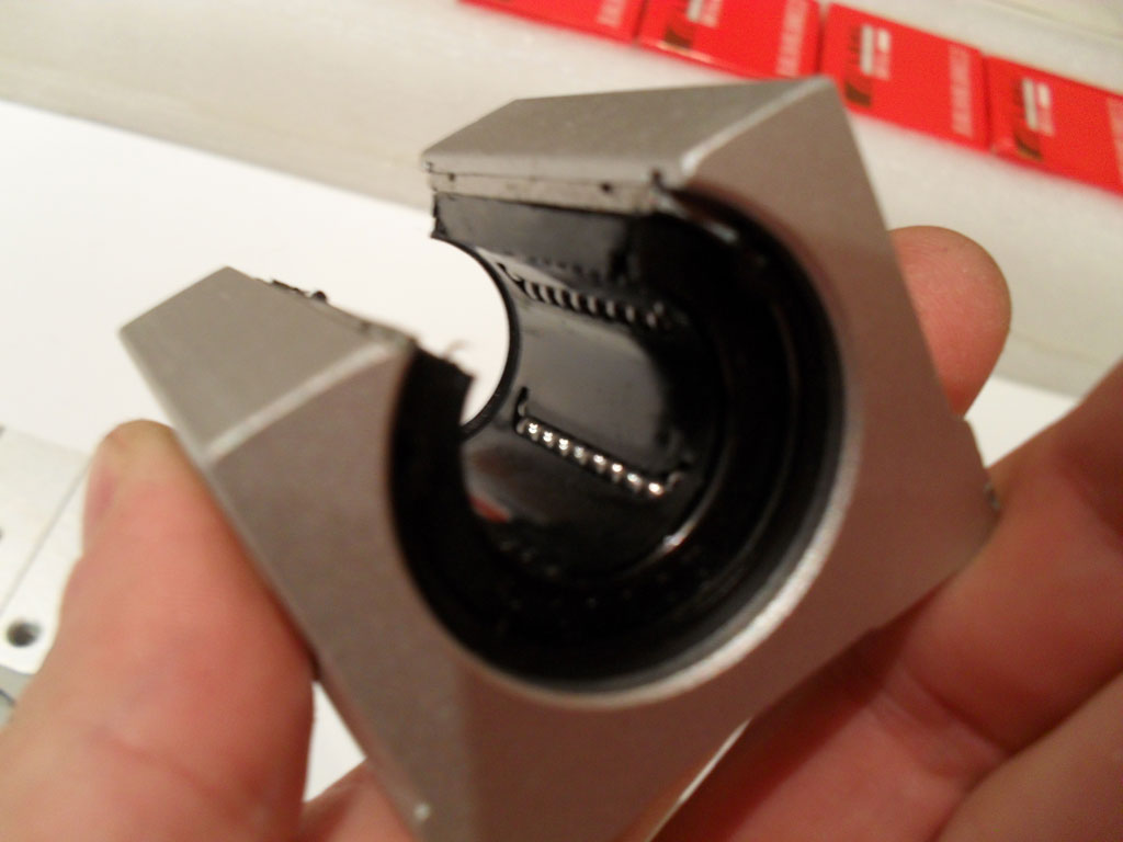

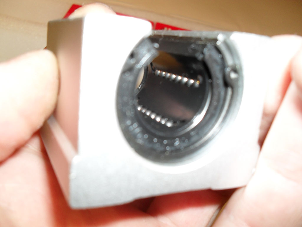

1. What type of bolts should I use? What is preferred size for bolting 20mm aluminum?

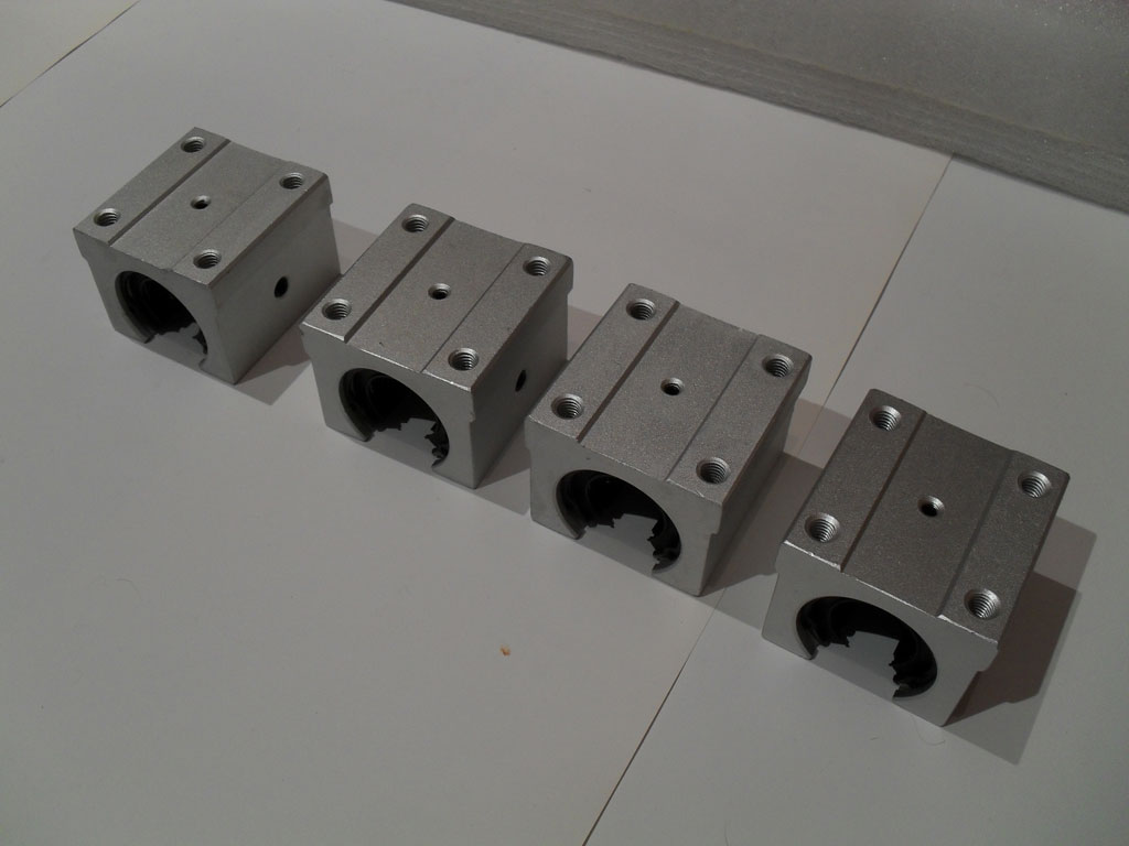

2. There are two screws on the Linear ball sliders. One is on the top in the center and one on the side of it. Why are those used for? I heard for tightening the bearings but why two?

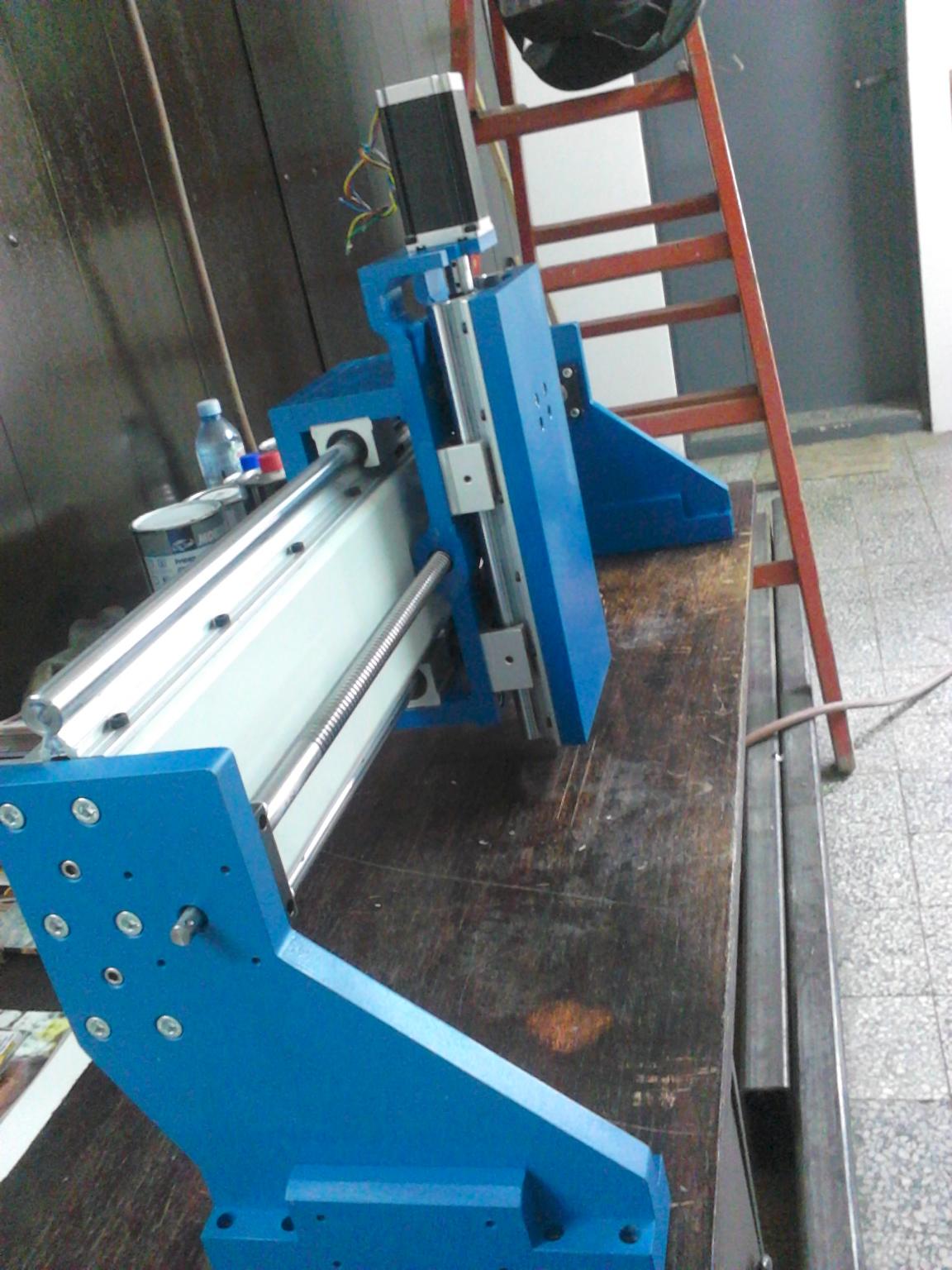

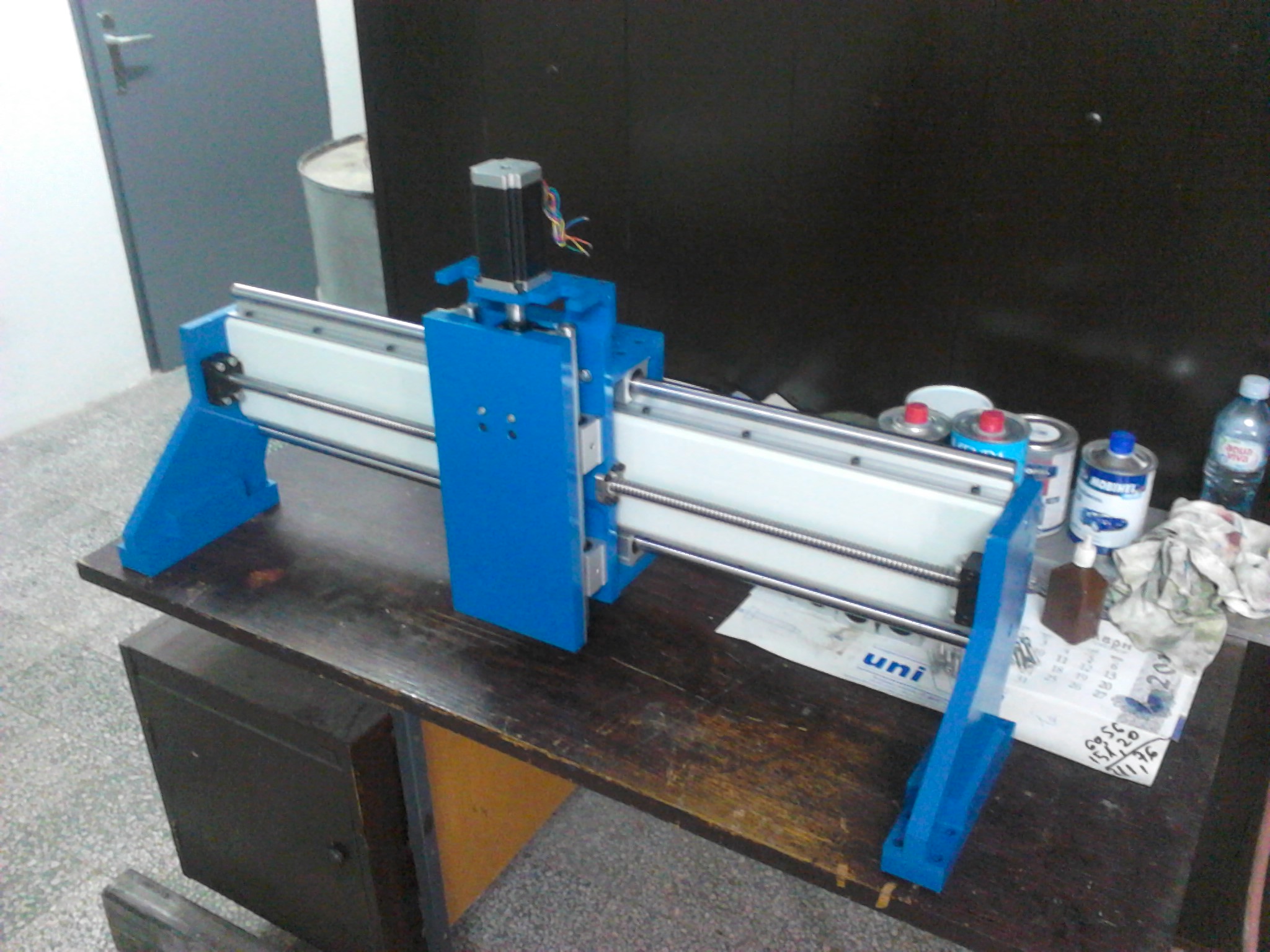

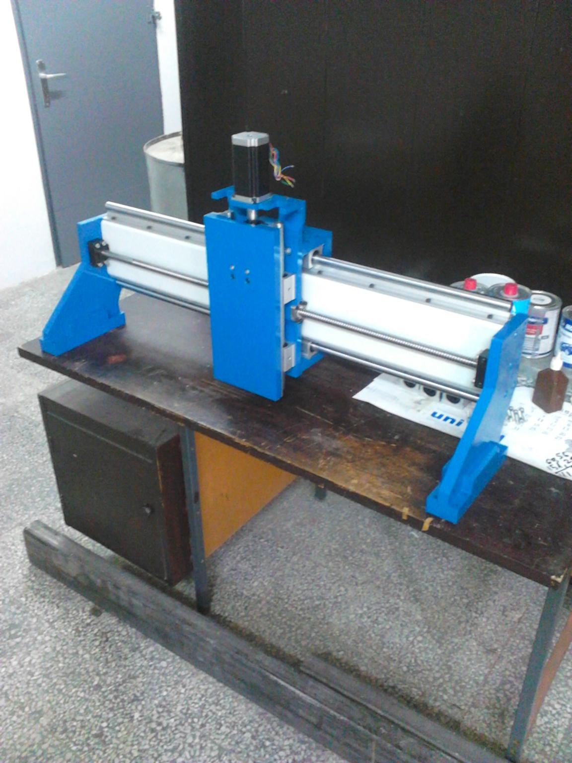

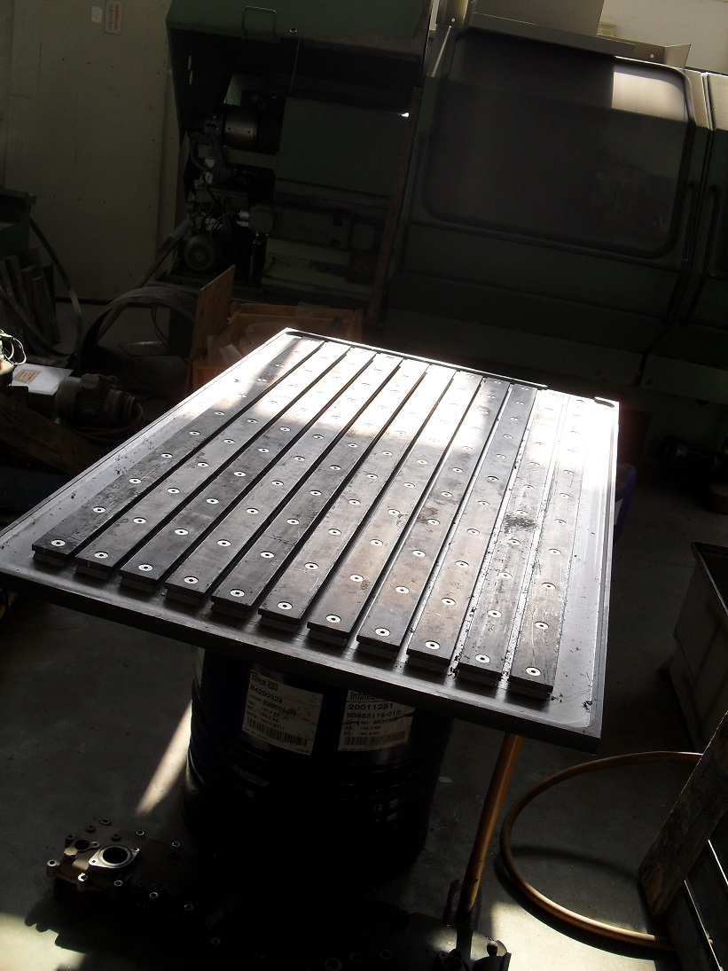

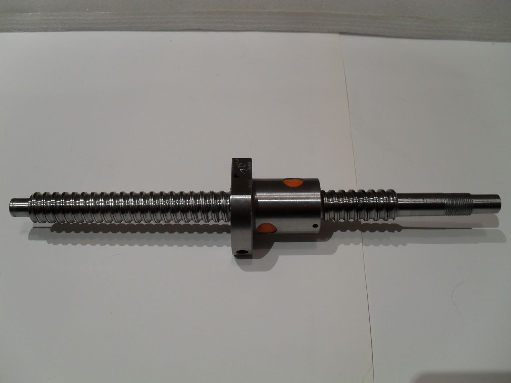

9 Attachment(s)
wow! -- excellent work.
keep the pictures coming
Thank you, I'll make new more quality pictures. These were taken with my phone :)

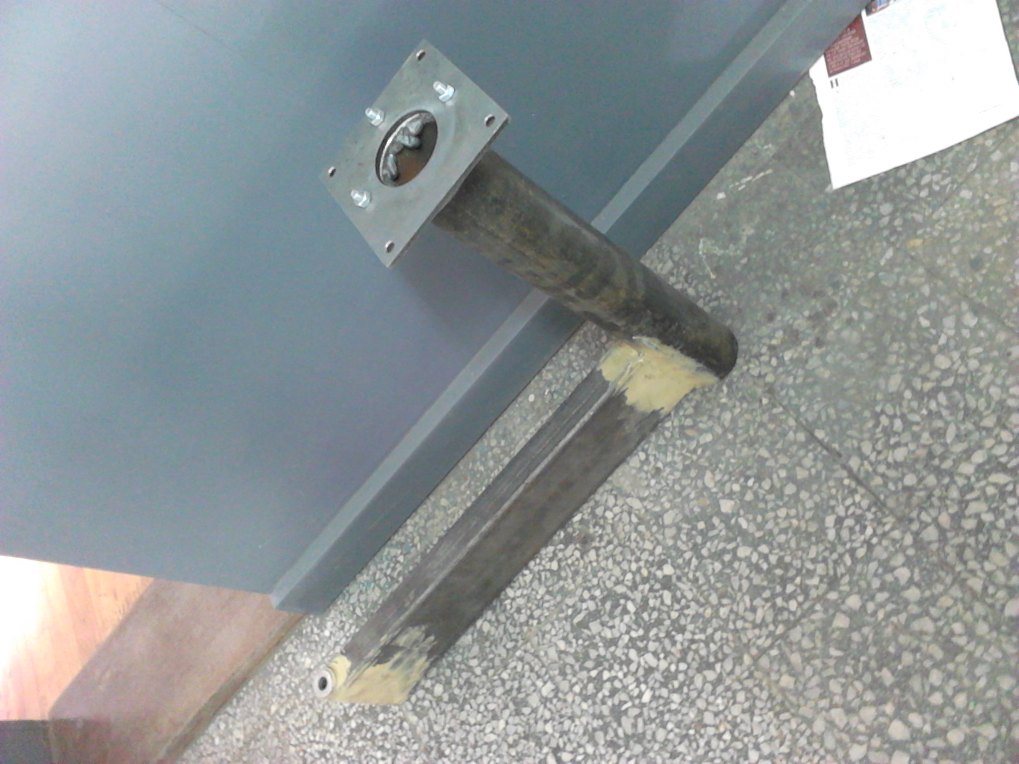

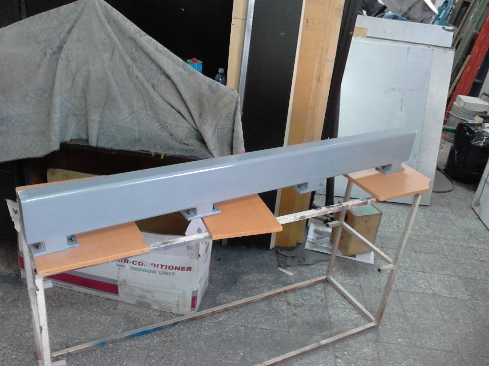

Looks good, how did you join the side plates to the ends of the big box section ? I can see there are 6 bolts used somehow.
EddyCurrent

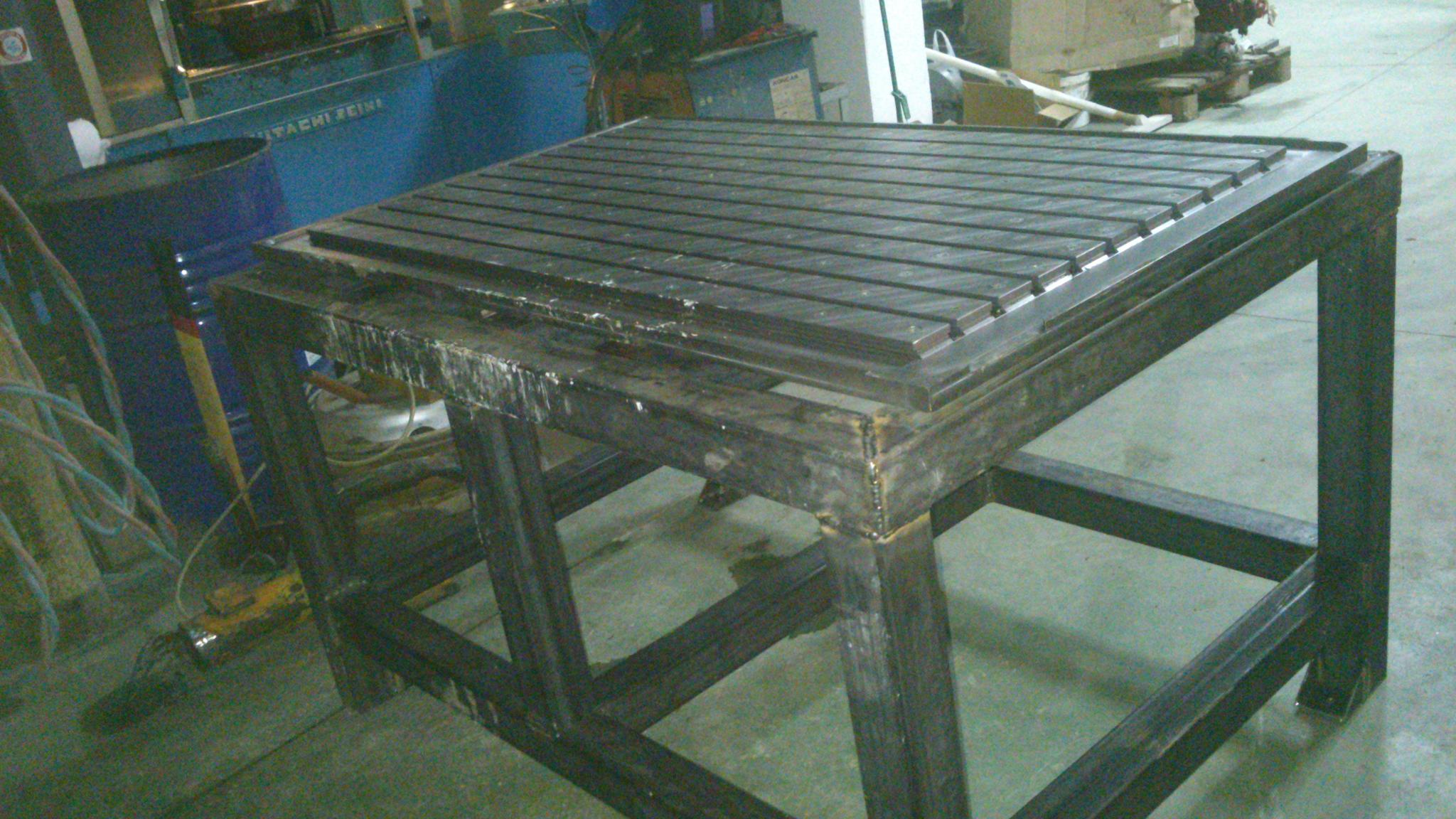

The big box section (140mm x 60mm x 5mm) has welded 12mm steel plates on the both ends. Then the ends are machined to get 90 degree. I used 6 bolts M8 to bolt the sides.

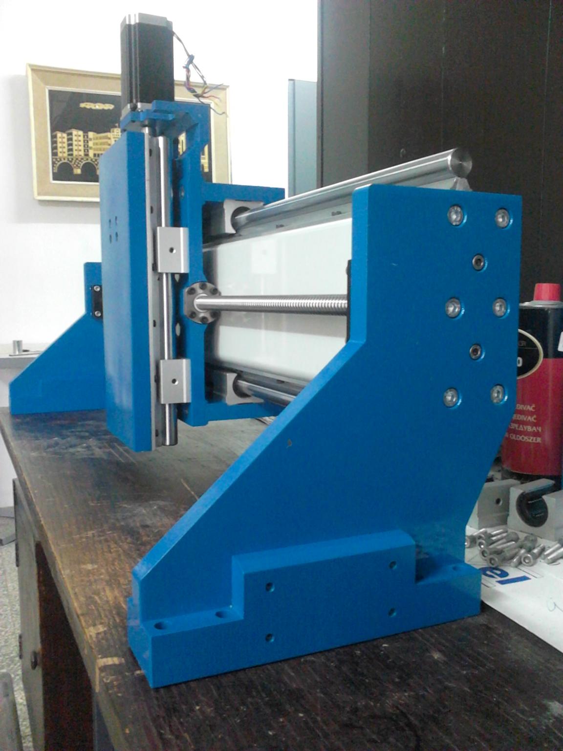

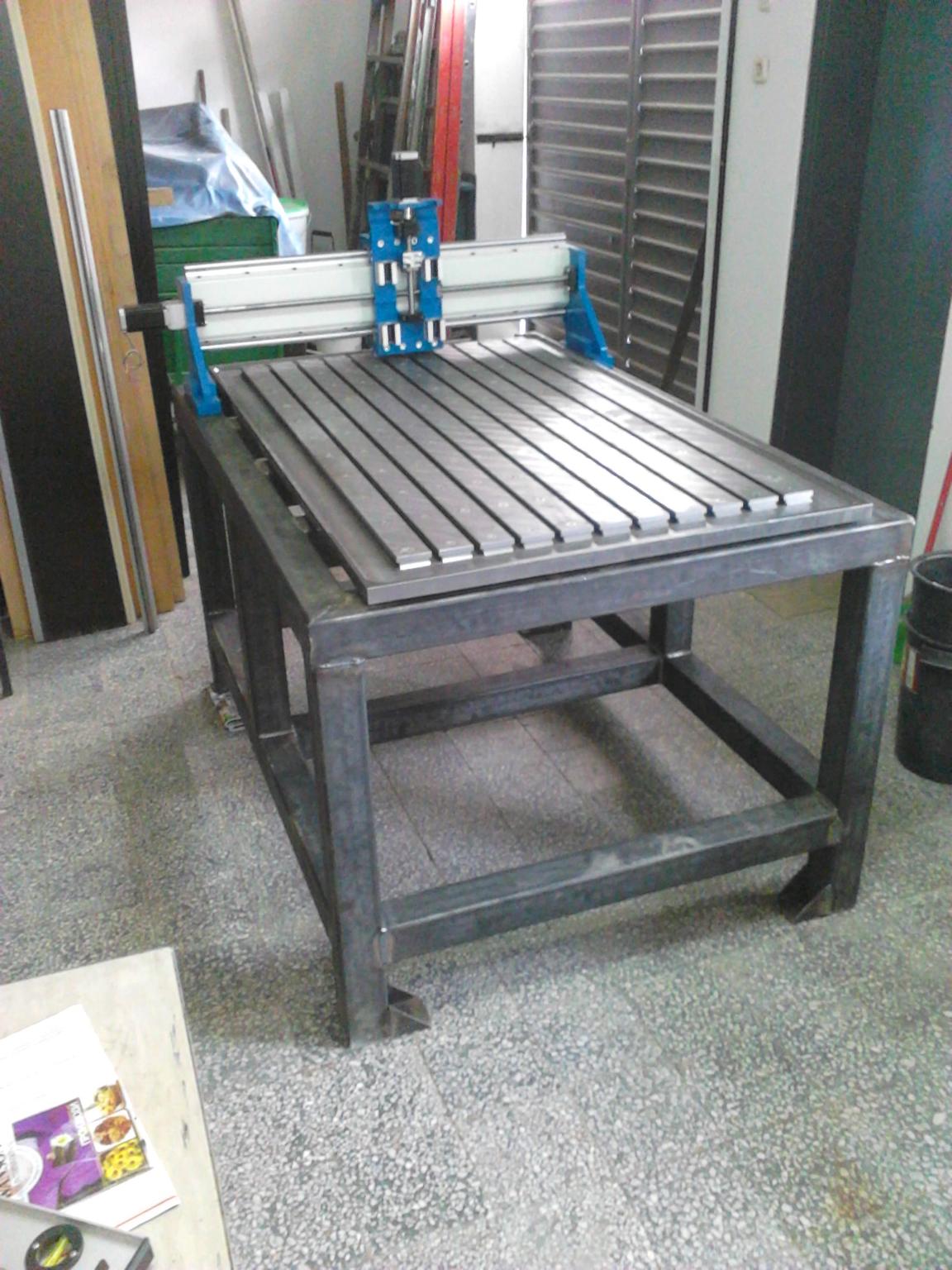

DigiSoft

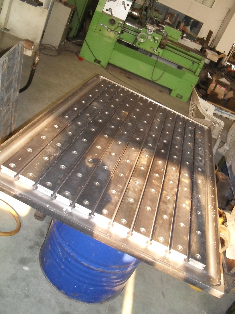

Here is some progress i made so far. Everything is made of steel except the font panel of the Z axis, that is 20mm alu.
Please comment.
Nice Job and like colour it must be heavy thou with those big lumps of steel what weight is it.?
It is around 100 Kg +-10
Tomorrow I'll make quality pictures and I'll take some pictures of few unmounted new parts.
DigiSoft
So with Spindle and other attachments like X ballscrew mounts and cables etc you'll probably be pushing 120Kg+.?? . . .At this weight your going to have to be careful with motor tuning using slaved stepper motors. The inertia of this thing at higher feeds will try pushing like crazy so if your thinking to use machine for router type wood work then you may need to consider servo's.?

Today I ordered steel working table. They will be making T slots in it. I have access to CNC shop with big cnc 2000mm x 2000mm working table. My table will be 1500 x 900mm and around 200KG.
The gantry complete like you said will be around 120kg.
I use RM1605 (5mm pitch / 16mm diameter).
I do not need fast machine. I just want to be stable and precise.

I have made a big progress with my CNC.
The worktable is finished and the construction is welded. It is night so I couldn't make better picture, but in few days I'll post more work progress. Everything is made of steal. Tubes are 80mm x 80mm x 4mm. The worktable is machined from steal.
Overall weight ~ 500KG
Attachment 11751
That is one hell of a substantial frame and bed, I can see why it weighs 500Kg, great job :applause:, pity the pigeon's have shit all down it though :highly_amused:
ahahahahahah it is not from pigeon. It rolled over on the concrete while we tried to turn it up side down :D
7 Attachment(s)
Tidy job but the gantry and supported rails seem quite a bit less substantial than the base and bed, that's not to say it won't perform well.
Next you will have to skim the bed to make sure it's flat.
