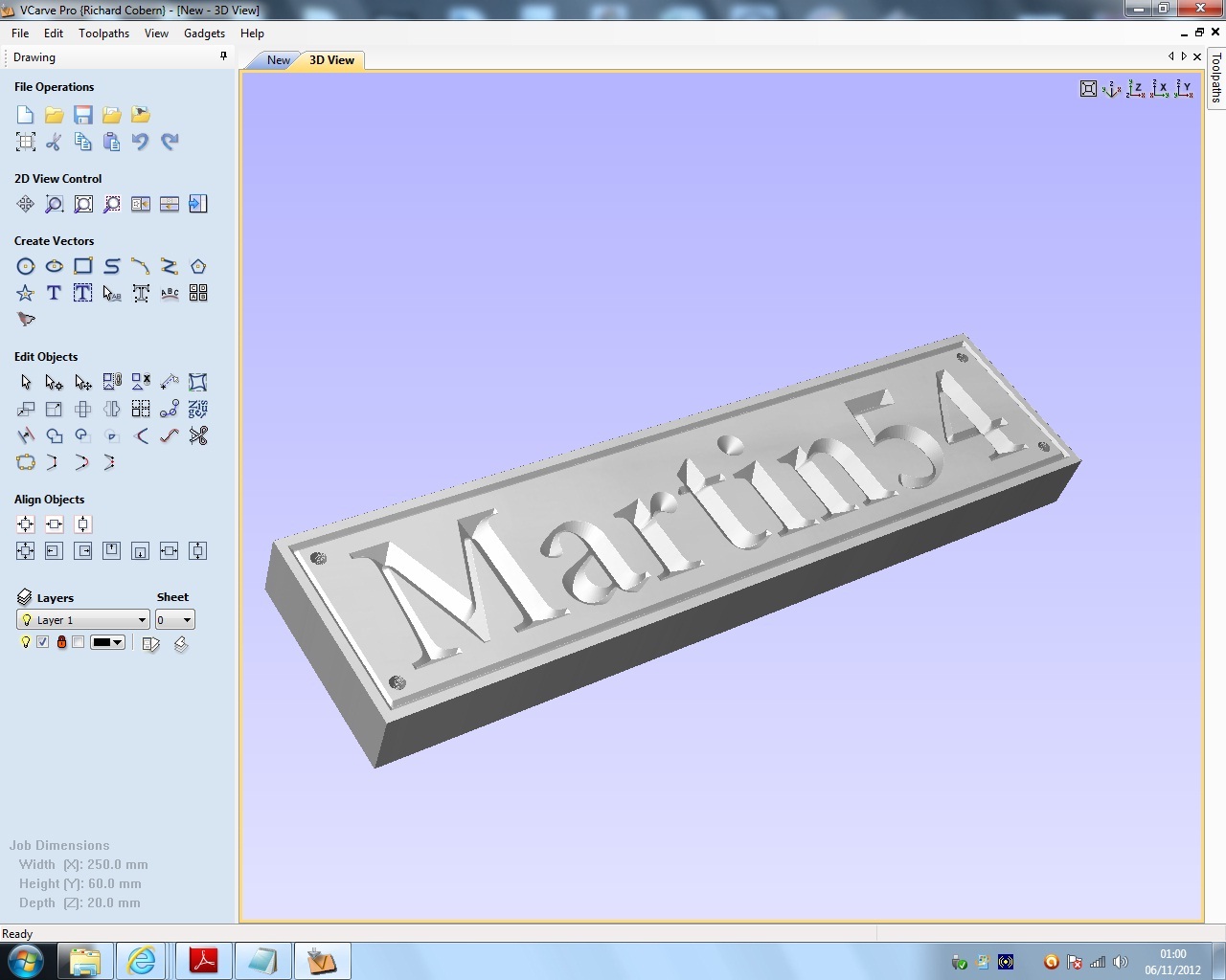

Hey no problem, i dont work for them or anything i was just so impressed with the software...
Attachment 7312
Have a screen shot of a simulation cut anyhow lol
Rick

Rick you need to open the kerning up on that a bit plus it needs a bit more negative space lol
Re: 2D software for newbe
martin54
LOL ... Only ten mins from concept to G-Code, mistakes are to be expected.....

i presume to get the angle in his letters you tell the software you are using a 45 angle bit?
wilfy
Yes you have to specify the dimensions of the tool, which includes the angle. Doesn't have to be 45 degrees...

I am sure there will be lots of people who agree with you Jonathan but personally because I don't want to spend lots of time trying to learn new software & from what I could see cut 2D had some very good support & easy to follow tutorials it fitted the bill for me.
Maybe if I were a bit younger then I would have opted for something else like cambam but unfortunately I don't have anywhere near as many grey cells as I use to have so although I am still happy to try & learn new things it's not as easy as it once was.
I couldnt have put it better myself, I too have less and less time nowadays and learning new stuff is still magic but nowadays i learn what i need, and this in turn gives me the time to do the things i must.

Cambam functions like some dawing programs and once get used to where things are in menus find it`s been reasonably intuitive.
Cut2D shows its roots in software for the sign market and it has nicer 3d visualisations ;-)
2d design likely to have been done outside of CAM program and its ease of depth setting , nesting and tabbing ,guess, are bits going to use most.
