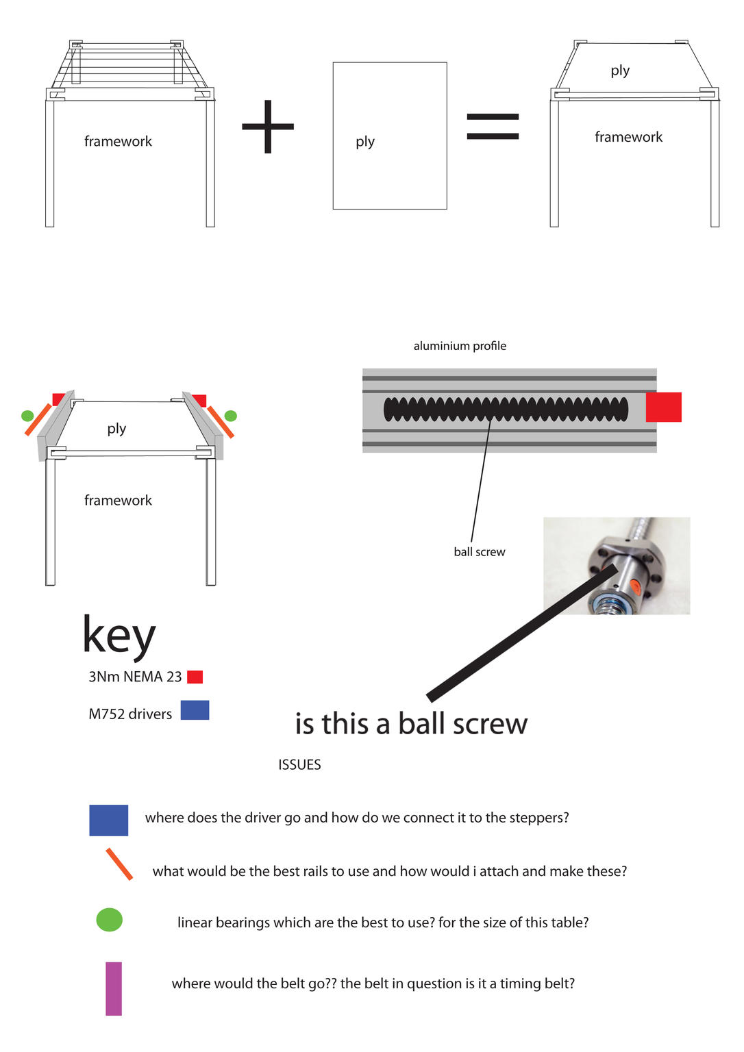

		Hi all,
I have attached the beginning steps to building my cnc machine. I hope to make it approximately 4x3 or 5x3 foot
Attached is the image of the metal fabricated framework, with brackets on each corner which will house the plyboard bed. There will be no top and bottom framework but only on the sides, in order to allow full sheets of boards to be cut continuously hopefully if this can be achieved). If there was framework on all four sides I am limited to that bed space. Is that right?
Also Can anybody give any clues about what stepper motors, ball screws, router, belts if i need any? bearings, tracks, brackets and drivers I would need?
How long would it take to make? and how difficult will it be?
I do think the best way would be to get someone to build it for me.

 If you're going with a frame that big you'll need supporting beams under the bed otherwise you'll get deflection and vibration, cross bracing etc.  I'm presuming that you're making it out of steel?  Box section would be best in terms of strength, something around 50 x 50 x 4.  I'd suggest having a look at Jonathan's build thread to give you some ideas http://www.mycncuk.com/forums/router...-building.html or Bruce's (motoxy) http://www.mycncuk.com/forums/router...challenge.html or one that's just starting is wobblycogs http://www.mycncuk.com/forums/router...s-cnc-mk1.html plenty to chose from ;)
 As a rough guide without knowing too much else (especially your budget) the norm seems to be 3Nm NEMA 23 steppers and something like the M752 drivers (from Zapp), ideally Profiled rail and linear bearings (expensive) or alternatively 25mm supported rail (cheaper) and bearings.  Ballscrews 1610 with anti-backlash ball nuts as you're going up to about 1500mm, anything over this and you'll need to .  Ball screws (2 on the X axis because of the length you want) driven by belts and reduced 2:1 to the stepper.
 How long depends on how deep your pockets are, how much time you have to put into the project, how skilled you are, what tools you have available to use...etc. etc. i.e. how long is a piece of string lol  How difficult is it....again depends on your skill level with tools, ability to learn new things, willingness to learn etc.

		Attachment 7430
Thank you for all your replies, I have looked at all the feedback and redesigned the cnc. Please let me know what you think. If it goes over my budget then its not too much of an issue. just a few issues which I dont understand :
(As mentioned and illustrated on the design attached)
1) where does the driver go and how do we connect it to the steppers?
2) what would be the best rails to use and how would I attach and make these?
3) linear bearings which are the best to use? for the size of this table?
4) where would the belt go?? the belt in question is it a timing belt?
5) Also Im thinking of making the frame stand out of mild steel and the cnc bed frame out of aluminium box section. Would this be okay?
Thank you all!
A lot of people use an old computer case for the electronics so the Power supply, drivers, bob & any control relays would all go in the box. Connected to the motors usually with shielded cable.
Profile rails would be the best but because they tend to be expensive a lot of people use supported rail, the rail is fitted to the machine frame with cap screws or something similar.
I'm new to all this myself but from what I have read 25mm on the longest axis & 20mm supported rail on the other two.
Yes they are timing belts, pulley fitted to each of the motors & ballscrews< the belt fits between the motor & ballscrew to turn the ballscrew.
Yes that would be OK but if you are making the stand from steel why not just make the whole frame from steel. Would be more ridged & probably cheaper to construct.

		Keep reading the build logs and looking closely at the pictures, you will pick it up quickly.
You shouldn't underestimate the importance of rigidity  This isn't just a case of using strong materials, but bracing too. There is no point making a strong gantry if the bed is plywood for example; if the work moves (bed resonates) it is as bad as the cutting head wobbling about. Making a machine to cut wood and plastics is one thing, making it cut aluminium is another so if you don't really need it to cut metal you can save money and design/build time.

		You can do either of 2 things...one is to use a stepper on each X axis ballscrew the other is using pulleys and belts.  running both ballscrews from one stepper.  On the belt one you put a pulley on the end of each ballscrew and one on the stepper and connect them with a belt.  Most people seem to use 5mm pitch HTC belts...
Re: beginning steps to building my cnc
		Belts and pulleys connect the stepper motor to the ballscrew. Some of the advantages are the ability to select the drive ratio, so you can make the motor operate in the optimal region of its speed/torque curve and they help damp vibrations.
