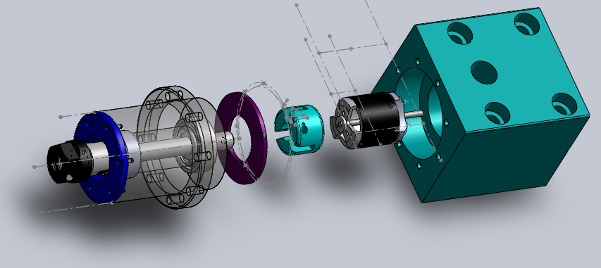

finally recieved all the parts to start designing the spindle, pretty much whats been seen on the forum. Attachment 8129. the motor is a NTM Prodrive 35-42 1000kv unit from HK. Im targeting 12k RPM as its my bearings upper limit, on a yet to be converted ATX PSU.

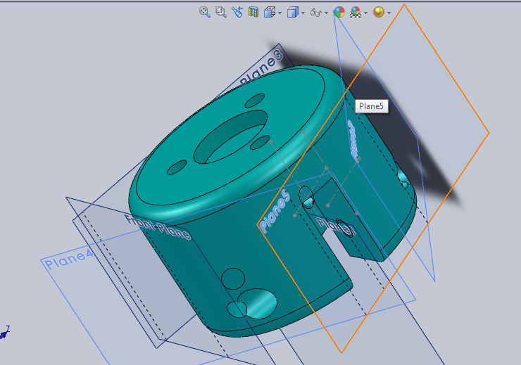

my mistake, it is 1000kv, on a 12v atx PSU. NTM Prop Drive 35-42 Series 1000KV / 700W shaft is 4mm, but im using a coupler bolted to the motor housing & clamped at the ER shaft end.
Attachment 8140
Designing a Metal milling bushless Spindle
Ahhh i seee now! Hopefully you wont get any vibration / miss alignment from the joint, keep us posted!

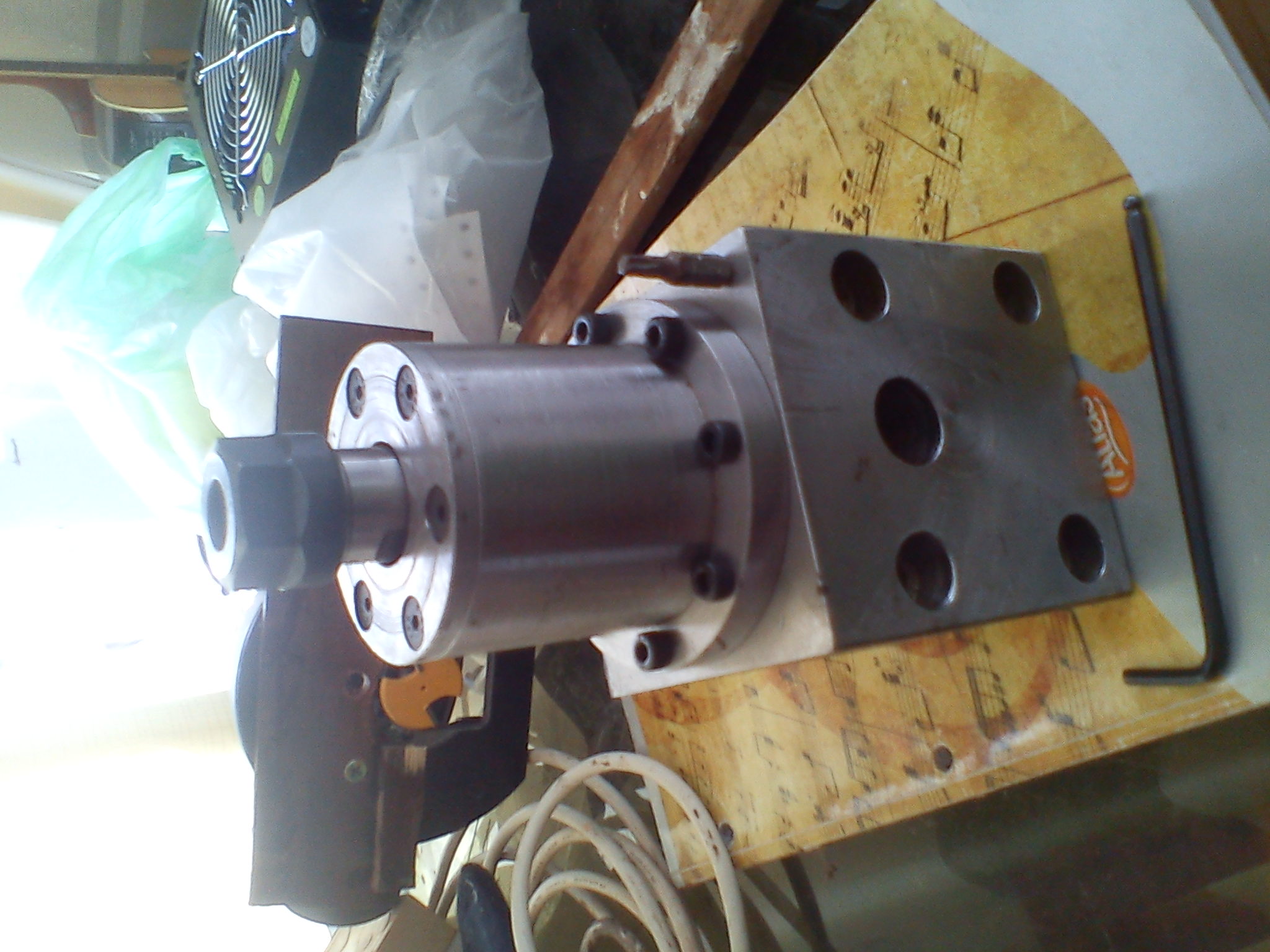

well, i got the spindle done!.. Attachment 8756

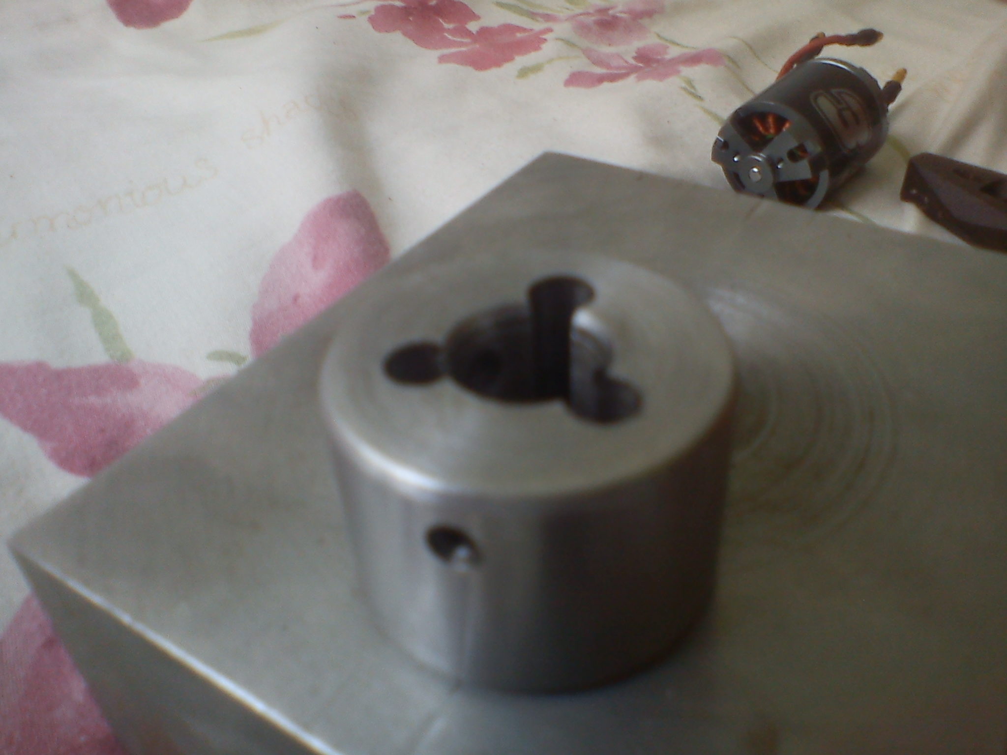

a shot of the coupler, i had to redesign it to clamp the shaft using grub-screws. the entire construction is using EN19.
Attachment 8760

Looking smart! Have you had it running?
How did the converted atx controller go?

thanks, i hav'nt yet converted the ATX so no test run yet, im also anxious to check the runout.
what are you looking to cut with the new design? will it be an ER collet?
much too early, but im looking to order a NTM 5060 & design a unit to hold an Arbour. i really want face milling capability, & ER collets dont seem to have that option.

very nice indeed. what size bearings did you use?
How have you pre-loaded the bearings? For machining metal you would ideally have a decent amount of fixed pre-load but for high speed they are normally spring preloaded. Having said that most of the spindles on ebay etc are spring preloaded and I believe people use them milling metal ok, as with all design its a case of compromise you have to decide how fast you want to cut metal as in reality you will just have to take slower and shallower cuts. This is the same problem I came up against when I was looking at a spindle capable of milling meatal and routing wood. I have put mine on hold as I have decided to go down the adjustable hydraulic pre-load and air/oil lubrication route, which means a lot more work and probably a few trial runs.
With all steel construction how are you going to deal with the heat dissipation at high speed? would a finned Ali housing for the motor be better? or are you using the top as the mount to the machine?
Look forward seeing how you get on with this.
Re: Designing a Metal milling bushless Spindle
@ Ross, im using 2 12mm ID AC bearings up front, Nachi #7201B i think they were. Rear is a 12mm radial bearing.
well, on the preload issue, i've got the bearing pocket slightly undersized in depth & im using a shim between the bearings. preload is by tightening down on the bearing retainer cover. its not very high tech, but i figure im going to run this as is & see how long it lasts. not very scientific i know.
as to the Heat dissapation, ive got one big vent hole to draw in air on the front of the square block with 4 smaller vent holes on the top of the block, where the motor mounts. the square block will bolt into the Z-axis moving plate with 4 bolts.
one thing im worried about is the weight. its at 5kg already, i designed my z axis on 4 THK RSR 9WN's... :dread:

That's the best way to do the pre-load. Most of the high end ones are done that way as it keeps the pressure equal, the draw back is that it is not easy to adjust.
