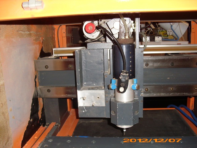

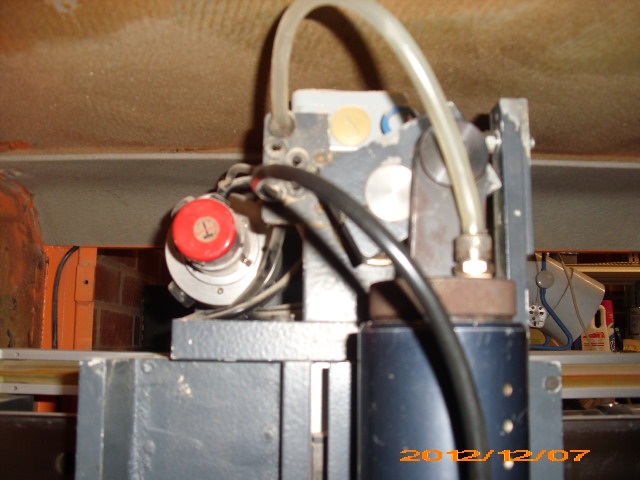

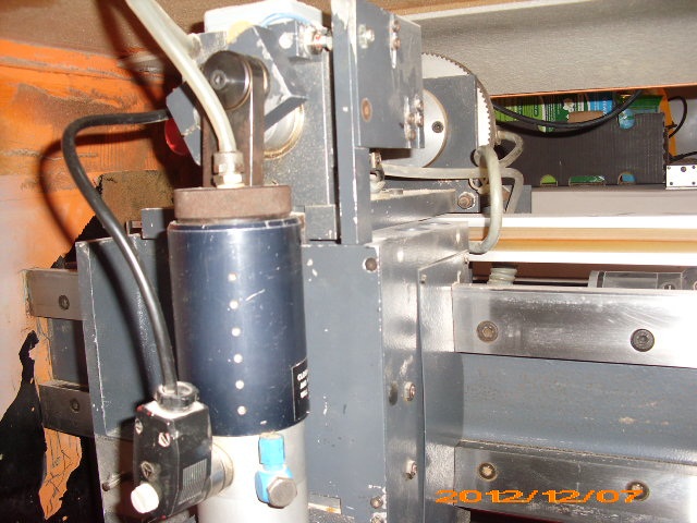

I have a very solid cnc router converted from a pcb drill router. the Z axis is very robust, using a vertical roller bearing slide on each side.
As the machine was not intended for the input of various Z depths it does not have a Z leadscrew, but the axis servo drives a horizontal shaft with a crank and conrod arrangement to drive the Z slide (Ihope that makes sense).
I intend to try to convert the Z axis to ballscrew. At present there is a 24mm hole from top to bottom of the Z slide which houses a spring to help lift the slide on the up stroke. I would like to fit a ball screw through the spring hole, but there is only about 2mm from the back ot the hole to the edge of the slide.
The ideal solution would be to find a ballnut that would fit into the 24mm hole. I think it would be possible to to bore out the top 50mm of the slide to accomodate a nut up to 28mm diameter if the nut flanges did not exceed 28mm. I think it would also be possible to mount the ballscrew offcentre (within the 24mm hole) to permit a larger diameter screw if neccessary.
As the Z stroke will only be about 50mm (total slide length is 205mm) would it be practical to use a fixed bearing at the bottom end (of the static section of the Z axis assembly), the ball nut fixed to the top of the slide, and do away with the top bearing (ie using the ball nut as the top bearing)? Would the Z axis with spindle be too heavy or would I need to incorporate a "helper" spring to lift the axis. Any thoughts would be much appreciated.

Hi Robin,
I have just posted some pictures and did them as a reply to Wilfy.
One of the reasons that I wanted to use a "beefy" leadscrew is because I am hoping to be able to use a ball screw mounted on the top of my Z slide as the top bearing. I don't know if this will work, but intend to drive the screw via a servo/encoder fixed parallel to the spindle and using toothed belt and pulleys.
I would be very interested to hear any comments about this.
Geoff I do of course mean ballscrew nut mounted on the top of my Z slide. G

Geoffrey would there be any chance you could post pictures with the Cam/Motor assembly off the machine with a top down view.
From what I'm seeing then it doesn't look like it will be a massive Job to achieve thou you will need the top of the Ballscrew supported if using Timing pulley setup other wise the tension will obviously try to bend it causing sticking.! You can easily get away with the bottom hanging unsupported but not the top.
Re: leadscrew conversion thoughts
Hi Robin, thanks for the nice comments about my machne. Whilst a bit old and scruffy it really is georgeous(bit like me really).
I actually have a second identical, but unconverted machine which I bought for spares, but am finding it difficult to bring myself to break it up!!!

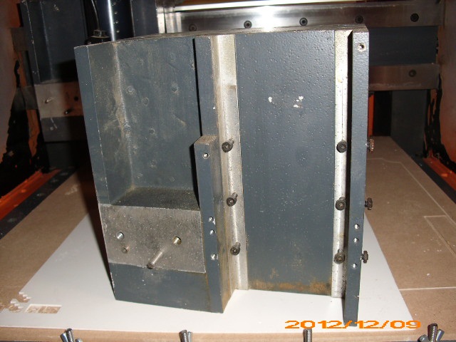

The "spare Z slide is the one pictured in the last couple of pics(you can also see my now completed vacuum table I referred to in my NM introduction).

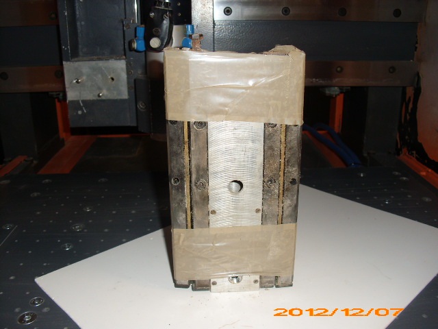

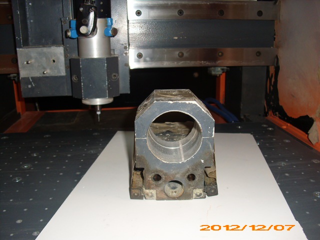

The 24mm hole i referred to is shown clearly in pic 6 and there is in fact plenty of room to bore this out much bigger(I'm getting braver by the day).

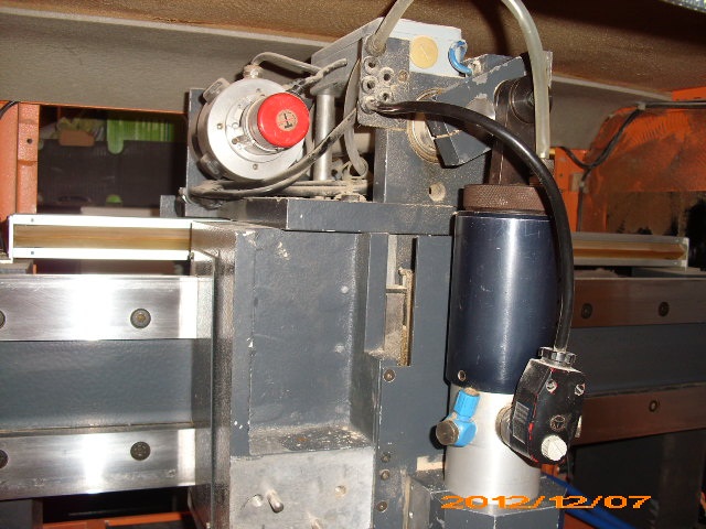

The servo/encoder would be mounted parallel to the spindle almost directly under its existing position(you can see in pic 1 that there is space for it.
The idea of using a very heavy duty leadscrew was to try to virtually eliminate any deflection of the screw as at max Z travel there should never be more than about 60mm of screw poking its head above the slide.

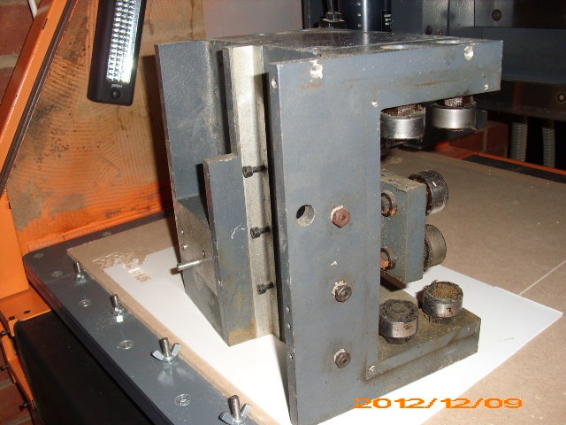

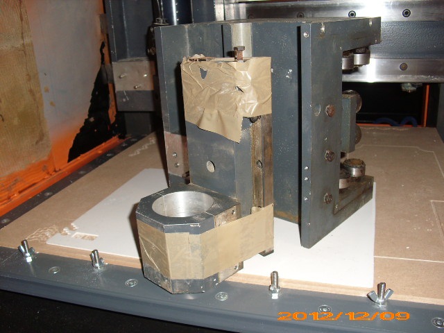

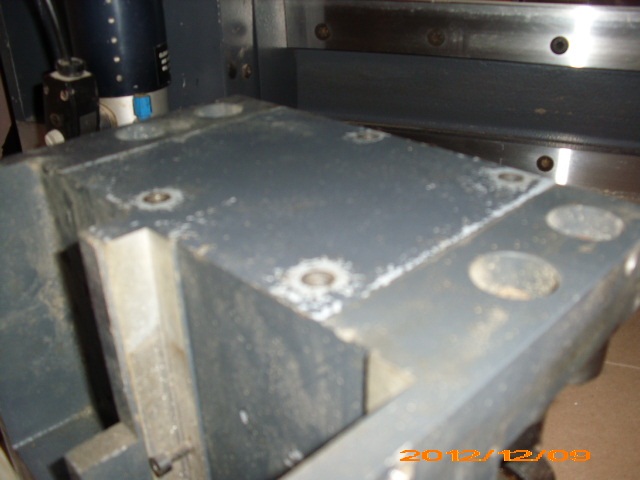

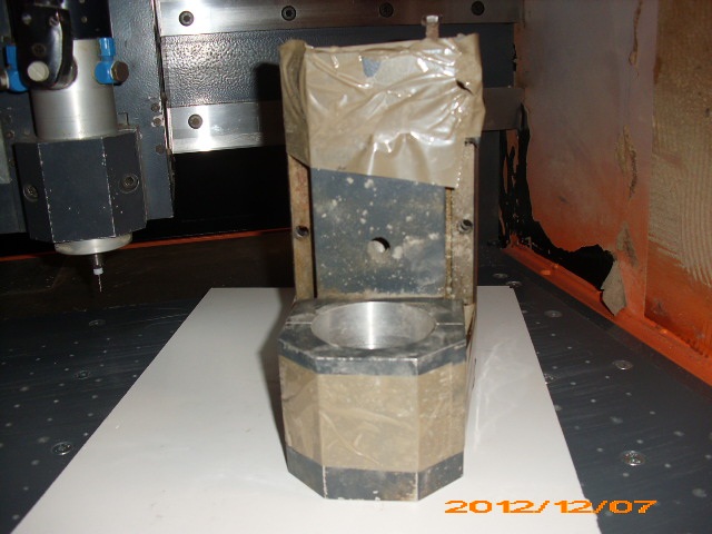

Thanks for your comments, I am posting some pics of my spare carriage so you can see how it travels on the X axis and carries the Z axis slide.
The heavy duty top plate will need to be retained to allow fixing of the X axis ball nut and linear scale. Everything else above that level will be removed.
I like the idea of mounting the Z ball screw nut at the bottom of the slide and fixed bearing to the heavy duty plate, but am a bit concerned that this would leave the ball nut and the end 50/60mm of ball screw exposed to sawdust.

Sorry to be a pain but can you give some top down shots of the spare assembly with Z axis close to in place has possible.
Also of the Z axis like pic 1538 in post #11 but tuther way round.!
Don't think this would be a major job to mount in traditional way but without clear pics of clearances etc then it's difficult to tell.
Thou less than the ideal I'm sure with the width of the Y axis carriage that some form of offset screw could be adapted if needed and eliminate any ugly screw sticking out the bottom and risk of damage to screw.
Jazz, I've read most of your threads, and don't understand how anyone could think you a pain!!!
Seriously tho' I think that the ballnut at the bottom is the best solution, with or without a second bearing.
The top of the Z slide is only 39mm wide (I thought it was wider) with the 24mm hole just 3mmin from the back. The bottom is about 60mm Behind the spindle).
The back of the Z slide fits back (minimum clearance) tight to the X axis carriage.
The 1605 ballnut is 28mm dia so I can offset the leadscrew in the 24mm hole and bore out the bottom of the slide to accomodate the offset and ballnut.
I was worried about the ballnut beig exposed to dust etc.,but the leadscrew will only be exposed when the slide is near the top of its travel.
I will try to assemble the spare Z slide tomorrow and post some pics. Your comments are much appreciated as my original idea w0uld have meant using a
