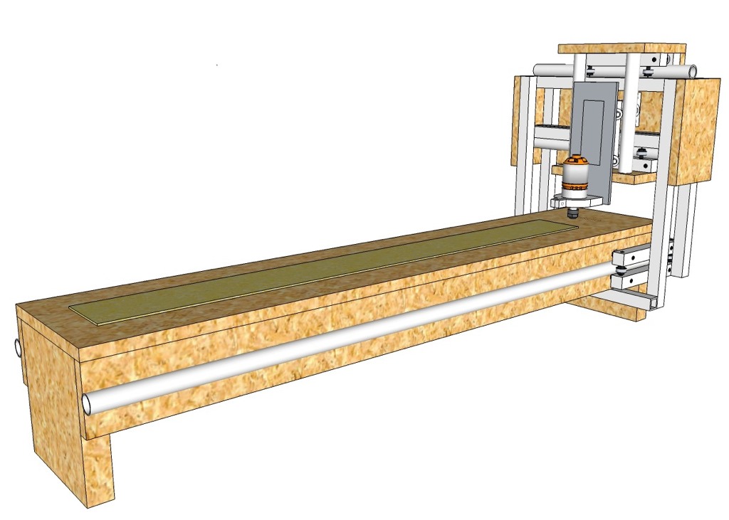

Geoff...Sketchup is easy once you get the hang of it, belows a drawing of my cheap and dirty balsa router I'm making...
Attachment 7565

Well I use it for visualising what I'm proposing to make, I haven't got into it enough to be able to tell you, I'm still learning it and far from proficient!! You can get plugins i believe to export as a DXF and also a STP file.
