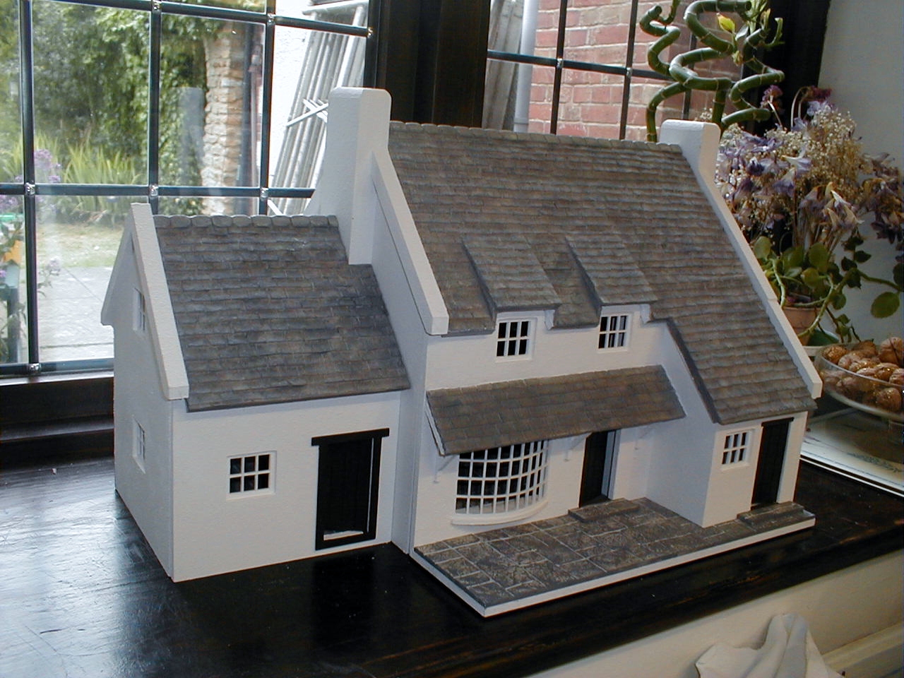

have you guys got any pics of foamex things you have cut?
Re: foamex... to cnc or not??
Hi Wilfy
I made some 1/24th scale dolls houses and the bow window is cut (on my cnc router) from 2.5mm foamex board.
Sorry the picture quality is not the best.
Geoff
Attachment 7554
oh my word that is amazing... the thought that i'll have a machine soon that could achieve something like this just blows my mind .. thank you so much for the picture

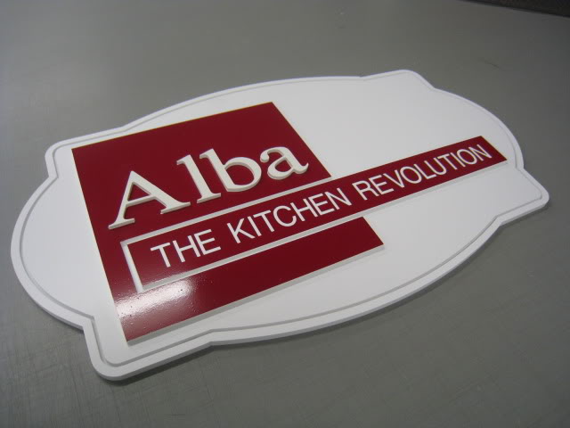

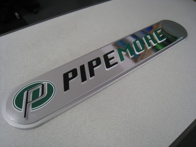

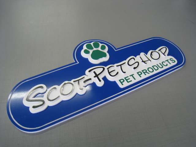

As has been said foamex is easy to cut on a cnc machine, the images below are all a combination of foam & vinyl produced on an MDF machine by a signmaker I know.
Attachment 7556Attachment 7557Attachment 7558

Yes, the dolls house carcase is cut from 6mm mdf. The roof tiles are a cast resin panel made in a silicon mould from a master cut from thin ply. The doors were cut and engraved (1.6mm ply) and the bow window foamex.
The other windows were proprietary plastic ones. I no longer use these windows as I cut all my flat windows in 1.6mm ply. My wife does the decoration. Glad you like it.

that house is awesome, i first read it that the whole thing was made out of foamex.. but only as thats what i wanted to hear/see. when you say the bay window is foamex are you talking the whole panel with the wall?? or just literally that thin frame of a window?
Only the bay window was cut from foamex to enable me to "flex" it into the required shape. The mdf was cut using a 3.175 cutter and the foamex/ply with 1mm.
