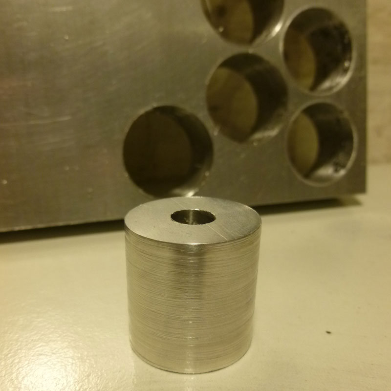

>Wouldn't an easier solution to your 25mm dia Ali bits you're painfully cutting out if plate have been to buy 25mm round Ali, cut to length, mark the centre and drill?
Maybe, but I don't have a metal saw - at least this way I can be sure that each spacer is an identical height - buying stock cut to length is always a bit hit and miss... The guide bit drills the centre hole too! Bonus.
Yep, it's a pain - but on the next batch I'm going to try drilling a guide hole straight through, cut from one side, flip, re-align and from the other side. It's the swarf not rising cleanly out of the cut after 15mm or so of depth that's making this job a pain - flipping the piece should solve the problem. I can only hope!

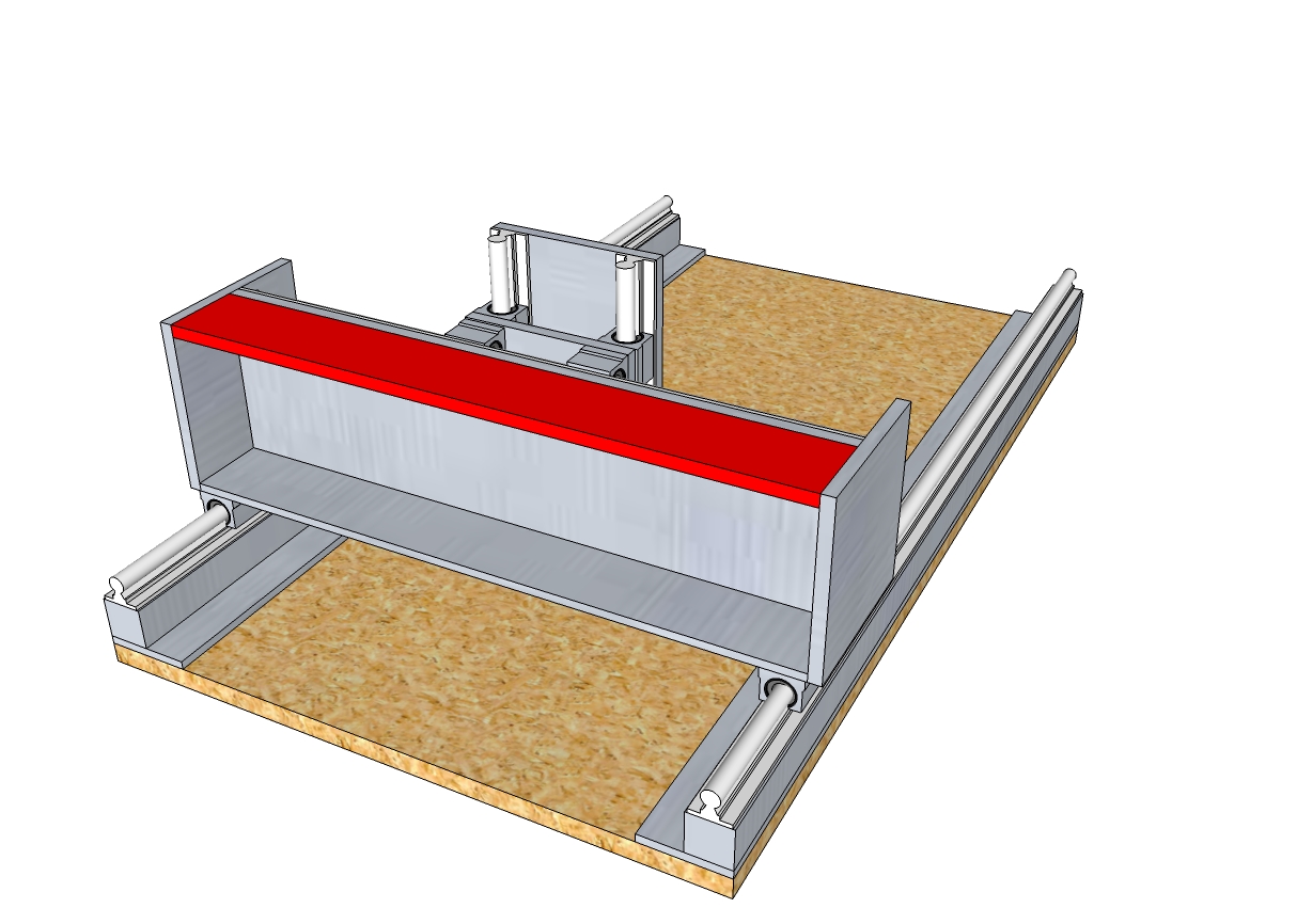

Not sure how you're doing your Z axis but if you put some bracing across the top it will stiffen it right up, something like this....
Attachment 7724
Probably need to put a brave in between the top and bottom in the middle to stop vibrations too...

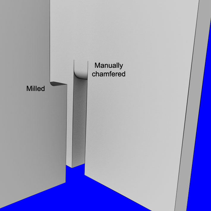

Some questions so far.
I'm using 15mm 6082 aluminium plate for this build. I'm hoping to use M8 35mm hex socket head cap screws to bolt this all together, which means the screws will bite 20mm of the thread I'll tap into the plate edges. Does this depth sound robust enough? Is M8 too big for the edge of 15mm plate?
To allow for a bit of adjustment I'll be making the holes in the face of the plates 10mm in diameter so there will be a bit of slop to play with before torquing everything up once it's all aligned. Does this sound okay?
Where there are slots cut for plate to pass through (the arm which passes through the side-plate, for example) - rather than cut this slot to be exactly 15mm wide, should I make it slightly wider (say 15.25mm) to ensure that the plate passes through okay? .25mm too much?
Obviously there won't be any internal right-angles because the end mill will have a radius. Where there's a square edge that fouls a radius, I'll manually chamfer off the corner to make it fit (see pic below).
M6 or M8 will be fine and 20mm thread is plenty.

Not so much to do with mechanical strength but dealing with or lessoning resonances the machine makes. Any resonance or vibrations will ultimately end up at the cutter giving a poorer finish. If bad it can even affect performance of the machine by throwing the motors into a Cissy fit.!!
Bracing here(See pic blue bit) on gantry and else where on the machines frame help dampen them out.
