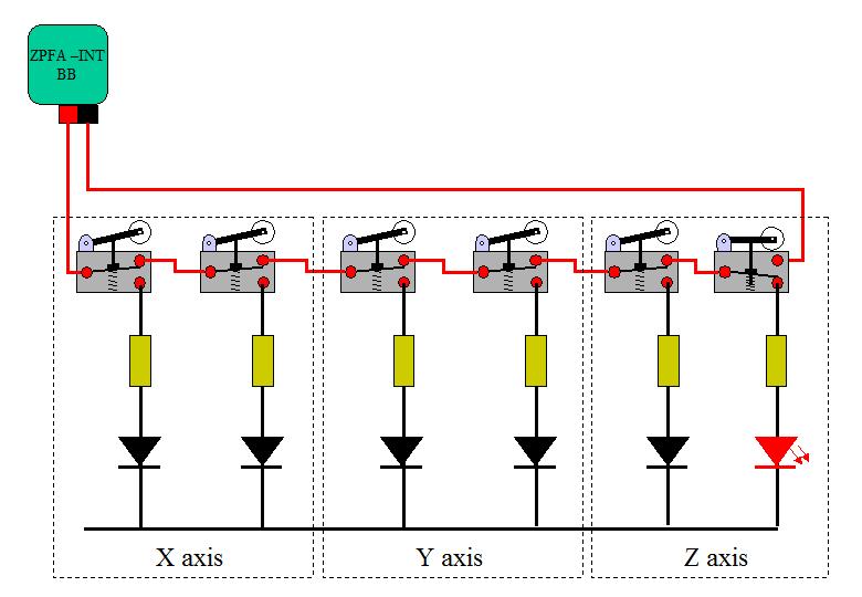

I intend, hopefully to install "Maximum Travel" limit switches to the X,Y & Z axis of my Hobbymat Milling machine, which i am currently converting to CNC control.
The Stepper Drivers are PM 542's and a ZP5A-INT Breakout Board, it looks like there are I/O's for 3 limit switches and a "E" stop on the Breakout board.
It would be nice to have a separate box containing the LED's and there corresponding resistors, which obviously would give an immediate visual indication as to which switch is made.
I understand so far that the Switch cables should be shielded, and the switches should be NC, i am not sure of the exact volts and current from the Breakout board, as the paperwork is not very user friendly.
If possible, it would be nice to have Green LED's that turn Red when the Limits are made.

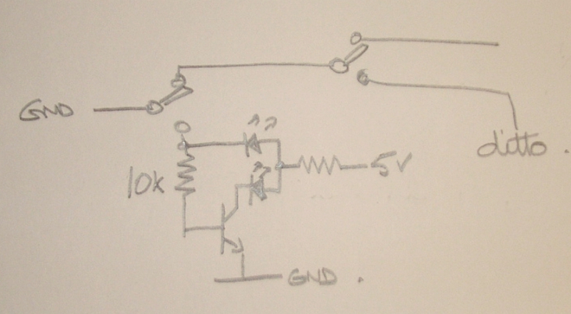

I am a dinosaur when it comes to transistors, how about a BC547.
Assuming 20mA to drive the LED and a 1.2 Volt drop across it, about 190 Ohms for the resistor.
I drew it up to minimise the component count, when the transistor switches on the Volts it has to play with fall away, may need a third resistor so don't lay any PCB's until you have tried it.
Personally I'd have gone with a resistor for each LED (to get their respective brightnesses balanced right)...therefore I'd connect the common anode direct to 5V & then place a current limiting resistor in each of the the LED cathode legs (the fwd voltage of a red led is about 2V, whereas a green led is about 3.2V ...therefore to get the right level balanced you'll likely need different value resistors).
Also 20mA - depending on LED - is gonna be very bright, I'd have aimed for 10mA or less.
Edit: Actually the way Robin has drawn it, for the red led you'll get a drop across the tranny itself, which pretty much balances the fwd voltage difference out for the red & green LEDs, so you may get away with a 180R single resistor for both....a 180R resistor will yield about 10mA through the LEDs

I have attached a PowerPoint Drawing, which is my interpretation of your drawing, which contains everything i know so far. Would you be kind enough to go over it, and advise me if it would work or not?
RayAttachment 7794
So you don't have a seperate ground.
That means every LED up stream of the one that goes red will go out.
If you accept that limitation, dump the transistor and the 10k resistor, not required.
Connect one LED cathode to NO, one cathode to NC and the common anode to your 190 ohm off 5V.
If you're happy with just one colour LED - i.e. red when the switch is pressed, off otherwise, which basically tells you the same thing as having red/green, then it's a lot simpler. Just put an LED with series resistor in parallel with each switch.
Since you will use normally closed switches, when the switch is open (pressed) the supply voltage to the switches is now present across the switch, so will light the LED. If multiple switches are pressed, the same is true except the voltage is now divided by the number of switches that are pressed so the LEDs would be dim, hence you need to choose the resistor values carefully. If you're happy with that limitation then this is a simple solution to implement, but for the sake of one extra component Robin's solution is better.

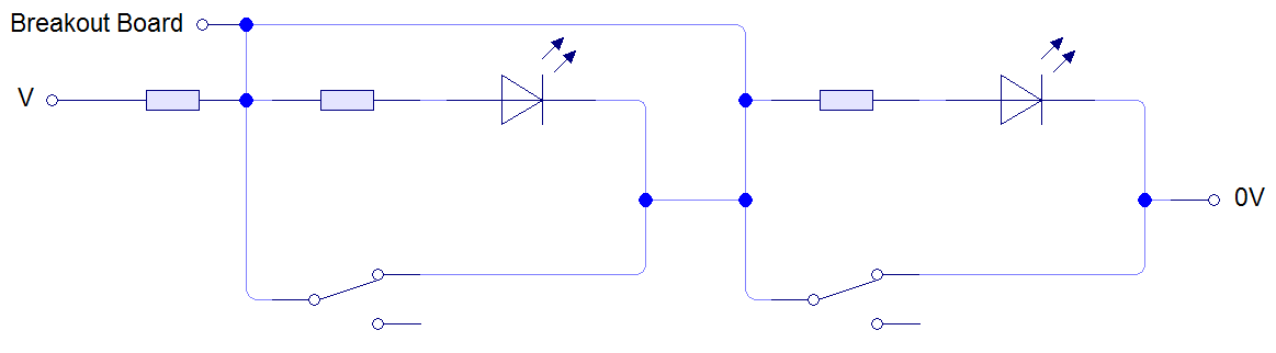

Good try, but what happens if two switches open?
Will 2 diodes and two resistors all in series sink enough curent to switch the Bob?
How about three?
Edit: I'm not explaining that very well am I? You aren't actually breaking the circuit, you are still requiring current to flow and light the LED's.
No, perfectly well.
I put this diagram in the previous post, but immediately deleted it as I realised the problem you mentioned:
Attachment 7800
If V=5V, then when one switch is pressed the voltage at the node the breakout board is connected to will be the forward voltage of the LED, so about 2.1V, plus the voltage of the resistor. As you say that's probably acceptable with just one switch pressed, but still more susceptible to interference and probably not going to work with more.
We can fix this by increasing V, to say 24V, and connecting the breakout board via an op-amp used as a comparator. Set the threshold of the comparator to be just under the voltage present when one switch is pressed, then any number of switches are pressed the comparator output will switch. I guess that does loose the simplicity...I'd do it your way, except I don't really see the point of adding LEDs!

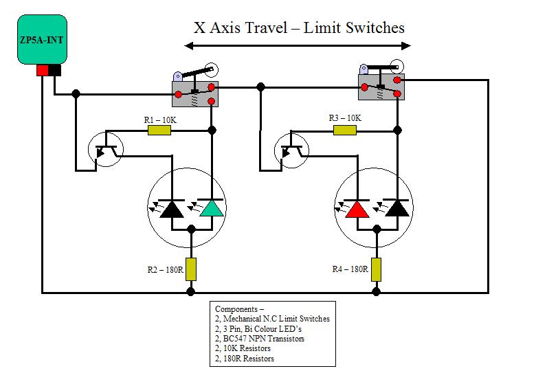

Attachment 7801This is my latest interpration, do you think it will work, i realise that the only LED to illuminate will be the one on the activated switch.

I can't comment on your circuit because I still don't know what is coming out of the Bob.
The plan above won't work as having just checked the datasheet for the BOB, the limit switch input is gets pulled to ground, so it won't provde enough power to light up anything, and adding LEDs in that way will probably be enough to pull it to ground.
Using some kind of high impedence sensing is the only way to make this work without affecting the BOB input.

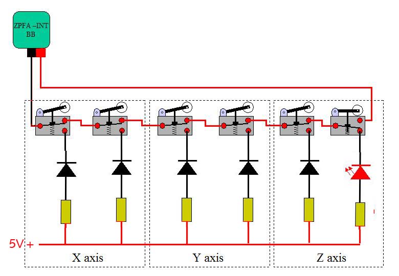

Can't he just use a separate 5V supply and use the NO contact to make the circuit when the switch trips.? Simplizz enough to me.!!
Edit: Like this.? Attachment 7817
Ray the same 5V supply that powers the Bob would work just take another feed from it.
Or, use a double throw microswitch and have red green on every switch, fully independant and all on one 3 wire loop, easy peasy.

Many thanks again, will this stop the machine from moving if activated.?
Ray
Yes Ray machine will stop and the relevant tripped switch LED turn on.
Easy to test off machine just run 5V+ wire from PSU to LED/resistor then thru NO contact of switch that Neg (-) is connected to BOB (-). the BOB will return to Ground of the PSU.
If it works Mach will go into reset and the LED light up while switch held in.
