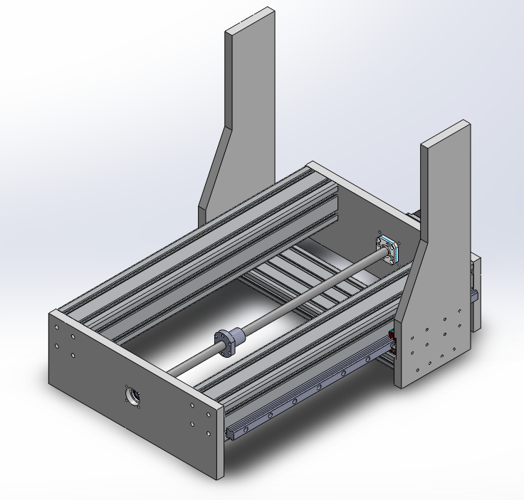

I have the beginnings of a design in Solidworks at the moment. I am hoping to cut Aluminium with the machine so coming up with a strong and rigid design is important. So far it looks as if I will be using a mixture of Aluminium plate and Extrusion for the frame along with Hiwin 20mm Linear rails, RM1605 Ballscrews and probably a Bosch 1617 Router (imported from the USA). Hopefully I will post my own build log soon.

		Finally got some time to myself and had chance to get back into Solidworks. Here's a very early sneak peak!...you get the gist! I will start a build log when I get some time.
Attachment 7815

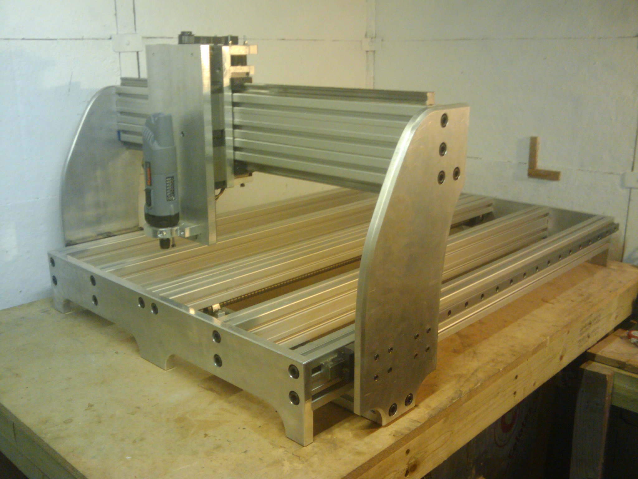

		So then some thing like the one I Prepared earlier.!!Attachment 7816
To be honest thou if you use this type design then it's mainly a wood machine and won't do aluminium to the best standards.

		Nice design! I won't be doing lots of aluminium to any particular high standard but I would like the capability. Out of interest, did you machine those aluminium parts yourself or have them done externally? (manual/cnc?).

		Yep my design made by me for someone else.!
Edit: Here's some more pics  i've posted before of various bits of different machines built on the same design.
I've built 2 versions one that had the motors on out side like Pic 1 & 2 and also version were the motors are all turned inboard or under bed like in pics 5 & 6 to fit in confined space like the corner of a shed.
I also have version that use's twin screws on long X axis with shorter stubby sides if just doing thin materials and bit more capable at handling Ali with decent results and feed rates.

		Thanks for picture 5 Jazz. I've only seen the 'L' gantry as drawings before. Nice to see everything in real, like how the motors are supported and fixing of the ball screw behind the gantry.

		How thick are the aluminium 'uprights' if you don't mind me asking? I'm looking to use ~18mm at the moment but they look slightly thicker?

 They are 19mm from cut from 3/4" x 12" plate from here. Aluminium Flat Bar - Imperial Sizes (6082T6) 12 in x 3/4 in
