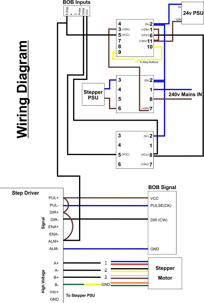

Hey folks,
I'm wanting to double check I've got this right before wiring it up.
The AM882 has an alarm signal output that triggers when the driver goes into a fault state. The object here is I want that signal to be picked up on one of the BOB inputs so Mach can trigger an estop and halt the other drivers.
Here's the an image of what Leadshine suggests in the manual.
Attachment 7875
And here's a crude wiring drawing that I've knocked up to stick on the inside of the control box for quick reference (please ignore the extra details such as the relays and stepper wiring)
Attachment 7876
Will that work?
Re: Wiring up the Alarm output on Leadshine AM882
Loose the brown link wire to alarm.
you are feeding it V+ from this and then to ground. when it triggers it will be a dead short.
You want e stop to go to one alarm terminal then to ground.
Basically alarm is in series with the estop
Thanks John.
Not sure I completely understand but had a go at updating.
Is this what you were getting at?
It should be noted that the Alarm+ outputs 30v 100mA and Alarm- is 0v so I don't think I've done this right.
Shinobiwan
In which case feed the E Stop circuit through a set of relay NC contacts and the alarm + and - to that relay coil.
Connect all 3 drivers to the same coil and then it doesn't matter which one trips.
Driver alarms, switches the relay and breaks the E Stop. - Simples.
The alarm terminals don't output any power. It's an open collector output capable of switching 100mA at 30V.
So you still need a relay as per John's suggestion to connect into to the Estop circuit, but you need to provide the power to the relay, then connect the relay to ground via the alarm terminals. You could also have the relay in circuit after the alarm terminals, but it's usually better practice to switch the ground side in electronics.

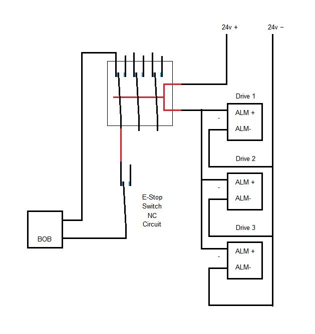

Ohh thought I'd got it then. I'm missing something here so would someone be kind enough to just put me out my misery and scribble the correct way over the top my drawing please.
Shinobiwan
Ok I think this is how it would be wired but you better confirm that with the gurus..
Attachment 7893
Sorry its crude but ive just got home from work.. I think you will understand it.
Rick
Thanks Rick,
Have I interpreted it correctly?
Shinobiwan
Thanks Rick,
Yep I think you have, although on my machines i always make the Estop ring as normaly closed ie you break the loop to Impose a condition, the reason for this is if a wire or connection breaks or the power fails or a component fails it will always break the circuit, showing an alarm condition. so all respective relays are energised giving closed condition for normal. this basicly gives me a circuit that is broken in the event of component failure or activation. the other way would not alarm in the event of a broken wire or failed component.
Remember to check it with the Gurus though..
Rick
OK will hope someone can confirm if this will work. I still have doubts about what I've drawn there. I know just enough to be dangerous!
Either way of wiring in the relay would work. Your first diagram switched the high (positive) side, and your second switched the low (negative/gnd) side.
Only thing that threw me was the markings on your relays. Vcc is a supply voltage in electronics, whereas you've used it for the contacts.
Ricardoco is right that e-stop circuits should be fail safe. For the actual e-stop button circuit, the relay should be active when the e-stop circuit is not in stop condition, with the BOB e-stop wires going through a pair of NO (Normally Open) contacts. That way if anything fails, the machine stops.
With the drive alarm function, a truly failsafe method is not possible due to the fact the alarm only activates when there is a fault, so you need to implement a system that relies on relays/wiring working when there is a fault. This isn't quite as big an issue on the alarm funcion, as a failure to stop when a drive faults out isn't as major a safety issue. At worst two axis keep moving, while one sits still.

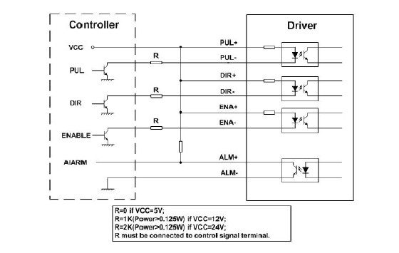

I thought I'd bounce this thread as I have a question related to the ALM output from a Leadshine drive (EM806, which is pretty much an upgraded AM882).
Is it safe to wire the ALM straight to a PIC pin, or should I use another (opto) transistor in the middle somewhere to isolate the two?
Regards,
T.
The Fault ouput is Open Collector, so provided there's not an issue with wires being connected wrongly, then you can connect it directly.
If noise is an issue, or the possibility of wires being connected wrongly, then having an opto would likely be beneficial.

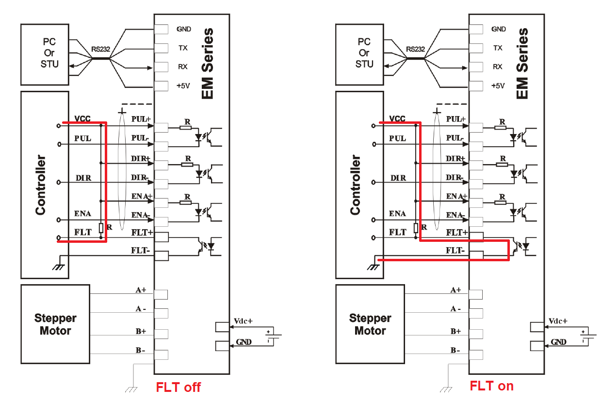

The Fault output on the EM806 (i guess that's what you mean by the Alarm output) is a floating optoisolated transistor. You could do it two ways:
1. Flt+ to PIC Vcc, Flt- to the input pin and a 1k resistor from input to PIC ground. Input will go low on fault; or
2. Flt+ to PIC input, Flt- to PIC ground, 4k7 resistor from PIC Input to PIC VCC. Input goes high on fault.
Wouldn't using an internal pull up be just as easy?
Looking at the diagram in the manual again, I thought that if I use R = 4.7k, the PIC pin will see 5V when the FLT output is disabled, and 0V when the FLT output is enabled. With nothing passing through the FLT optotransistor in the EM806 ie. with no fault, the PIC pin should see 5VDC on the input, if the FLT optotransistor is enabled, it would pass current down to 0VDC, thus bringing the PIC pin down to 0VDC. Or am I missing something?
Regards,
T.

dsc
Regards,
T.
That was my option 2 and will work fine, but if you read page 3 of the manual you'll see it says that the output is low impedance in normal operation and goes high when there's a fault, i.e. the logic is reversed. The reason for this is if you put the pullup at the controller end and the cable gets broken or disconnected you get a fault condition.
@m_c you could use internal weak pull_up but needs to be turned on in s/w and is only 10k so more susceptible to noise in this environment. Indeed on reflection I'd probably use a 1k external pull_up for just that reason.
