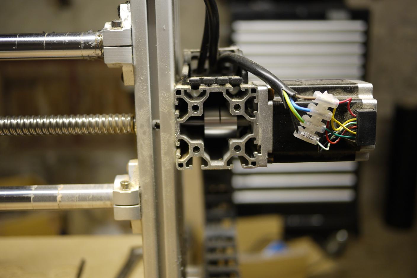

I have been aware of the fact that there are no thrust bearings or any sort of proper ballscrew mounts on my marchant dice router. Up until now it ain't been much of an issue as I was cutting soft mdf and plastic at slow speed. Last week I had a job to cut some birch and I noticed the accuracy to a hit. All my dimensions were consitently off by 0.4mm or so, regardless of the length of the dimension, this sound like backlash. The couplers are tight so I reckon it is due to the fact that the ballscrew does not have a thrust bearing and the design realise completly on the stepper motor resisting the force on the ballscrew. The stepper won't do this as I was expecting, so I think I will prob need some proper mounts.
Has anyone else got a marchant dice A4 sized router with the same prob?
Here is a pic of the current setup. x,y and z are all indentical.
The x axis ballscrew end arrived bent and the coupler had a lot of runout in the machining, so much so that it wiggles the stepper motor a lot as the axis is moved.
Attachment 7936

If you grab the ballscrew by hand can you get any play in it by trying to move towards and away from the stepper?
Yes lots, prob over a mm. :(
If the shaft is bent and directly affecting the stepper then it will eventually knacker up the stepper motor as well.
I know its only a matter of time before it knackers the motor. I actually completely rebuilt the machine last week, had the ball screw in the lathe to check the runout on the ends, straighten it out as best I could. A new coupler would help matters as most of the runout is in the coupler. Actually I thought to myself Ill get some oldham couplers, then I relised I couldn't because the coupler needs to be ridged to work as the motor is holding the screw in place, pretty crap huh.

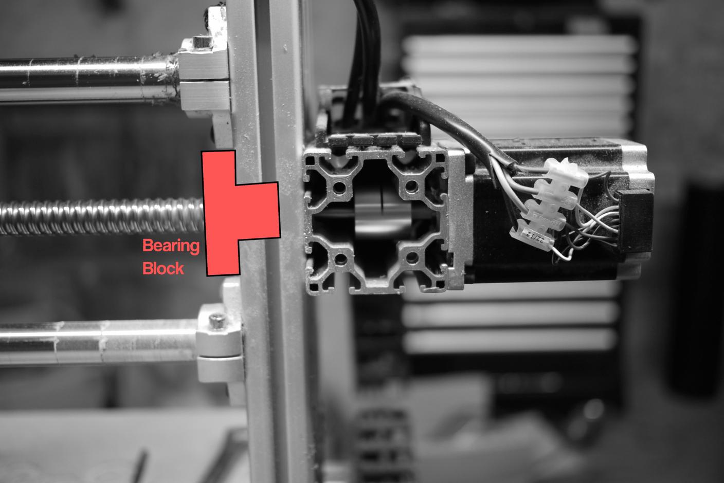

Attachment 7937
If I could fit a block in the inside like this I could retain the same mounting block for the motor. I would be a little hesitant about milling into the aluminium extrusion as I don't have a mill.
Re: Marchant Dice router no thrust bearings?
Yes that should do the trick. Didnt know if you could get it on the inside but if you have enough space that would do. Cant you mill it on your machine?

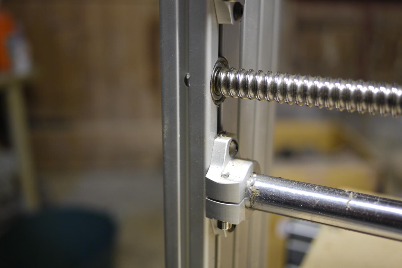

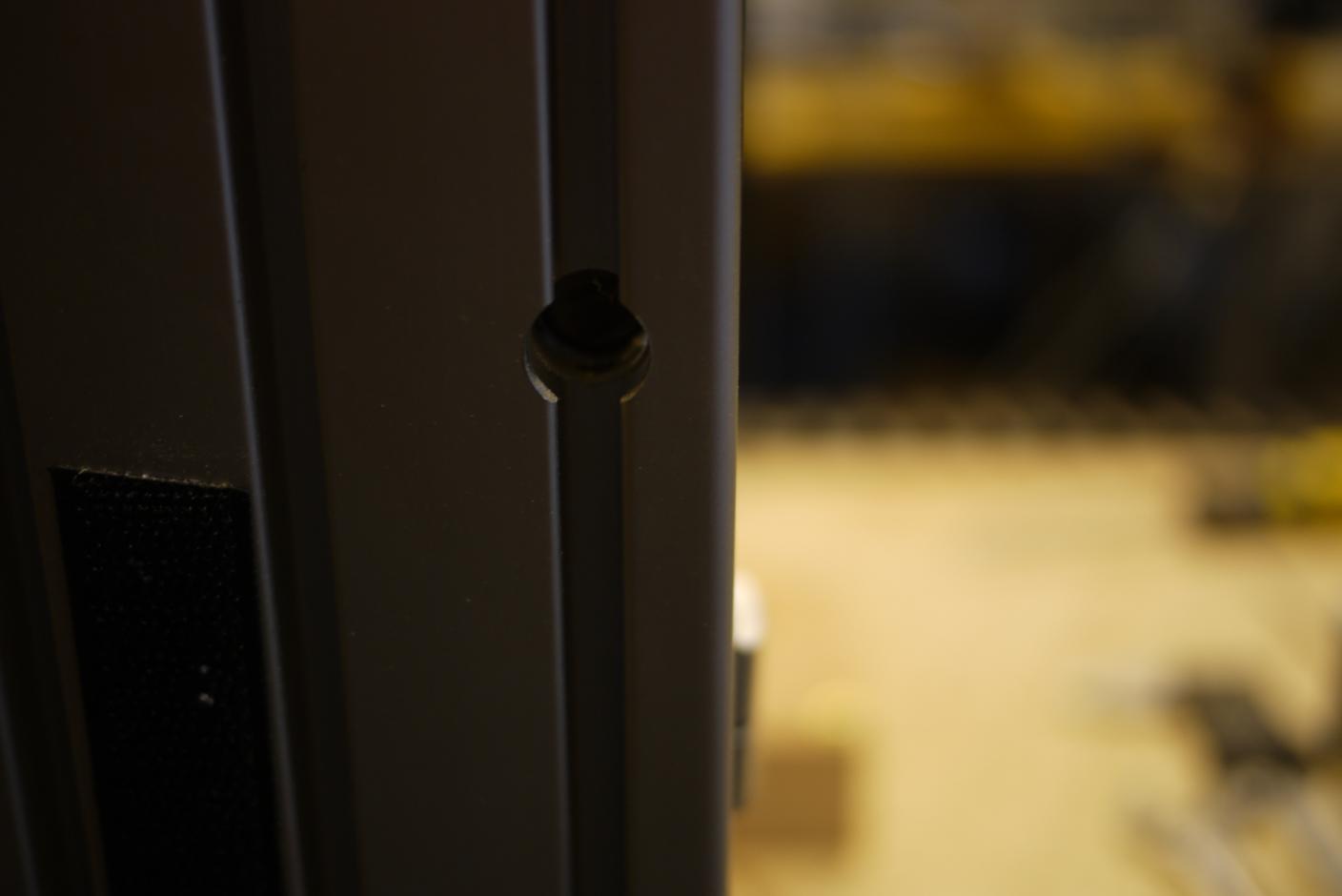

Can you post some photos of the opposite end of the screw so we can see how its mounted?
2 Attachment(s)
Attachment 7938Attachment 7939
Here are some pics of the end mount
I bought the router about a year ago

Anyway, I think the easiest way to solve this is to buy a pair of FK/FF bearing blocks since so long as the extrusion is long enough you can drill a hole in either side and put the new bearing mounts in. That's assuming the ballscrew end machining is standard, what does it look like?
Also, I'd solder those motor connections as if they work loose whilst the machine is running the stepper driver could be damaged.

It looks as though you have some end float which could be shimmed out.
Thats even worse than I thought it would be. The only thing keeping that bearing in place is the ballscrew and if its whipping about it will start to pull the bearing out as well. The first photo isnt very clear but it doesnt look like there is any kind of nut or circlip holding the ballscrew on the outside of the bearing.
I would either buy or make two bearing mounts and get them fitted but you might have to get some lathe work done on the ballscrew as I cant see it already having threads for a securing nut.
Another option would be to use the bearings blocks on the insides of the gantry and have the shaft lathed to fit between the two blocks, some spacers might be required as well. The two blocks on the inside would remove any sideways play from the ballscrew.

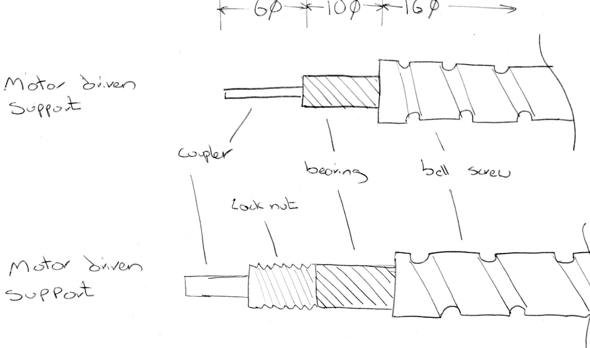

Attachment 7940
This is what I think I would need machined to take the bearing blocks at the drive side. The top pic shows whats there and the bottom shows what I think I need.
As there is not enough material, I would need to chop the current machined end off and weld a new one in to give me the material I need for the new design.
This is how I have machined my ballscrews before as my lathe aint up to the job of machining the hardend casing off. It makes the maching a lot easier anyway and as the welded on blank is oversized when it is turned down in the lathe it brings itself concentric with the screw.
http://i59.photobucket.com/albums/g2...h/P1070450.jpg
Something like this for the bearing block?
http://www.zappautomation.co.uk/en/f...7-fk08-c7.html
Its a little smaller than the recommended block but I doubt it will matter too much for this router as I am only looking get something in there that will work relative to the limits of the rest of the machine.
That looks like a Myford lathe and with the correct cutting tool will handle machining ballscrews, my little boxford does. But with this job then it wouldn't hurt to anneal the end up to remove hardening.
From the pics of motor with screw then there is a bit screw left with enough room for a nut so just thread the whole lot then grind flat spot for coupler screw, you may have to machine a new coupler or a sleeve.? . . . Sure it could be done easier than welding bits onto screw.!!
