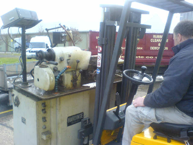

Renovating a Hardinge HLV-H
I acquired this filthy Hardinge from a firm for which my brother has been doing some work. Apparently, they acquired it in a company buy-out and had it shipped to their high precision dept. The manager took one look and consigned it to the scrap heap (their HLV's are pristine and polished :)).
http://www.mycncuk.com/forums/attach...3&d=1233771422
That's my younger brother on the fork-lift and my next eldest brother's car and trailer. With my Eldest brother giving me a hand to get the thing off the trailer it was quite a family affair. Handy things, brothers :)
http://www.mycncuk.com/forums/attach...1&d=1234129441
