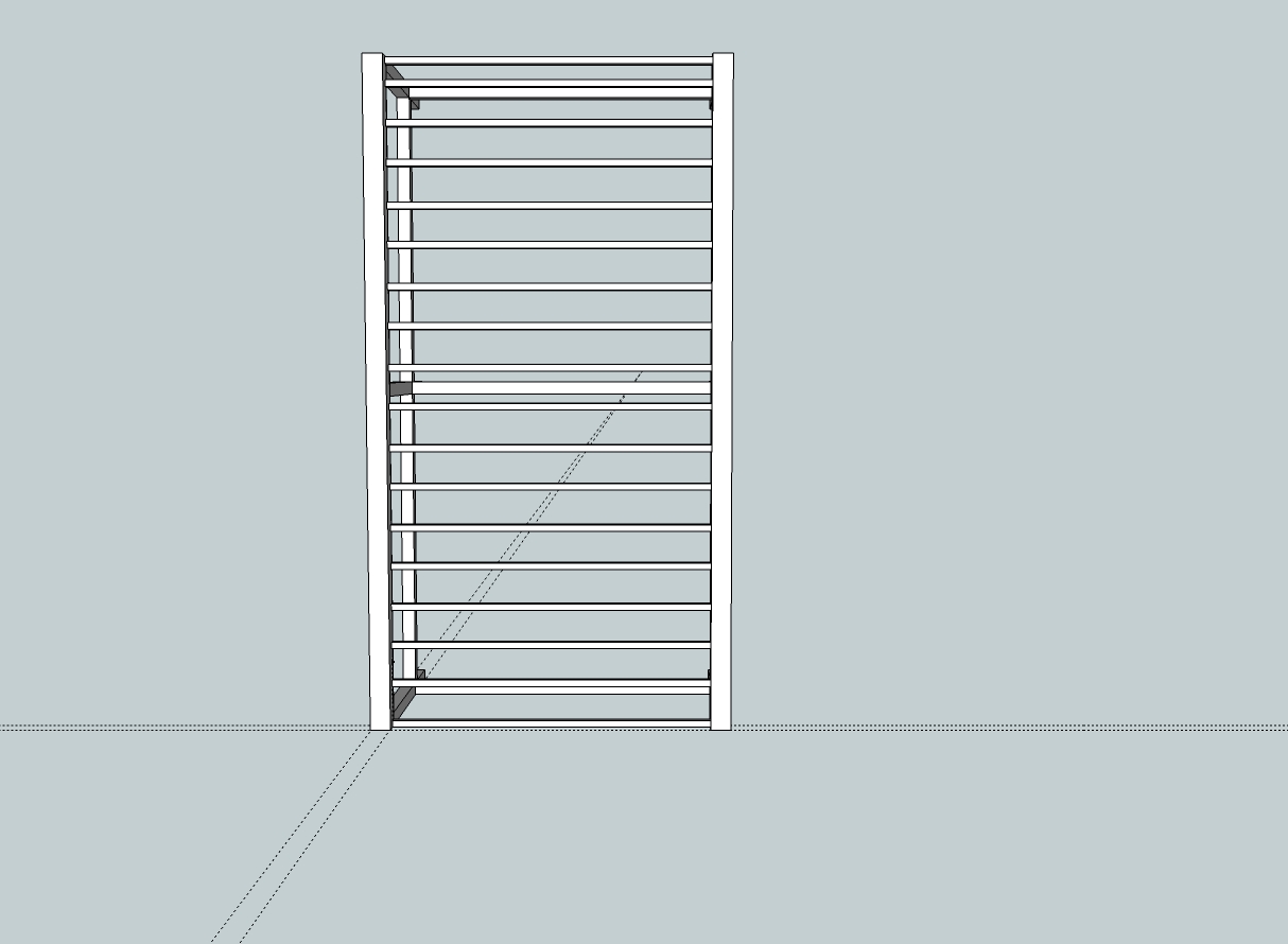

3 Attachment(s)

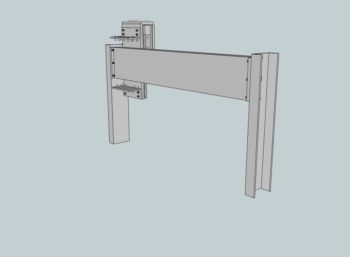

Re: New CNC router 8x4 For Cutting Multiple Materials
Attachment 8060Attachment 8059Attachment 8058
this is what i had in mind for the gantry y axis after do some basic calcs and using the spread sheet on here
the deflection for y and z had a tolerance of 0.054, this being 2 x 4 " ali u channel and 1 6 " channel with y axis = to 1500mm but this may get reduced to 1350mm this may be wrong
my calcs may be wrong as i may have use the ss in the wrong way:calm:
please put me right
ric
Good to see someone using the spreadsheet. You'll find that if you change to similar size box section the deflection due to bending will be similar, but the bending due to torsion will be substantially lower. That's because the torsional stiffness of a channel cross section is very poor. Also put the rails for the Z-axis on the plate that moves up and down, so swap them round. It's much stronger this way since the distance between the supporting bearings and the tool is minimised. The best thing you could do to that design is loose the tall gantry sides, as they're invariably weak compared to the machine frame.

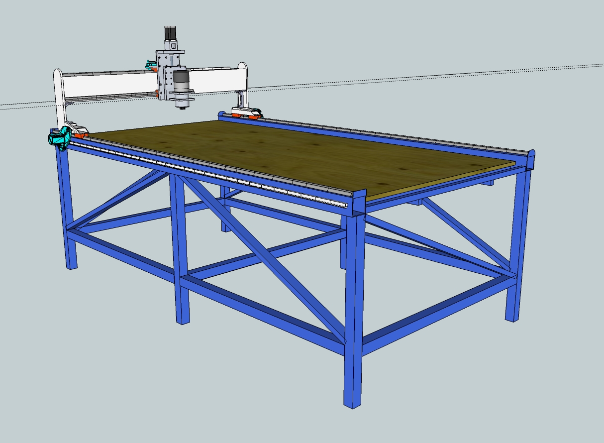

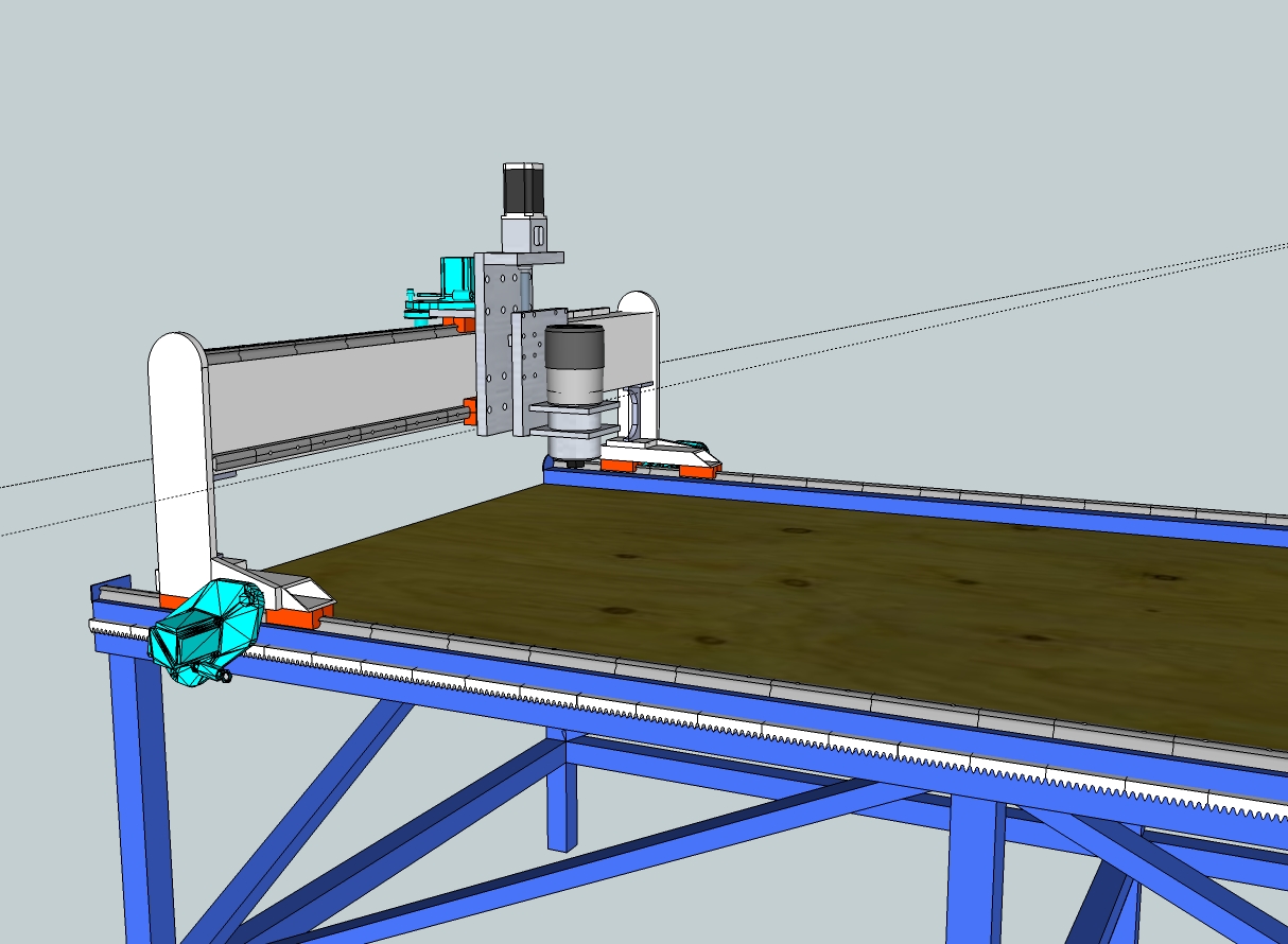

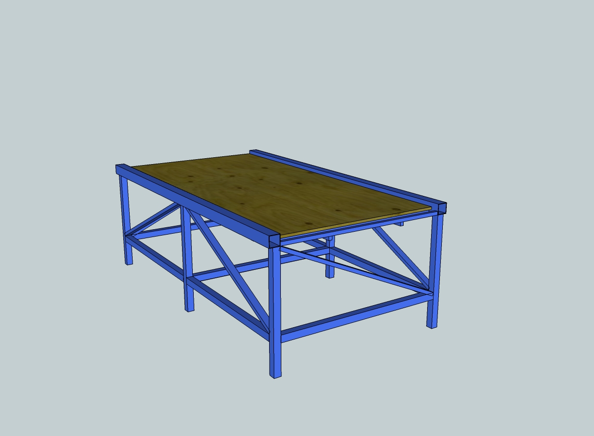

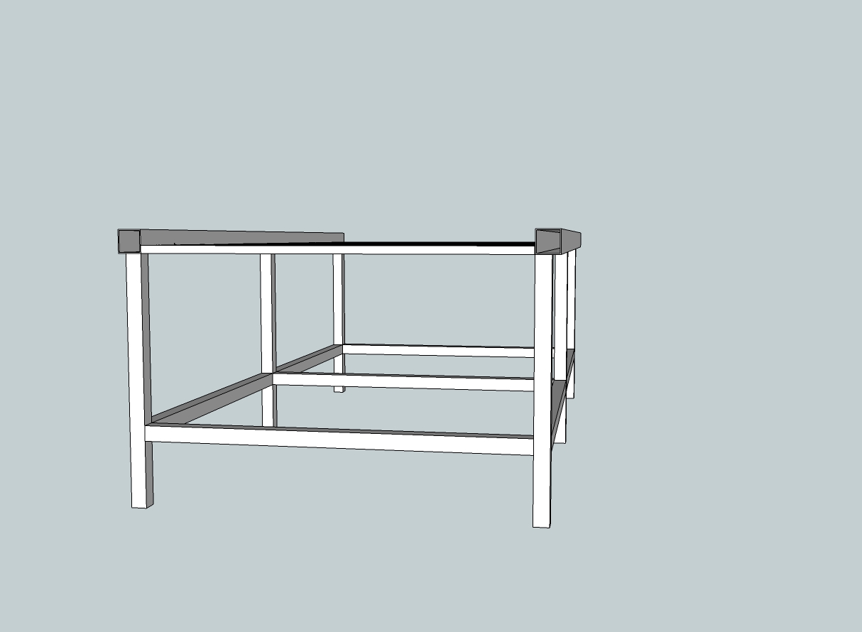

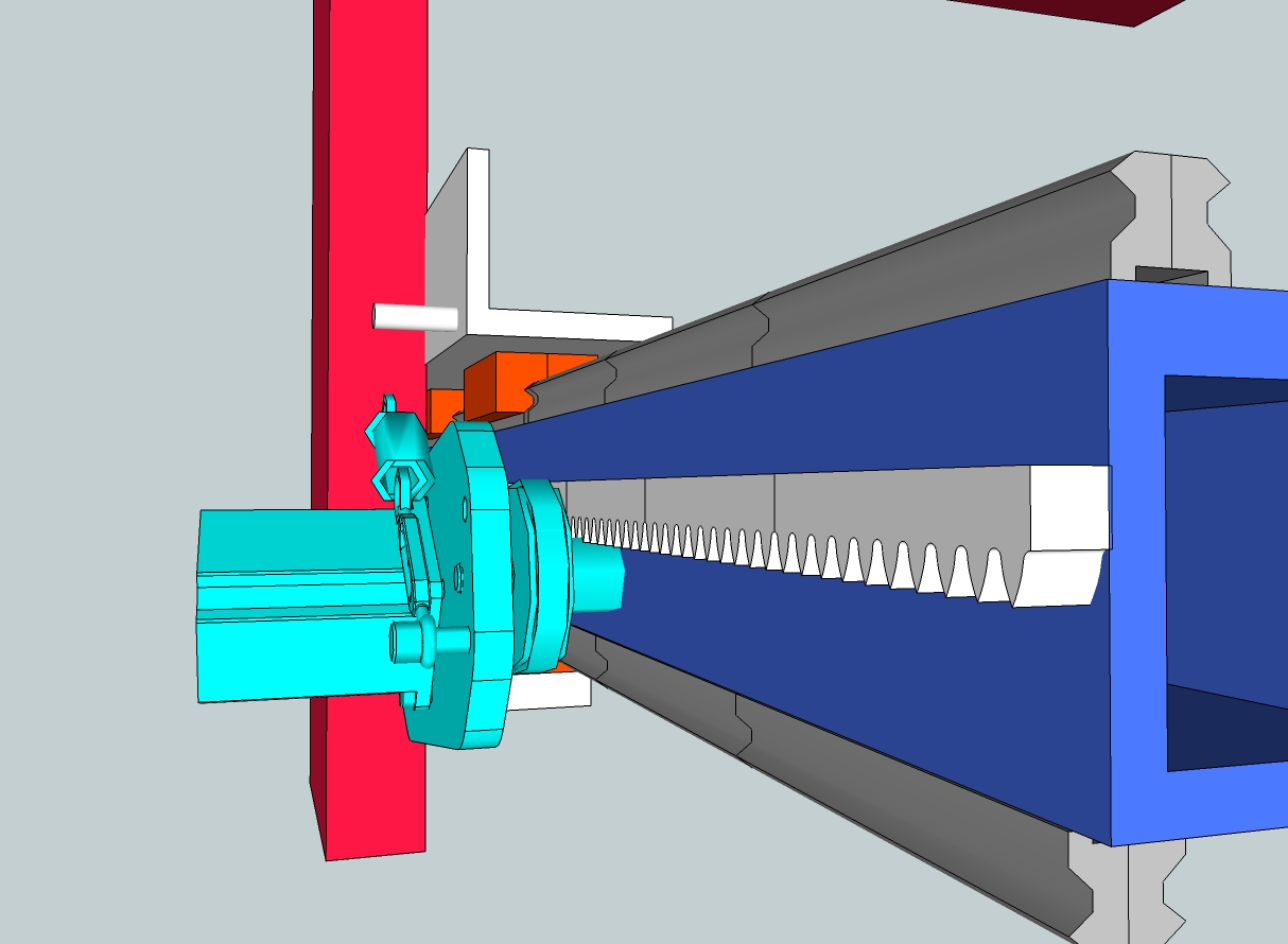

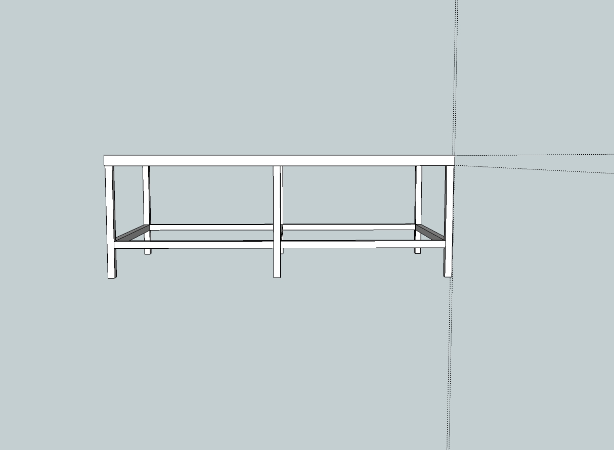

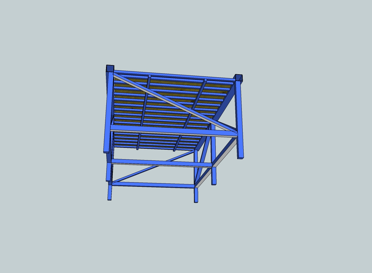

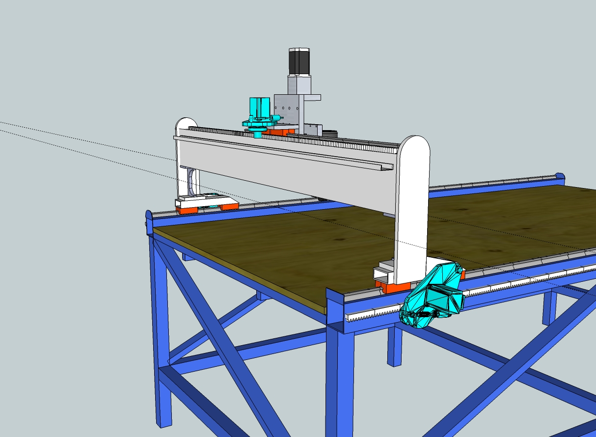

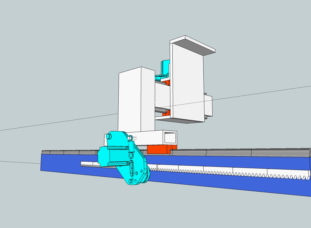

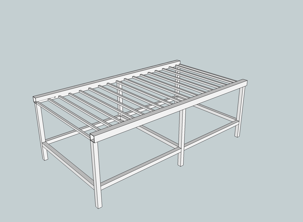

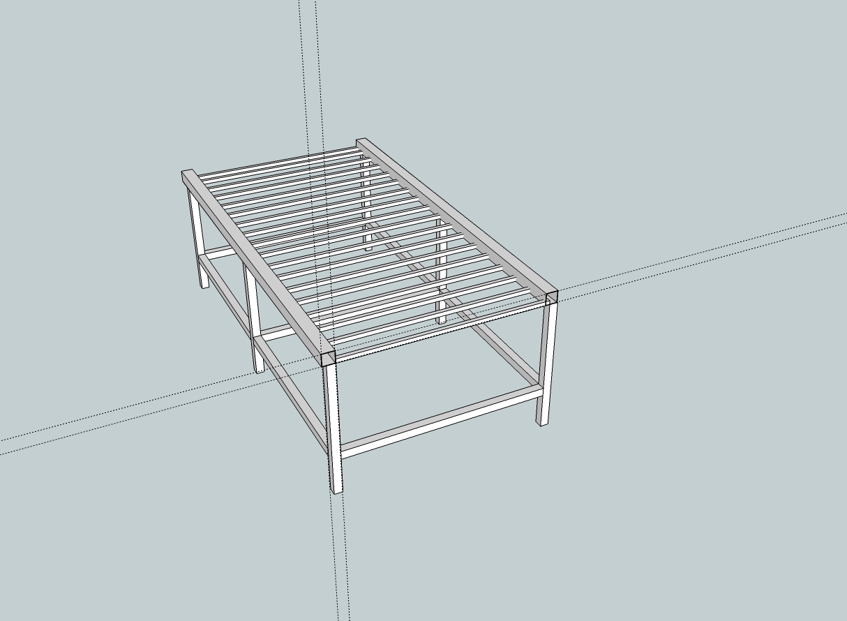

5 Attachment(s)
hi all this is an update of build i am in the design process stage here's what i been up to!
the cnc base (bed) is steel constructed from 75mm, 50, & 25mm steal box
i would like your thoughts please and weather this is up to the task?
if anyone wants anything welding in steel from Pm a line, not to bad at welding, new 200 amp Welder on its way :thumsup: :emmersed:
Attachment 8081Attachment 8082Attachment 8083Attachment 8084Attachment 8085
have a look
all welcome to comment
Not a bad start, but a few changes will make it a lot easier to construct and stronger. The most important factor is how do you intend to fix the box section for the bed (25mm) to the rest of the frame? It looks like it's just welded on at the moment, which makes the bed nice and strong, but the issue is with such a large Z-axis (450mm) you want to be able to adjust the height of the bed. The general idea is for sheet material you put the bed high up, so where it is in your drawing, then for the occasions where you need more Z-travel you drop it down. This is easy enough to do if you drill a series of holes in the 6 vertical pieces, support the cross pieces for the bed on two 8' long prices of box section, then attach them to the frame with M12 bolts. If that's not clear then look at my build log. You've got no chance of cutting 12mm aluminium and having 450mm Z-travel, without having an adjustable height bed.
It'll be a lot easier to make if you use 50mm box section, or something bigger than 25mm, for the bed and use less of it. Also add in some diagonal pieces to the main frame since without them it will skew relatively easily.
Since you want to use this for cutting aluminium, if only occasionally, I wouldn't use rack and pinion since the resolution and rigidity will be worse than with ballscres. You can easily use a ballscrew and 3Nm nema 24 motor on the 1500mm axis, however to use ballscrews on the 2500mm axis requires a large ballscrew and big motors, or rotating nuts.

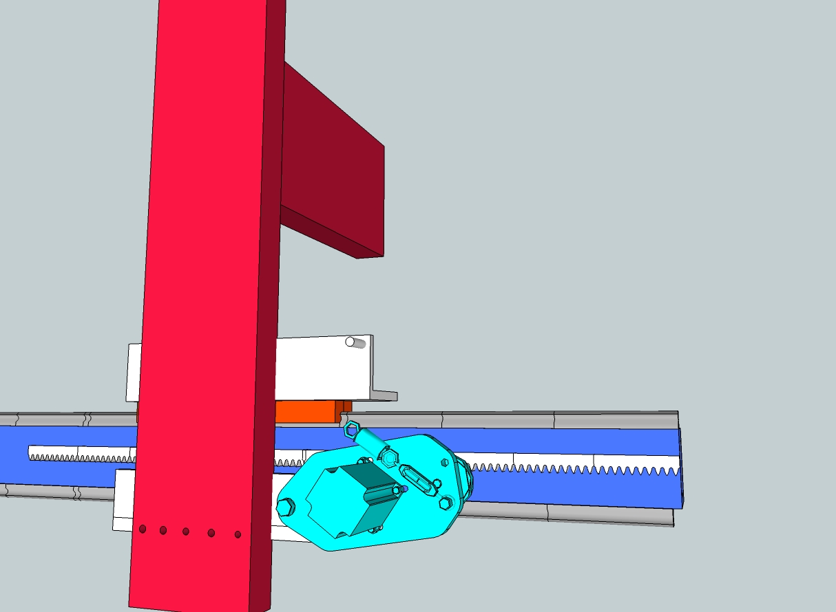

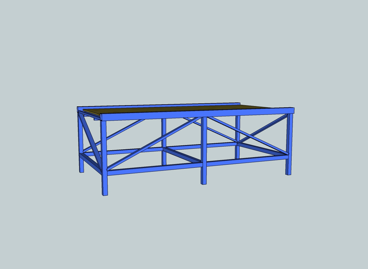

3 Attachment(s)
Jonathan
JONATHAN
thanks for the advice and taken on board,
i have decided to cut the z axis height down to 400mm ballscrew as the y gantry is 2x8 ali box
decided this after i found out the you can mill sections at a time and glue together to for a fibreglass/vac form plug i think mach 3 has that ability or was it artcam????:hopelessness:
at a later date build a cnc router for carving vac form plugs,the later cnc 800 x 800 from ali extrusion and plate this does not have to so stiff and rigid as it only carving foam/plastics and MDF and pine
since i posted i have modified the frame to be very rigid, see pics
Attachment 8086Attachment 8087Attachment 8088
i know that using 50mm box would be better and save some pennis but i decied to stick to the 25mm as a way of spreading the weight and of course it looks nicer but this may change:tranquillity:
as for the x axis and using rack or ballscrews the jury is out on that at the mo , thanks for the spanner by the way:black_eyed: LOL
i will post my idea for using rack and pion and a lock plate,
i will have that idea up soon
speak later, buy the way i am on skype if u want to face to face pm me
ATB
ric

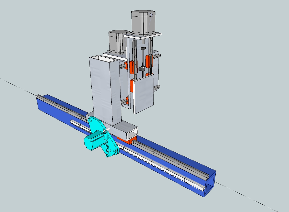

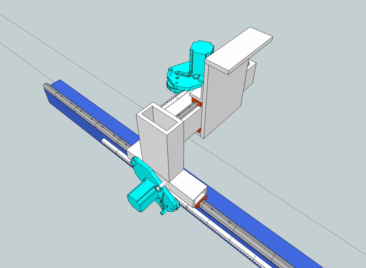

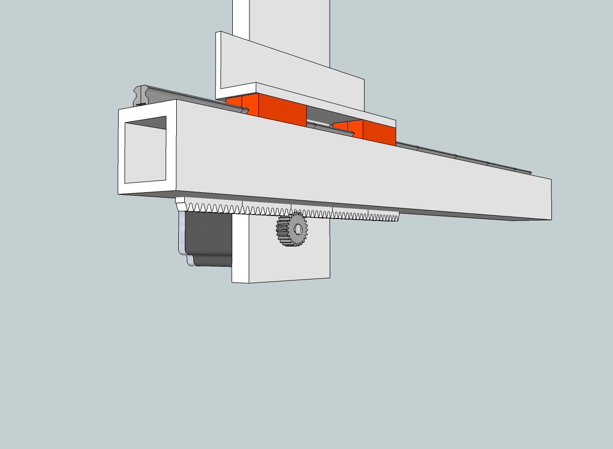

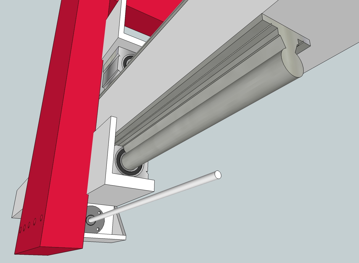

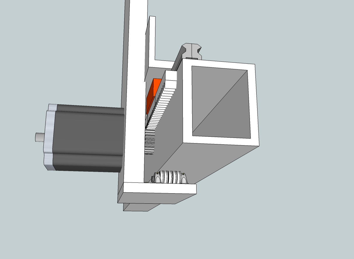

7 Attachment(s)
PART TWO
Y GANTRY IDEAS
IDEA 1
Attachment 8090Attachment 8091
hiwin rails, nema 34 x 2, rack and pinion, aluminium plate not to sure what thickness to use or use box section and mill a lap joint, bolted and ali welded
Idea 2
Attachment 8092Attachment 8093Attachment 8094
hiwin rails x 2, nema 34 on spring drive plate, ali box section, rack and pin, use box section and mill a lap joint, bolted and ali welded

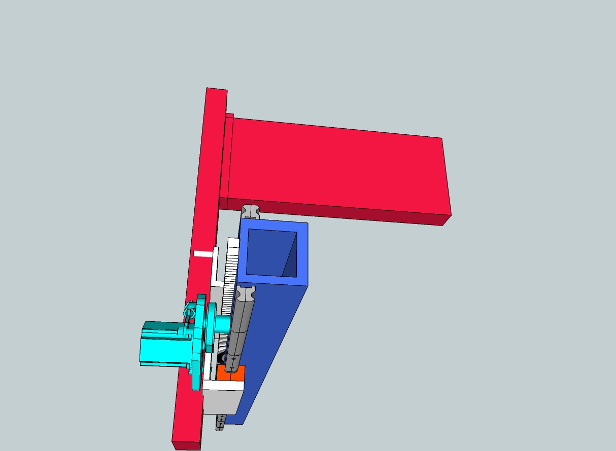

Ideal 4
Attachment 8095 using ballscrew and thread 20mm or more use box section and mill a lap joint, bolted and ali welded
Idea 5
Attachment 8096ball screw & tread moved to bottom 2 X NEMA 34 use box section and mill a lap joint, bolted and ali welded
this might be over engineered???????
let me know what you think
advice please
ric

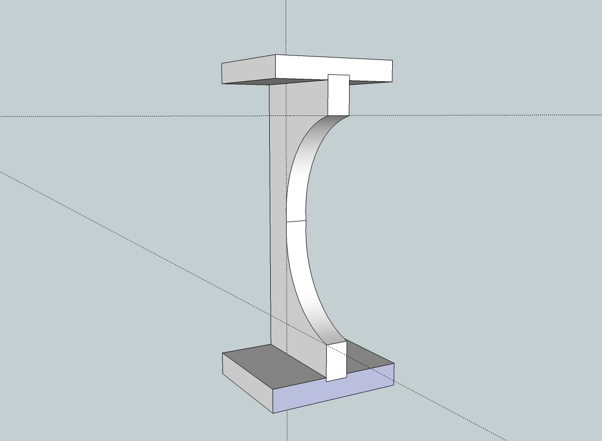

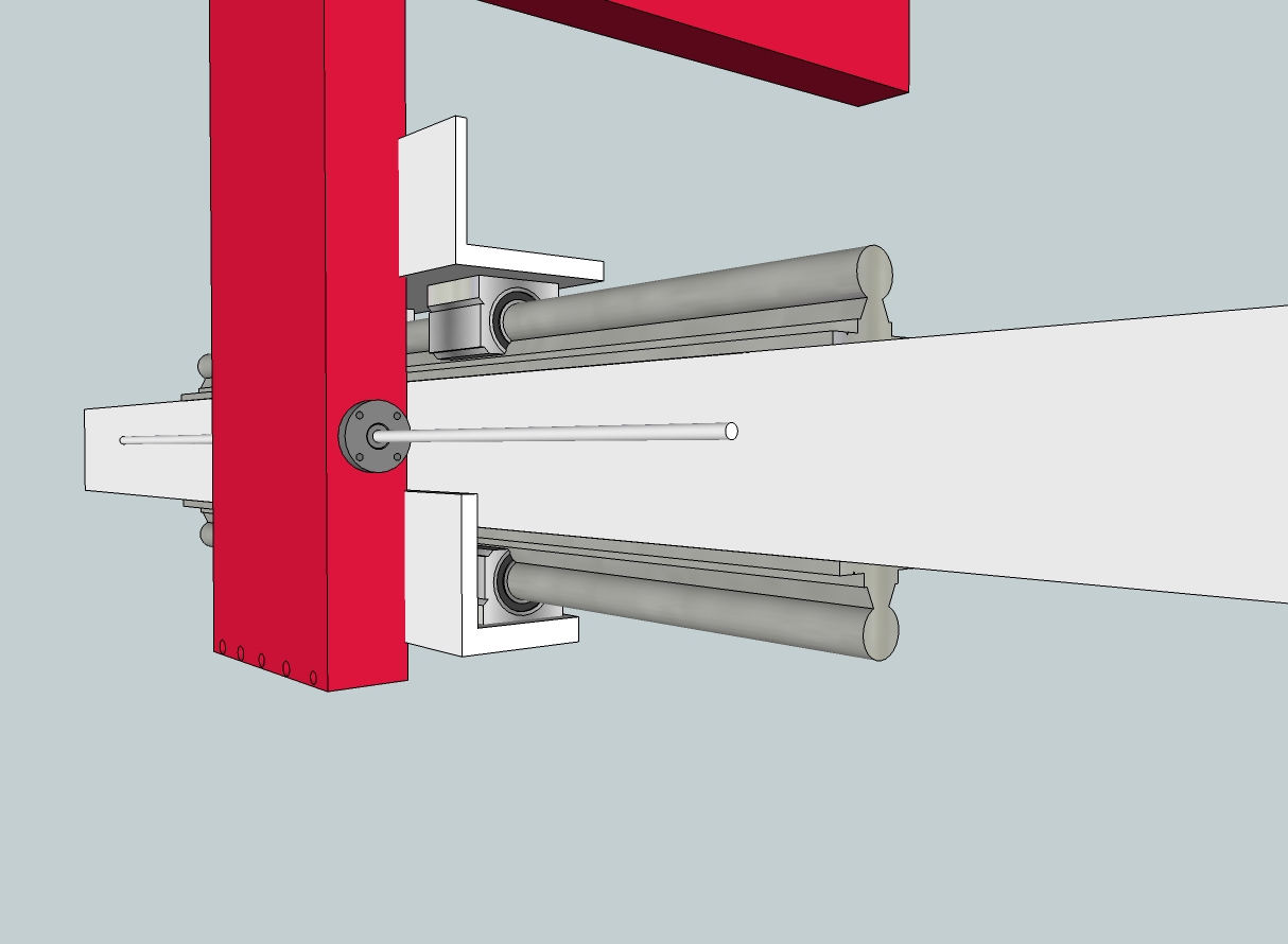

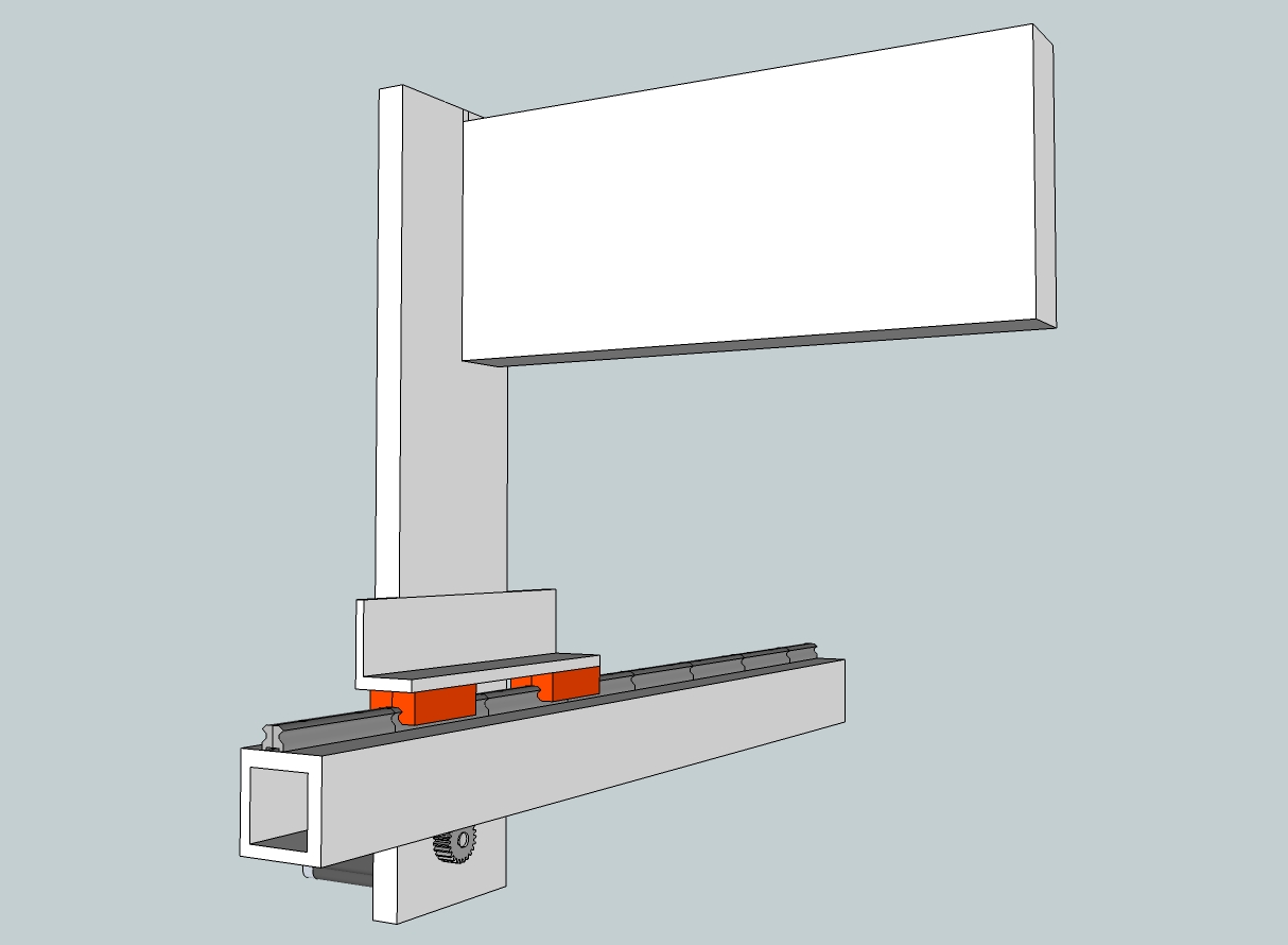

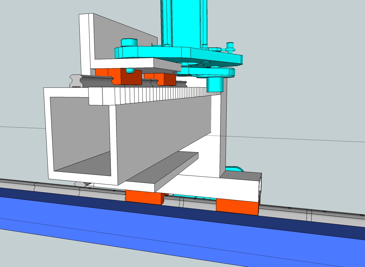

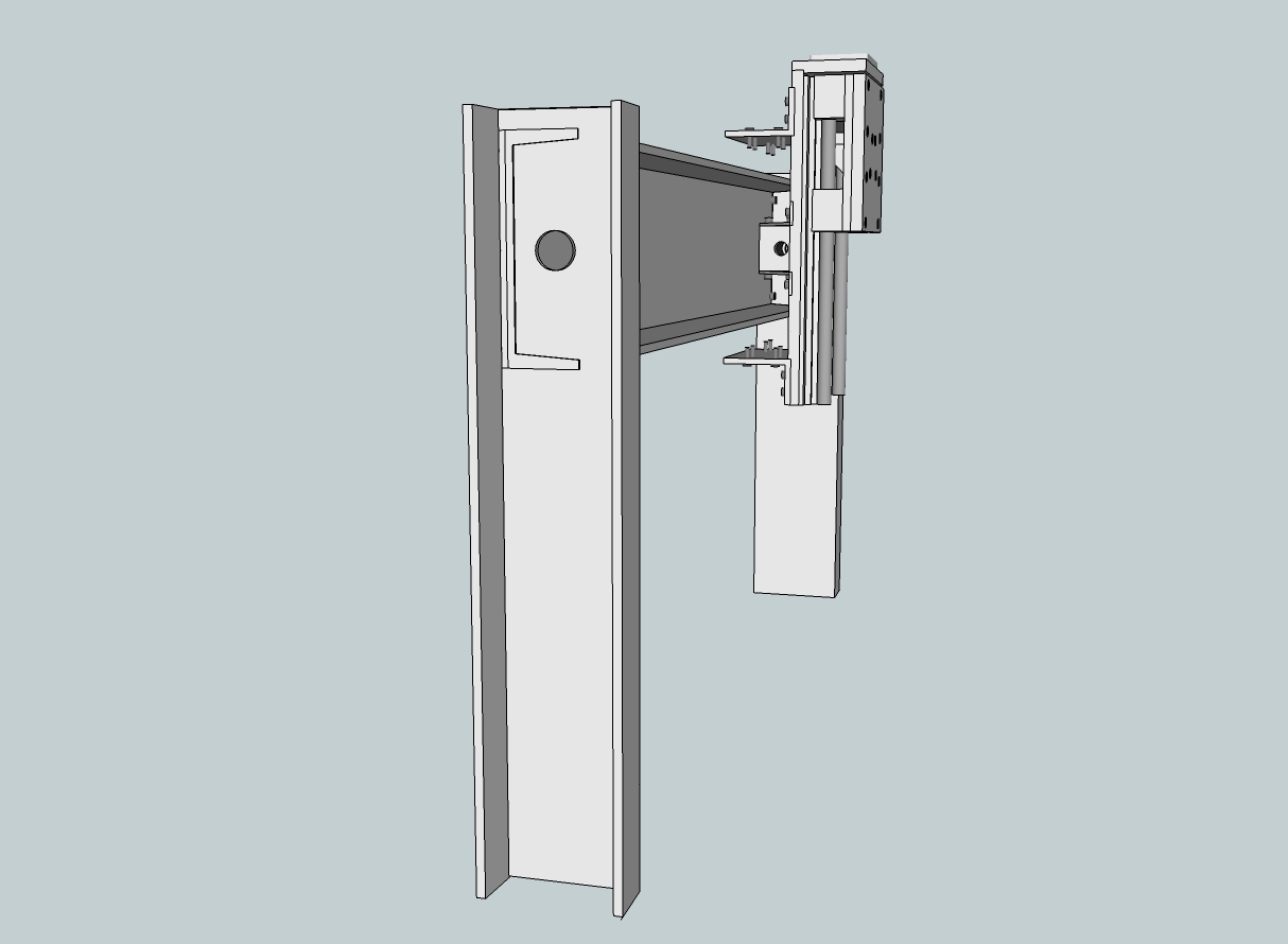

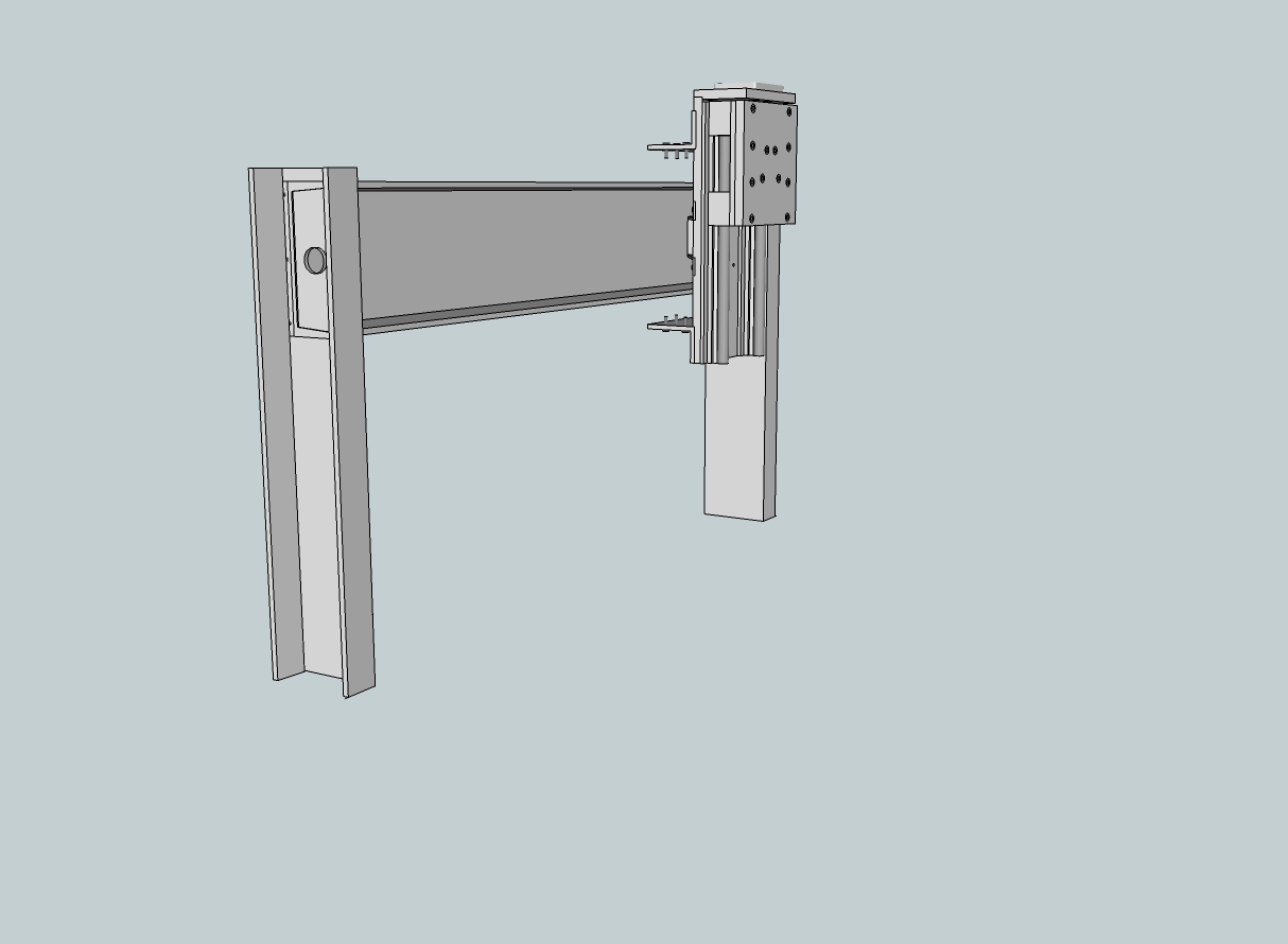

3 Attachment(s)
Attachment 8110Attachment 8111Attachment 8112
xyz
idea
Please comment on this idea i do like the design, but i not sure if this is going to had too much deflection so please advise?
i have reduced the hight y gantry from 400mm to 175mm from the bottom of the z axis
y gantry virtical and mount box section is welded steel, or welded ali
all comments welcome
Hello cisco, I'm not one of the resident experts but as everyone seems to have sodded off I'll give it a shot.
Try this thread for photos and video of a z-axis
http://www.mycncuk.com/forums/items-...ma-23-3nm.html
You want the rails mounted to the plate that the spindle is attached to as it will add stiffness to the plate and if you are using hiwin type rails you really want to use ecocast aly for the plate as it is a lot dimensionally accurate than the cheaper stuff and hiwin rails need very accurate alignment to work properly.
Watch the round vs square rail video here to see what I mean:
http://www.thomsonlinear.com/website...and_guides.php
That big hunk of material that is your gantry, is that steel box section? If you intend to mount the rails directly to it you might want to consider finding a local machine shop with a surface grinder that can grind it reasonably flat for you.
D.C.
H
thanks dc
base is steel and all the upper is 12mm ali plate and box section
cross member is 6 x 3 ali box, is this really necessary to get the box y gantry ground, if it is then my budget has been killed
but if you are taking about the box and plate that connects to rails, then i that's given! i will nee the plate cute to shape and the I bar making, the i bar is made from ali, but the was thinking of welding it in steal but this means get the cut on a water jet or laser?
been working on different ideals as you can see from by thread, but seam like almost no one is willing to giving advice or the own views, i welcome anyone who can talk from experience, good or bad,
i-beam is screwed together, but if i can find a ali wekder i will get his welded
Attachment 8120
ciscoeuk
I'm happy to comment on the new design, but I haven't posted as most of the things I have to say are the same as what I said in post #7. The main problem is still that the gantry is far too tall - it's best to have no gantry sides and lower the bed, that way the gantry is supported by the main frame not some flimsy bits of plate.
A 3Nm nema 24 motor is plenty for the Z-axis. Also, to get anything like good resolution on X and Y with rack and pinion, you'll need to have two belt reduction not one. Search on the forum for rack and pinion versus ballscrews and you'll find plenty of relevant information.

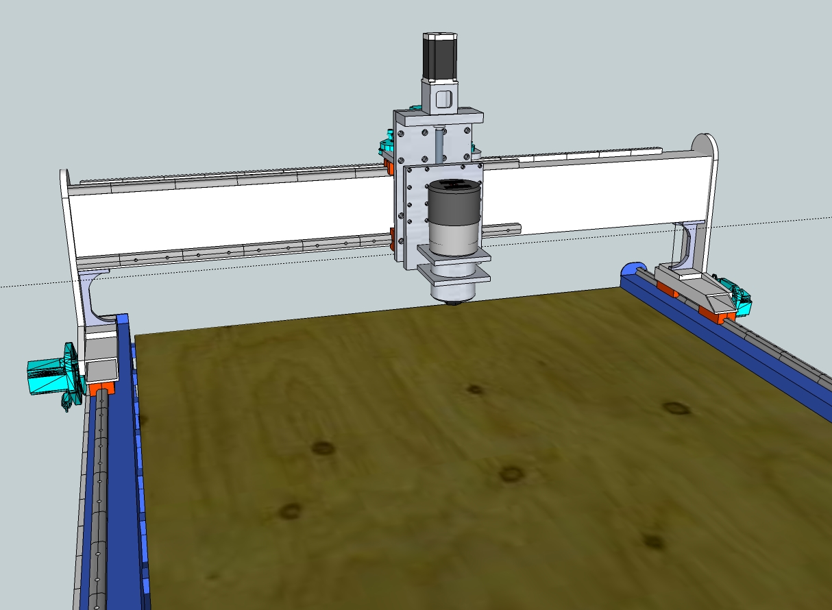

Hi Richard,
This design is really only suitable for Wood/plastic cutting. While it will cut aluminium the finish won't be very good and the cutting conditions regards DOC and feeds speeds will be far less than ideal.
After our conversation and knowing your intentions to cut Ali to high finish standard then machine is all wrong. Even at half length it's all wrong.
Again knowing your needs better then a dedicated small fixed gantry machine using profiled rails matched and ballscrews along with either high flood coolant or blown air/mist system will be far better.
Regards this machine then I'd use supported round rail on X & Y for convenience and Budget, they will be more than good enough for just cutting wood/plastic.
Personally I don't like R&P and would use 2010 screws on a rotating ballnut if much over 1800mm. Below this then standard connection is fine.
That said I have used R&P in the past on large machines and it works OK but find it needs more maintenance and critical to keep free from debris. Needs much larger motors with matching drives with high ratio gearing to achieve decent resolution which together make it more costly than ballscrews with far less accuracy and efficiency.
For the Z axis even with R&P I'd still use profiled rails and ballscrew. The Z axis is the single most important part of the machine that takes all the cutting forces directly, it also directly affects cut quality finish and if it's weak or poorly designed or uses cheap components then it will show in finish or wear and perform badly.
The gantry design looks a little on the flimsy side regards it's sides and Box section for the gantry will be very resonant which is less than ideal and could directly affect cut quality and even motor performance if bad. If your using Aluminium box then it will need to be thick walled stuff 3 or 4mm won't be enough.
Don't be afraid of weight when it comes to the gantry, often folks believe and go out there way to make the gantry has light as possible thinking it improves the machine when in reality it compromises the machine where it matters which is when cutting.!
Mass helps significantly with cutting and damping resonance, light gantry only really helps regards allowing higher rapid speeds which come much lower down the pecking order of desirable requirements.
If you want an all round machine then really this design isn't the way to go. In my experience for a successful all round moving Gantry machine then the frame/gantry needs to be different with the gantry mounted directly on the X axis bearings with no gantry sides to speak of. The distance from bed to cutter or put another way Z extension needs to kept to a minimum for harder materials like Aluminium. This requirement is often restrictive to the requirement to cut softer often bulkier materials like wood.!
So away to accommodate both needs to be found.? You could just raise the material to the cutter for hard materials and keep the high gantry side design but this is less than ideal has the very high sides are weak area and allow flex and resonance that will show in the finish of harder materials like Aluminium. . . . Fine for wood plastics etc that need to hold less tolerance or finish.
To do this we get rid of the the gantry sides and mount direct to bearings by raising the frame sides.
Now we still need to accommodate the high clearance for bulky materials while still keeping the rigidity by not having the Z axis extend all the way down to the bed when cutting thinner Aluminium but at the same time we don't want to be messing around with Blocks to raise material.
To get round this we make the bed adjustable, doing this takes away all cutting restrictions meaning you can keep maximum rigidity for all materials with much higher clearance if required.
In real world use you will seldom move the bed and find a position that suits most of your requirements but for the times when MAX strength or large materials need to be worked on then you can and the whole machine is very configurable for ALL ROUND uses.
All you have to remember is that it will always be a Jack of all trades and master of none but will still do a bloody good job.!
hope this helps.
Look around the forum for Z axis examples I've posted several examples with pictures of them in pieces and complete.
thanks jazz thanks has been helpful, thanks the chat after speaking to ken (friend)
we had decide to take your advice and build 18" x 24" unit dedicatted to metal only and encase it is a screen enclosure as this is more of a priority now all we nee now is a design
construction will be steel and ali 3 axis unit
as of now this thread is on hold and i will start a new one
