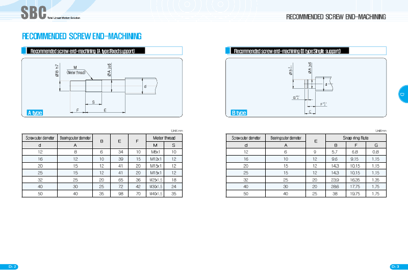

Ok, il try and answer what I can...
First off, I think you are referring to Chai. http://http://stores.ebay.co.uk/linearmotionbearings
Next, have a look at this...
Attachment 8122
When wording your email to chai, you need to specify your ballscrew dimensions carefully.
For example. I wanted 1500mm of actual travel, I wanted BK type bearings at BOTH ends. and then I wanted to put a pulley on. So I actually ordered
**1603mm Total length so 1500mm PLUS one end machined to type A (except dimension F to be 25mm instead of 15 (to accept pulley), and the other end machined again to type A, but without any F

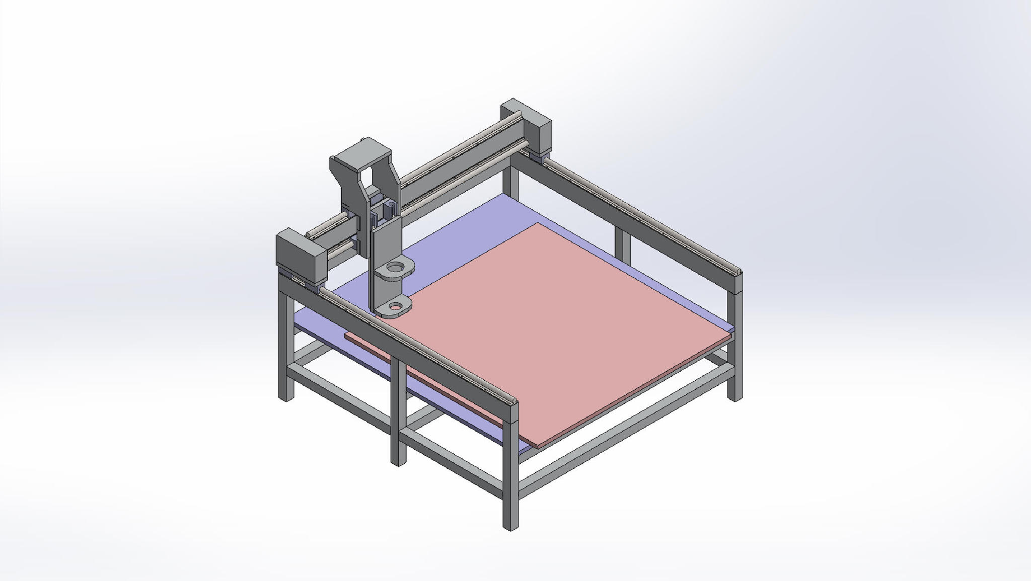

Ive uploaded a screenshot so everyone can get an idea of the design when its being discussed. Its a long way off being finished tho. Please let me know your thoughts.
Also i have started to research controllers and wiring etc and am a little daunted by it all, does anyone know of any good links that talks through it step by step and any recommendations for controller (makes and model) - think i will go with a parallel controller and Mach 3 rather than USB / bespoke software. Is it best to go with separate drivers rather than built into the controller?

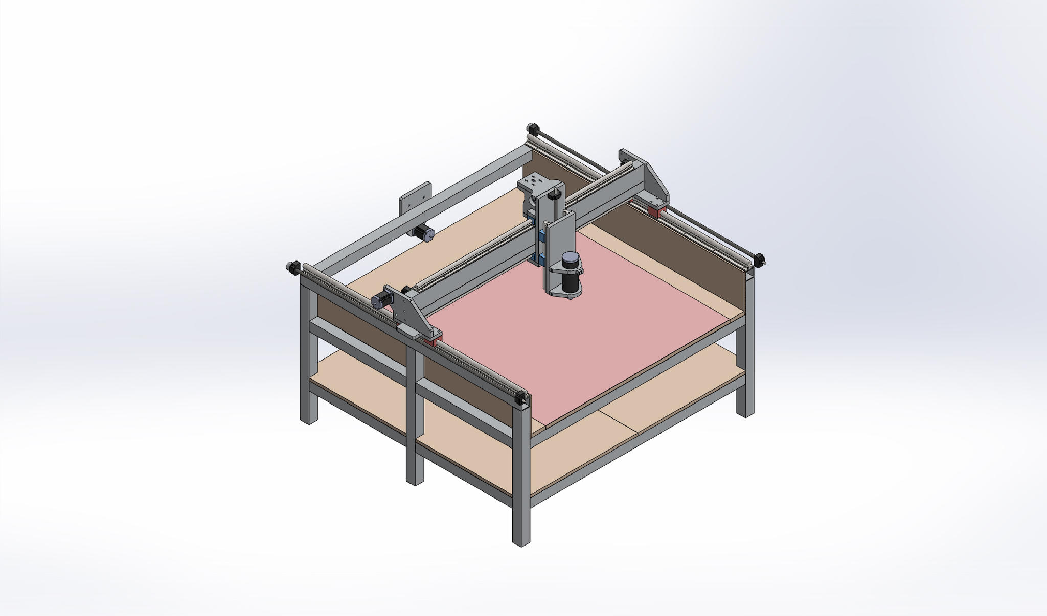

Just wanted to give some more info on the use of the machine and the design so far.
Im hoping to cut mainly large ply / MDF sheets on it so wanted it to accommodate the maximum capacity sheet (standard size: 8ft x 4ft).
i didnt want to build a router to this overall sheet size as i it will be a bit of a beast and also the cost comes into play. my thoughts were to make it accept the width of the sheet (4ft / 1220mm + a little) and then the length of the board could be machined in two halves by either feeding the material through of turning it through 180 degrees.
Does the length of the gantry pose a problem for general machining and would it be able to handle cutting aluminium? As long as the strength is there will it be ok and will the precision still be to a fairly high standard. If cutting aluminium or harder woods is
Will be looking at getting the water cooled spindle so im guessing the weight of the gantry and Z axis will be a fair bit so the gantry will have to be fairly substantial.
The bed is going to be in a fixed position so this can be bulked up with diagonals for strength and like suggested heavier gauge extrusion, just difficult to balance the desired design with the cost of parts.
The support in the Y direction behind the gantry was to mount the motor in the centre with pulleys to the X ballscrews, so didnt really want to add a support the other end as this was to allow material to be fed in / out but if i can position it in a way that the material can be slid under the support i may add this in.
Yes Gantry length will greatly affect the machine but not so much for precision but more the quality of finish from machine. Precison or accurecy is down to combination of components and quality of build.
That doesn't mean you can't have long gantry but it does mean it will have to be very strong and substantial to resist resonance and flex which are the enemy of finish quality.
Take this strength to another level if you want to cut Aluminium and achieve good Finish quality. Really unless your only cutting Thin Alu sheet or Profiles etc that don't need good finish then forget cutting Aluminium on such a wide or long moving gantry machine. Yes it will do it but not very well.!!
Danielroyal25
No need One end support will be fine so long the frame is braced well, my machine has this one end setup and it works fine.
If your into wood can I suggest you have the rails slightly overhang the end of bed. Doing this simple thing will give you some nice options easily achieved.
Namely will allow end machining of boards etc for hinges, locks, Dovetails and oversize or oversize awkward parts by clamping to end of machine.
Also if you want a 4th axis makes it very easy to add one see pics for some idea of what I mean.
It's only a cad mock up so pay no attention to details like gantry has thats actually a design I use the other way round it just saved me some drawing time for showing the person it was intended for. It could be used that way round thou.!!

i am looking at aluminium box section 60x60x4 for the frame and 120x60x4 (2x L shape config) for the gantry. Is there much difference in strength / deflection using box compared to the t slot ext and how does it deal with resonance? What materials are generally used to dampen if it is needed?
4 Attachment(s)
Re: 1250 x 1250 cnc router (from scratch)
Hi, here are a few more screen shots of the model. Done a lot of work on it, but still a few more hours to go... Please let me know your thoughts as i would much rather make the changes now than down the line. I have still got to add diagonals / gussets onto the frame to strengthen it up. What are peoples thoughts on the X pulley set up (i have left the cross bar unsupported so material can be slid through), ways to mount X ball screws and set up of motor / pulleys on Y axis?Attachment 8308Attachment 8309Attachment 8310Attachment 8311
nice work. i can see some time has been put in to these drawings.
Pretty confident the guys will tell you to mount the Z rails the other way round.. so the Y plate holds the bearings and the moving Z has the actual rails if you understand? see my machine
I suspect the pro's will suggest more strength under that bed.
To be honest, I took all the useful pointers from the guys on here regarding strength and rigidity and resonance with a pinch of salt..I use 6mm steel box section and 50x100x6 ali for the gantry.... every one of my mates told me its over-engineered.
Now, I sh*t you not. It is only now my machine is working I understand what they were talking about. Its literally got to be SOLID AS A ROCK otherwise you watch the thing flex when cutting hard wood let alone Ali. Your only down the road... Come and watch mine do it before you spend any money
kingcreaky
If you look again Matt you'll see he's got it correct way round.!. . . BUT . . You have put the Ballscrew upside down with Fixed end at bottom. You want fixed end bearing near motor.
kingcreaky
He really does shit you not.!! . . . Don't under estimate the forces they are high and if you want high Precision and accuracy then the average, and even well tooled up DIY-er can't over engineer.
Build it strong and don't be afraid of weight when it comes to gantry.? Better to have rigidity and sacrifice speed thru using larger motors than end up with flexy resonating gantry which gives crap finish.
Yeah I am the same really, thinking that the framework can be fairly rigid (nothing too over the top) but not seeing many cnc routers in the flesh it's hard to judge how much force is actually created from them. The idea was to try and create some storage for sheets etc under the bed (as workshop space is limited already) but this can be sacrificed by adding some more support struts etc to beef up the frame.
i was worried about keeping the weight down too for some reason? But as its going to be in the same position in the workshop and weight is a key factor for reduction of resonance and improving quality of finish those worries are out of the window.
still unsure whether to go with alu or steel tho...
matt - my gantry design is based on 2x lengths of 50 x 100mm 6mm wall aluminium in a L shape config. And 60 x 60 x 4mm wall alu box for the frame. Based on your machine would you change the material of the gantry?

Hi guys. The design is now complete and into ordering parts!! Just arranging the machine parts so that they can be machined from one large plate. What is the minimum gap I can have between each part. I have made it 4mm so far will this be ok?
