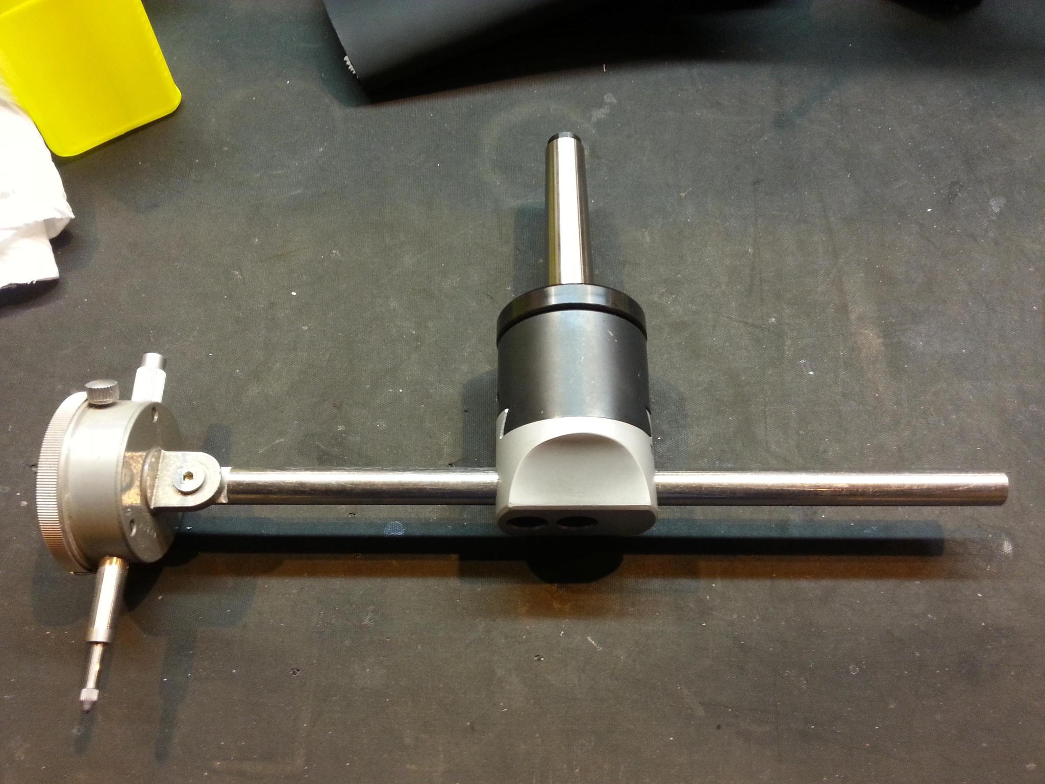

If you have a boring head all you need is a bar to fit the clock guage to. Works well and is adjustable for length. I cant upload a photo from my phone but will post one later.
Photo as promised.
Attachment 8182
Easily adjustable for the length or width of your bed.
