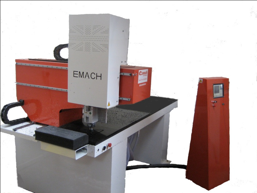

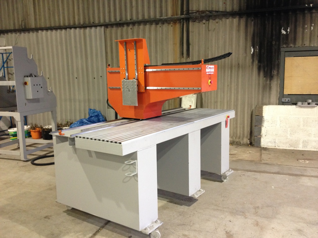

In November last year we ordered an EMACH CNC Router Model EM Roto 600 from a chap called Leigh Tricklebank at EMACH International Limited. We were told it was an Ex Demo model and we were quoted £12,000.00. I went down to Walsall to see the chassis being built, it was all very convincing. It had a 2000mm x 600mm Working Area, a 250mm Working Height (across the 600mm width) with a 4KW Electro Spindle, Pneumatic Material Clamps, 10M/Min Axis Speed, and quoted 0.2mm Axis Repeatability 0.05 Programming Accuracy. Emach’s quote included delivery to us up here in the North East, ½ Day Installation, included 1 Day Training and a seat of ‘Delcam artcam’ CAD CAM Software.
Attachment 8376Attachment 8375
It all seemed too good to be true, and it was! The machine was never delivered and Emach ceased trading. Fortunately for us we went through an asset finance company, as such they actually bought the piece of equipment to lease to us over a 4 year period. On further investigation it turns out Leigh Tricklebank has been the MD of a string of companies that have taken money and failed to deliver. Unbelievably the finance company didn’t check that we had received the machine before releasing payment in full. The finance company have now refunded us the instalments and deposit we had paid and are now pursuing Tricklebank to recover the debt. Ironically the reason we chose Emach was that they were a British company making the routers here so would be able to offer the support and training that we are after.

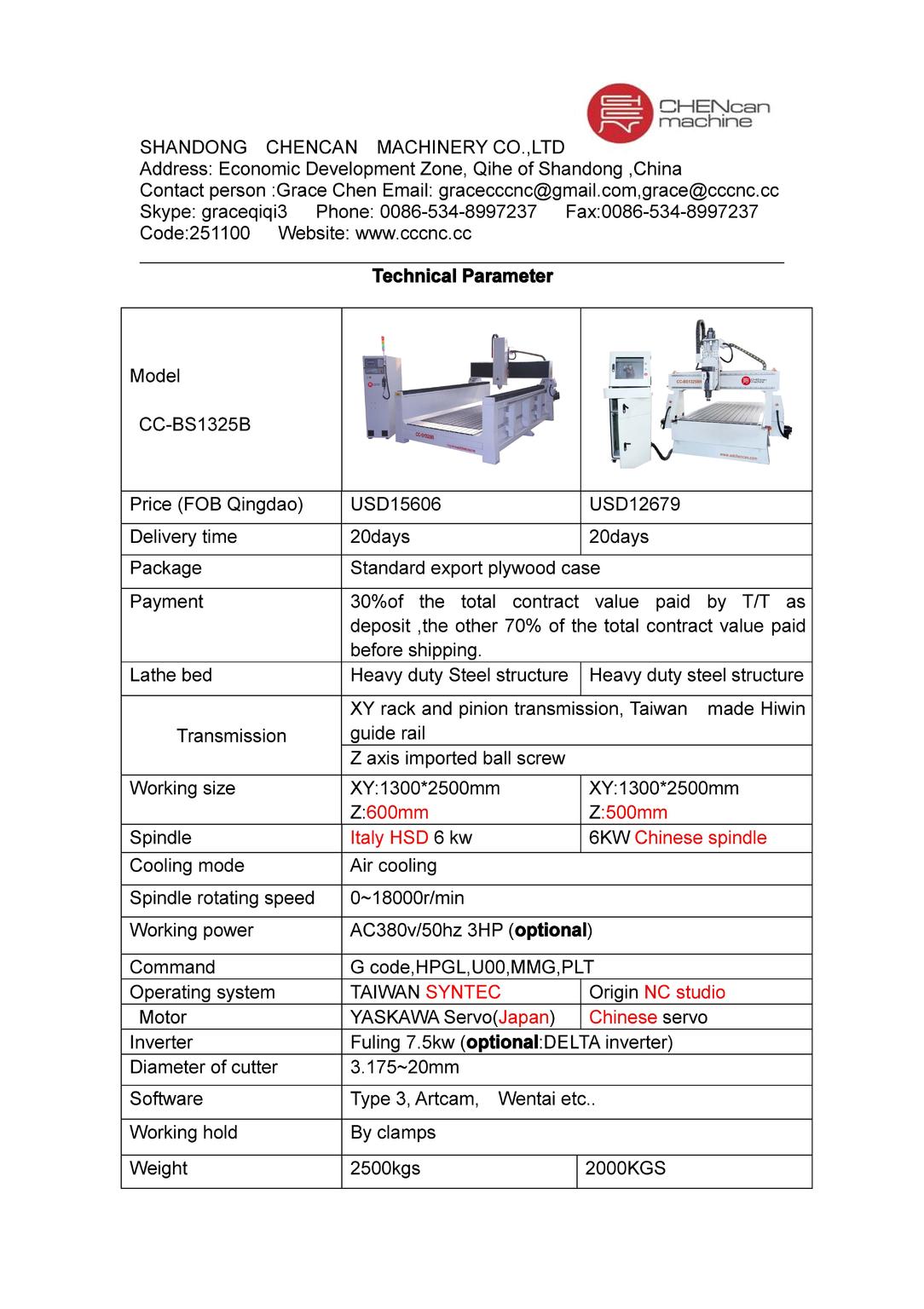

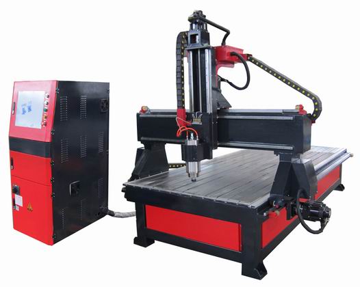

Hello mark
We are manufacturer of cnc routers in China. For your requirements,here are two kinds of cnc routers for your choice.
One with below specification(picture attached)
working size:1300*2500*400mm
servo motors and drivers
DSP handle /NC studio control system
table facet:vacuum suction or T-slot
And the other is professional mould making cnc router,which Z axis height can be highed up to 600mm.
If you are interested,please feel free to contact with me at [email protected].
More details and pictures will be sent to you.
Regards.
graceAttachment 8382

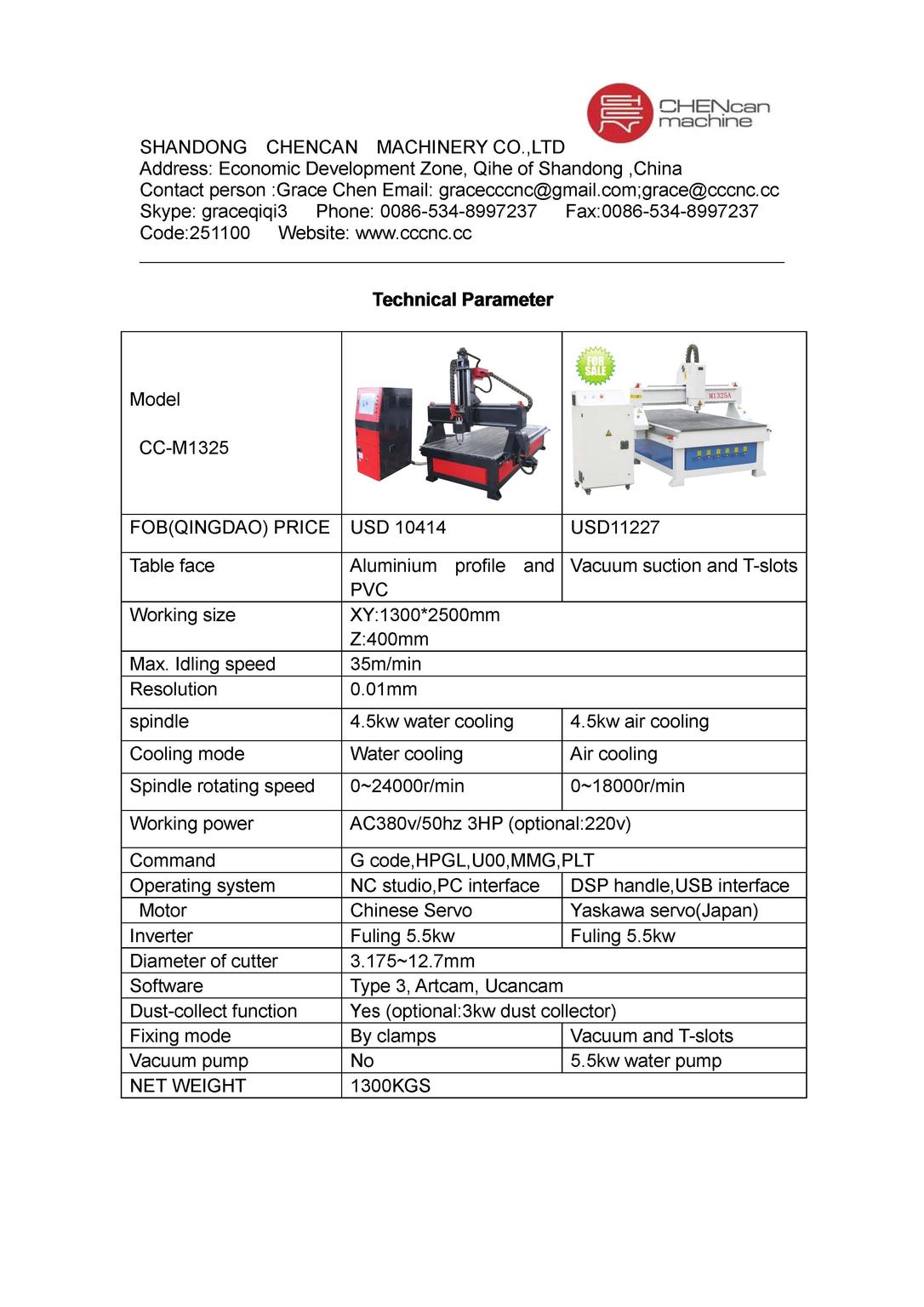

Hello Chaps,
Grace has sent me a spec. Seems very good value for money, although they don't have a UK distributor or rep. I have replied asking if they have ever sold a machine to a company here in the UK. Let me know what you think.
Attachment 8383Attachment 8384
Re: Help with new machine
No idea what the Chinese Company are like but you would need to do your homework on them. Other problem is going to be support for the machine, best your going to get by buying from China is phone support which may not be easy to understand. You will still need someone with some sort of understanding of the machine parts both mechanical & electronic.
