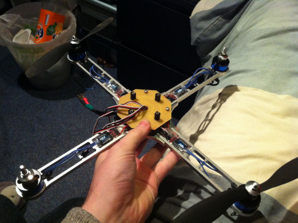

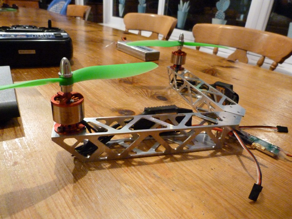

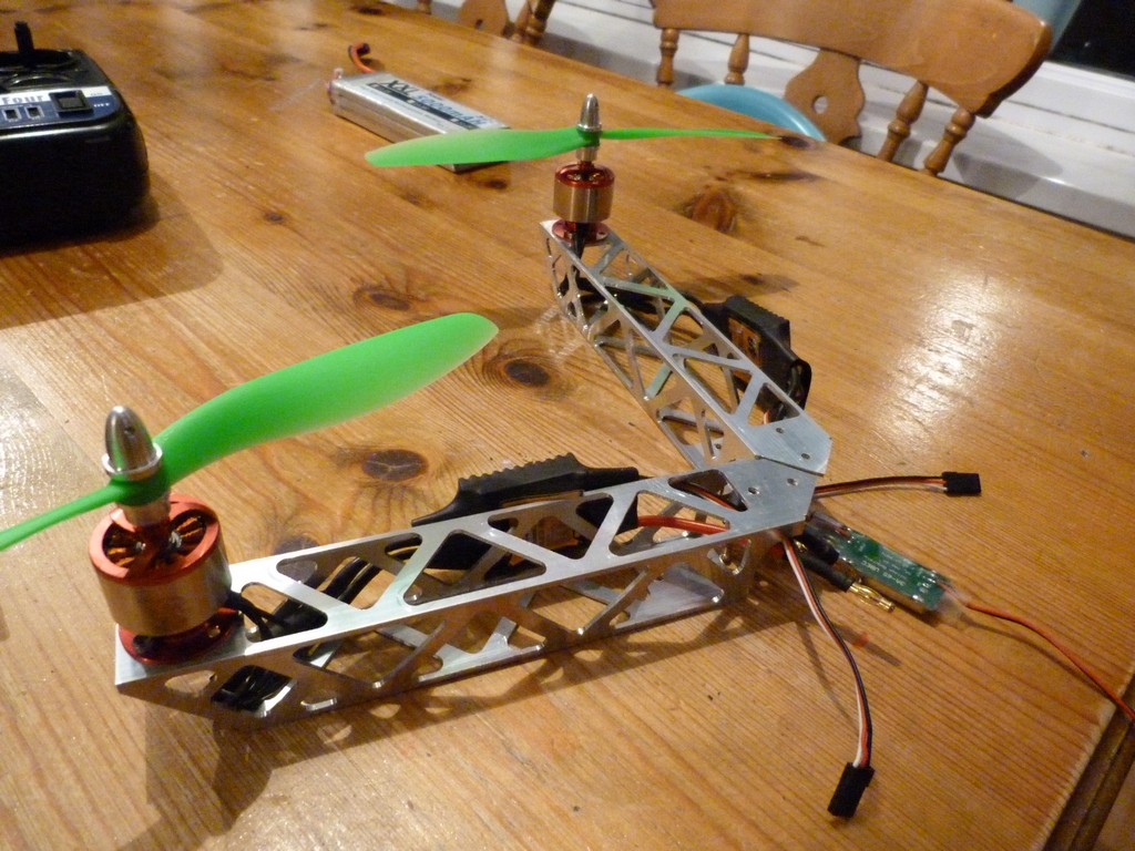

I've been building this since halloween time going through multiple frames and multiple electronics!
so I present you my unfinished quad,
Attachment 8442
But I can do better then, so I did.

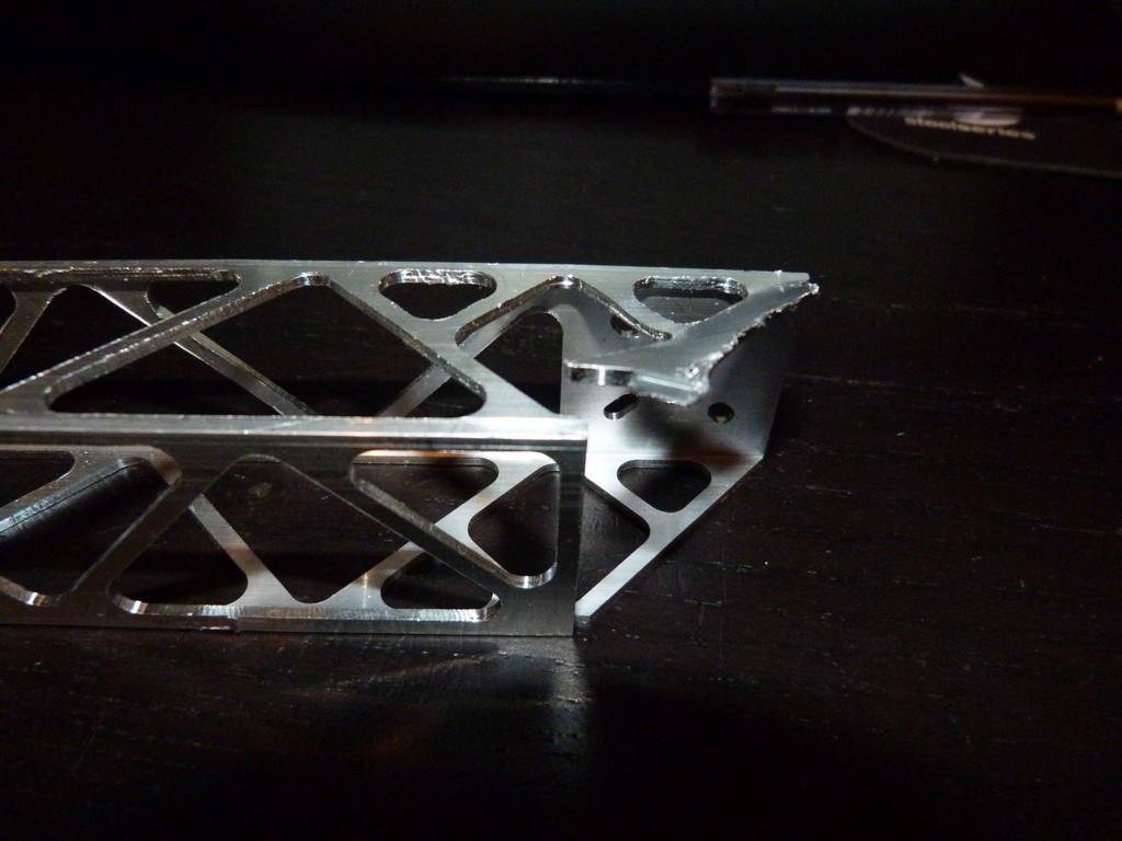

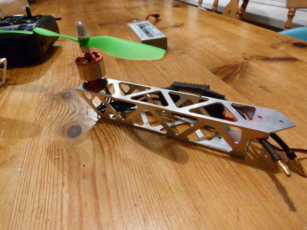

I haven't finished it yet, but here are some prototype arms I've been making:
Attachment 8443Attachment 8444Attachment 8445Attachment 8446Attachment 8447

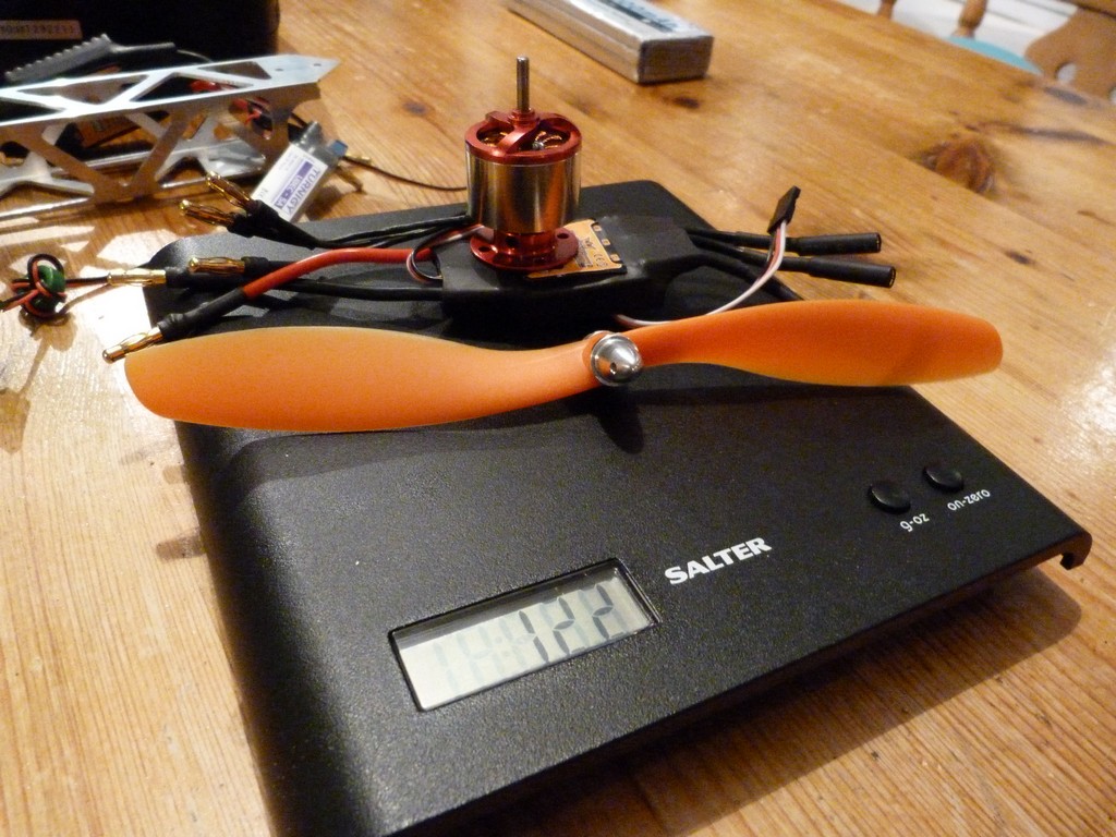

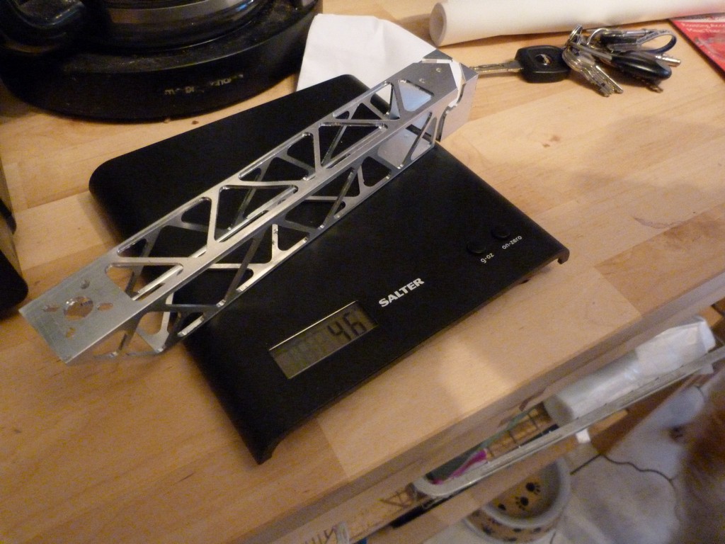

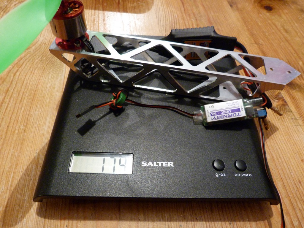

but these are a bit short now I've seen them in real life and too heavy at about 45gs
so I'm starting longer but lighter ones
Attachment 8448Attachment 8449
they should weigh about 30g and are 30mm longer but harder to make. hopefully they wont be too weak, I look forward to destroying a few!

That is a lovely truss, if you are still having problems with weight there are some nice frame designs 'floating around' made from fr4 fibreglass.

im just finishing off my quad. yours is looking really nice so far. I took a simpler approach to my frame and it seems to fly really nicely. Got to make a decent battery mount and a couple other bits then ill post some more photos.
Is there a reason you went with a 'truss' style arms instead of flat ones similar to mine?
Re: Jcb's Quad copter Project,
I just thought it would be really cool to have a truss style frame, they aren't too heavy for the quad but it's more of a competition with myself to get it as light as possible!
I was planning on using the same arms for a hexacopter or larger and have some thing super stable that won't flex in any direction.
Are your arms 5mm thick aluminium? How much do they weigh? What kV are your motors and the prop size you are running on them? Flight board?

i think the arms are 6mm but i cant remember how heavy they were, i think its close to 500g flying weight. To be fair i could save alot of weight on the arms and the center plate but wasnt sure on the stiffness of the design and may swap the ali center plate for a glassfiber one. it flys pretty well and hovers at less than half throttle which is pleasing. just need to learn to fly the thing better now haha.

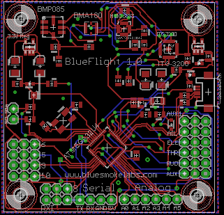

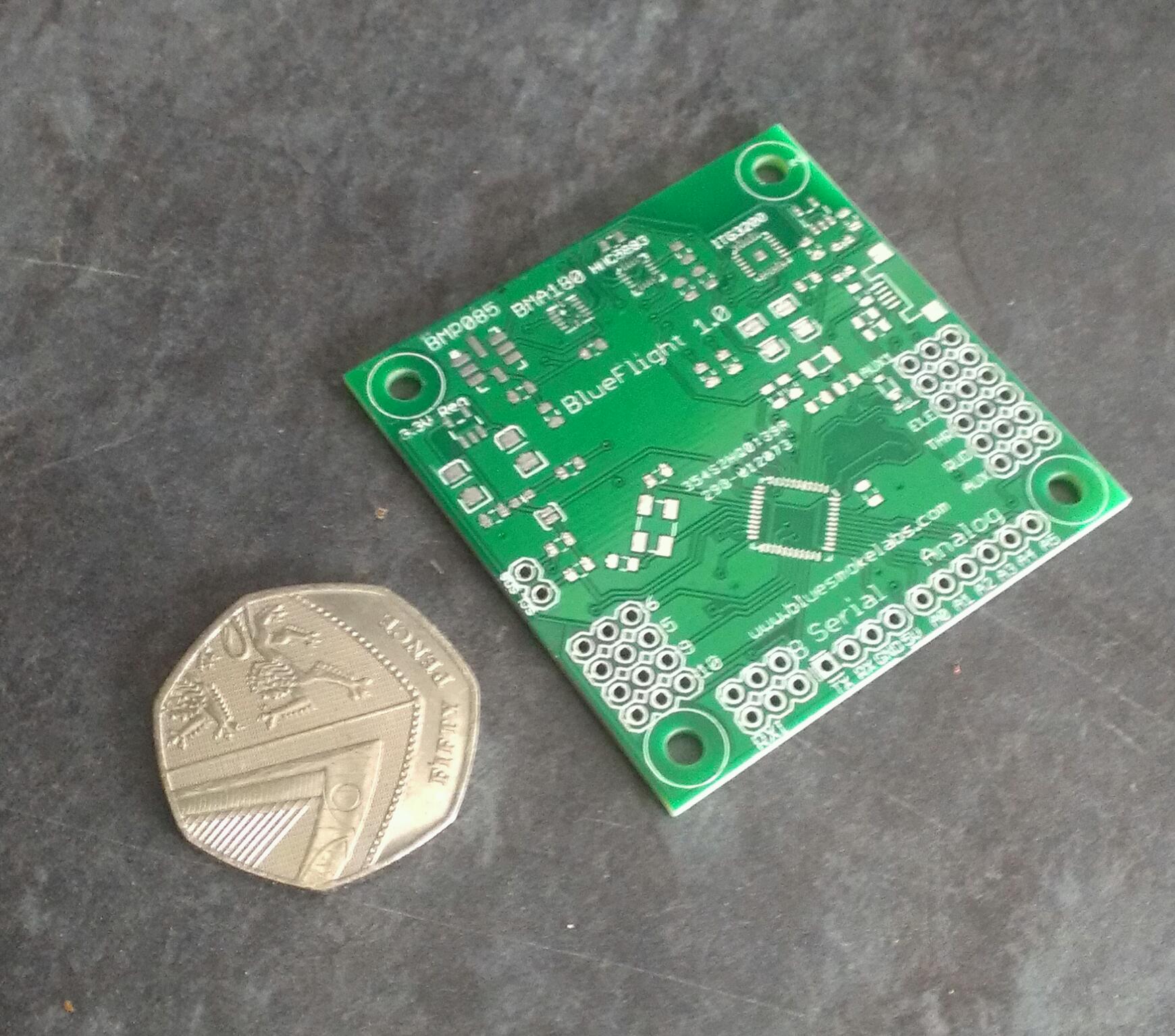

I designed a flight controller for this very purpose, just not finished building the quad yet :)
Attachment 8453
Got the boards, just waiting for parts so I can test, its 10DOF and is GPS ready :) Its 5cm x 5cm.

That looks very nice! will you be basing your firmware on the code already available?
I was thinking about making a flightboard, if you board works with gimbals and such then I might be interested :)

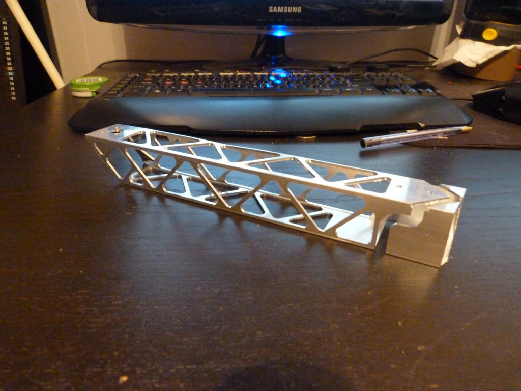

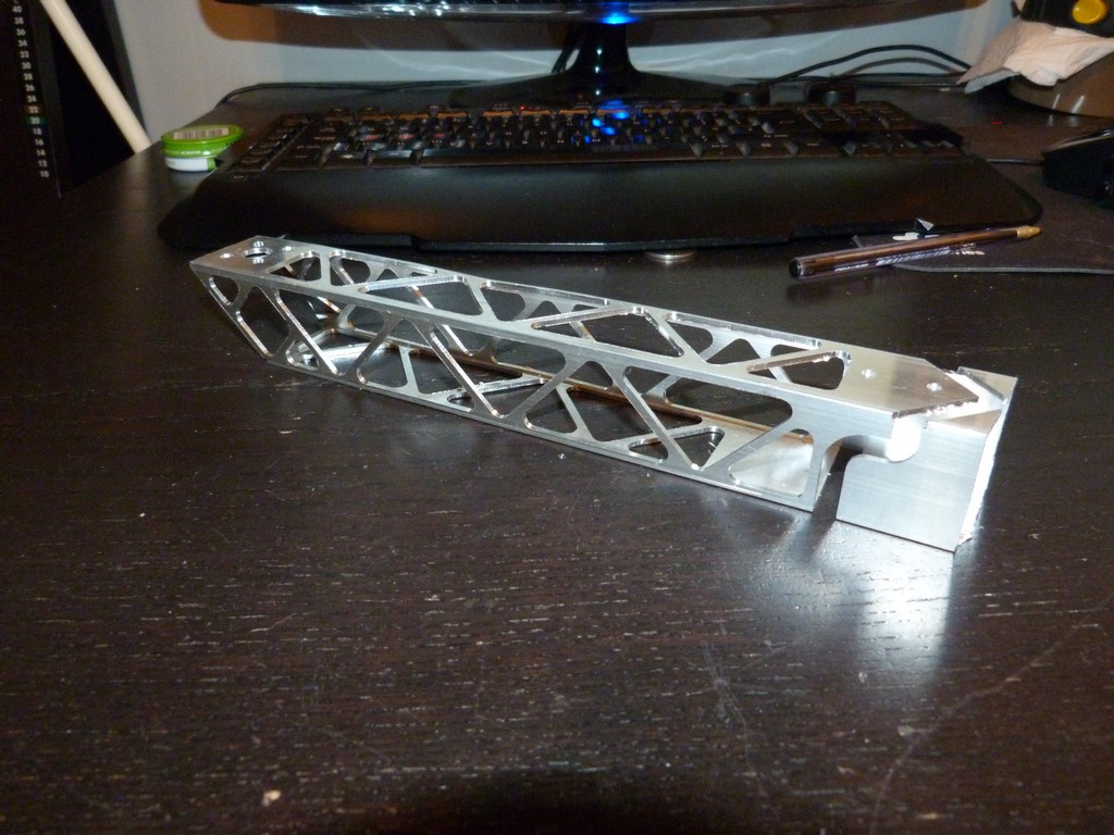

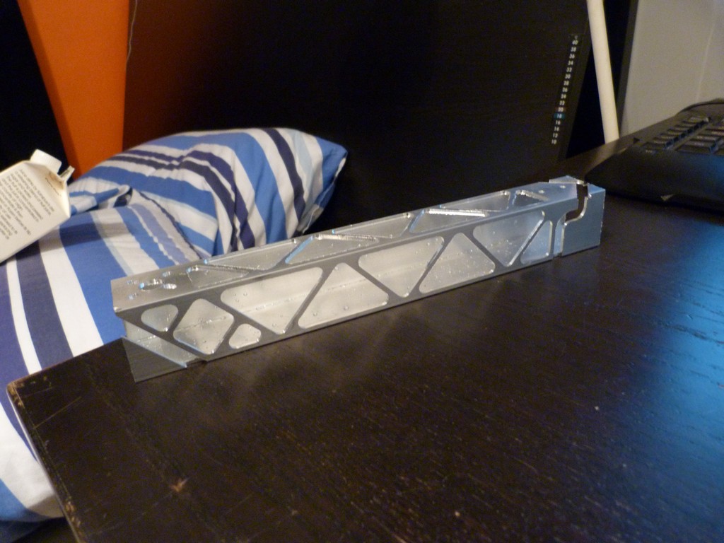

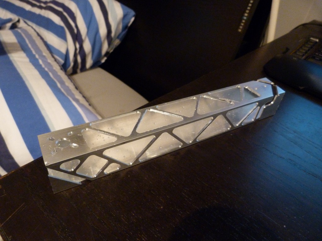

I kinda almost finished my new arm,
Attachment 8473Attachment 8474Attachment 8475
but as you can tell it's unfinished,
I had a little problem with it in the CNC. a structural issue that I'll learn from on the next model!
Attachment 8476
Each side takes me about 5-6 minutes to do, but changing the tools and re-finding zero can take ages. I need to develop a manufacturing process :) and what order I do operations in.
It would be easy to make with a rotary tale and tailstock, but not really worth getting one for just these parts. Have you done any analysis to see if they're strong enough?
I can stand on it without it deforming and I weight 90kgs, I think they'll be strong enough :)
and I was thinking this would be easier with a 4th axis.

It was desined around the Multiwii 2 code and has extra pins broken out for gimbal usage etc :) I'll dig one out and take a photo for you :)

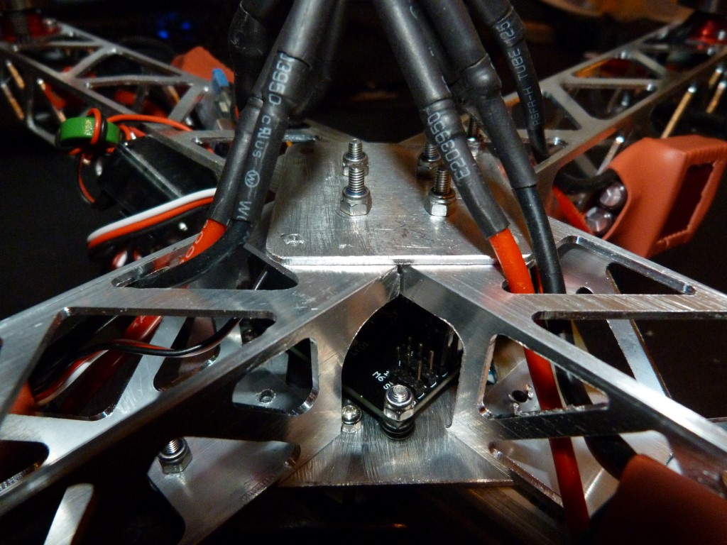

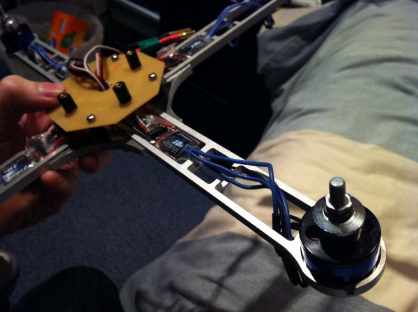

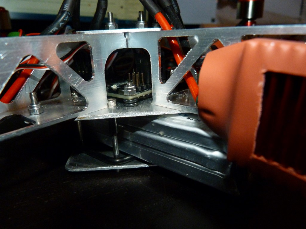

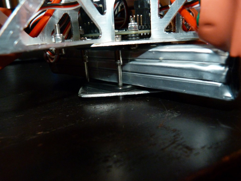

2 Attachment(s)
So I'm 3/4 of the way there!
Also how the board sits in the frame.

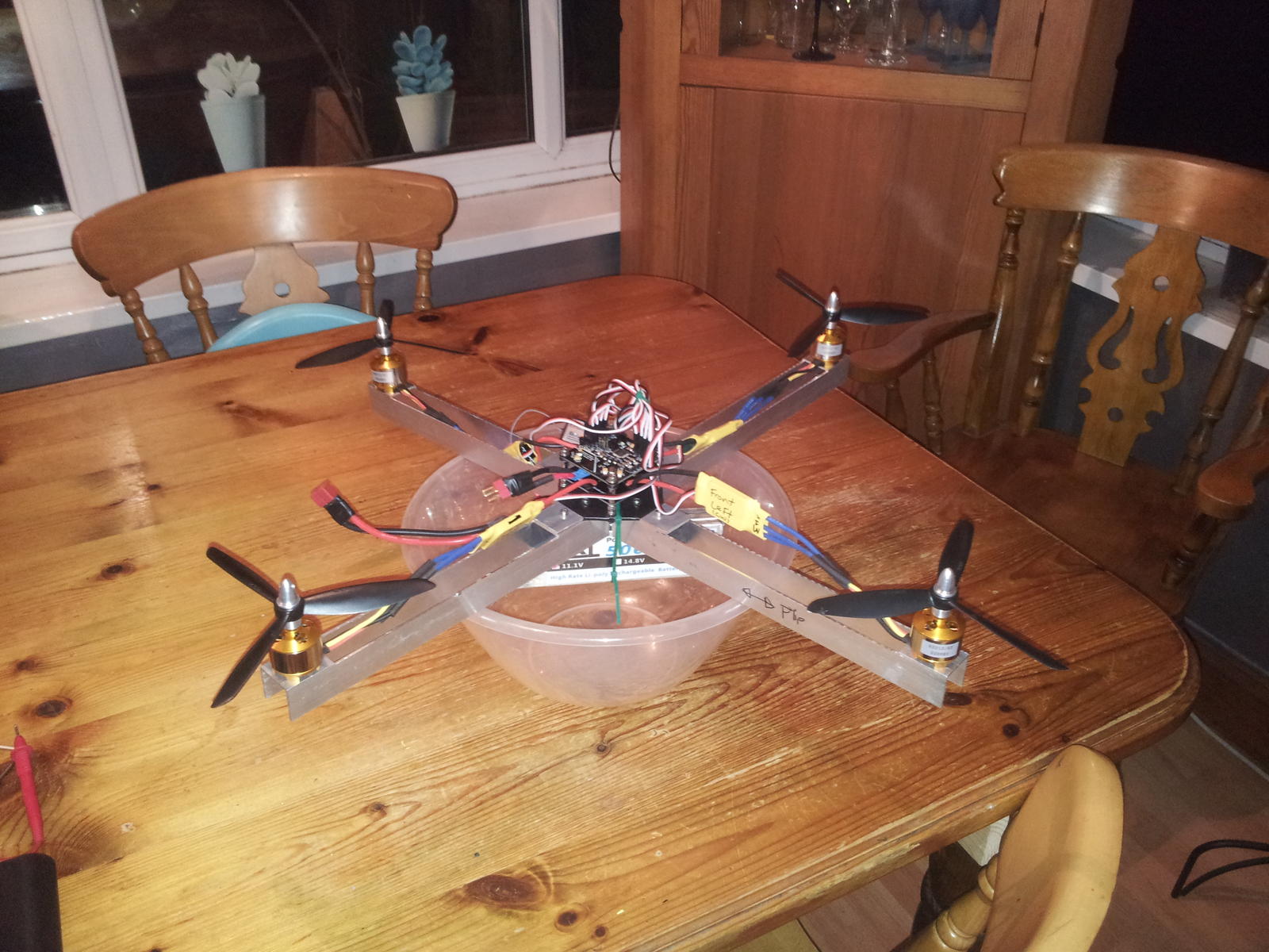

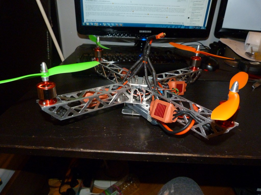

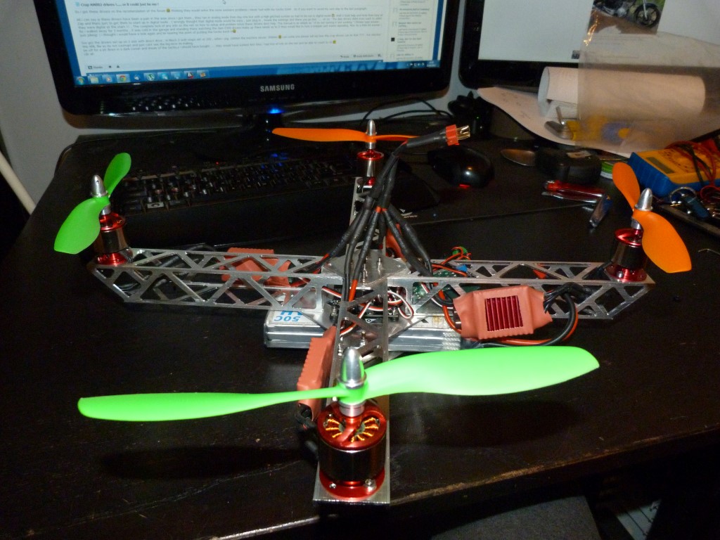

Ergh. It is finally done-ish.
I'm missing a few nuts and bolts but the frame is done! The weight in the photo is 900g and that's with a big 5000mah battery so I've done pretty well.

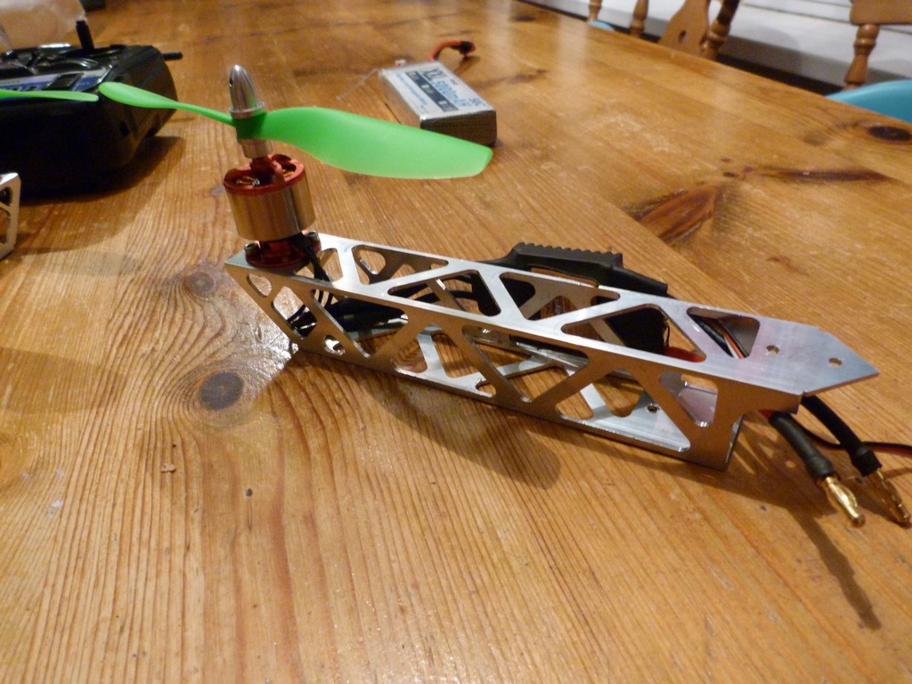

6 Attachment(s)
I've just stolen my step-dads camera so time for some better photos!
Attachment 8528Attachment 8529Attachment 8530Attachment 8531Attachment 8532Attachment 8533
I just need some cable ties for the ESCs and hopefully it'll fly!
total weight is just over a kilo.
